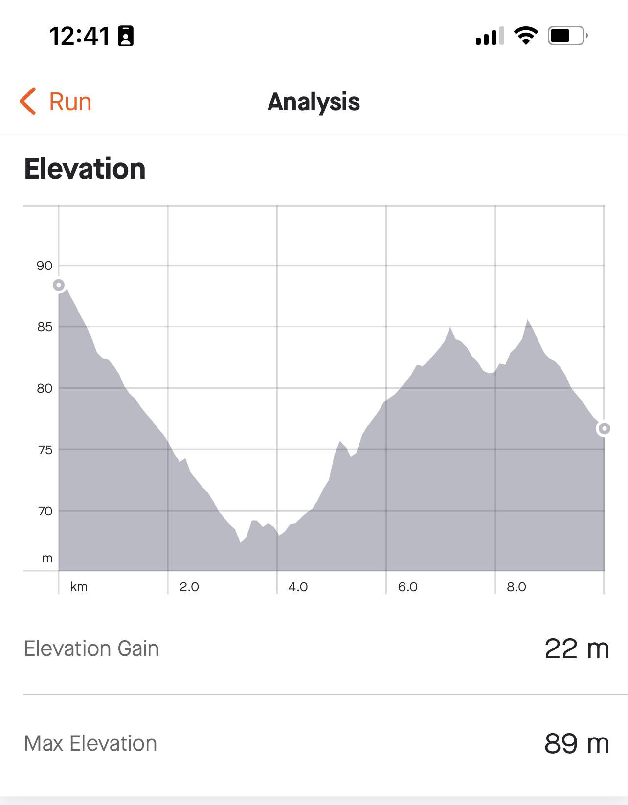

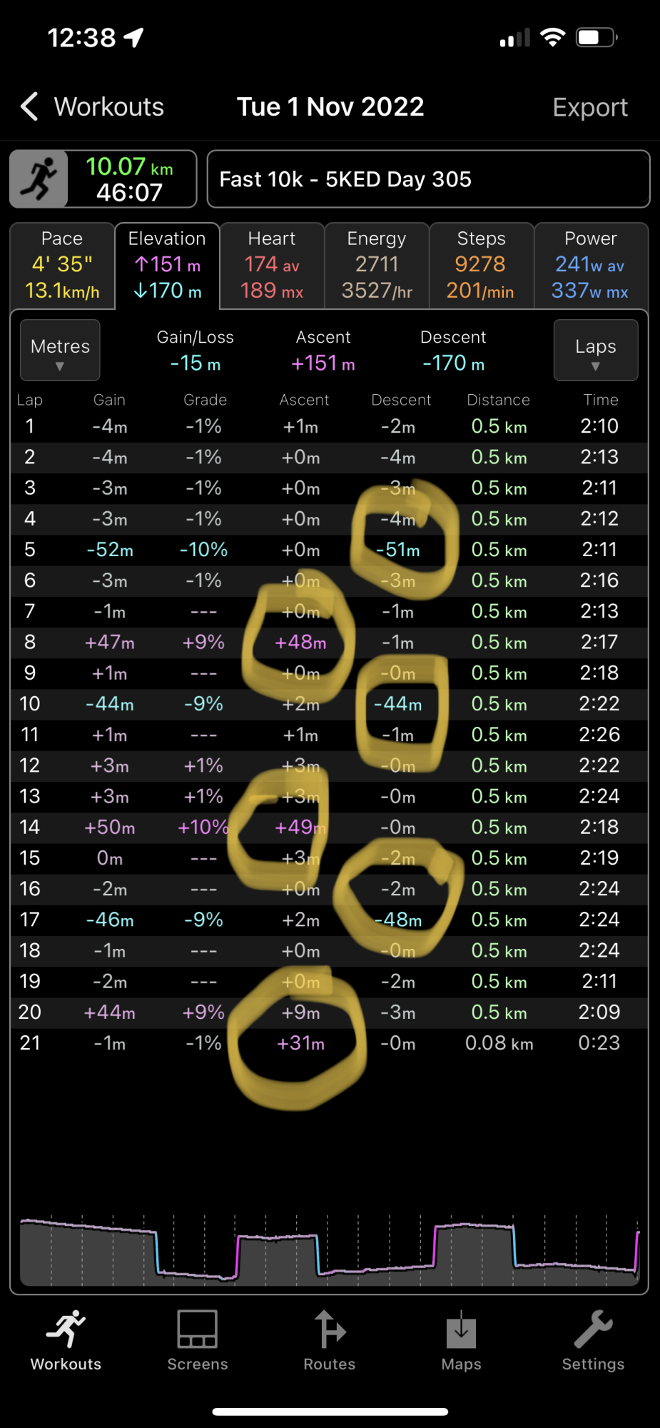

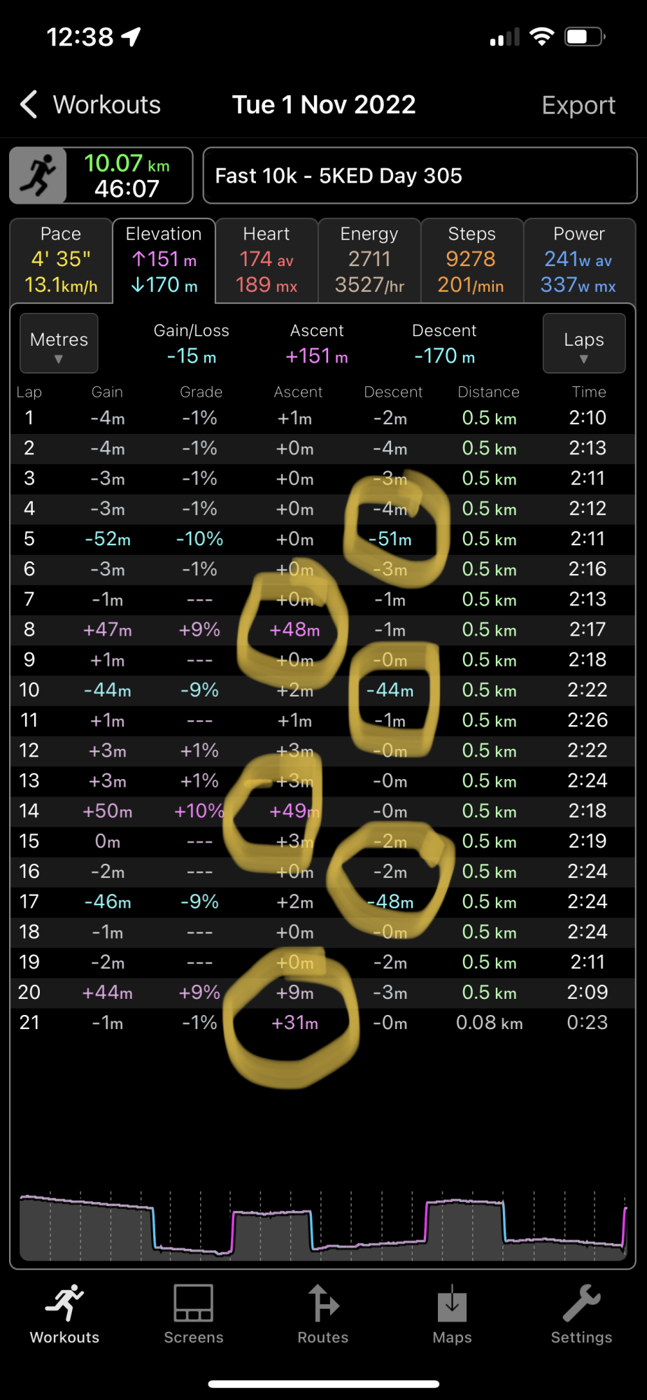

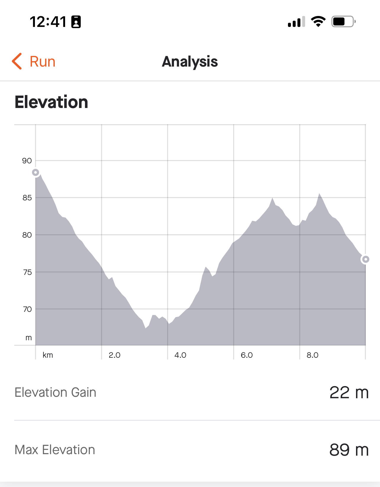

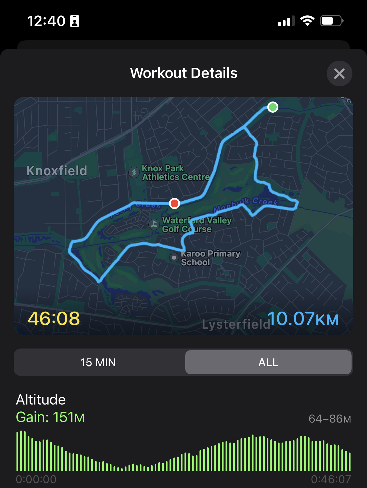

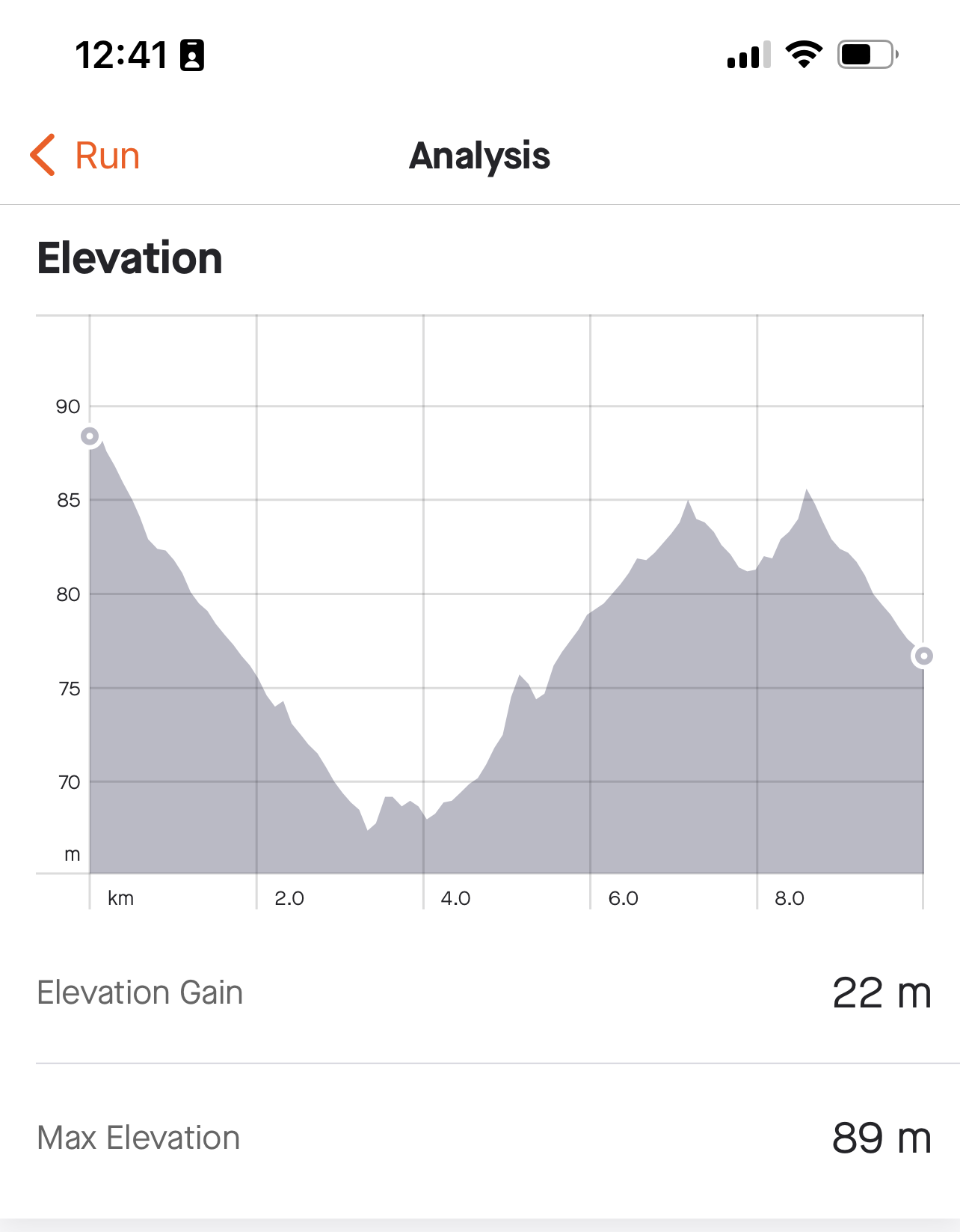

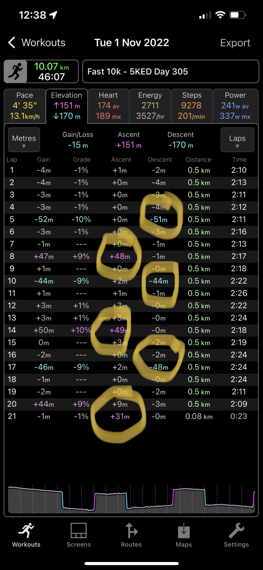

I've been getting some strange behaviour with elevation that I'm trying to understand. I recently got an Apple watch Ultra (having used WorkOutDoors on a AW6 and an AW2 before that) and noticed some strange elevation profiles on some of my runs.
If you look at the screenshot the profile has these odd dips in elevation. I've sort of assumed that it was an issue with the watch but on further investigation, I'm not entirely convinced it is not an issue with WOD.
When I look at the same workout in Fitness and in Strava these odd dips are not present.
The gain in the Fitness App is wrong (151m - should be ~30m) but aligns with what WOD has provided. The artificial dips are however not present.
If I look through my workouts I can see this occurring for the last two weeks.
Any ideas?

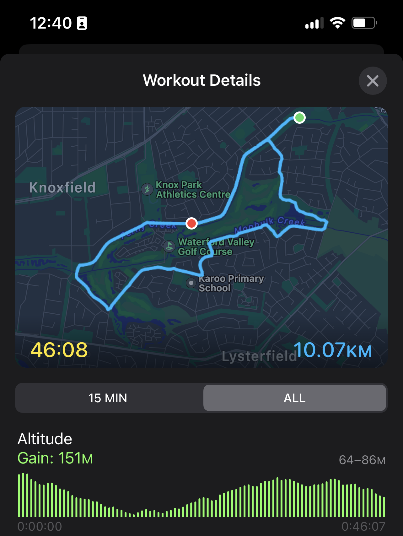

View attachment 2109244View attachment 2109245
Any ideas?
So, I've been doing some more investigation and I can now see that the issue is with the the watch / phone and not WOD. If I look at the GPX or TCX I can see the dips in the raw data. It looks like both Apple and Strava are able to normalise the data based on the location (so presumably they ignore the elevation data provided and just use the map heights.
This is annoying because I can't think how I can demonstrate this to Apple to investigate when it looks 'normal' when looking at the results in the Fitness/Workout App.
My current theory is that the problem arrises when I carry my phone and the watch at the same time so will do some more runs with and without the phone and see if I can narrow it down. I have also set up a focus mode for workouts that automatically go to low power mode so I might try turning that off too.
Has anyone else seen this sort of issue?
Someone else had the same problem last week. My suspicion is the app's use of the always on altimeter, so I suggest switching that off in the app's settings. To do this go to the Other Settings on the iPhone app or the More settings on the watch app.
It seems that the elevation returned by the always on altimeter is jumping up suddenly, then remaining at the new value for a while and then jumping back down again. I have heard of similar similar effects in Apple's native Compass app.
Apple do not reveal much about how the always on altimeter works, but they do mention the use of local WiFi networks (https://www.apple.com/uk/newsroom/2...eakthrough-wellness-and-fitness-capabilities/). This makes me wonder if an incorrect elevation for a WiFi router is causing issues. However there were no nearby WiFi networks for the other user, so I wondered if cell towers could explain it as the watch went in and out of range. Although it could just be that their algorithm just reassess and suddenly changes for some reason.
In any case switching off the use of the always on altimeter should help. There is a bug in the way app uses it anyway, which I have fixed in the next version, but that does not explain this. I have also made the use of always on altimeter default to being off in the next version because of these issues. The app was working fine when using the barometer, so I probably shouldn't have switched it to using the altimeter by default. If it ain't broke...

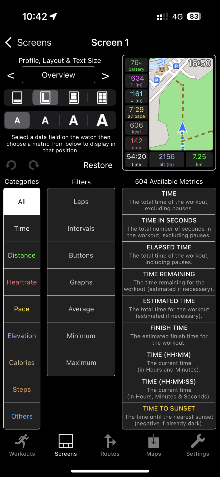

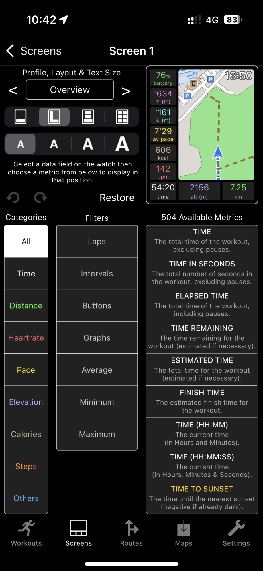

Actually, I’ve wished I could have the battery level on the L layouts for several years now. I’ve almost requested it in this forum several times. Now that the Apple Watch Ultra brings a larger screen size, I’m wondering if a battery level might fit at the top now? It sure looks like there is room for the standard size up there on my watch.
Why don’t you just put in the battery level in the upper left corner like in the screenshot below?
That’s what I do; I would just like to be able to free this space up for another metric. =) I hike in rain and cold weather a fair bit, so I usually have the touchscreen disabled (gloves, jackets, rain droplets all cause problems with using the touchscreen for me). This means I need to fit all of my important hiking metrics into a single L-shaped screen.
Also, one of the hallmarks of this app is near-infinite data field customization. Giving the option to include the battery meter in the top-center of the map on L-shaped screens for the larger Apple Watch models such as the Ultra would be yet another user-customizable parameter (and a welcome one!).
Reactions: MaxSto
That’s what I do; I would just like to be able to free this space up for another metric. =) I hike in rain and cold weather a fair bit, so I usually have the touchscreen disabled (gloves, jackets, rain droplets all cause problems with using the touchscreen for me). This means I need to fit all of my important hiking metrics into a since L-shaped screen.
Whilst it may look like there is space there, that isn't always the case. For example if sensors are connected then there are 1 or 2 sensor connection icons that appear in the top middle of the map. There is room for them next to the battery icon when the map is full width but not in the L layout.
Also yesterday I added a little lock icon for when the screen lock is on, and that appears in the top left of the map.
I could probably use a set of priorities where the battery is shown if none of the others are present, but I am not planning to change that in the near future because I suspect I will be rewriting a lot of that code in order to use the Always on Display. However when I do that then I will bear all this in mind.
As always, thank you for the thoughtful and detailed reply! I hadn’t thought about how the sensor icons might affect that space (I don’t use external sensors).
