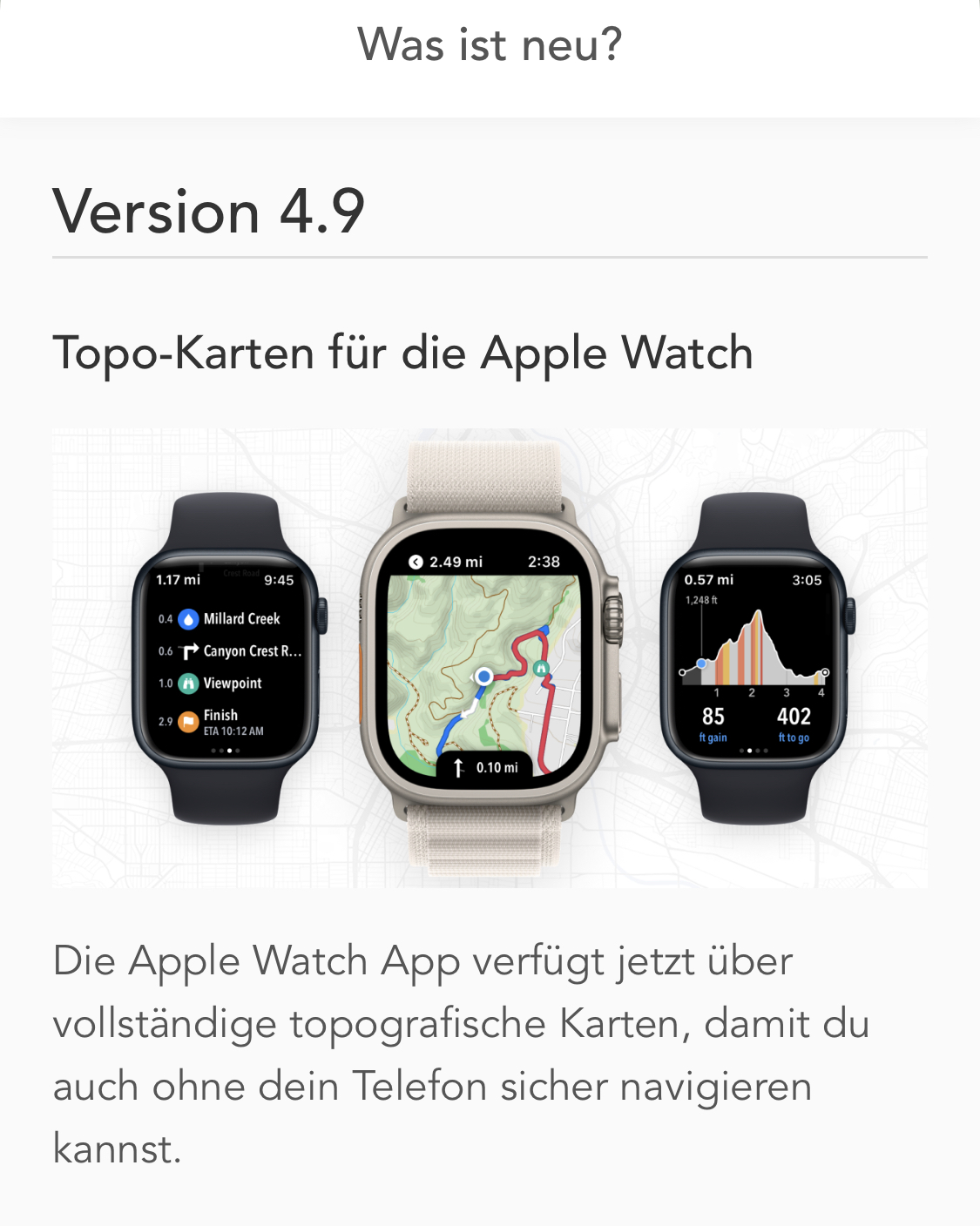

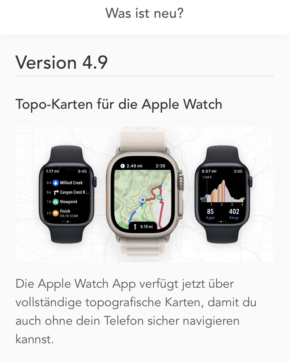

Footpath is the next App with offline download maps.

Footpath is the app I use for exporting running and hiking routes to WoD. It's a great app. But them adding maps to the watch won't really add much IMO. The apps great for drawing routes and fine for going for a wee walk. But it won't give you the metrics you need for a workout.

Can it do turn-by-turn navigation?
Footpath is great for turn-by-turn navigation.
I have always recommended it for creating routes and I plan to make WOD support the directions that it includes in GPX route files when I eventually add turn by turn to WOD.
So it can do tbt now without an iPhone?
I have tried this app for route creation a while ago but I prefer doing so on my Mac with a big screen and a mouse.
I have never tried the watch app but have been recommending the iPhone app for a while. Looks like the watch app is pretty good too so I will have to try it out at some time.

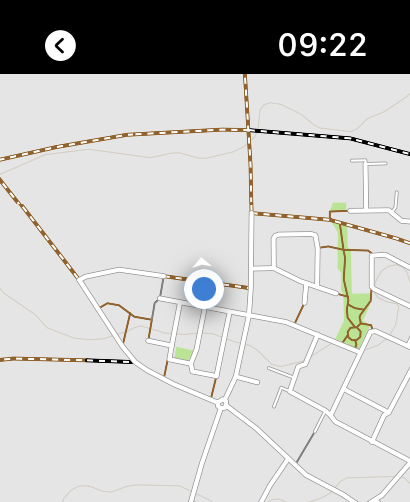

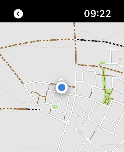

Hi, on the map-view during a workout is there a way to make the current time more easy to read ? I find it is sometimes not so easy to read the white letters when the map is a light colour. Thanks, been using the app 2 years and still loving it.
Hi, under Settings -> Maps -> Time Background -> you can choose between "None" / "Grey" / "Black".
