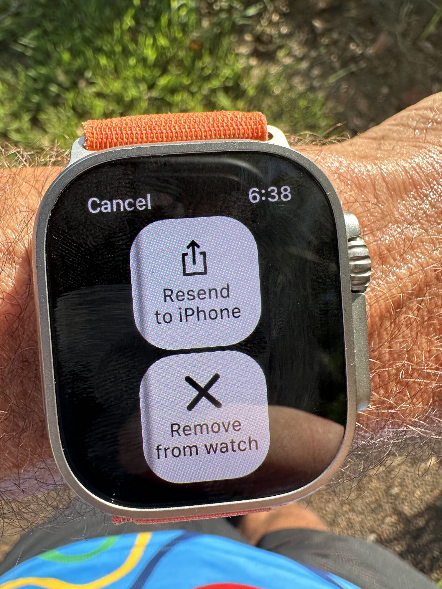

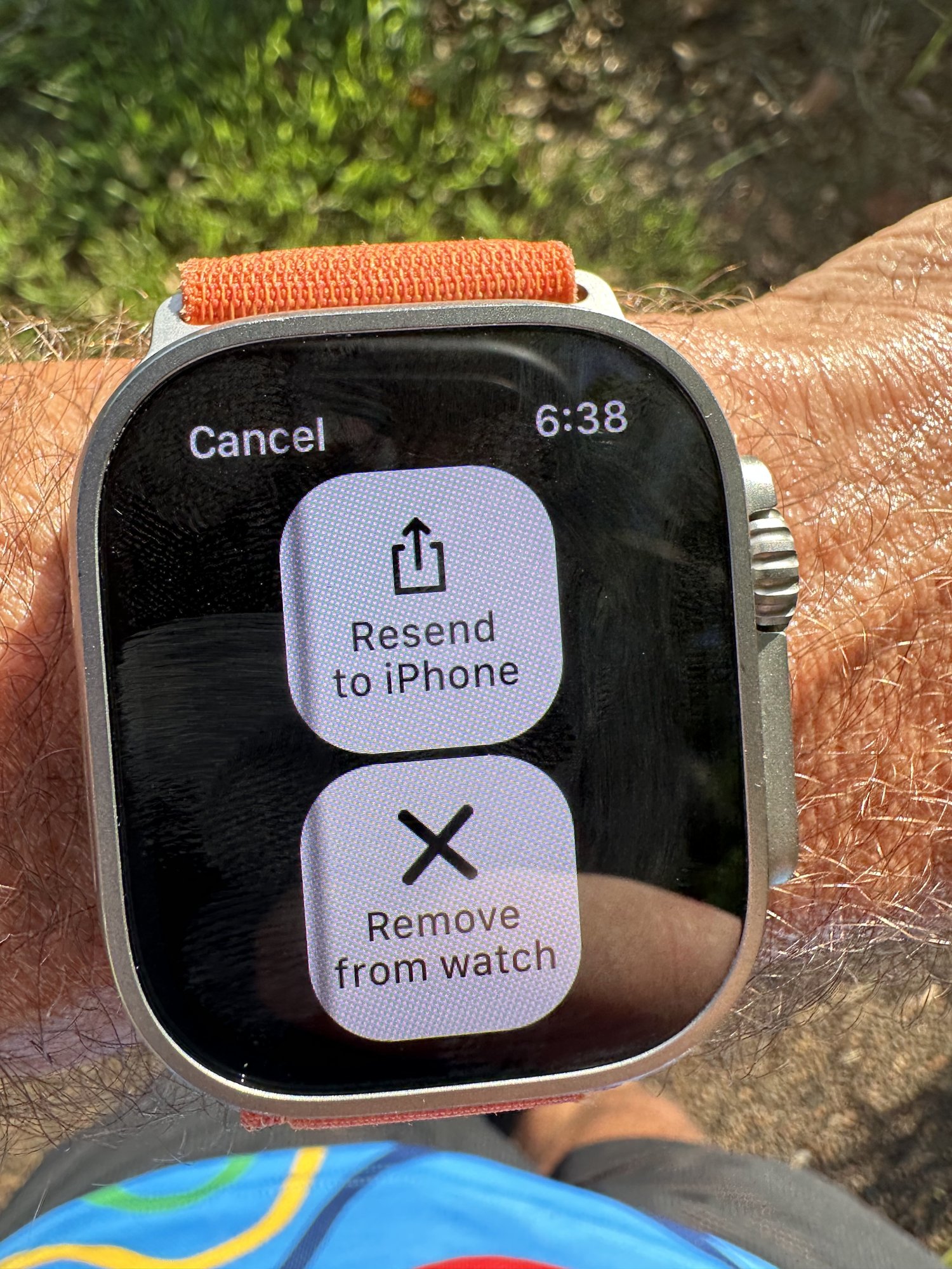

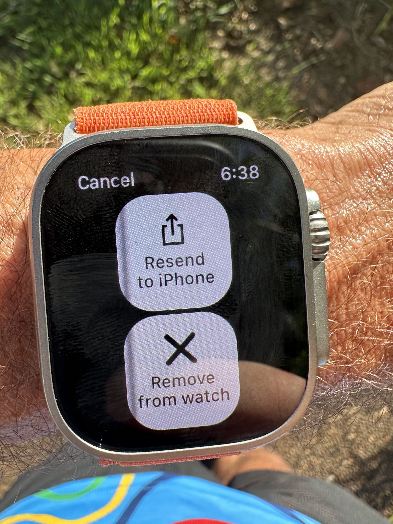

hi Ian. Had an issue with the app this morning where a long press just brought up a menu to resend or remove the workout, not the usual menu to save etc. I restarted the watch and the workout came up as recovered. I’m assuming this is a glitch as I’ve only seen this once before out of many many recorded workouts… anything else it could be?
Love the app, thanks

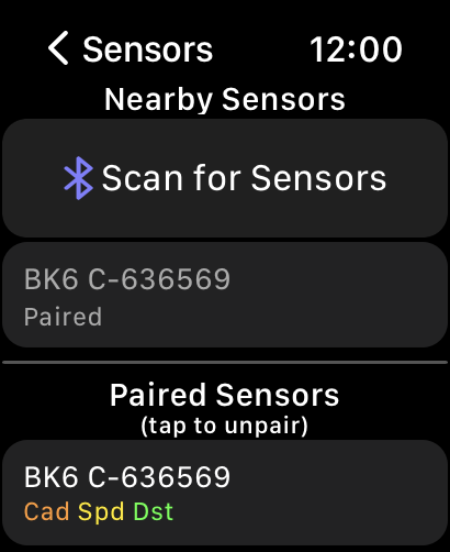

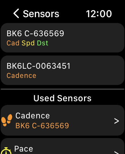

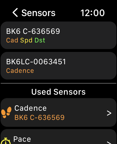

What is wrong with my settings or is this a bug?
See Screenshot
The sensor is paired and I get a success before start. But when I start a activity WOD disconnect the sensor.
What is the matter 😳

@cfc
See Screenshot
Please send the wkt file for that workout to info@workoutdoors.net and I will take a look. To do this tap the Export button 3 times quickly.
Ow
Hi Ian,
I love you app! Really nice.
But today i had exactly the same as oboe5150!
Today I used the action button to start a workout for the first time. The app presented me directly a running workout and everything was fine. I did my workout and came back to my home where I tried to stop the workout. But that was not possible. A long push just showed the options „resend to phone“ and „remove from watch“. I checked the settings of long push on the phone but everything was fine. The app was stuck in the workout, not able to stop and finish it. Then i hit „remove from watch“ and I came back to my last workout from last week - I was on the overview-screen with the done-button at top.
My workout was gone. Thanks to @oboe5150, I tried to restart the watch and yeah, the workout was back there as „recovered“! Great!
Maybe after the last workout I did not push at the „done“ button. So that the app was still all the time at this overview? (This happens often to me)
I was not able to reproduce the issue.

Hi Ian,
Sorry, I missed that previous post. That sounds very strange. I can't guess what would cause it. Those menu options are for a workout in the workout history so I don't know why they would appear during a workout.
Please could you send me the wkt file for the workout and I will take a look. To do this tap the Export button 3 times quickly and email it to info@workoutdoors.net. Also, please could @oboe5150 do the same. Thanks.
