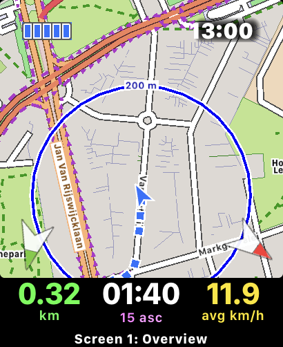

Hi, under Settings -> Maps -> Time Background -> you can choose between "None" / "Grey" / "Black".
Hey thanks for that. This is the best I get on my watch, and in some circumstances it is not very easy to read the hour. I would suggest that the black background should be a bit bigger and maybe rectangular shaped to improve the readability.
I think the reason it doesn't stretch to the hour is because you are using the bold font. The app tries to cover as little of the map as possible and I never tested the app with the bold font. Sorry about that.
I will bear it in mind during the current re-write for the Always on Display.

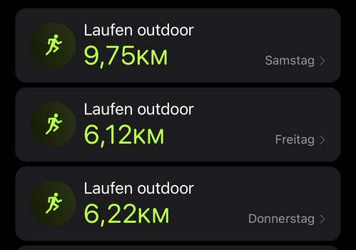

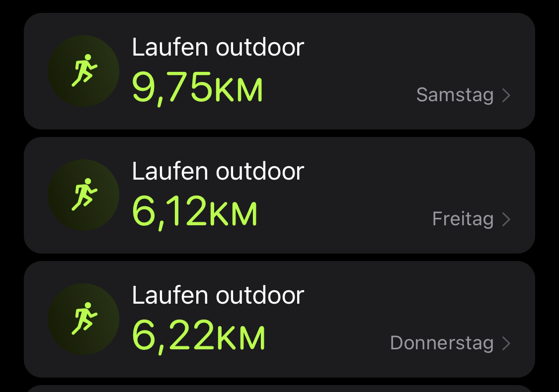

So your watch simply is not calibrated, which explains basically all the problems you have with the WOD-App…
Perhaps you should do a few longer runs or walks with the native app when you are outside, before you use the WOD-App again.
