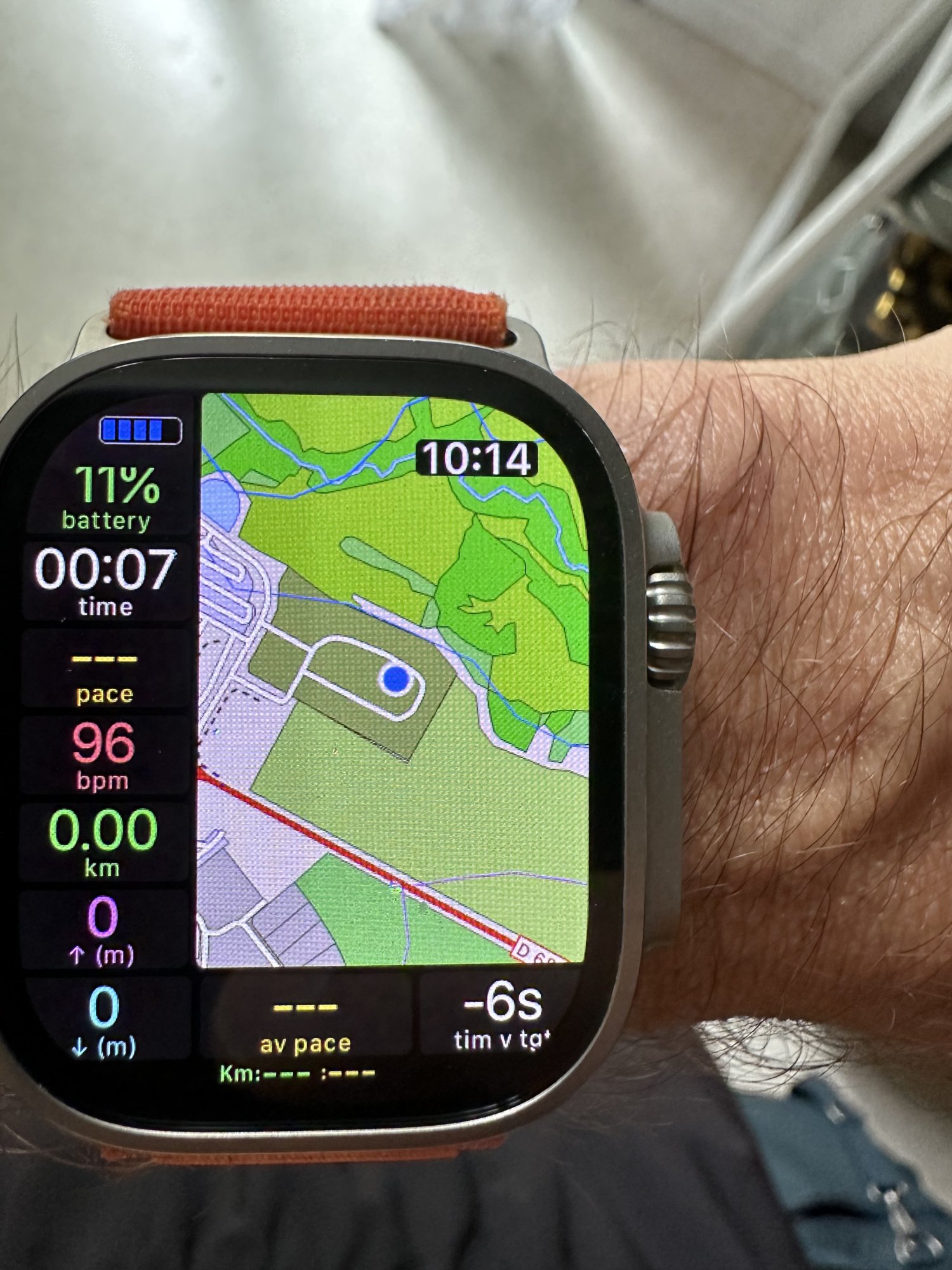

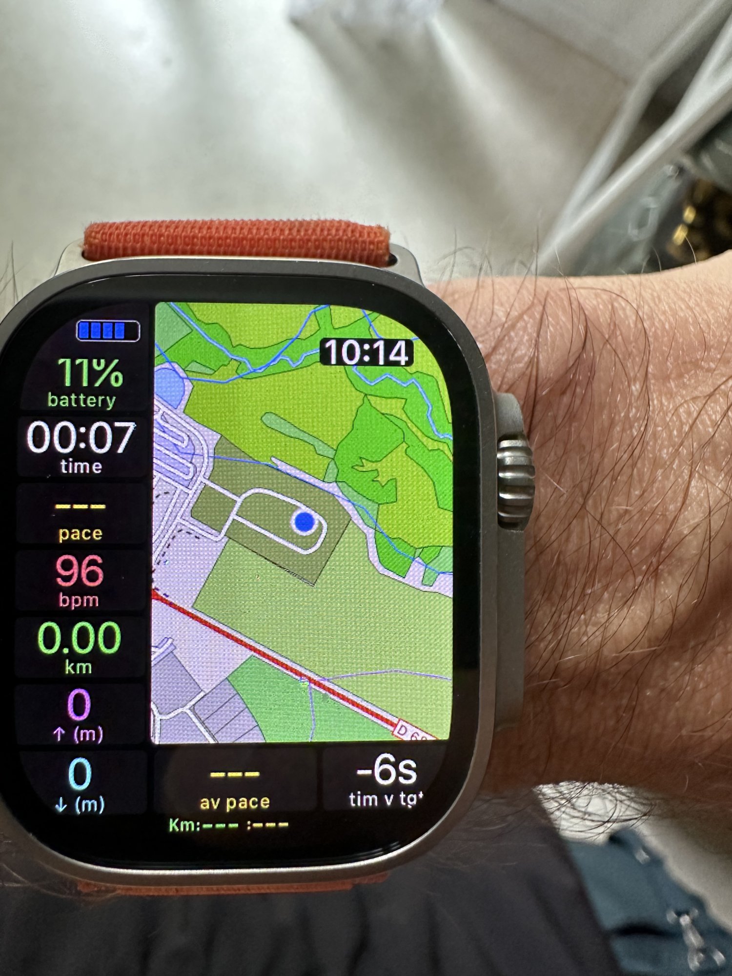

hi ian, this morning test on a run of 8.5kms/43min. the aod works well although i notice some darkening of the screen when i don't raise my wrist. I started with 20% battery and ended up with 11 with the music all the way through so ok. I noticed that the data display was a bit truncated at the top left and bottom, yet I'm in small print. before the MAJ I could see well. That's it for my return and thank you again for all the work!
Apple slightly darken the screen by default when your wrist is not raised. The app also darkens it slightly further but you can adjust this in the Screen settings (to control battery usage).
I will fix the truncation of that top metric in the next beta. Thanks for testing the app!

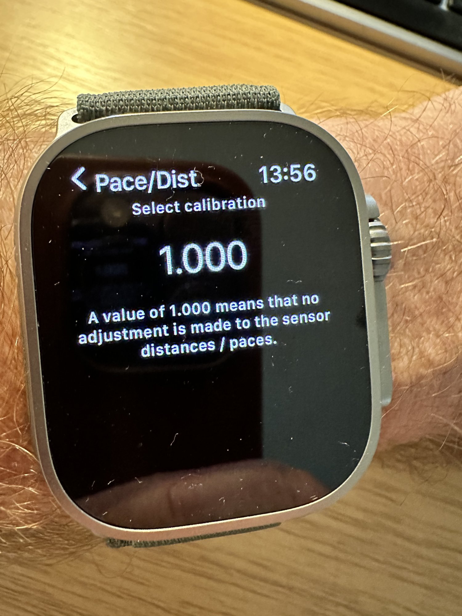

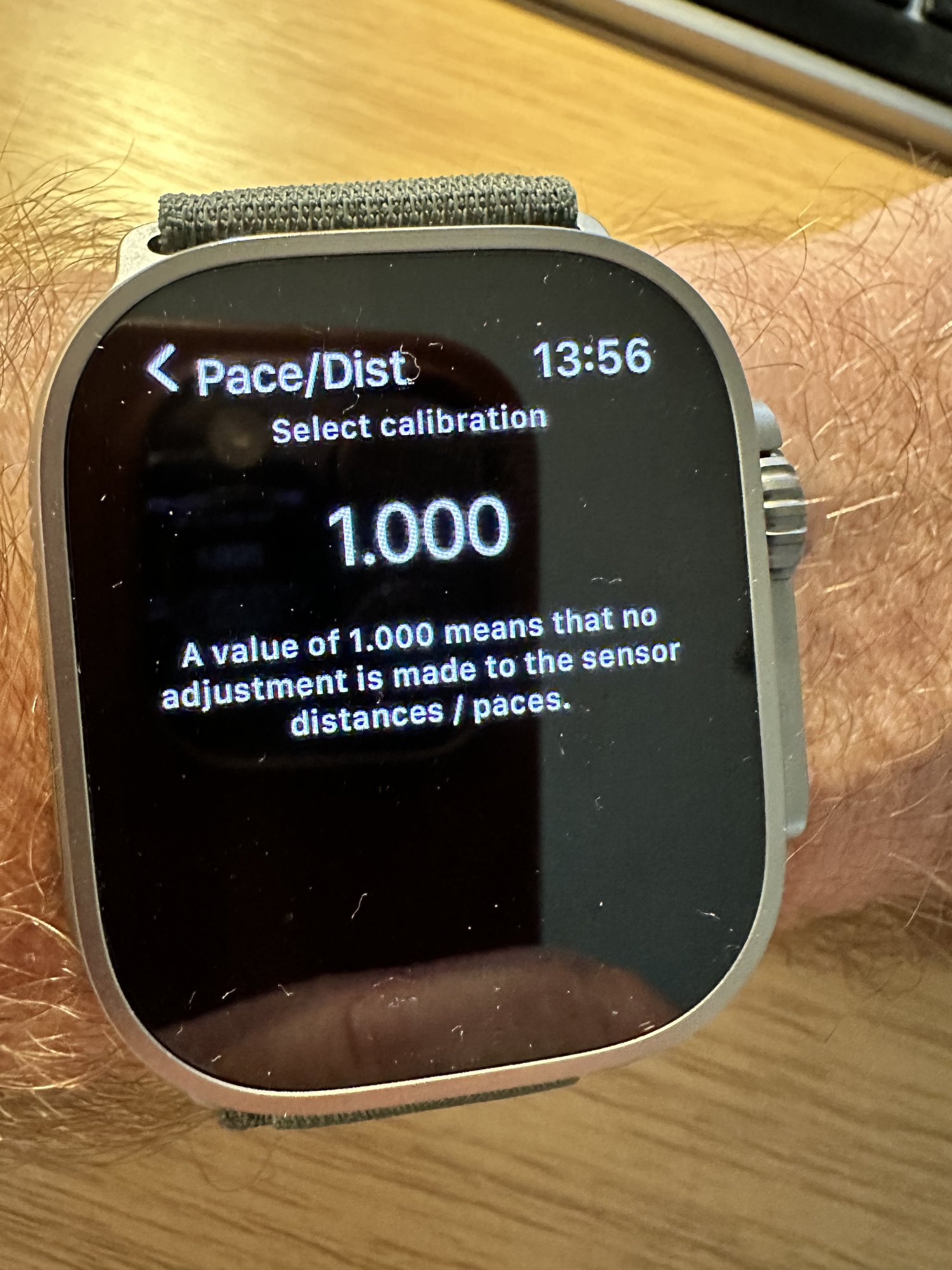

Regarding the beta, from memory when going into activity settings I could refine the calibration of a the Stryd sensor for pace/distance. This doesn't appear to work in the watch app anymore. Or am I dreaming that I used to be able to do this? I'm sure I calibrated it to 1.09 for Indoor Running so it matched my treadmill. I recall there was a +- either side of the value.
The sensor calibration hasn't changed. It has always been in the Sensors settings. Are you not seeing it there?
You will need to select Indoor Running and if the Stryd is paired then it should show the calibration settings.
Yes, it is there but I thought there used to be a - and + either side of the value. Even if I tap that area it does nothing.View attachment 2236490
I don't think there used to be + and - buttons for that screen. There possibly should be, but I am minimising changes to existing screens, so I won't add them now.
The settings screens do not need to change when the wrist is lowered so there was no need to rewrite them in SwiftUI. I will probably rewrite them at some time in the future but the existing screens should be the same as in the previous version.
When I do rewrite the settings screens then I may add + and - buttons for that screen because I possibly should have included them in the first place.
Sorry my mistake. So how can I change the calibration?
EDIT: Just worked it out. It scrolls
Yes, the crown scrolls between values. You have confirmed that I should add buttons when I rewrite that screen. Thanks for testing the app!

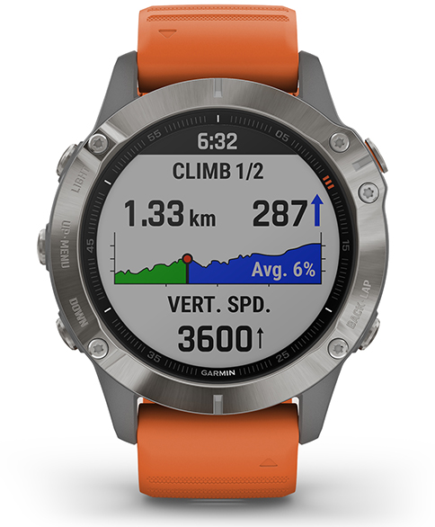

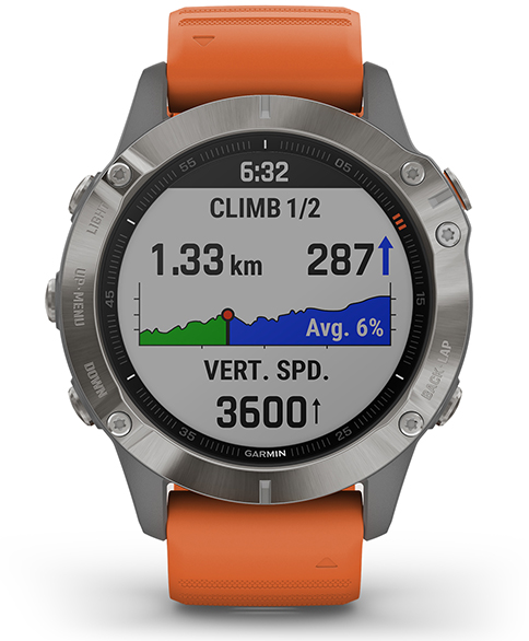

WorkOutDoors is an essential tool when hiking and I use it as my primary map for navigating through a route imported as GPX from Komoot (pre-hike planning online) or Garmin Explore (offline planning during the hike). Without WOD, Apple Watch Ultra could not have replaced my previous Garmin Fenix 6.
There are couple of key feature gaps - or maybe I have not just found out the features:
1) Elevation graph that shows both the history and upcoming elevation changes on the planned route (this is the most useful view for hiking in the mountains. See an example from Fenix 6 below)
2) Remaining distance in the route
3) Remaining ascent in the route
4) Way to see distance to a selected point along the route (now zooming in/out on the map shows a circle with direct line distance, but in mountains this is usually very different from actual distance due to path not being straight).
5) Bug (?) funnily the direct line distance circle shows the distance in meter for any distance between 30 - 1500m, but switches to miles for a distance greater than that. Would be more logical to keep the selected distance unit. For miles, I would prefer 0.x ml over x00 feet. Also, 1ml, 2ml, ... is too coarse showing circles for every x.x ml would be better.
Have I just missed these features? Are they planned to be added to WOD in future?

The first 3 points (and maybe 4) are part of the improved navigation features that will be top of my to-do list after the always on display version is released.
The last point is intentional. The app generally shows metres for small distances and miles or km for longer distances.
