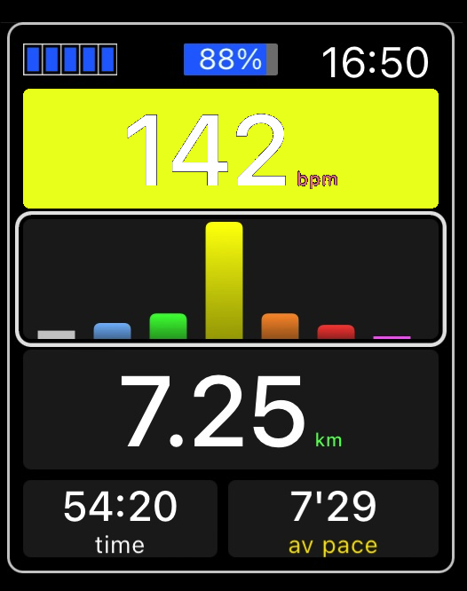

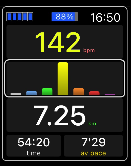

Hello, congratulations again for the app, I have been using it happily since I got my Apple Watch ultra two. Coming from GARMIN, I'm missing one thing that seems important to me. When I run, my practice does not always require the same type of screen. When I go jogging or a track session or even a hill session, an ultra trail or a short trail, I don't need the same screens. Would it be possible to personalize or rename screens or even disciplines in order to adapt them to my practice. For example when I do track, I use a basic screen and a screen that allows me to consult my intervals, I don't need a map. On the other hand, on an ultra, to save battery, I am not going to use AOD, I need a map screen with the track and the remaining distance, a basic screen and a elevation screen. When I go jogging, I only need a basic screen etc. etc.
Would it be possible to implement this function?
Another thing, the zones have specific colors, would it be possible to apply these colors to the text or background designating the numerical value?
In any case, congratulations again and thank you for all the work.
Philippe
I know @cfc has this capability in his list of upcoming features. If I understand correctly you will be able to create multiple running profiles for example and configure the screens differently for each. I would like put my vote in for getting this feature before the navigation stuff. It feels like a fairly simple feature in comparison but would be very valuable to many of us that use the app. I routinely switch between trail running and road running and would like a totally different configuration for each. I understand if you can't because it is more difficult under the hood then it seems but it would be a great addition.
Philippe
The app uses Apple’s workout system, so it is limited to the activity types that offers. In the future I plan to allow the ability to create custom activity types that map to Apple’s types, so you could create separate activity types with different settings and screens etc.
Custom activities are probably top of my list after I have added the navigation improvements, but that will take some time. Sorry about that.
In terms of zone colours you can't set the background of each metric but you could go to Settings / Screen / Bottom Line in the iPhone app and configure the app to show the zone with the appropriate background colour.

**Feature Request**
Hi CFC. I wondered if it was possible to add a 'limit alert' for 'High/Low Heart Rate Zone'. I know there is a an alert under 'others' for zone changes but I would love a limit alert that could tell me when I breached Zone 2, with senstivity values etc.
I guess I could use a high heart rate value for this but I would appreciate being able to set this simply using a zone.
**Feature Request**
That is on my to-do list but rarely requested. It will rise up the list as a result of your request.
In the meantime you can do it by using a simple interval schedule with a single interval with a manual duration and a target heart zone. It's not ideal, and it's probably easier to set a bpm alert, but it may help.
