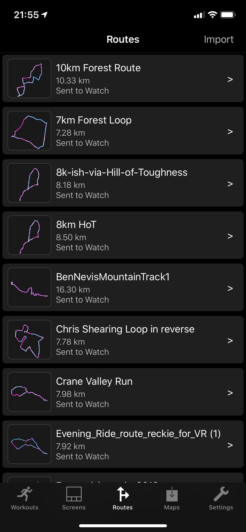

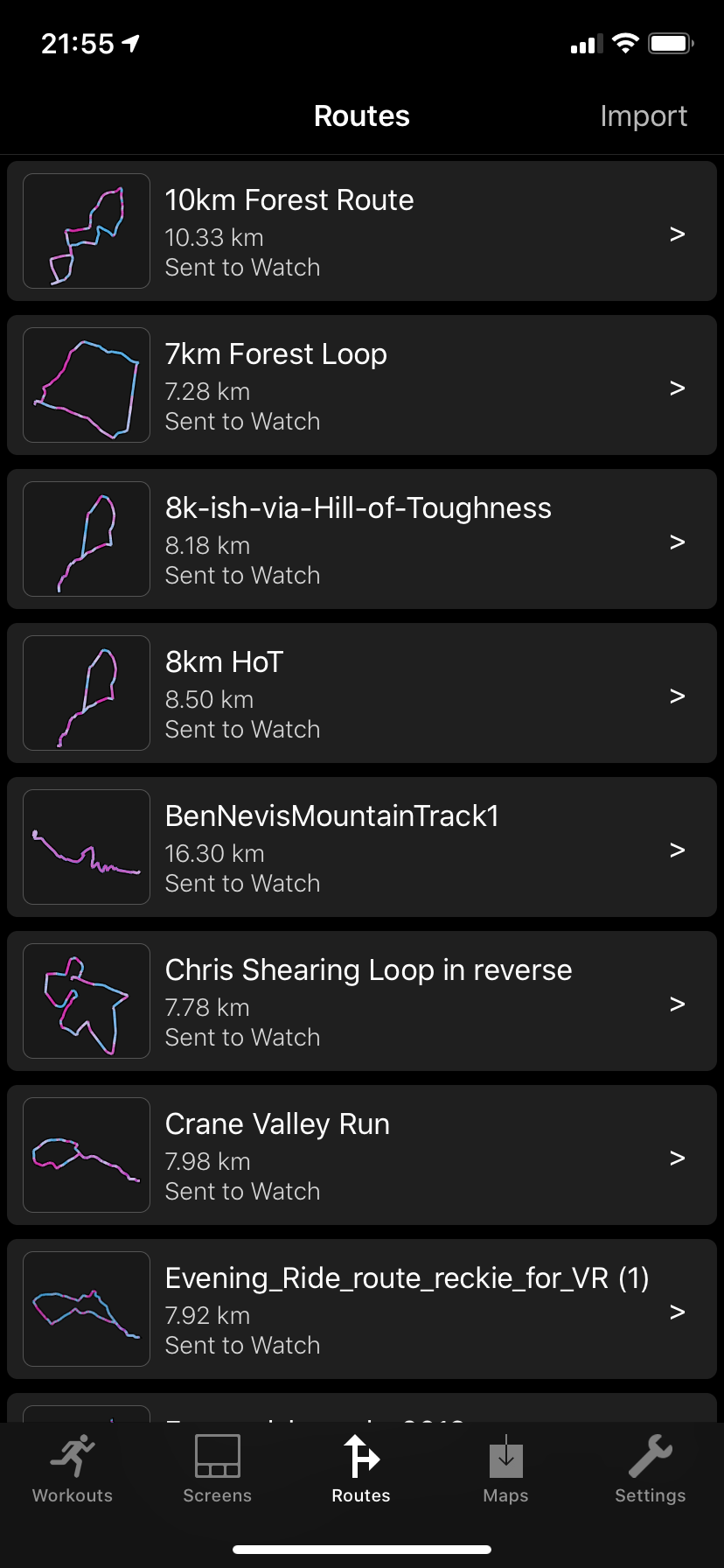

Any known reason why I am struggling to sync routes? I have a new phone so the app on the phone still thinks the routes are on the watch, but they do not appear in the route section on the watch.
The best thing to do if the comms between the iPhone app and the watch app are not working is to reboot both the iPhone and the watch.
If that doesn't work then uninstall the watch app (not the iPhone app); reboot both the watch and the iPhone; and reinstall the watch app.
Sorry about that. Occasionally iOS and watchOS seem to conspire to install a watch app such that it cannot communicate with its iPhone app. Sometimes this is fixed by a reboot, but sometimes it is necessary to reinstall the watch app.
I hope that helps.

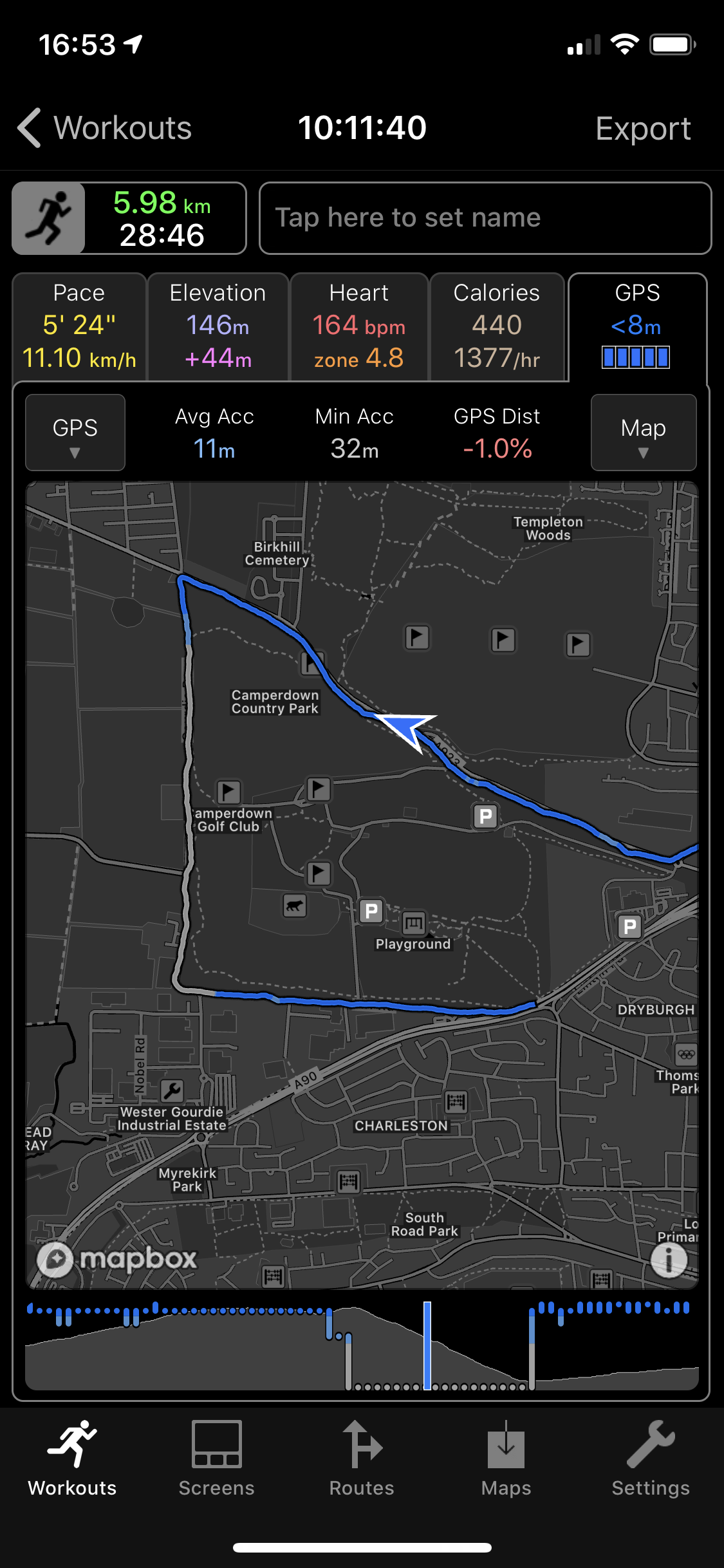

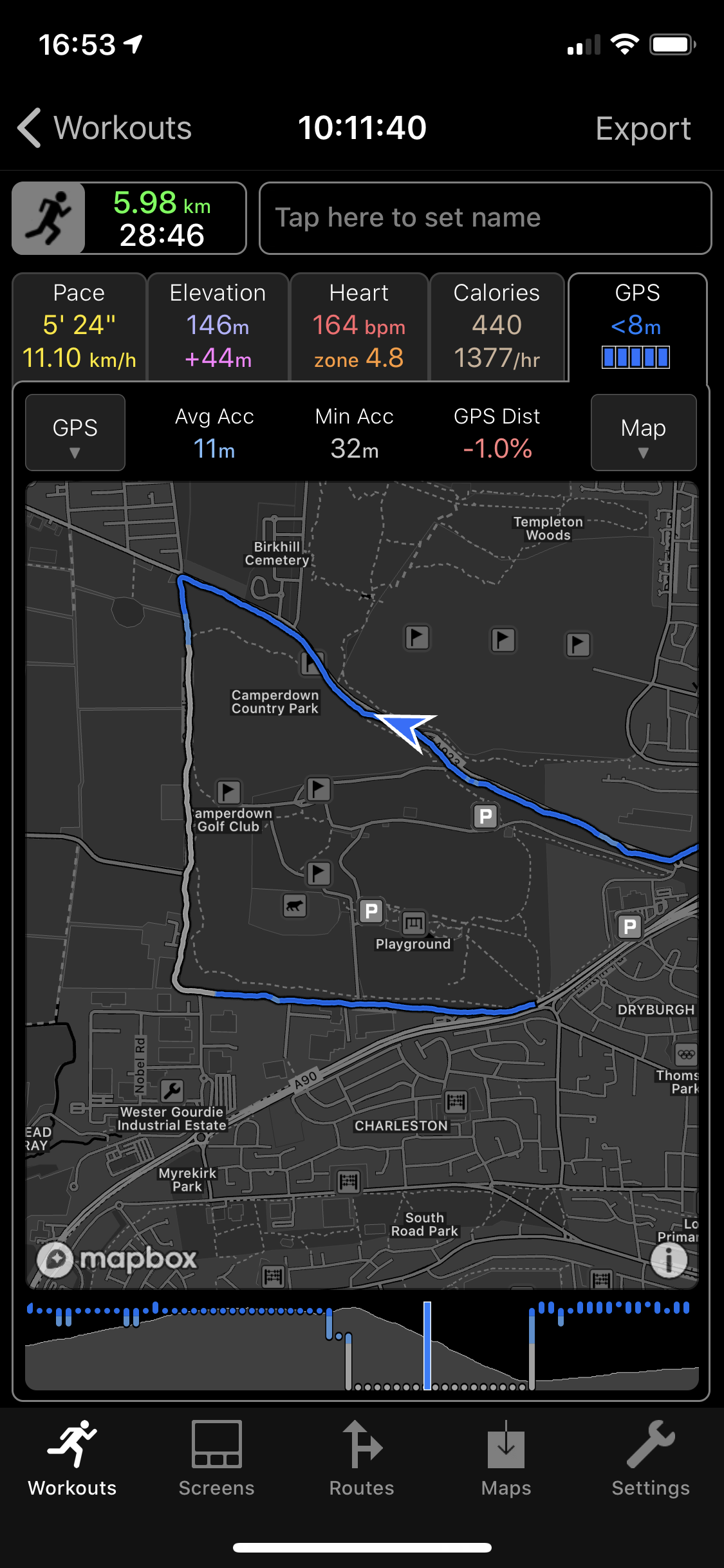

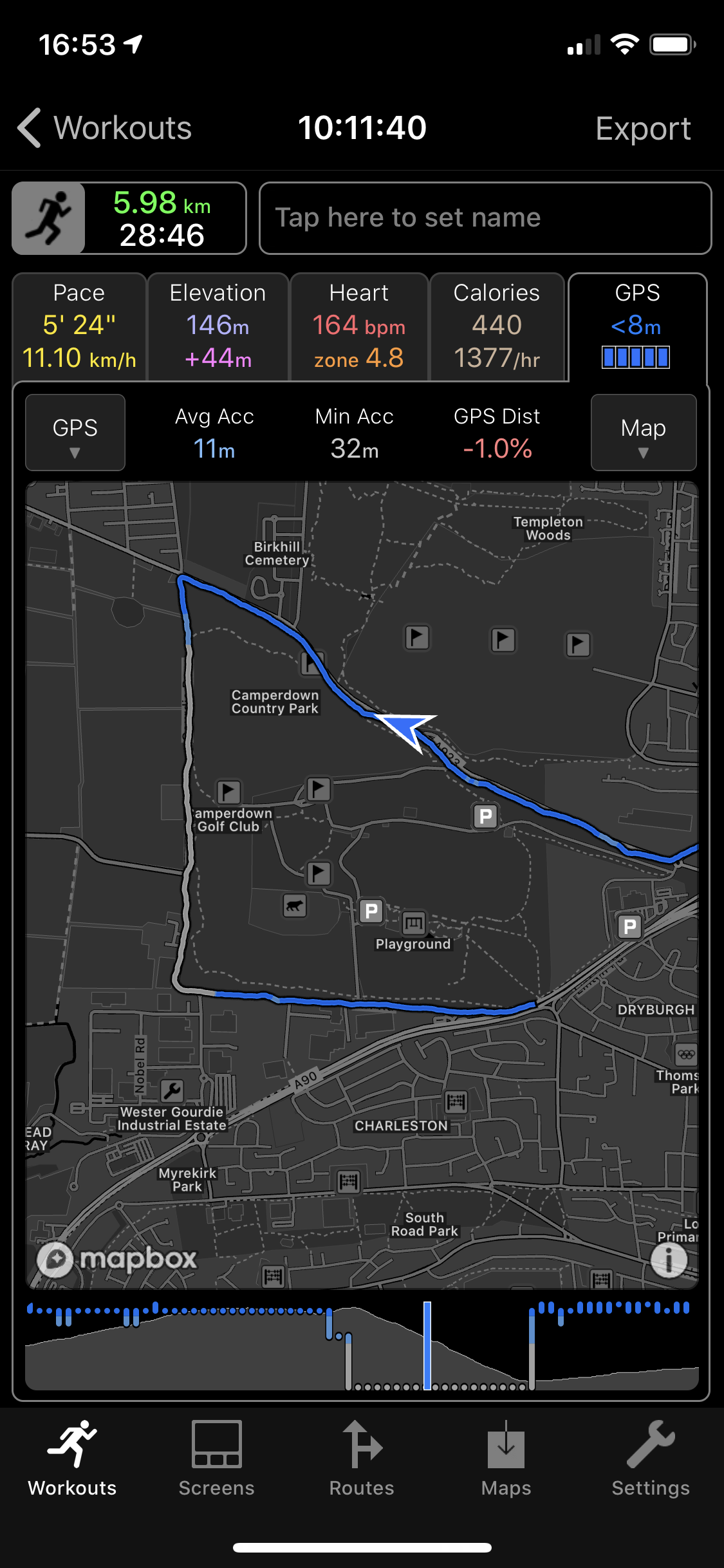

I believe I've found a bug in the iOS app. Sorry if you've already seen this, but it's pretty small anyway.
When you zoom in on a map, the elevation side view thing at the bottom zooms to the same extent, which is fine. But when you tap/slide over it, it doesn't match the map. You can see here, I'm in a section of 'grey' signal on the side view, but blue on the top down map. I think the side view tap/slide is still reacting as if the side view is fully zoomed out?
Turns out iOS13 was not disconnecting bluetooth (iOS12 was) when in airplane mode. Turning off bluetooth manually solved this.
That does look like a bug. Please email me the wkt file for the workout and I will take a look. To do this tap the Export button 3 times quickly and send to info@workoutdoors.net. Thanks!
