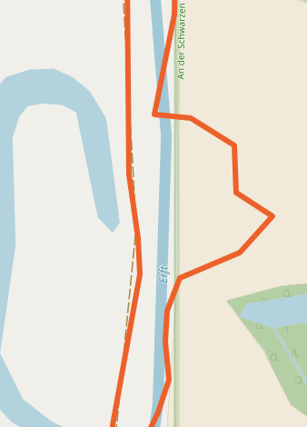

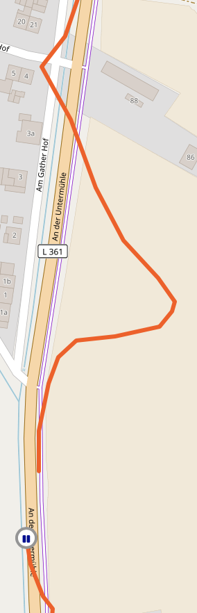

Ok, this sounds good. Hope it improves. What makes me wonder are the following very ugly recordings.
Tree cover was very light, btw. Two examples:
1) Left is my way back on the route where the track is quite good, right is the track on the first half which is very ugly:

2) I was running along a road with almost no tree cover and the track was horrible, right after I paused and resumed:

Those NME42 posted GPS tracks are not normal. If something, Apple normally smooths tracks too much, but nothing like that I have ever seen. If that doesn't change, you may have to return your AW and get a new one.
I think you only get the swooshing/over smoothing if you use the native app not with WOD/Strava etc. But no, this doesn't look right? I wear it upside down (crown bottom left), that may help. I find gps can have good days and bad, even on clear sunny weather. When I had problems with my Garmin their support said you must update the firmware at least every two weeks to get the latest satellite trajectories. It might be the case that the accuracy of a new AW needs time to -> learn your accelerometer data/build a satellite cache. And yes sometimes it can throw a wobbler when near my phone so I walk away from the house for about 100m before starting my run.
Yes, true. In Garmin speech they called this "GPS soaking". Maybe I will give this a try. Their recommended procedure was to go outside, lay it on the ground with good reception and start a run and let the watch read satellite data for about 20 minutes.
