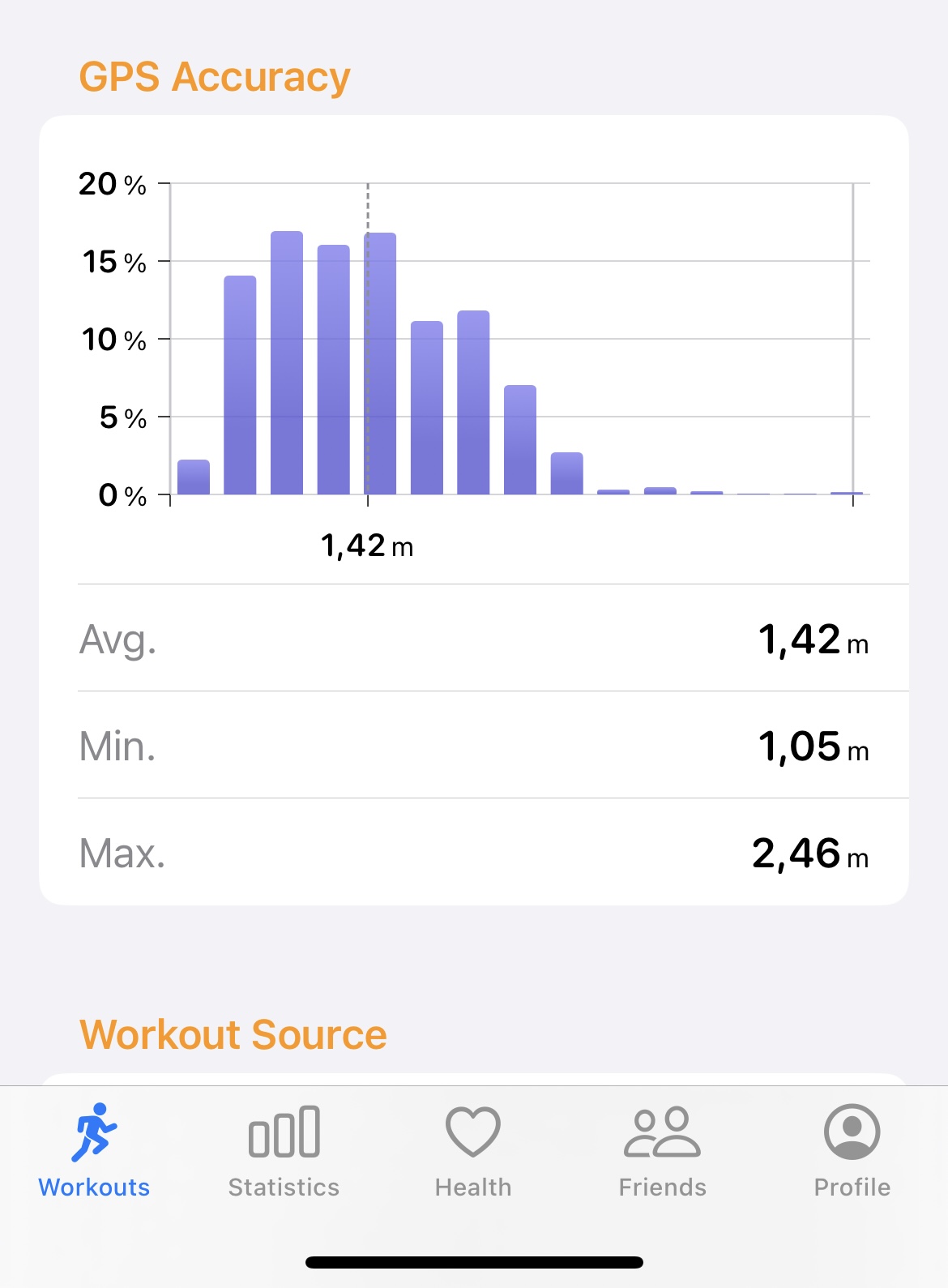

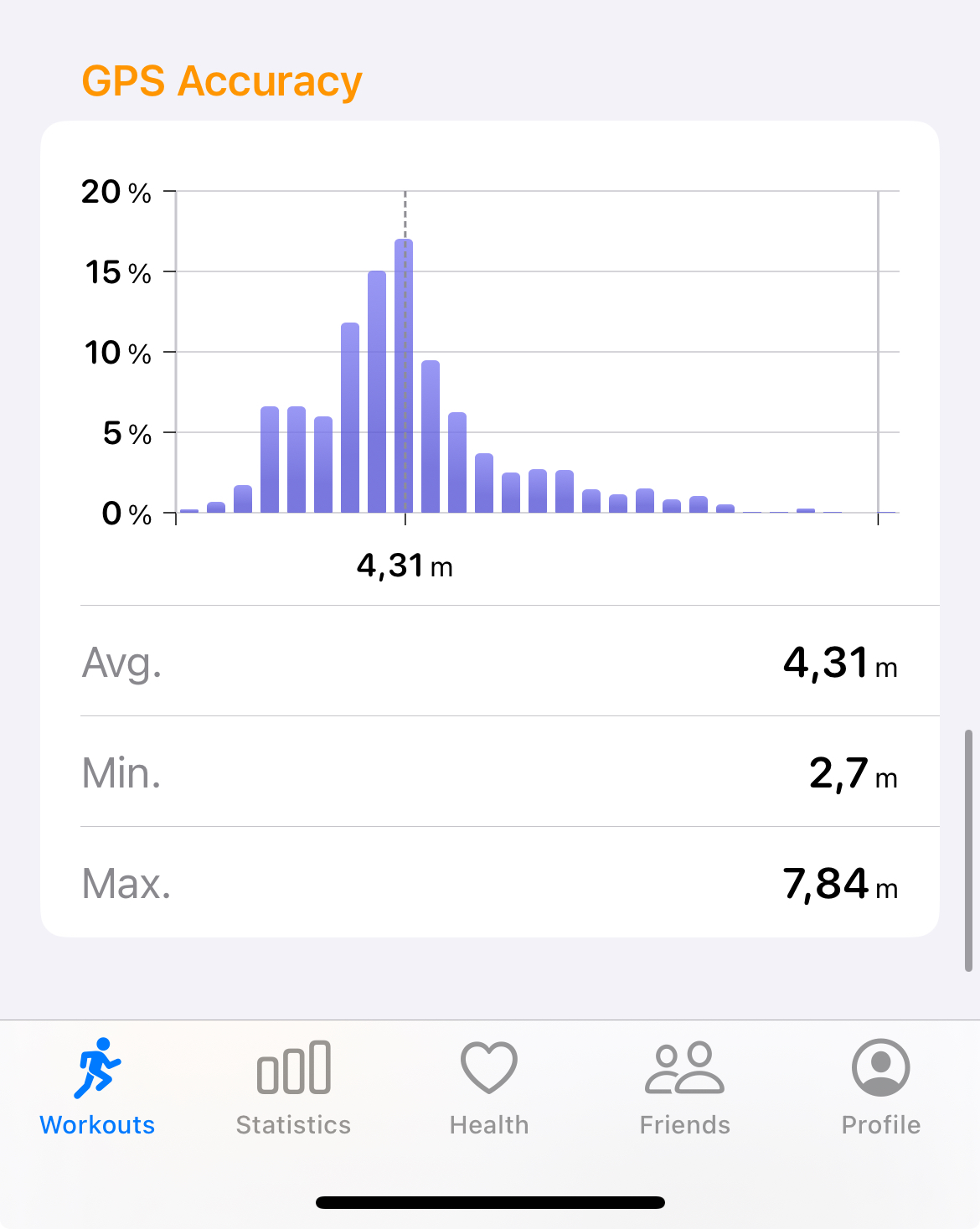

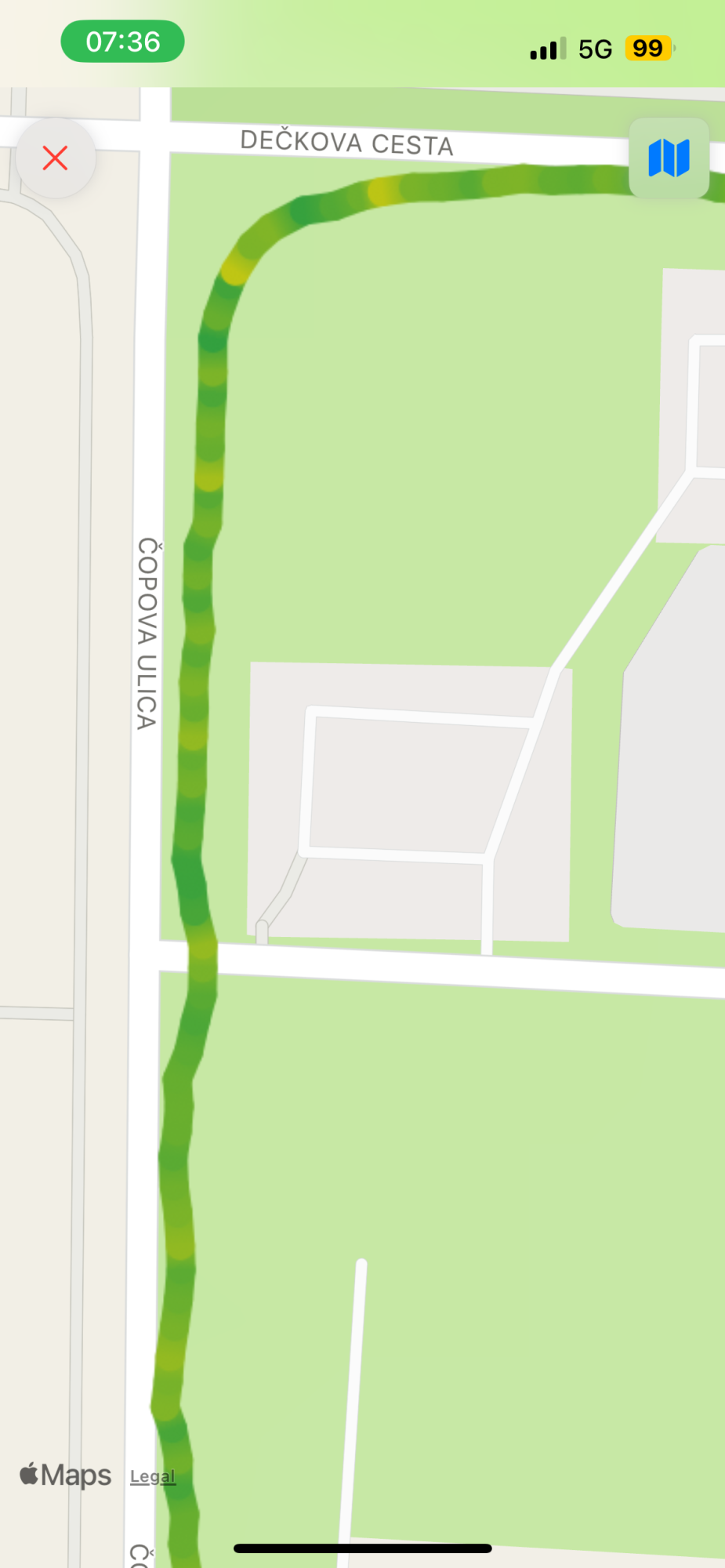

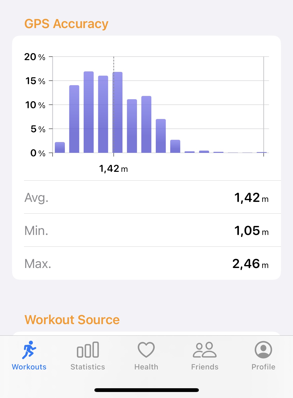

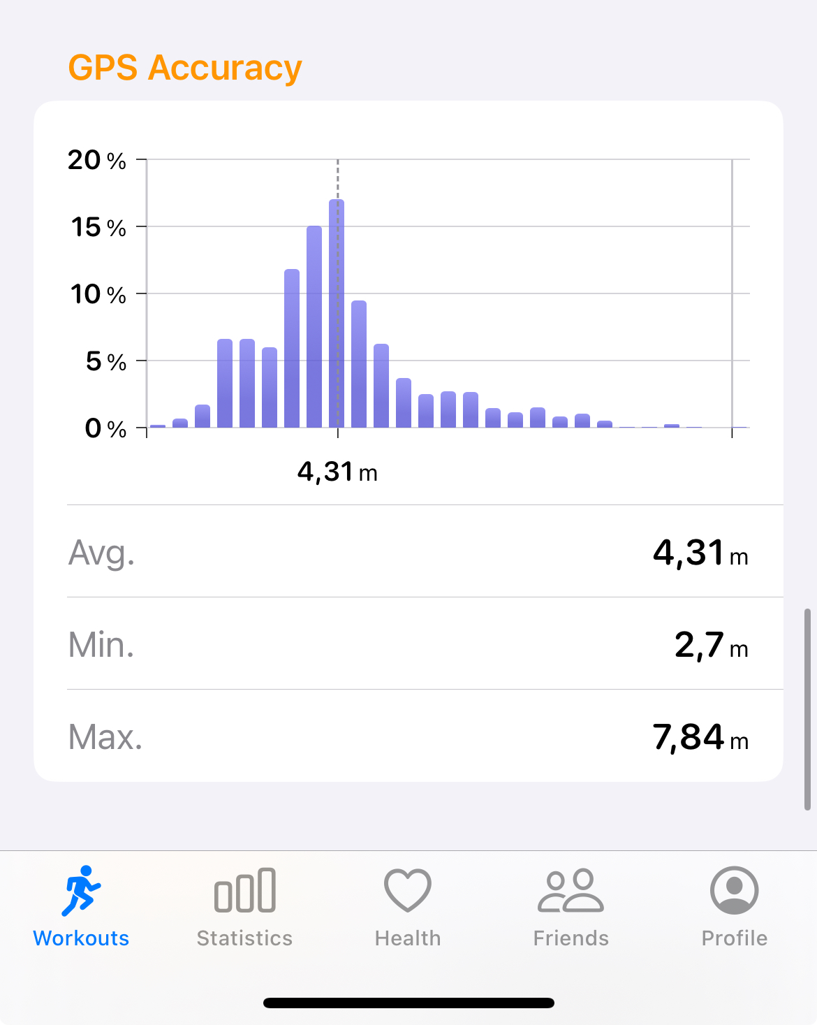

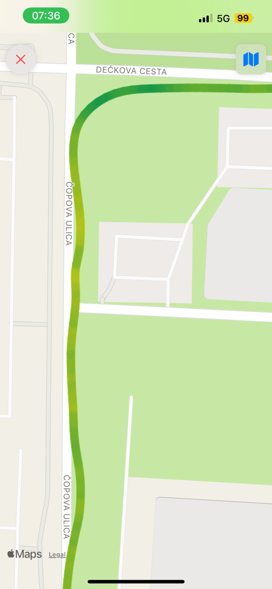

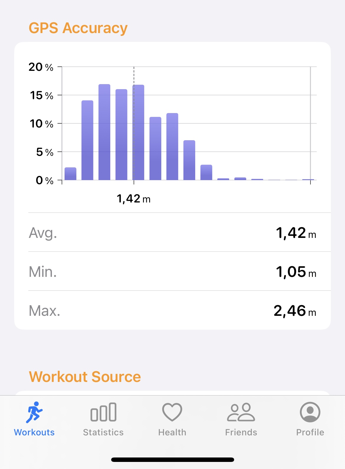

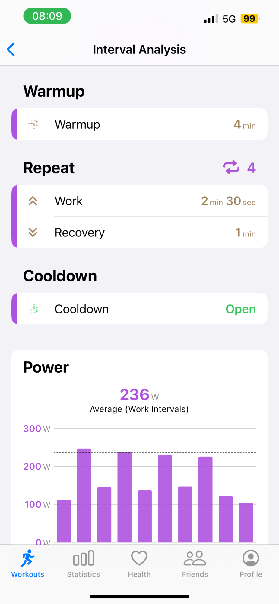

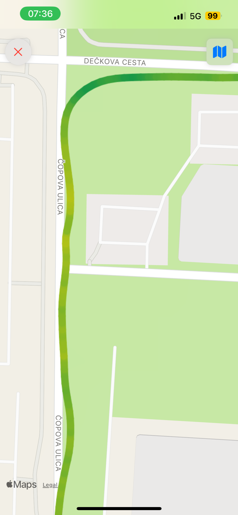

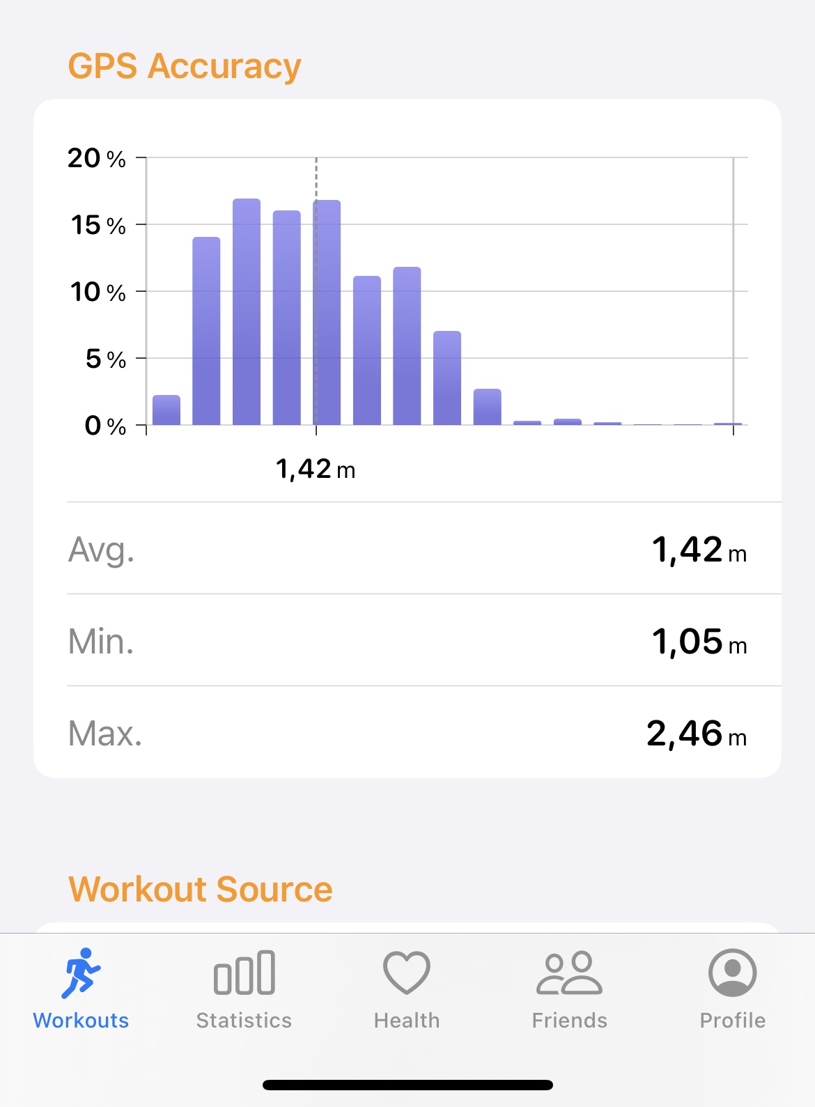

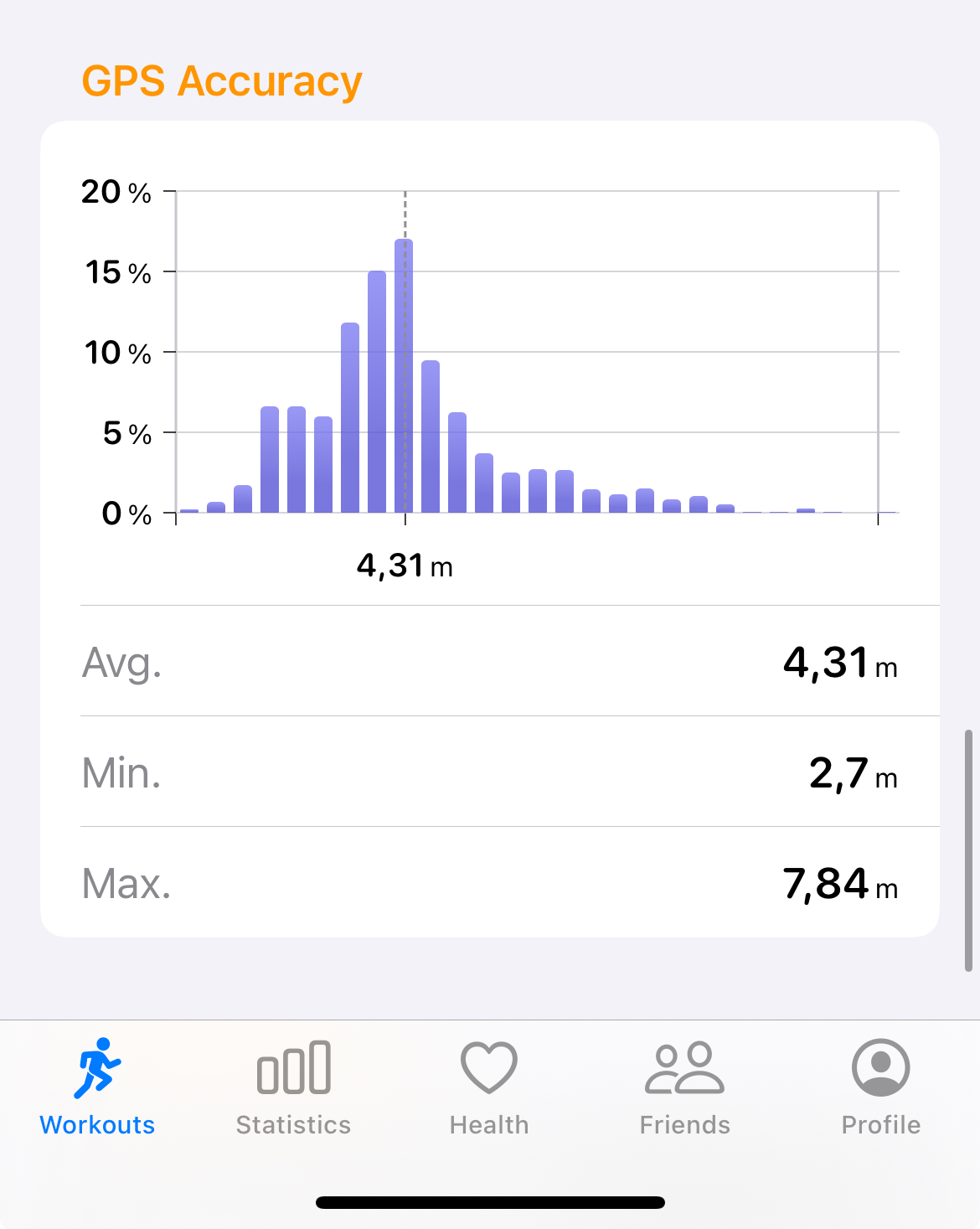

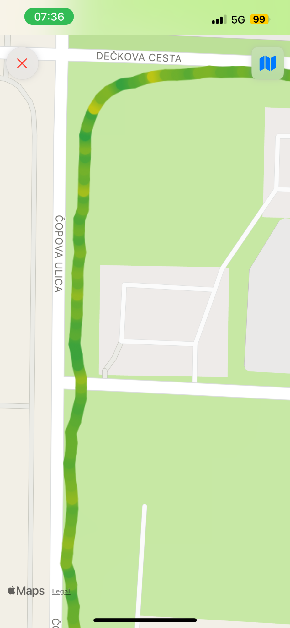

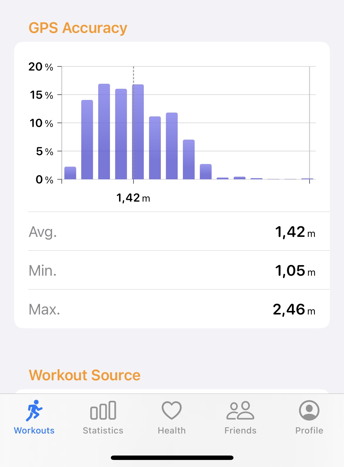

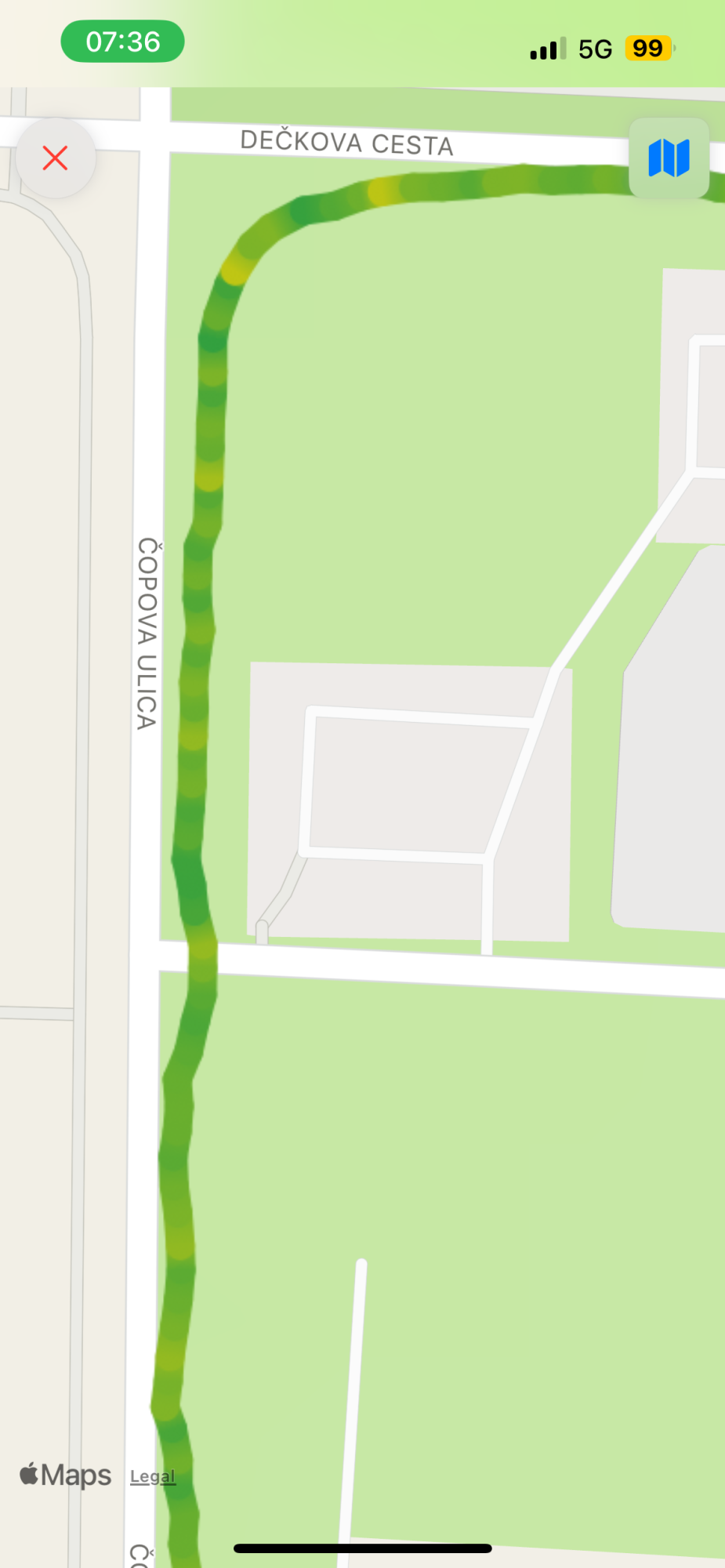

Not sure if this is the right place to ask this. I've been using WorkOutDoors for a while now, but with iOS 18 I've decided to try out the native Workout app for one run and I've noticed a couple interesting things.

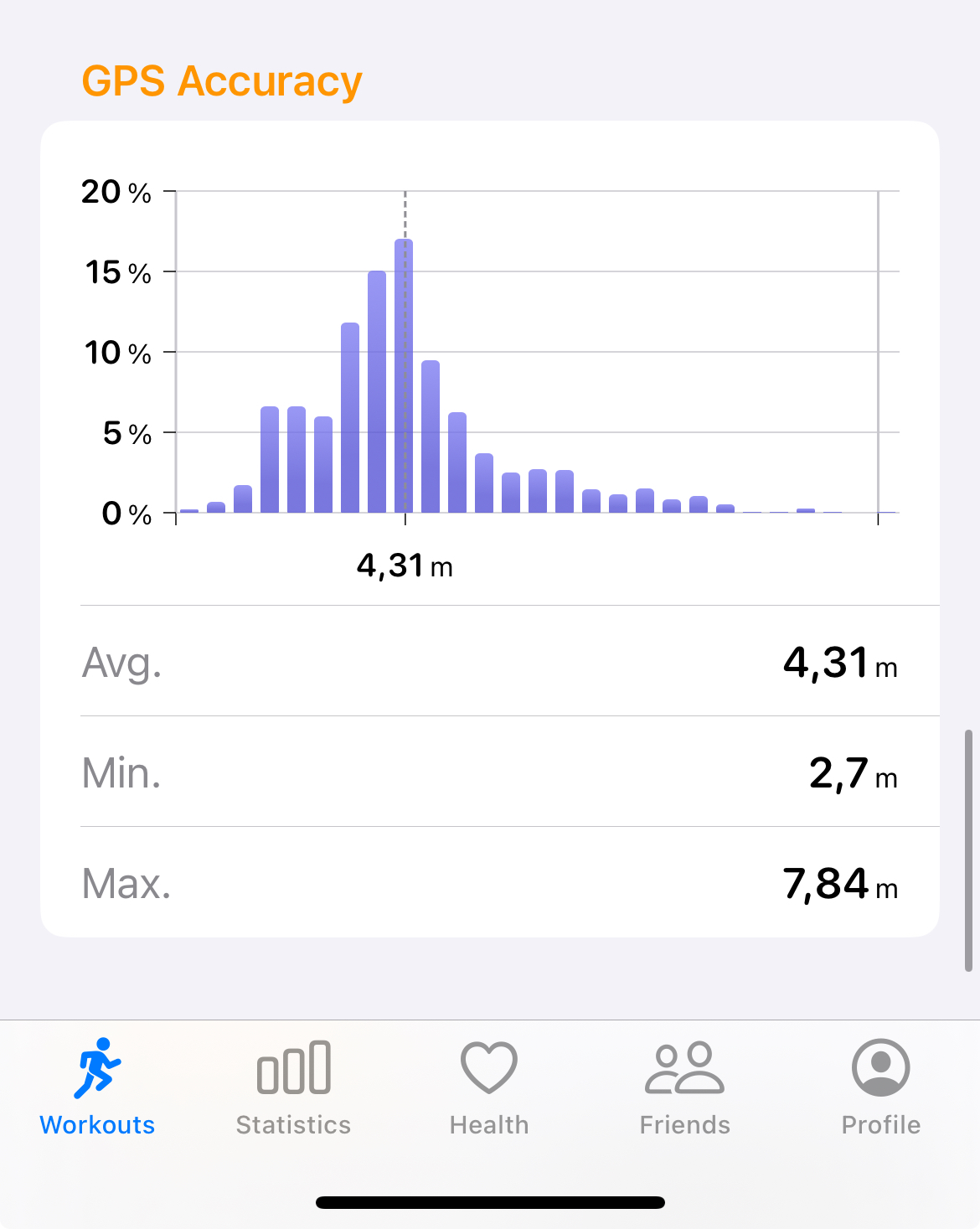

First thing I've noticed it the GPS accuracy was much better with the native app. From 1.42m avg using the native app to 4.3m using WOD. Running the same route. See the screenshots below. In WOD I have selected Apple as the source of distance & average pace. Is there something else I can do to get the accuracy of the native app with WOD?

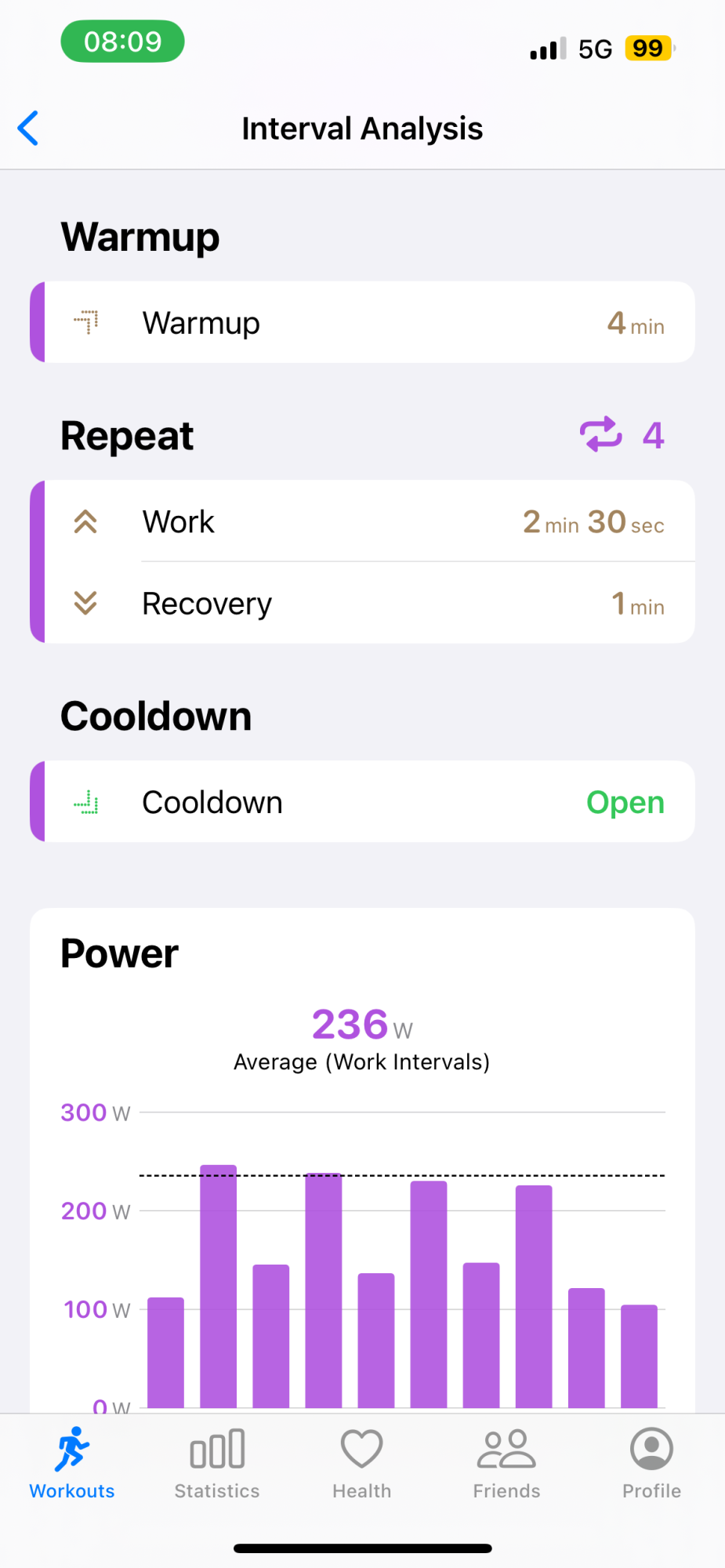

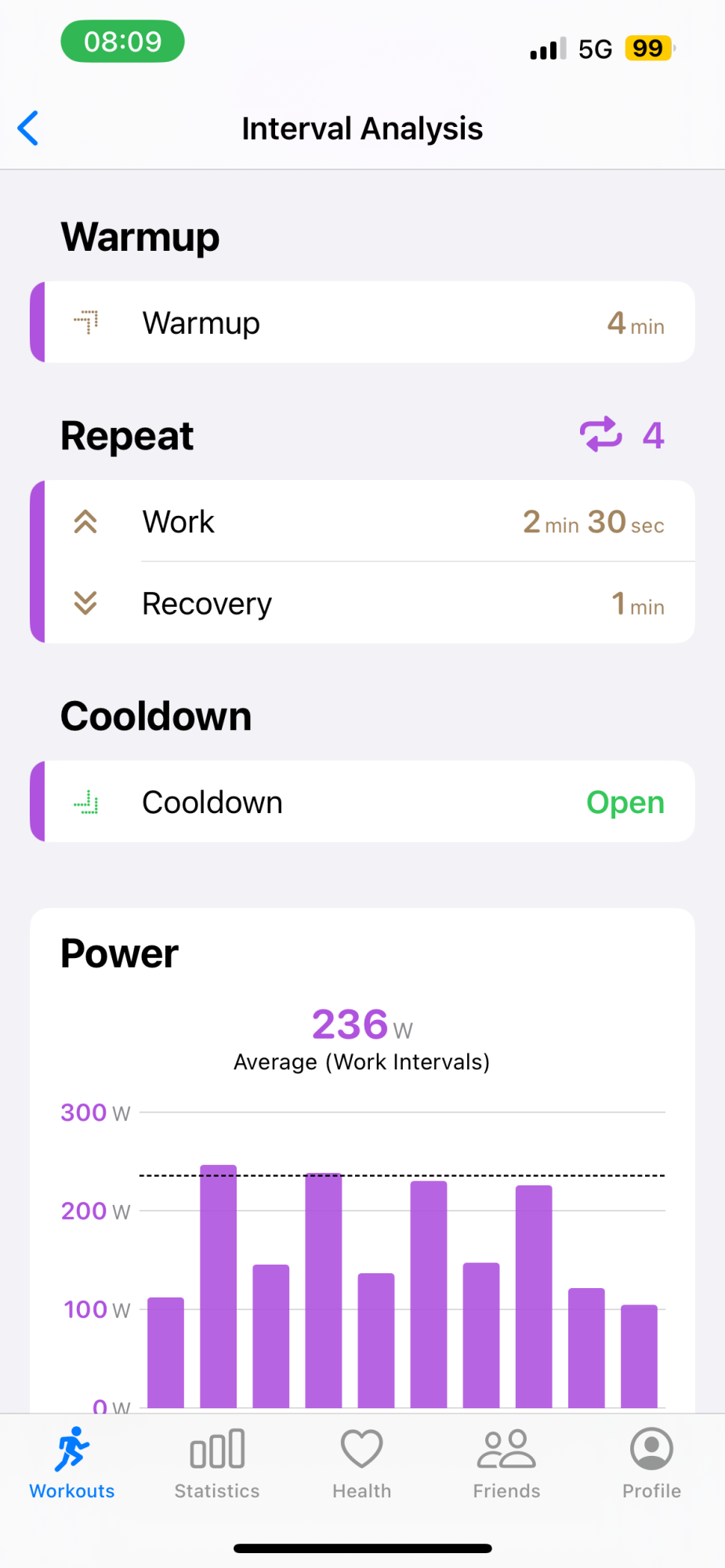

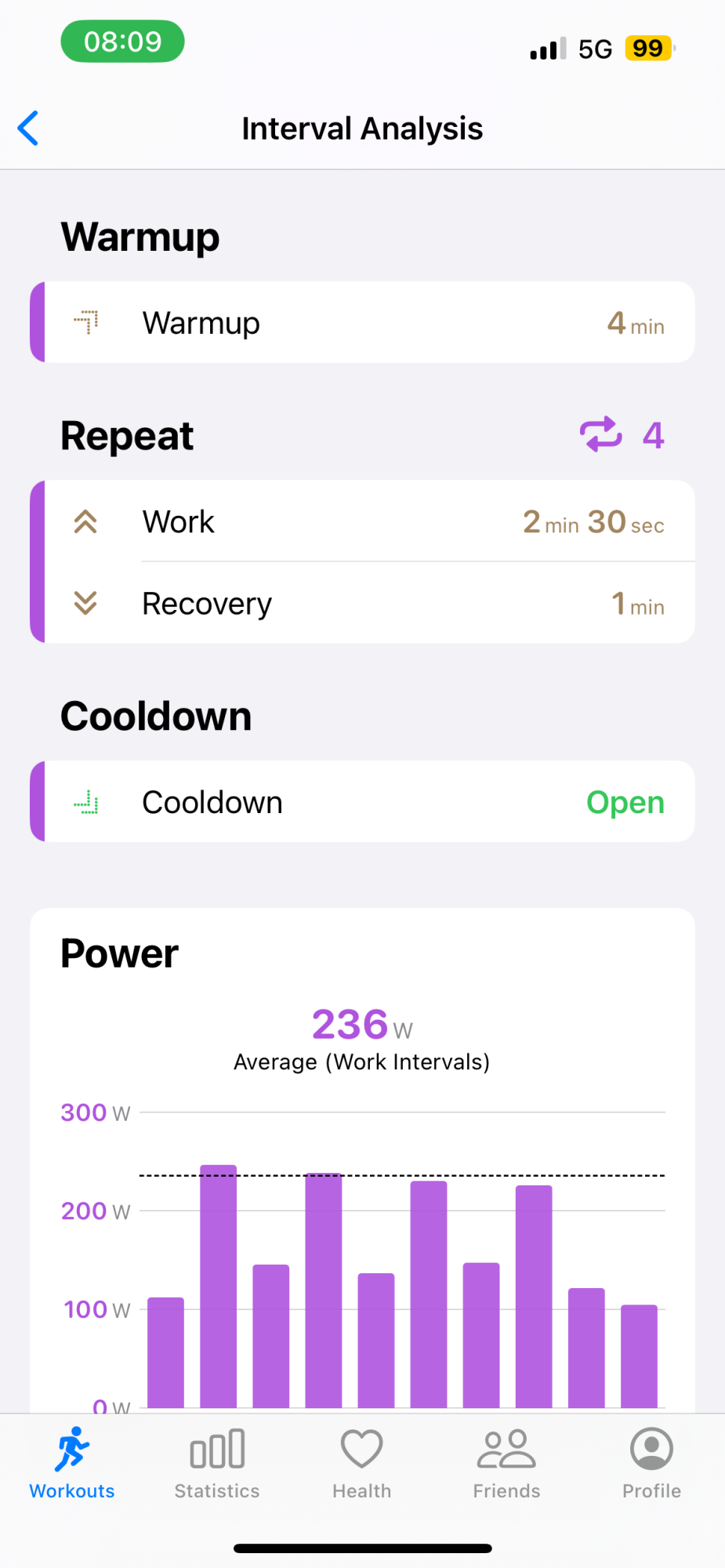

The second thing I've noticed, is that the way the native app creates intervals, it gets interpreted by HealthFit in a very nice way, showing all the different stats for each interval. While when doing it with WOD it just gives you pace info for each segment. Is there any plan for WOD to have similar data in Health app to mimic the native app?

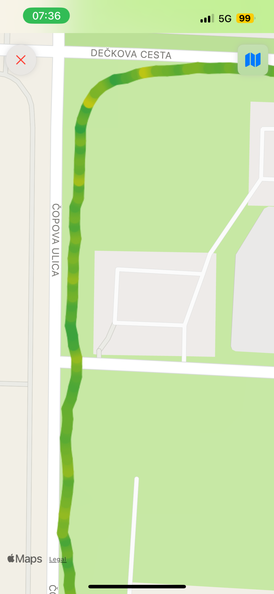

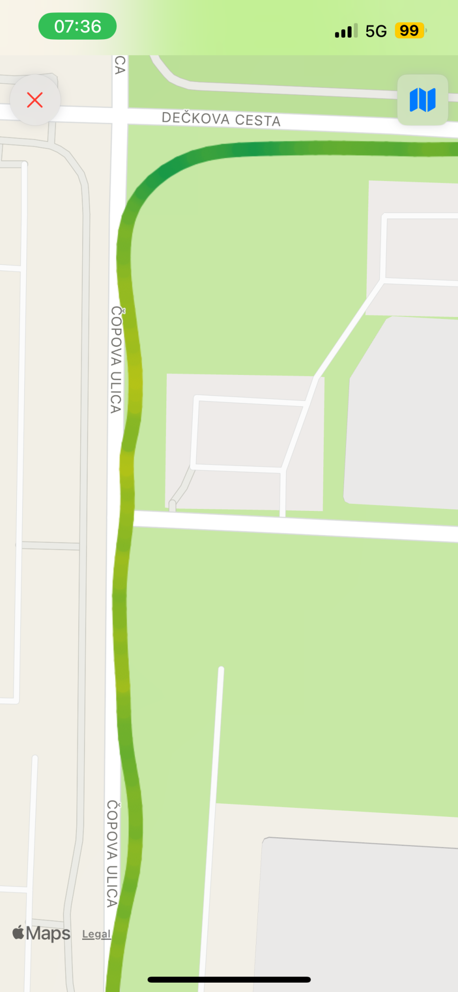

View attachment 2431585View attachment 2431587
View attachment 2431586View attachment 2431589

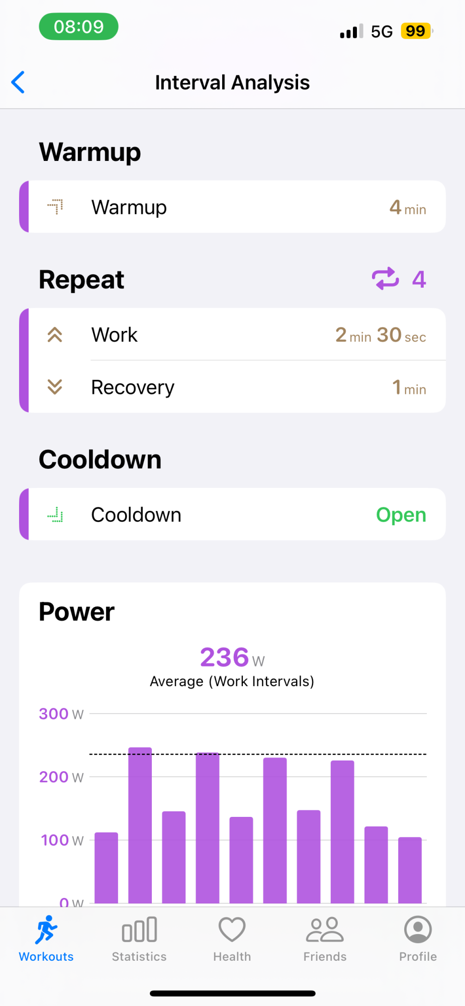

The accuracy differences are because Apple smooth the workout route after the workout, whereas WOD and other workout apps show the raw GPS positions as reported by watchOS.
When Apple do the smoothing they adjust the accuracy figures accordingly. For example if they see that a GPS position is roughly in the middle of a series of positions in a straight line then they can be more sure about its accuracy than they were when they supplied that position live during a workout and they didn't know what was coming afterwards.
This makes no difference to the statistics you see on the watch because of two reasons: firstly it happens after the workout, and secondly by default the app uses Apple's pedometer based distances. However even if you use the GPS distances there is no real difference because WOD and most analysis systems like Strava slightly smooth the data for distance calculation anyway. In fact most external systems are probably expecting raw GPS data rather than smoothed data.
Basically the smoothing makes the trail look nicer, and improves the accuracy confidence but doesn't make much practical difference. And the result is not always more accurate.
In terms of the intervals in Apple Health, unfortunately Apple added their interval functionality long after it was added to WOD so I haven't yet integrated it so that the app saves the interval data to Apple's Health system. I was actually planning to do that last week but discovered that the way that Apple offer to do that requires their latest coding language, whereas that area of WOD is mostly written in an older language.
I will probably implement it in the future but I spent most of last year rewriting the user interface of the app to use a newer language so I am in no hurry to do the same with the rest of it!
Good to hear that intervals like that will come in the future.

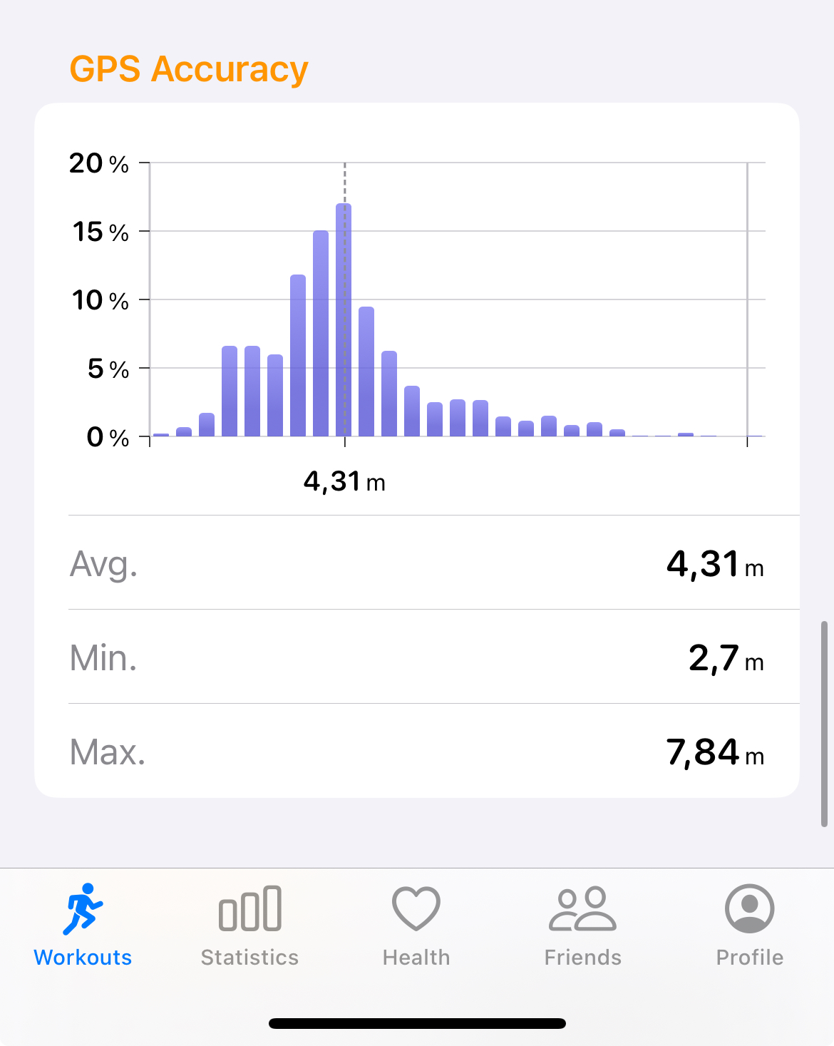

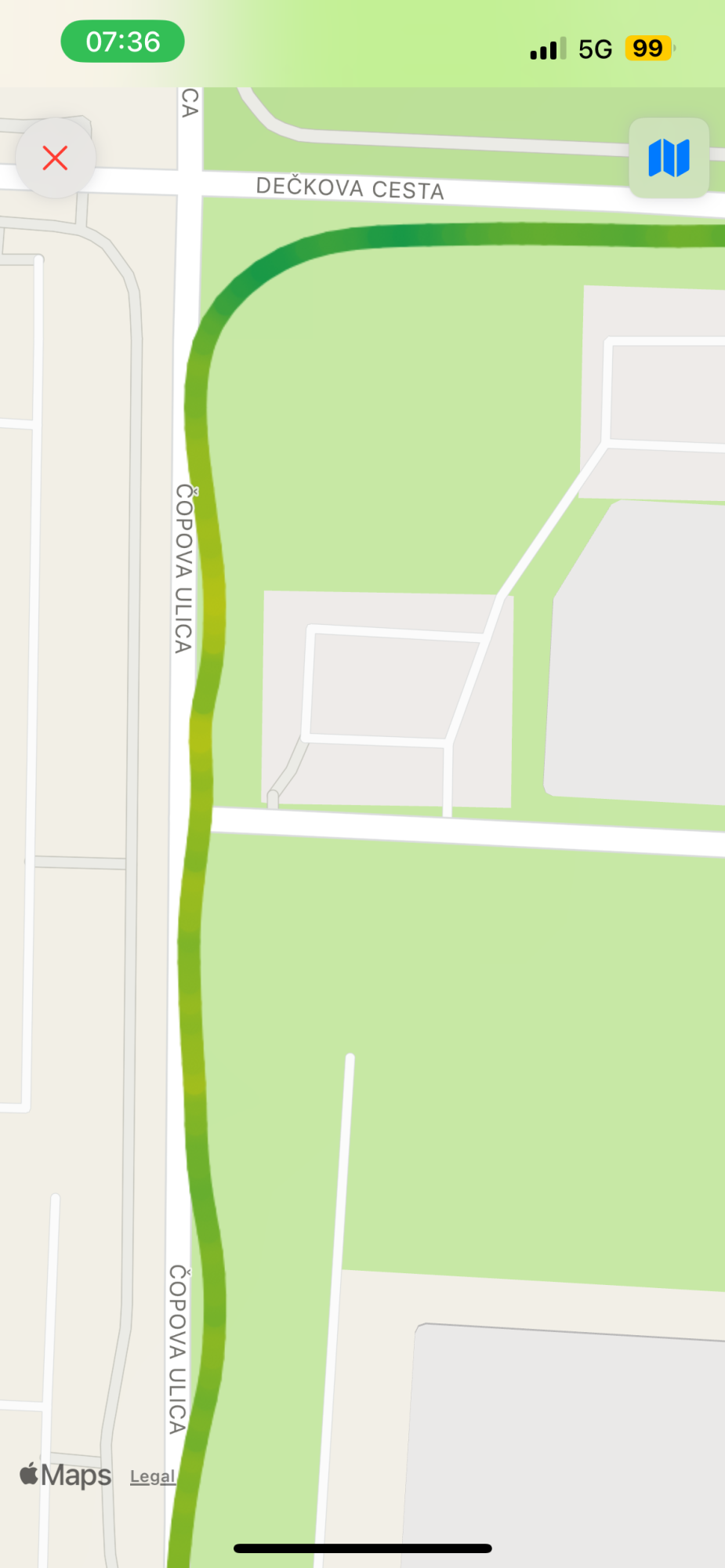

And thanks for the explanation on the GPS accuracy. It makes sense that smoothing is done after the workout is done, so its fine if data displayed on the watch is a bit different compared to after the workout. But it would be nice to have higher accuracy when the workout is done.

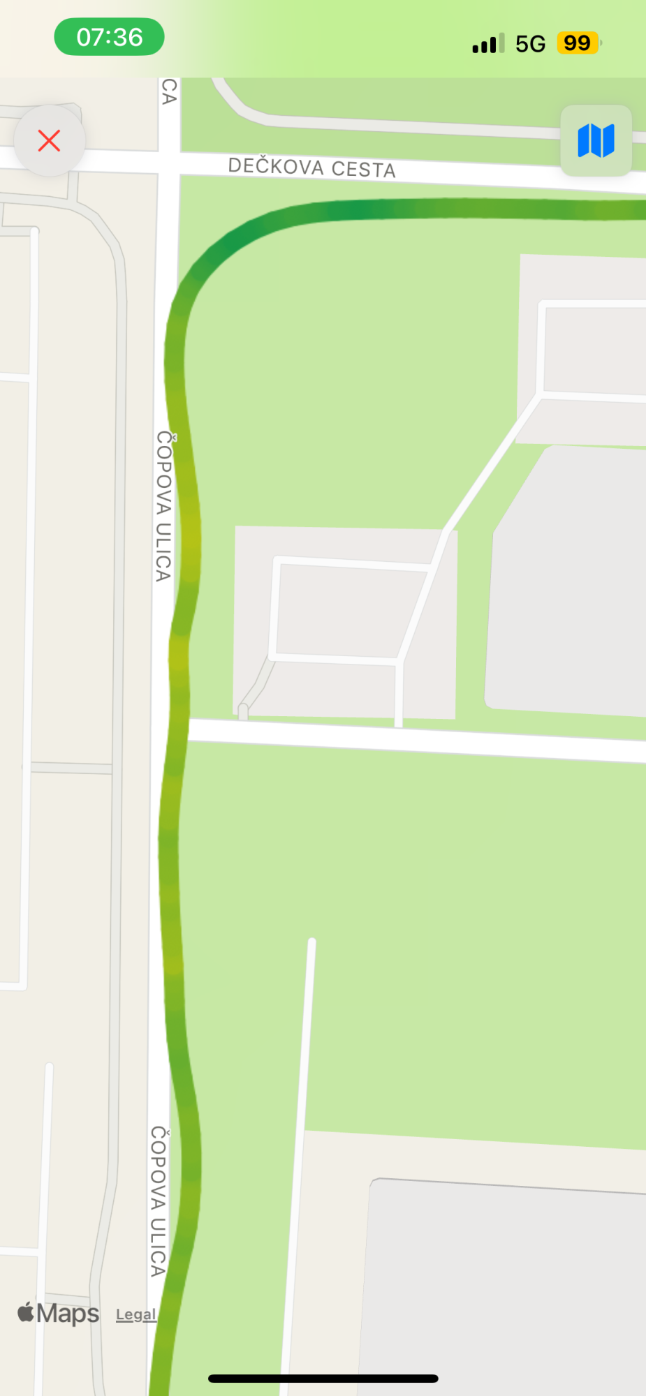

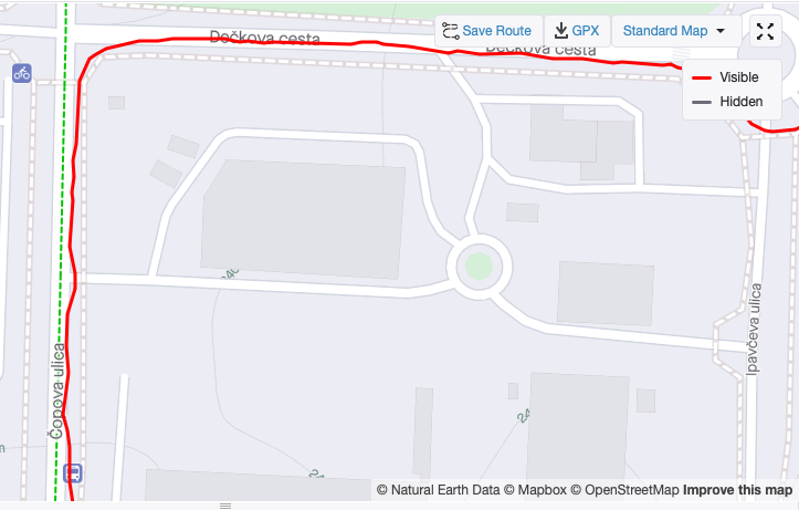

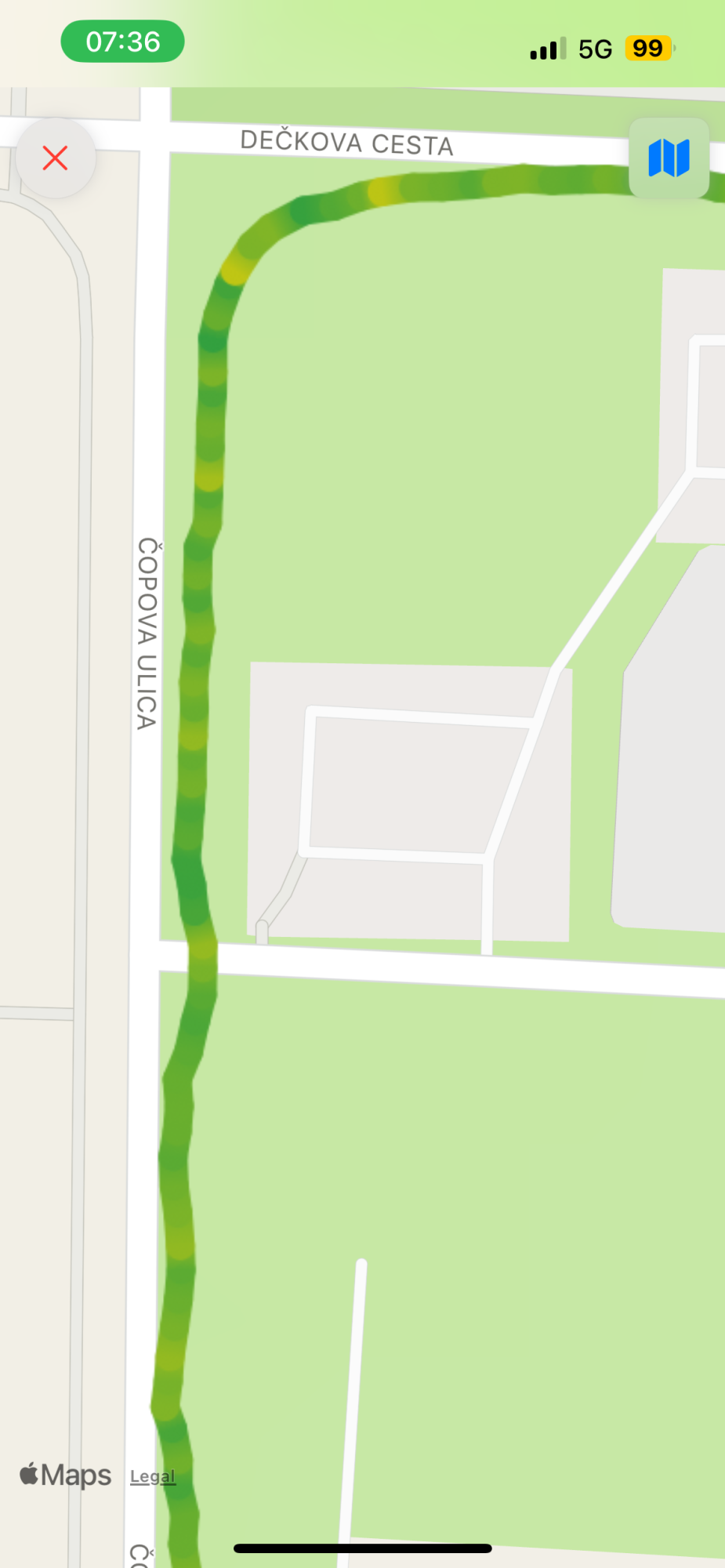

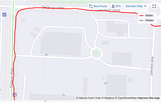

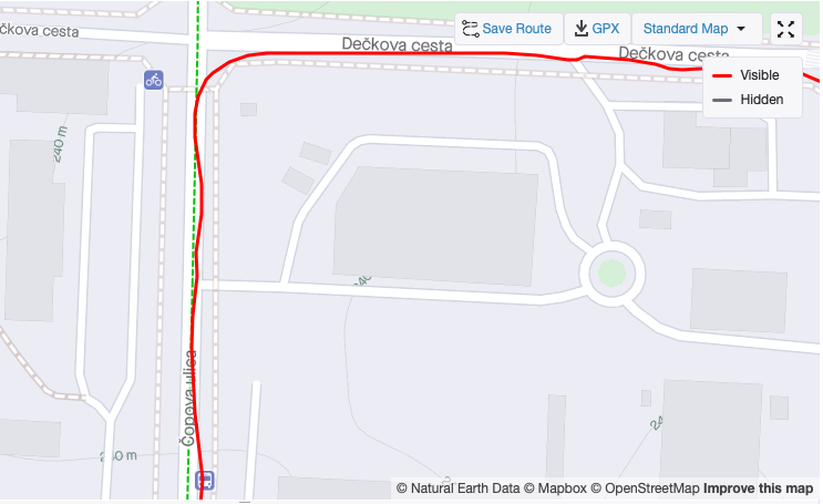

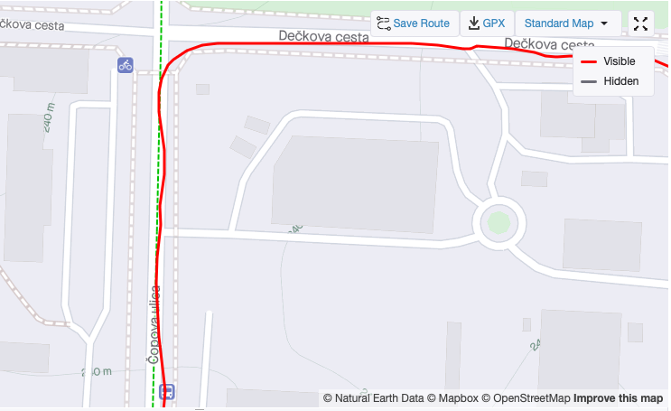

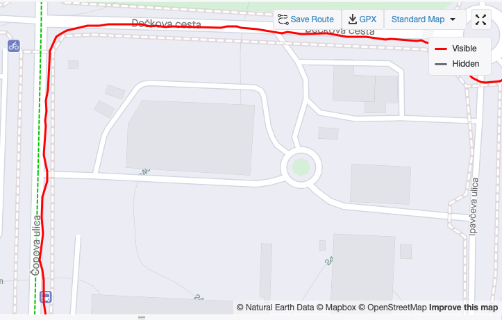

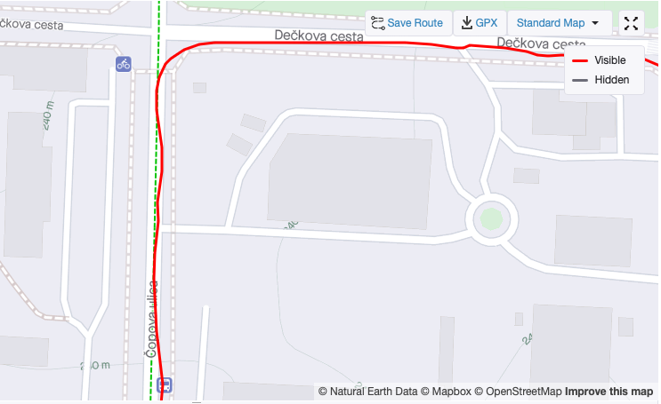

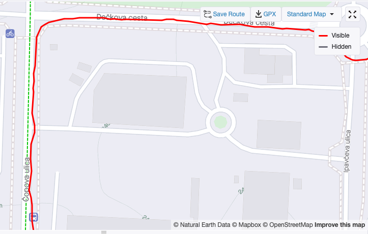

I have also checked the data on Strava to see if it smooths the data as you say, however I cannot confirm that. See screenshot below. They seem to match what HealthFit shows. I use HeathFit to sync to Strava, if that matters. Not sure how much additional distance the raw GPS data adds, but to my naked eye it seems it would not be negligible.
View attachment 2431608View attachment 2431609
I didn't mean that Strava and other systems smooth the data from a visual point of view but instead from a distance calculation point of view.
If you calculate the distance by using the simple approach of just adding up the distances of all the lines between points then it will definitely over-read because GPS points are not perfectly accurate and the resulting zig-zag trail would be longer than the real-life route taken.
So apps have to allow for that. WOD certainly does when users choose the GPS distance option, and most people find the resulting distances to be very accurate.
This is a different process to smoothing the trail from a visual point of view, which is why Strava still displays the raw positions.
