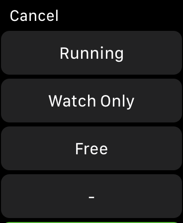

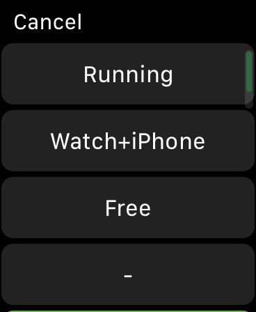

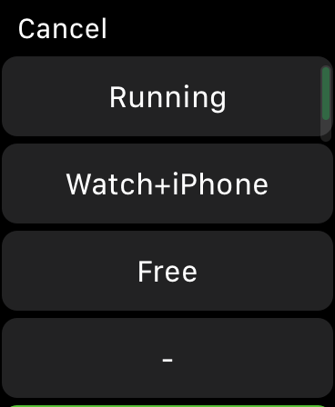

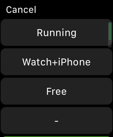

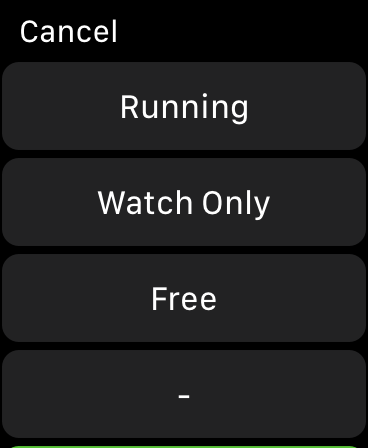

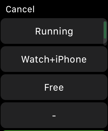

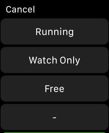

Hi @ptukhar
Where exactly is this option?
Thank you
In the watch app “start session”
I think that this option only controls whether the workout is shown on the iPhone screen as well as the Watch screen, and does not have any effect on where the GPS comes from. I could be wrong though.
Hmm - you have a good point. Thanks
