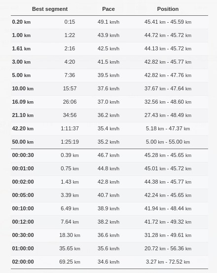

With Strava it’s only visible if it’s in the top 3 of your PR’s right? Maybe I’m looking at the wrong place or is this behind the Summit paywall?
Runalyze.com can do this.
You can easily export all your runs to runalyse with healthfit.
In an activity you have the option to view the best sub segments, see picture for an example.
https://blog.runalyze.com/features/analyze-time-series/

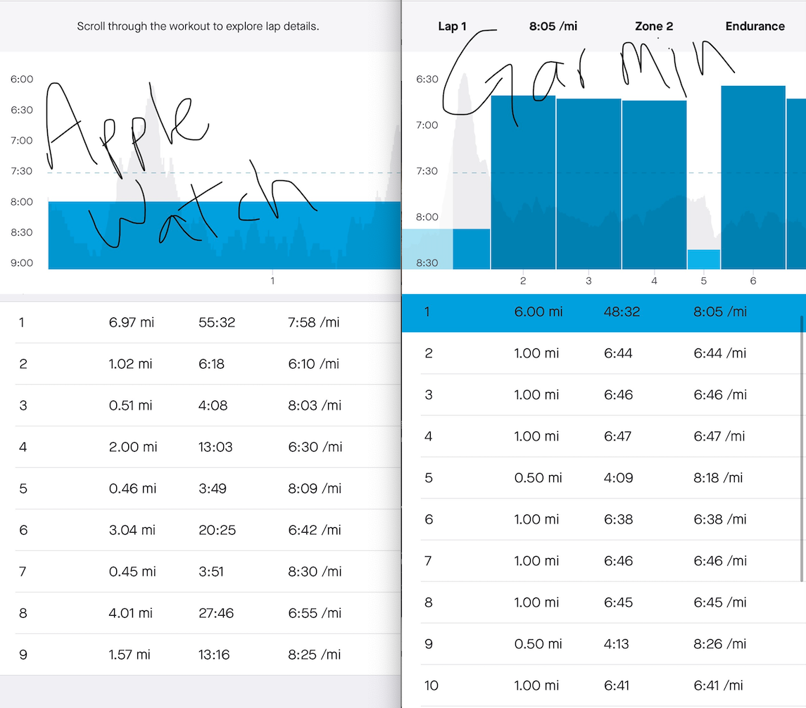

Hi all,
Long time apple watch user, but mainly wanted a watch for running. Switched to a garmin 945 for a year, but missed apple watch too much -- back with Apple Watch Series 6 now.

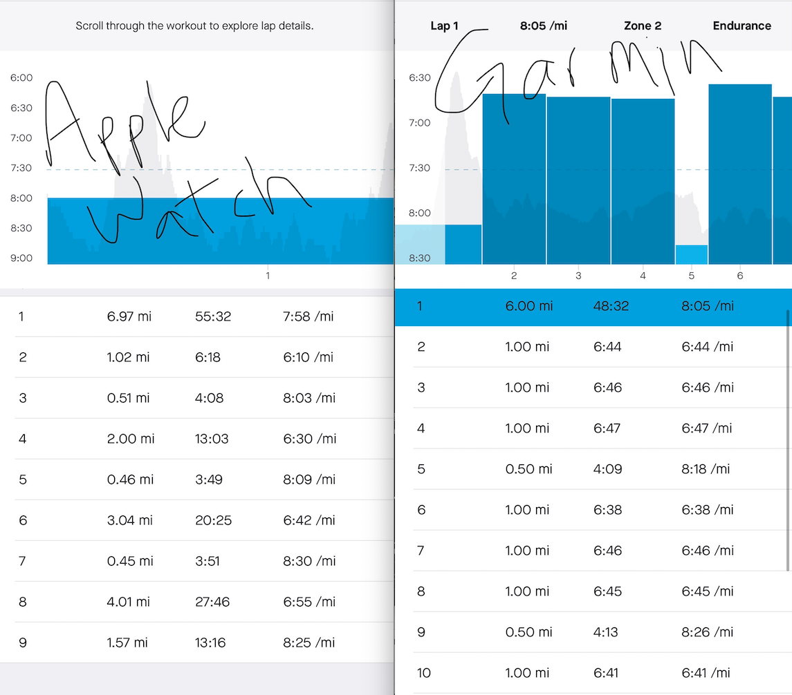

I'm trying to use the workoutdoors app and I'm wondering if anyone can help me with some interval runs. I know you can set up an interval workout, which works great. But when doing a workout without people, and watches not syncing up perfectly, it's nice to be able to manually start the next "interval/lap/segment."
Is there a way, to have it so I can manually "lap" but... it still auto laps at every mile? That's the only thing I'm missing about a garmin! I've added pictures of what my workout looks like on apple watch, and what it looks like on garmin - I want it to be like garmin!
You can see the 8th segment in the "apple watch" workout has 4 miles in it. It would be very valuable to me be able to know what the pace was for each of those miles without having to manually lap each one..
If I'm over complicating, let me know!
@cfc any thoughts?
Hi all,
@cfc any thoughts!?
Hi all,
@cfc any thoughts?
Sorry - I am a bit confused. Are you saying that you want laps within an interval, or that you want to manually start a lap and then future laps happen automatically after that?
Some background which may help: Previously the app allowed both laps and intervals to be manually controlled, but this confused downstream systems which only handled one way of manually splitting a workout. So I removed the ability to manually start a lap, and this made it consistent with Apple's app.
So now laps are always of a constant length (splits) and you should use intervals to manually split a workout. This can be done either manually during a workout (by using the New Interval command) or by using a custom interval schedule. Or both.
This means that what you want is only possible by using intervals. If you want repeating 1 mile intervals but with some that are truncated then set up an interval schedule with a repeating 1 mile interval and then use the New Interval command when you want to start a new interval early. It is probably best to set up a shortcut to the command, such as double tapping the screen or using both side buttons.
I hope that helps?

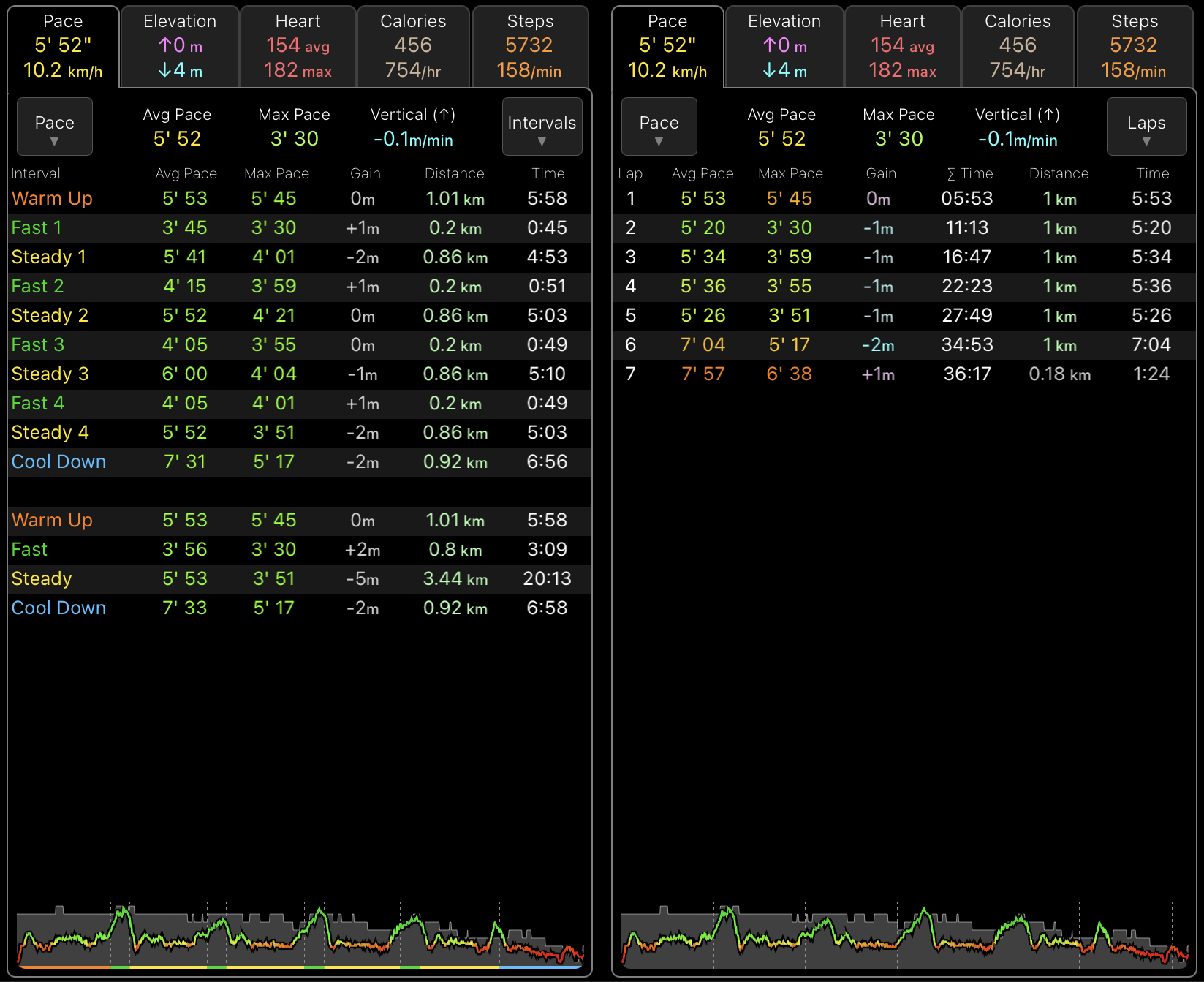

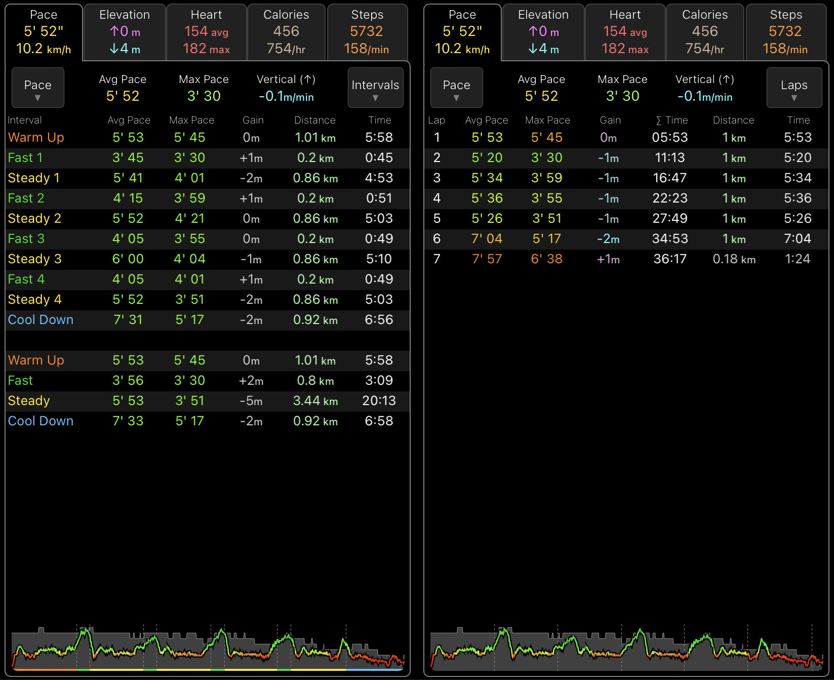

Maybe it's this you're looking for (?): WorkOutDoors differentiates between intervals and laps so you can see both for the same run.
Reactions: cfc
That’s an interval workout you set up in advance right?
Yes, but it's the same when you start an open workout with new interval button, just the names of the intervals are different (the screenshots are not of an actual run - that's why the data makes no sense).
