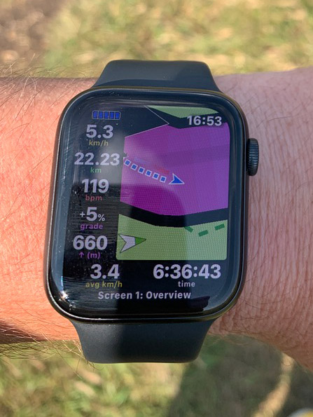

Hi there,
WOD is a great app but I want to discuss some issues that I encounter often.
I'm posting this discussion here so we can help more people if they have the same issues.
  1. Big Trace (path). When I load a pre-drawn route, quite often I see part of it very large and this interferes with the orientation for directions, as well as hides the objects below it, because it takes up an unnaturally large area of the map. See the photo for an example. If you have a solution to the problem I will be happy to discuss it.
  2. Send map on watch. After uploading a route on the watch, I want to upload the map as well. When I hit “Send Map” usually there are 15 objects (for example) to transfer. Very often he transfer few of them and the others not. I try to select the map area manually, but very often this does not work either. Sometimes when I try more time on the roll (10 for example) It works.
  3. Elevation not shown on SportsTracker. I know this is not directly related to you but if we find a solution to this problem it would be great. When I export workout from WOD app in GPX file, and then import it to SportsTracker app. I can’t see the elevations. I see the elevation graphic, but the ascent and descent altitude number is 0. The same file in strava show elevations correct.
  4. Split 2 workouts in one. Sometimes during a workout the battery drops, the clock restarts or for other reasons I have to interrupt a long hike for example. And right after that I play it again. These are 2 separate ones in workouts. Is there any way to split them in one workout.
  5. Used equipment in each workout. I have seen other requests here on this one. Strava have this one. What kind of sneakers am I wearing, for example, and automatic calculation of the distance traveled with them
  6. Delete a route from the watch that has already been deleted from the phone. I deleted the route first from the phone that remained in my watch. How to delete it from the watch.
  7. Next update. What to expect with the new update and when?
Regards
erone

  1. This is a rare but very long term bug that people occasionally report but which I have never seen myself. It is interesting that you get it often because it is so rare. My plan is to investigate when I rewrite the route functionality in the version after next.
  2. When the phone to watch communications are struggling then the best thing to try is to reboot both devices.
  3. If the GPX file exported by WOD contains elevations then there isn’t much the app can do. The files are just text, so it is easy to check if the elevations are present.
  4. You cannot merge workouts in the app but you can export them as GPX or TCX files and there are a few places online that allow you to merge such files. You could then upload the result to Strava. I may allow merging (and trimming) in the future.
  5. My opinion is that Apple should offer gear tracking, so that it is tracked across all workout apps. Some people use WOD when they want navigation and other apps (e.g. Stryd) when they want other functionality, so such tracking within one app would be pointless to them. Having said that gear tracking is so frequently requested that I will probably add it. In the meantime you could tag each workout by including the shoe name in the workout name. You can then use the icon in the top right of the Workouts tab to filter workouts by name and then group by something to show totals for each tag.
  6. The next version of the app will have the ability to remove a route from the watch app rather than just being able to do it from the iPhone app.
  7. The next version will probably be available in a couple of months, with a beta available in a few weeks. It will have lots of improvements with sensor support and topo maps being the headline features. Sorry that it is taking a while: this is mainly because I have extended sensor support from just Stryd to also include many other sensor types.
