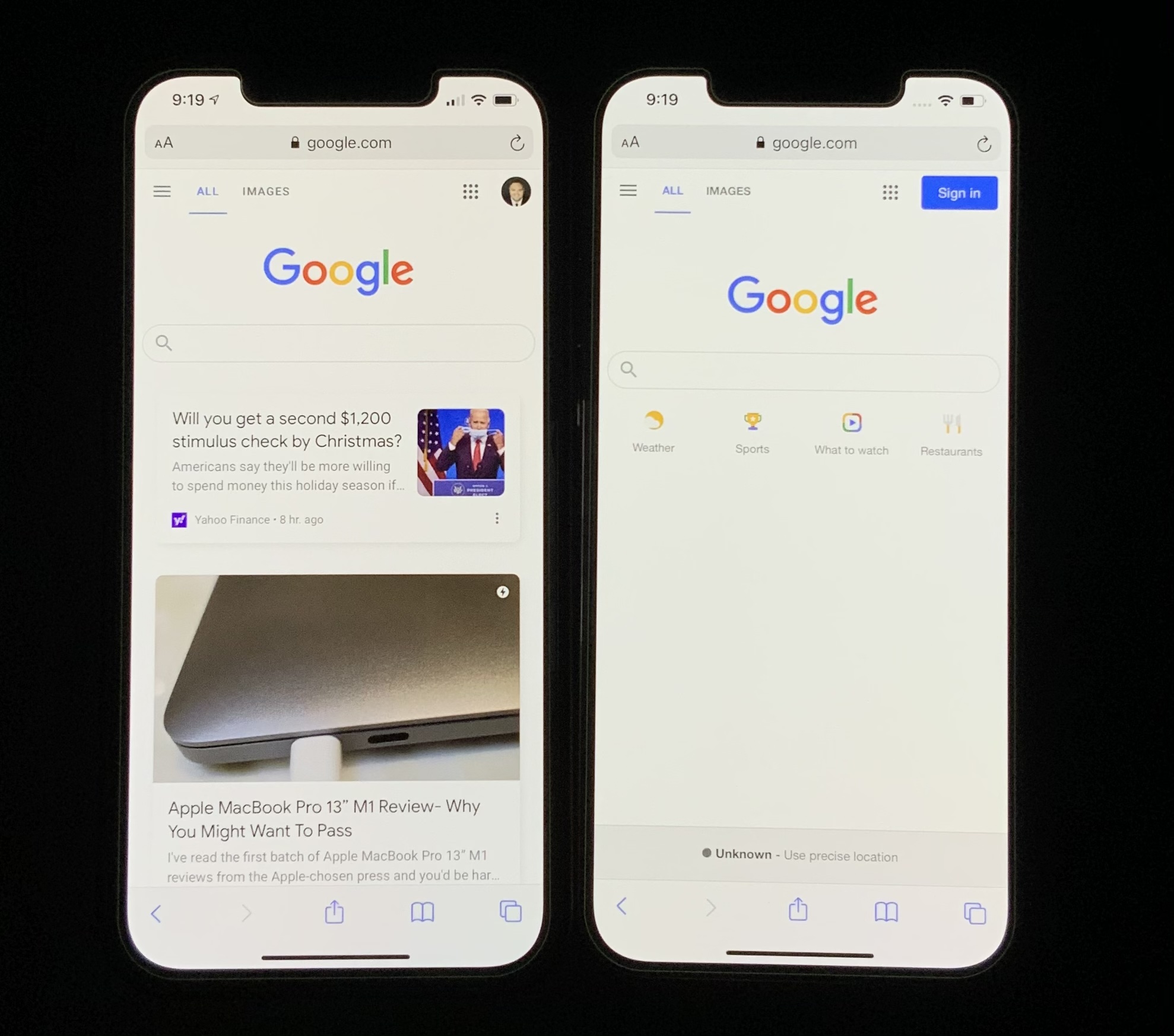

Both 256gb iPhone 12 Pro Max. Which one do you think looks better?
The one on the right looks less yellow but the text on both are dull and not sharp like they should be.
Sharpness is due to using my iPad Pro to take the photos. It’s sharp on both. The screen on the silver one is 99.9% perfect. I like the graphite color better but the screen is more yellow, and not nearly as bright as the silver. Probably going to exchange the graphite one hoping for a better panel.
Pictures like this are pointless unless you've manually set your camera's white balance to a specific temperature. Preferably 6500k. Maybe you've done this but you should say.
Sure the one on the right looks better, but how do we know if your camera metered/adjusted for one display's white over the other?
