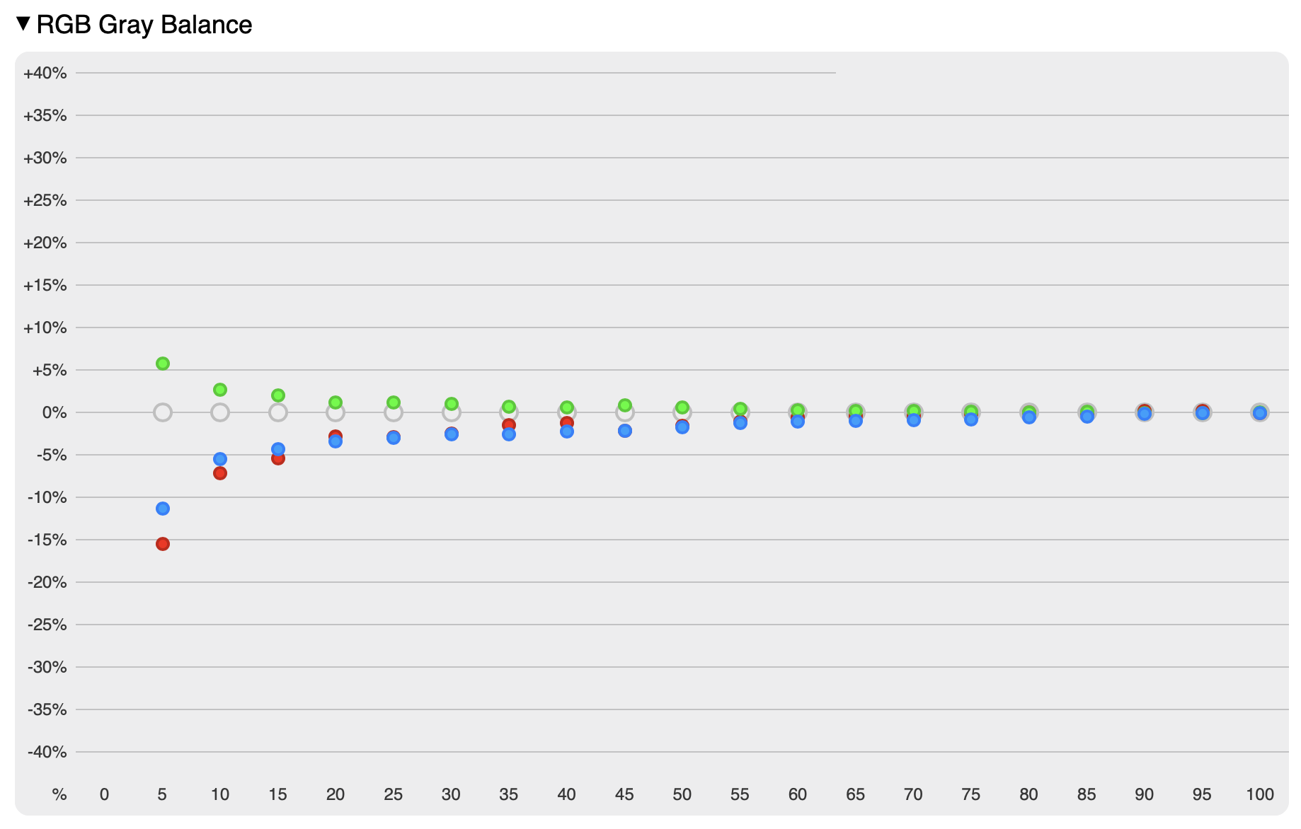

Yes, the color temperature and color accuracy are good, and it's not too warm, but there is a green tint to everything, which is measurable by looking at an RGB balance chart:
What I find most interesting in this graph is not the green being slightly higher than normal, it is the red and blue significantly lower than they should be at lower brightness. The lack of red and blue highlights the green.

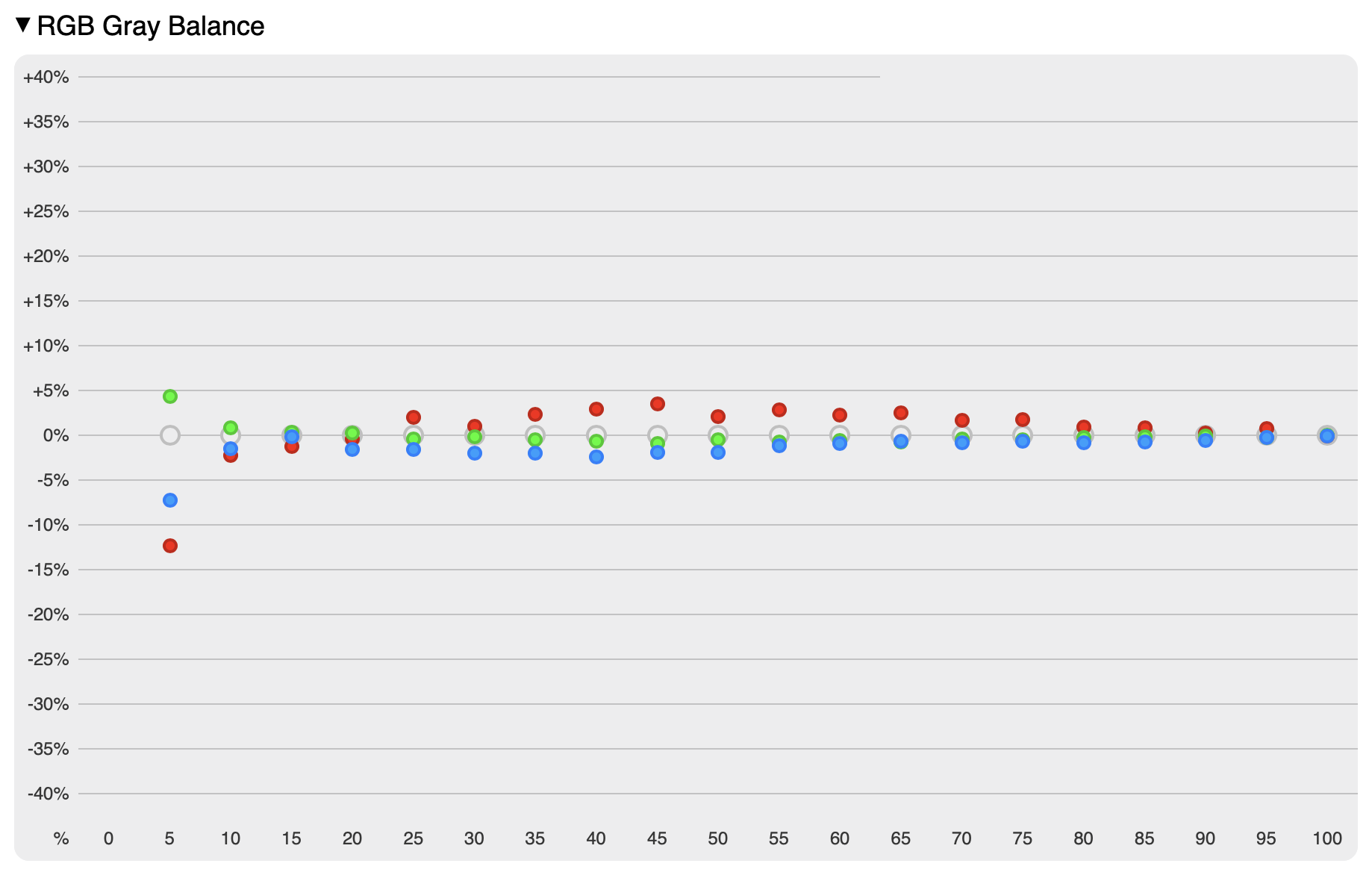

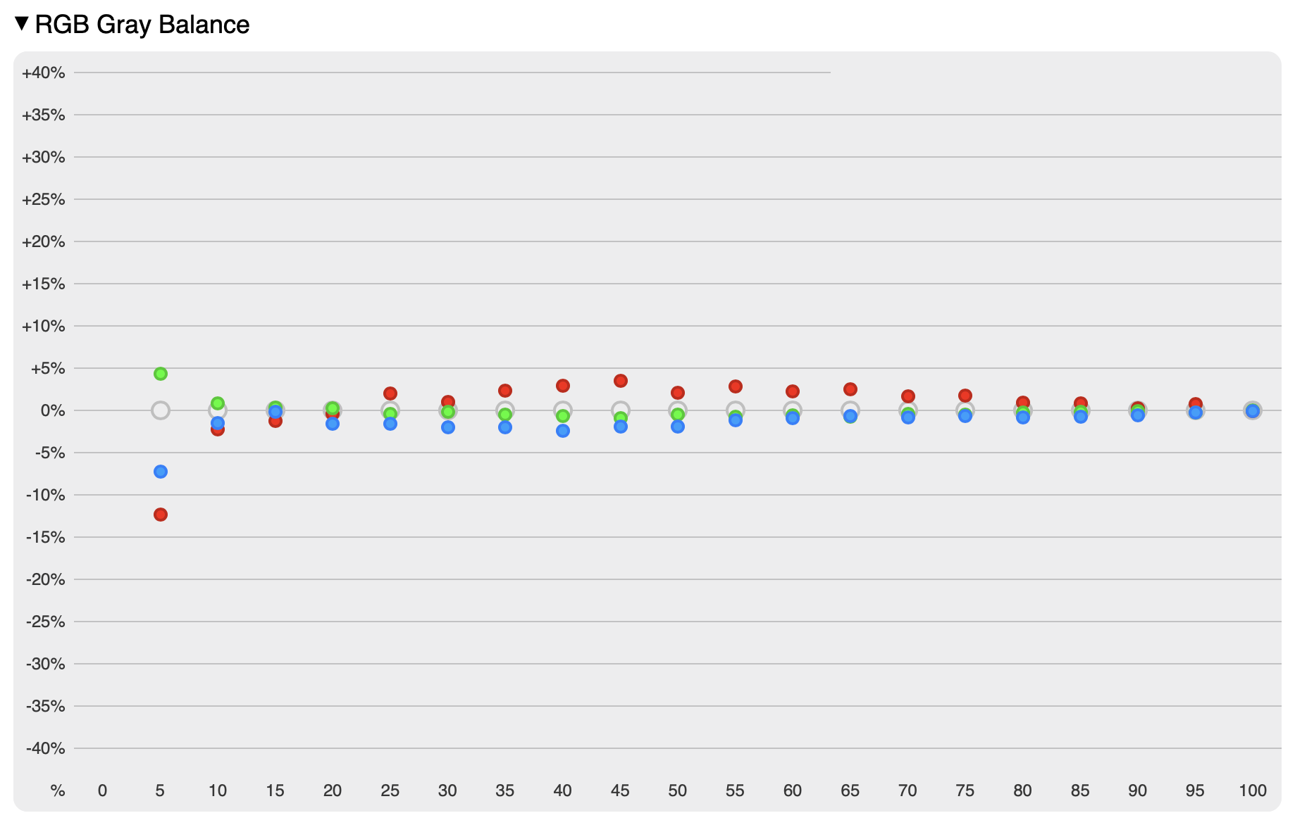

gtg465x, if you run the test on your iPhone X what does it look like?

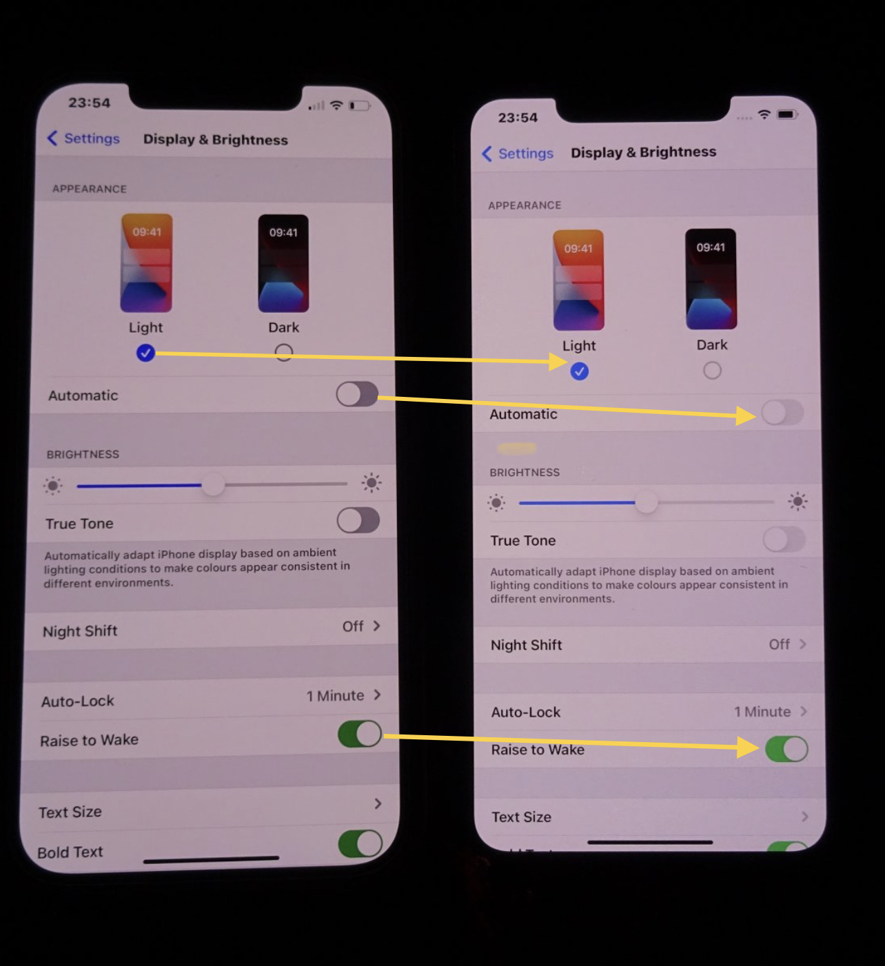

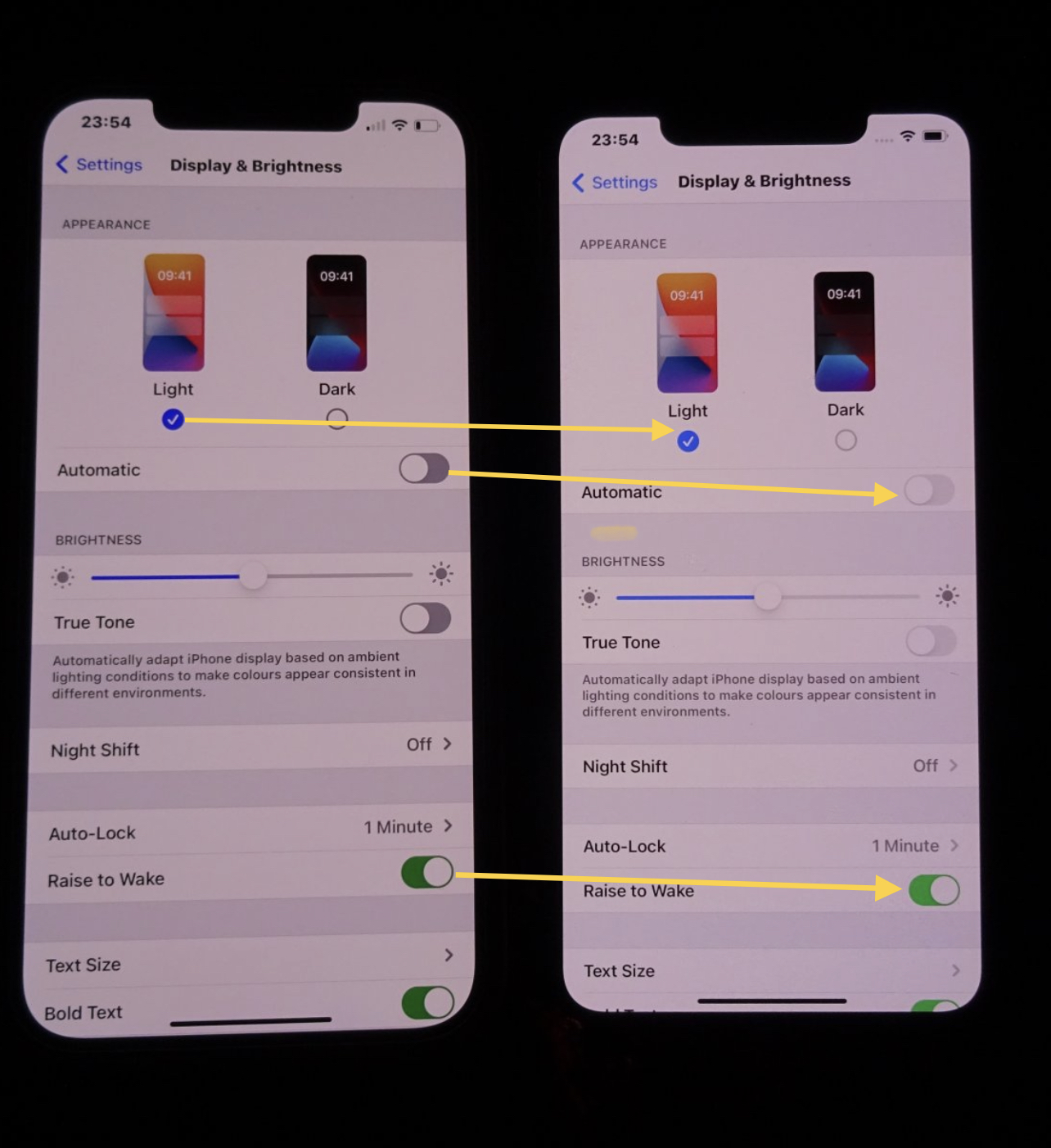

Some more pics/evidence for the collention. Serial starts with G0NDL. Brightness at 50% set by Siri. True Tone and night shift off. 12 pro max to the left, XS max to the right.
more notable with your own eyes with phones next to eachother. Not the worst I’ve seen here but it’s there. The XS max does “feel” like a crisper white
It seems to me as one of the phone are tuned by color filter and higher contrast on. Sorry when I am wrong but the blue, grey or green background of the buttons looks not like the standard should looks.
What's also interesting, is that this graph lines up with the other RBG balance graphs I saw of display units of Samsung Galaxies and generally other OLED phones released this year. I think this might be an industry wide issue this year.

The iPhone X color temperature is actually 6554K, which is surprising, because it looks cooler than my 12 Pro Max, which is 6521K. I was expecting the X to be in the neighborhood of 6700-6800K. I wonder if the off axis color shift is altering my perception of how cool the screens are. I don't know how to measure at an angle, but my X definitely gets very blue when I look at it from an angle, and my 12 Pro Max gets very green when I look at it from an angle.
The iPhone X color temperature is actually 6554K, which is surprising, because it looks cooler than my 12 Pro Max, which is 6521K. I was expecting the X to be in the neighborhood of 6700-6800K. I wonder if the off axis color shift is altering my perception of how cool the screens are. I don't know how to measure at and angle, but my X definitely gets very blue when I look at it from an angle, and my 12 Pro Max gets very green when I look at it from an angle.

At lower brightness the green is not that much different. Red and blue look better at lower brightness. Overall more consistent.
Just want to clear one thing up. The x axis on these graphs is not brightness. All of the measurements are taken at the same brightness. The x axis is grayscale, so 0% is black, 25% is dark gray, 50% is medium gray, 75% is light gray, 100% is white. So the 12 Pro Max graph, for example, is telling us that, at this specific brightness (42%), white is well balanced, but dark grays have a lot of green tint.
