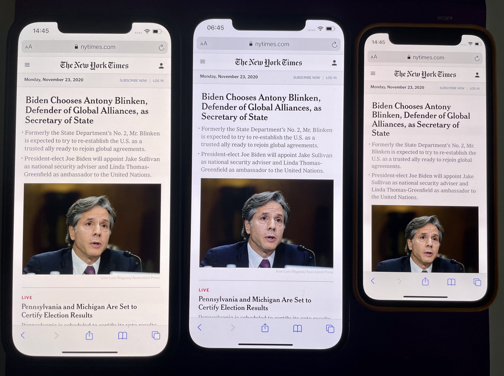

I just had another delivery of the max today. It is in the middle of this picture. The previous max and mini are next to it. Not only is it not yellow. The screen pops and it is almost like the other Max’s screen is thicker and hence makes text look more washed out.
this is a TROLL. How do I know? a. He hasn’t responded to any questions from anyone. b. post history. And...here is the best...c. Time on phones. d. One good post out of 100 pages. e. Can be a good photoshop.
upload more pics/dates/first four,etc.
come on people, Russia trolls you all the time, don’t be naive with only 1 post.
