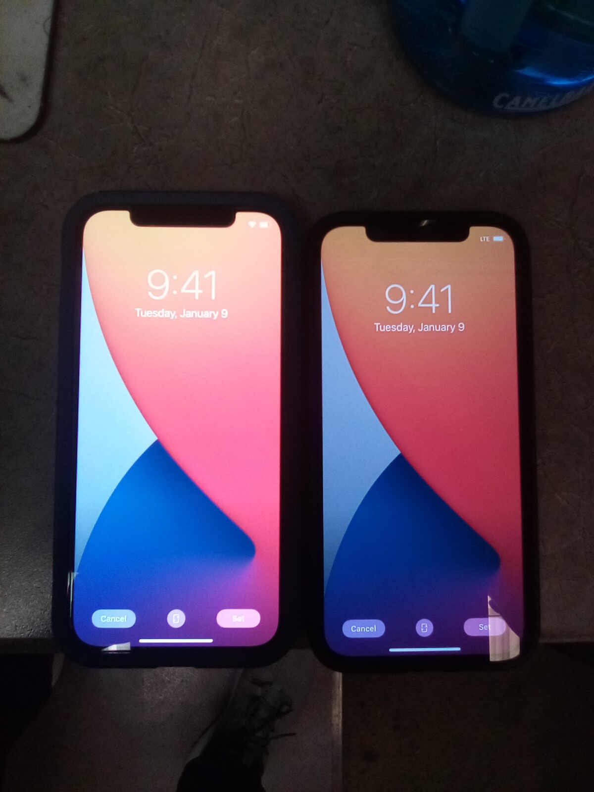

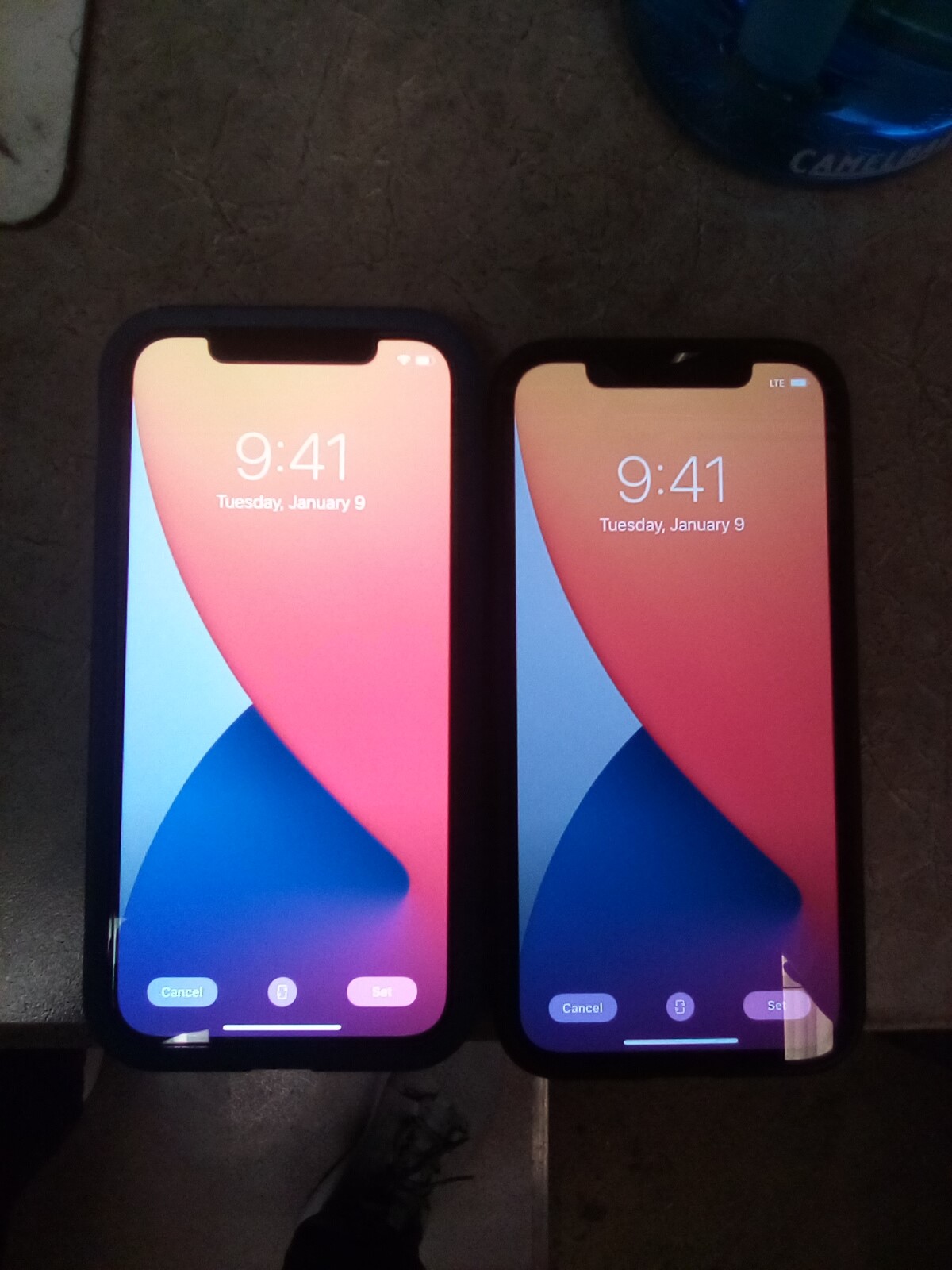

I compared my 12 pro with my friend's and saw a noticeable brightness difference. (See photo). Credit to the random reddit thread I saw this suggestion, but I ended up:
going into accessibility settings --> toggling the reduce white point switch--> sliding it all the way to left --> then turning it off. That ended up fixing my dim display issue. If you're experiencing just a dimmer display (doesn't address yellowing), I would fiddle with that setting to see if it fixes it. There must be some bug that triggers that setting without it being toggled.
