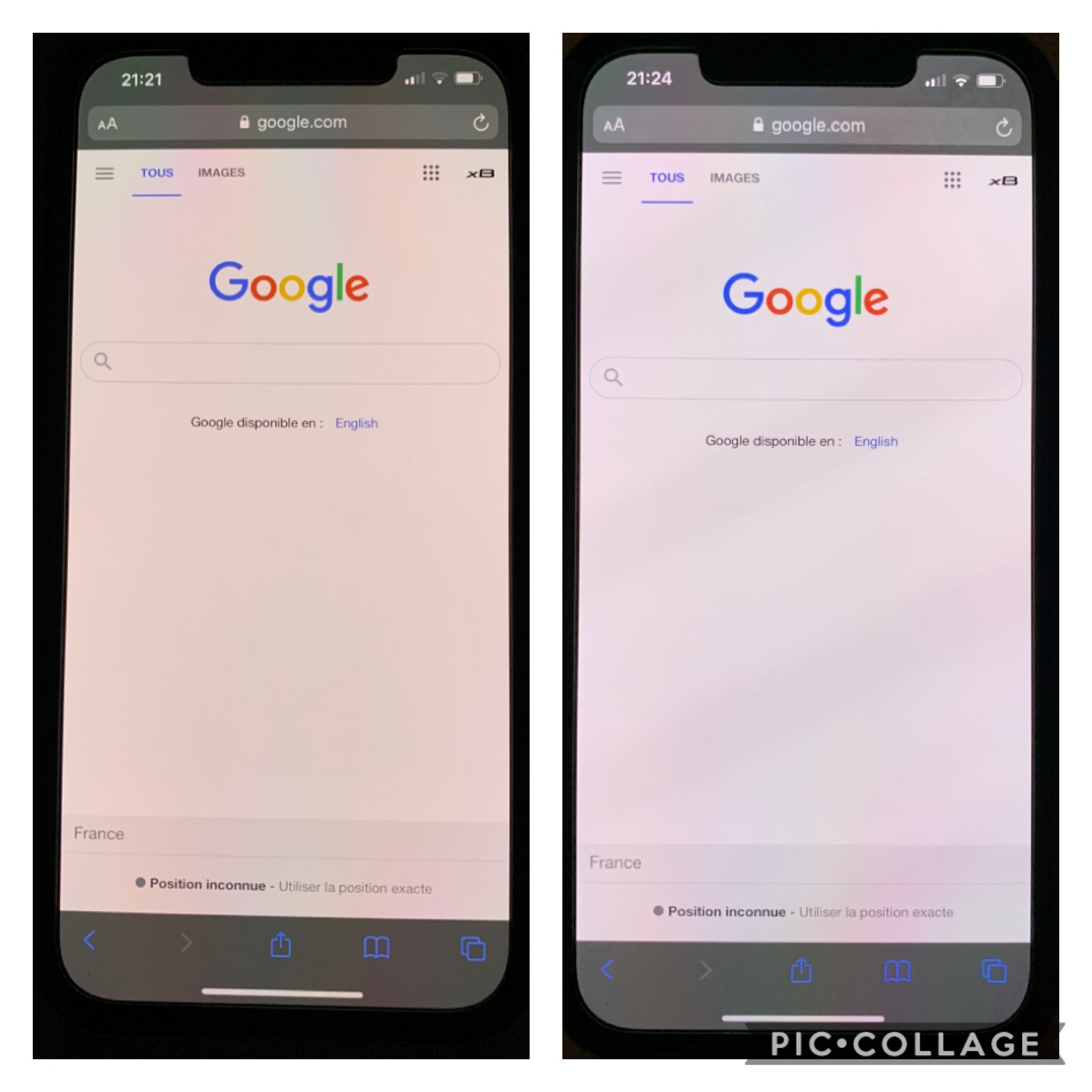

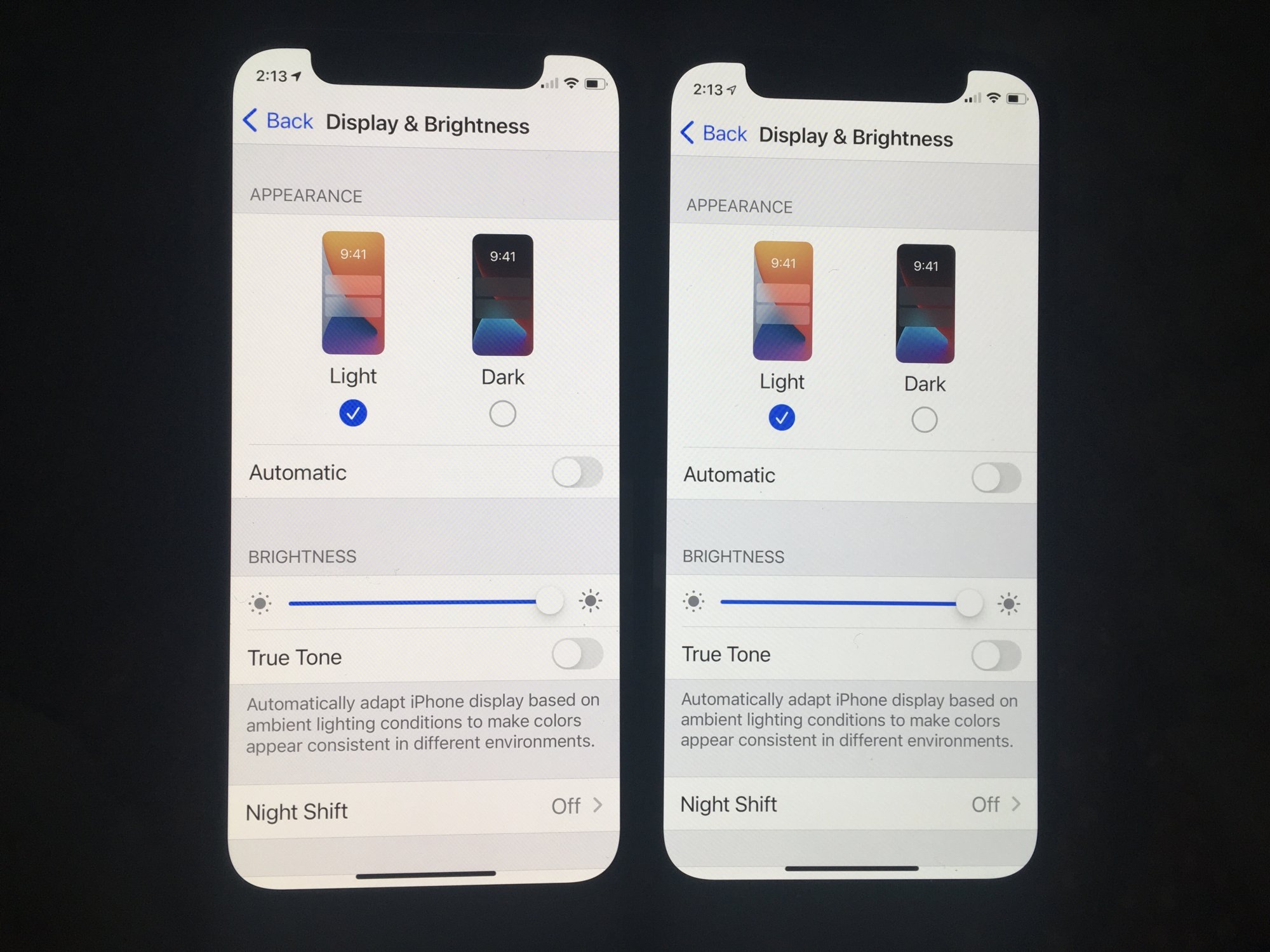

Original on the left, Foxconn on the right. Less piss, but still piss. Taken with iPhone SE gen 1
Reactions: Sim-1
TT on will have a yellow tint even if your iPhone has the best calibration in the history of the earth. This thread is for people with yellow tints with TT OFF and Night Shift OFF.

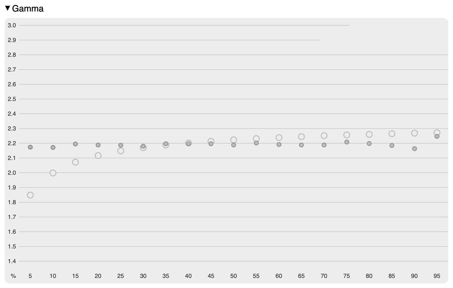

Woot woot! I think I got a good one boys! Now calm down a second... it still has a 6500K color temperature and would still look warmer and perhaps a bit more yellow than many iPhones from previous years, but it has noticeably less green tint than my first one, which was my biggest issue.
The touch screen was acting up on my first Pro Max, so I went in to an Apple Store and swapped it out. I obviously don't have the first Pro Max to take side by side pictures, but I do have colorimeter measurements for both screens.
Average ΔE / Color Accuracy - lower is better, < 2 is considered good, < 1 is considered excellent
  • Original F2LDN / GNQ Pro Max: 0.99
  • New G0NDL / GN9 Pro Max: 0.82
Average Color Temperature
  • Original F2LDN / GNQ Pro Max: 6521K
  • New G0NDL / GN9 Pro Max: 6518K
Now, the average color temp is almost the same, but I noticed that DisplayCAL shows a much higher error in white point / color temp for my original Pro Max, and I suspect that's because it had so much green tint.
Measured vs. Target Whitepoint (sRGB 6504K) ΔE - lower is better, < 2 is considered good
  • Original F2LDN / GNQ Pro Max: 4.02
  • New G0NDL / GN9 Pro Max: 2.34

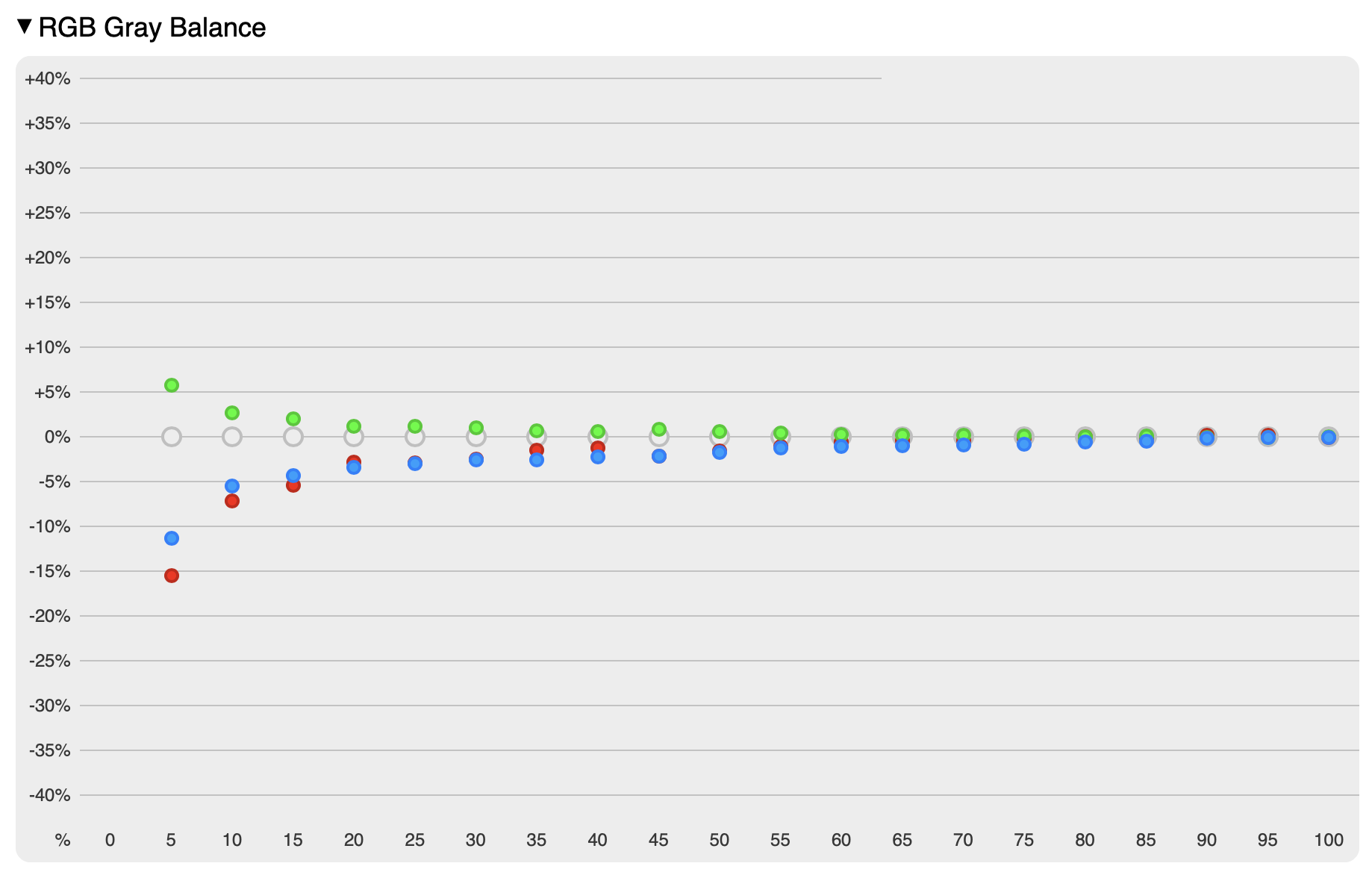

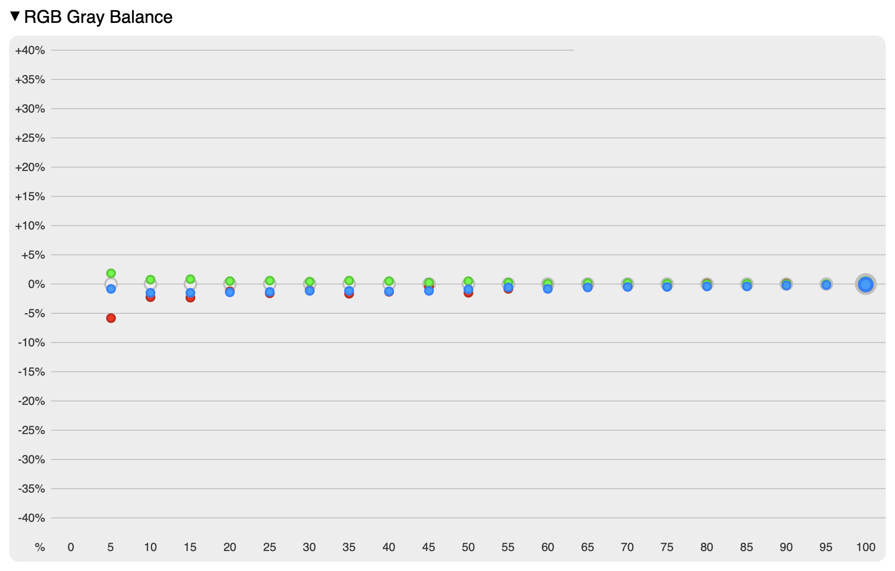

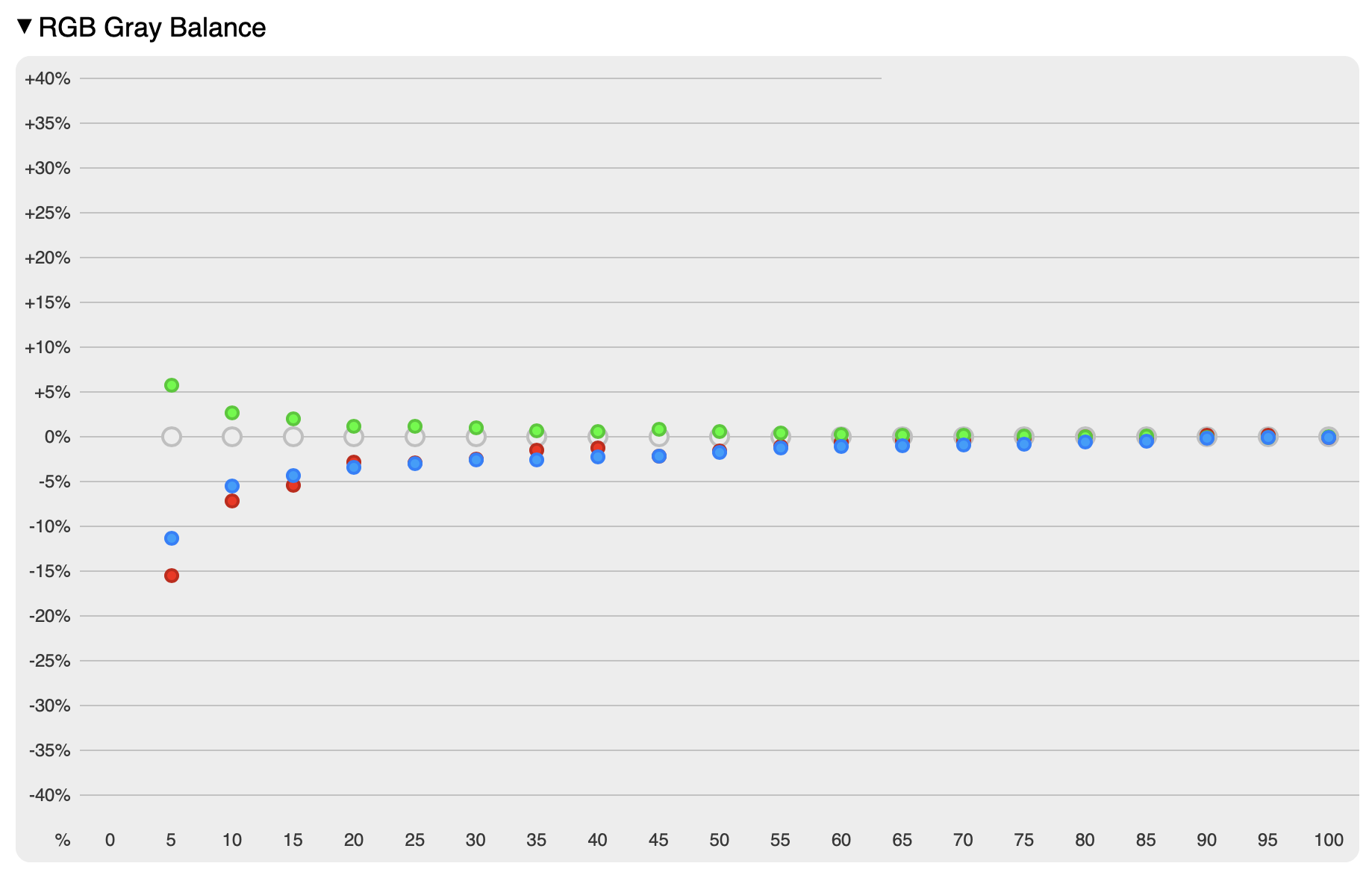

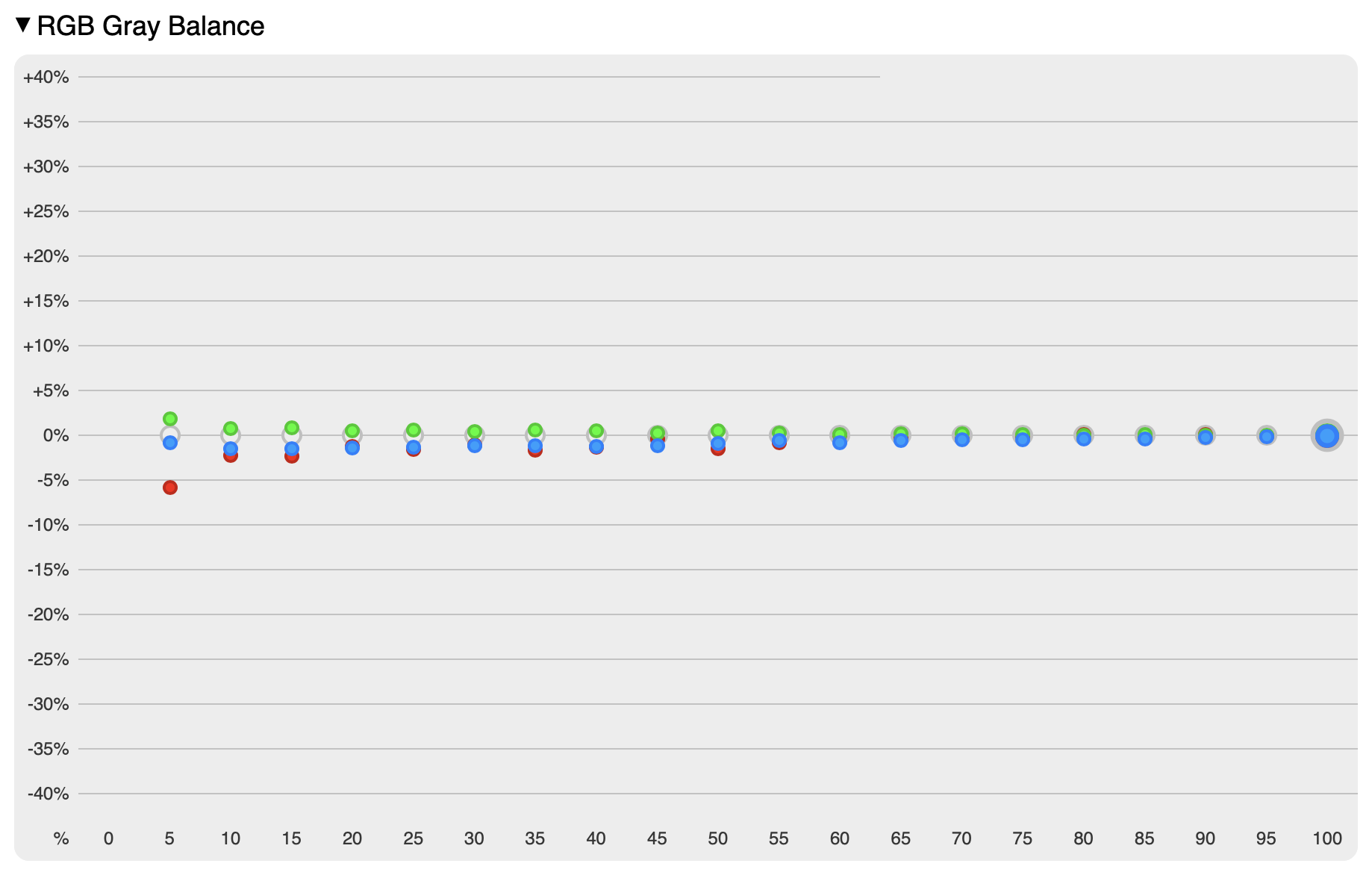

RGB Gray Balance
You can see that there is still a slight tendency towards green in the darker grays, but it's a lot more balanced and less green looking than my previous Pro Max.

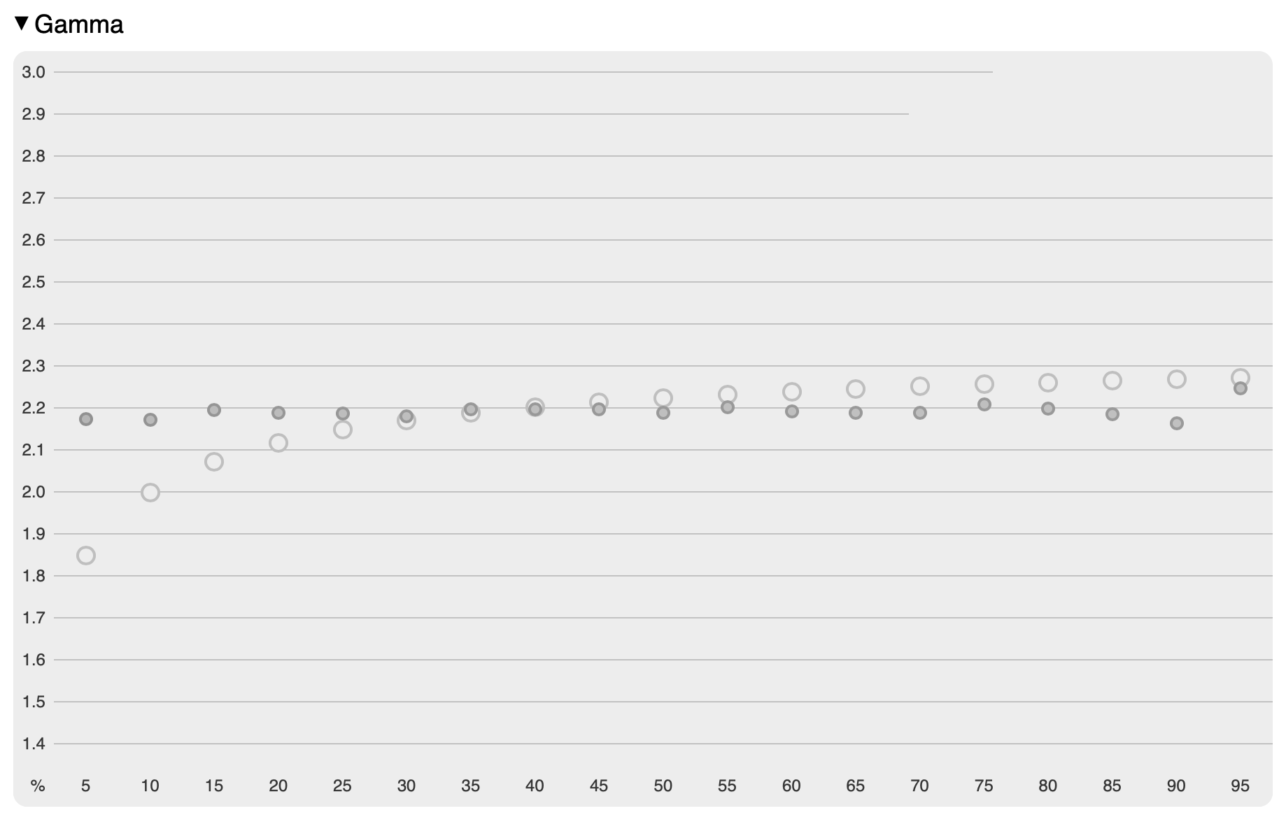

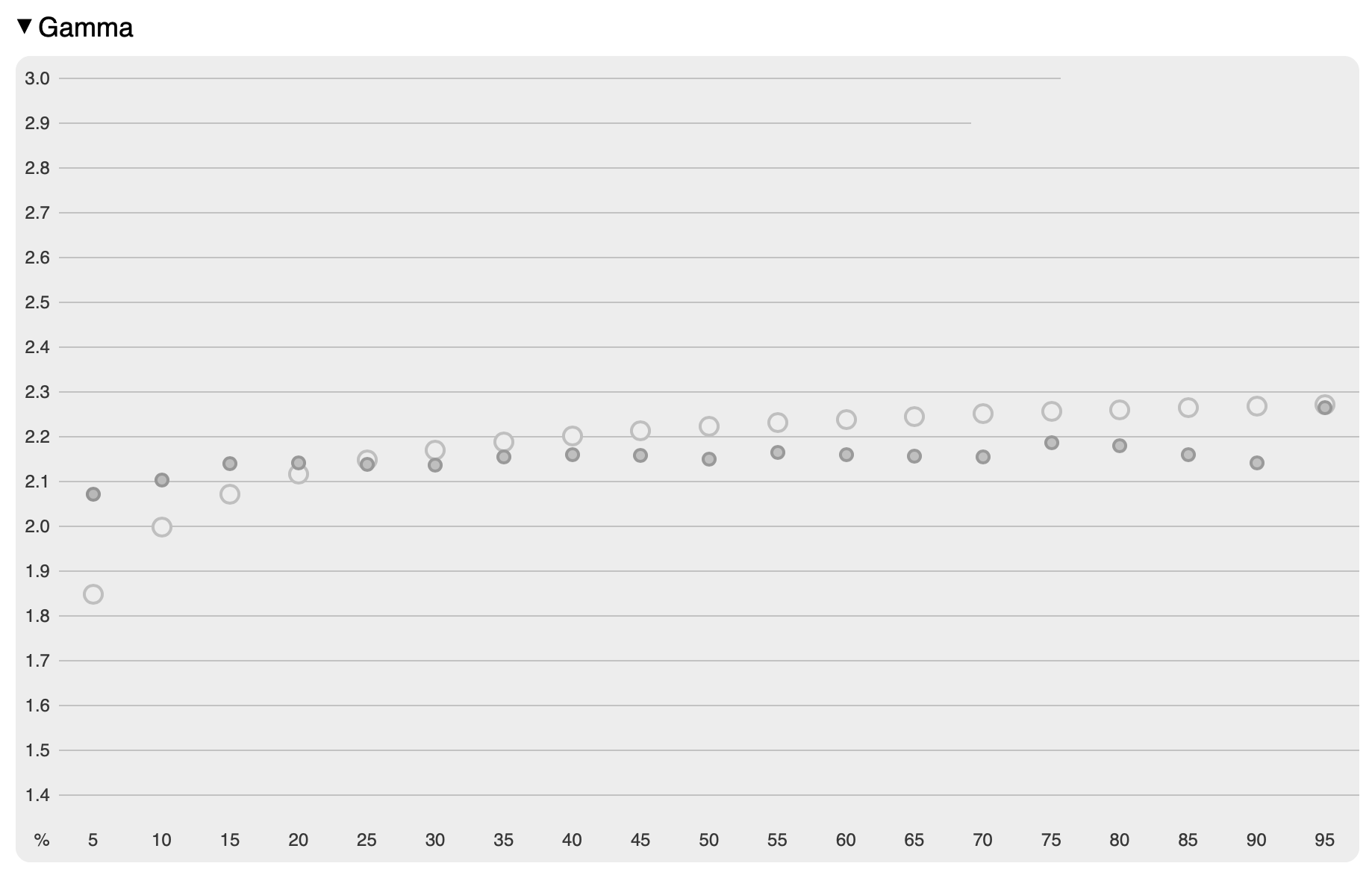

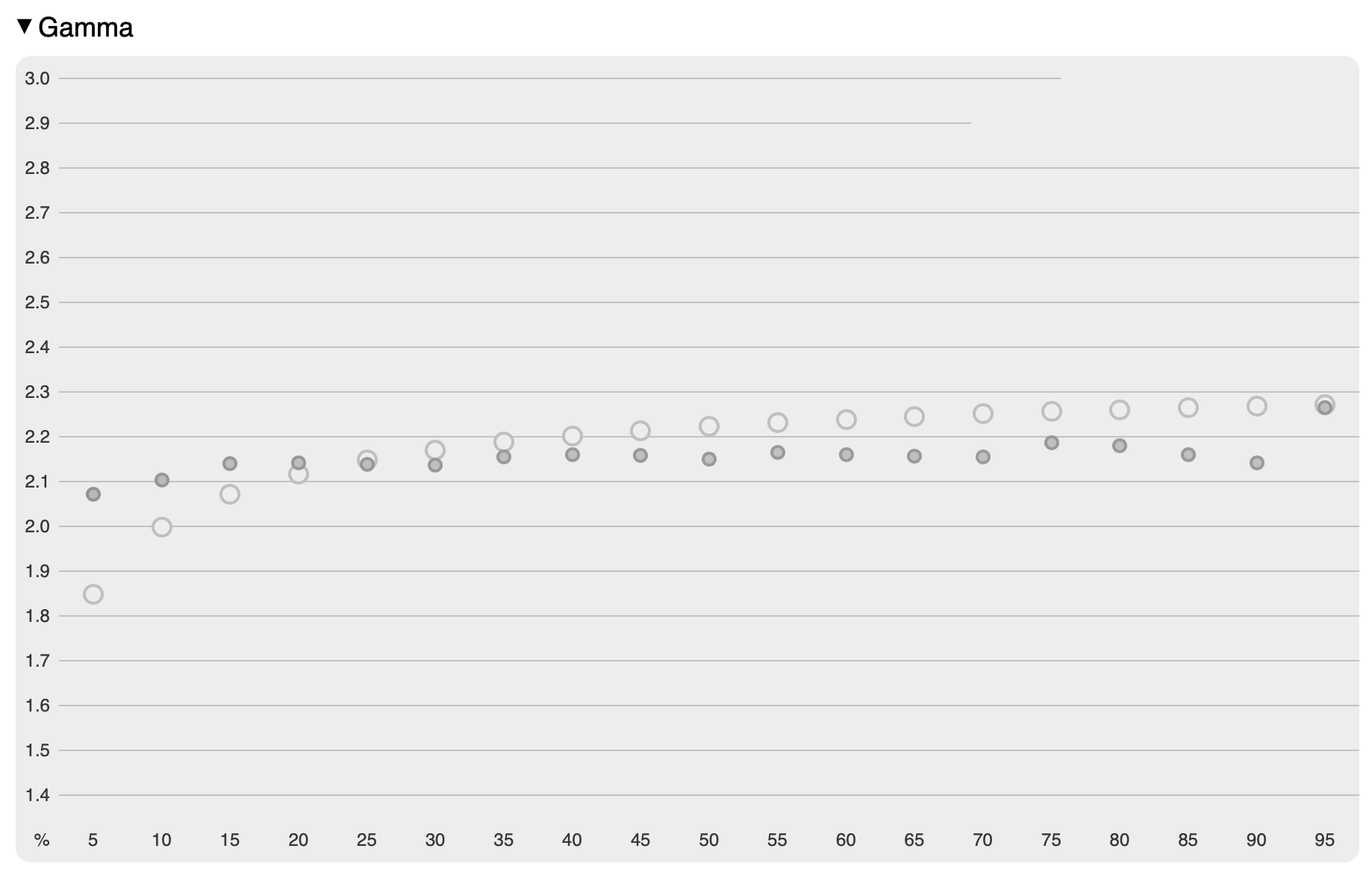

Gamma - Should be 2.2 all the way across. Ignore the empty target circles as that's the original sRGB spec meant for CRTs, and most modern displays aim for a flat 2.2 all the way across. Lower gamma will make things look more flat and washed out, higher gamma will look more contrasty.
I hadn't noticed until now, but my original Pro Max had an average gamma closer to 2.15, which is a little lower than it should be. I wonder if the people complaining of a washed out look have phones with gamma that is too low. My new Pro Max has gamma pretty much right on 2.2, which is better.
In the end, I'm a lot more happy with this display. I'm sure some people would still be unhappy with it because it has a 6500K color temperature, which is warmer than the displays in most Macs and iPads, and warmer than what most people are used to, but I can live with that since it's technically more accurate. I just didn't like the green tint of my first display, and this new one has a lot less of that.

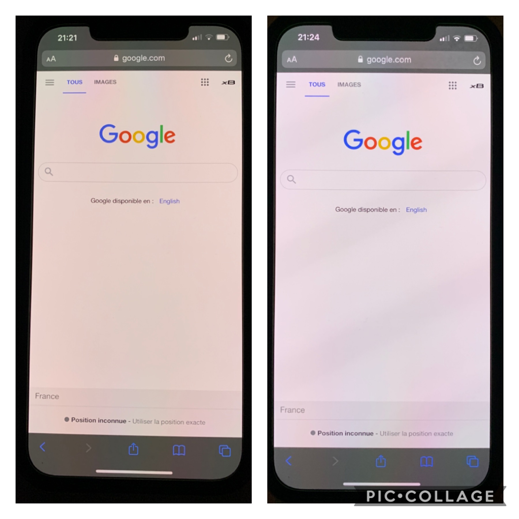

Hi. Yesterday I received my iPhone 12 Pro Max (pacific blue) and is exhibiting the same issues as described in these forums. The display is warmer/yellowish/dimmer than my iPhone X. Also, the whole screen flickers dimly in black areas where the pixel are supposed to be off on video and pictures. So, I called Apple and initiated a replacement process but, I am kinda expecting to receive a new iPhone with similar problems since all my friend's new iPhone 12 pro, are confronting the same issues after testing. Some of them didn't notice the issues but after the tests, well, nobody is pleased by it. So my question, should I keep it, replace it, or returned it and wait until the issue is resolved? Is there any fix coming soon? is this issue fixable? My 2017 iPhone X display looks greater than the 12 Pro Max.
For the record, my iPhone serial starts with F2LDN.
I decided to keep my 12PM knowing that if I exchange it I will most probably receive one with the same issue...and the hassle to reconfigure it again.

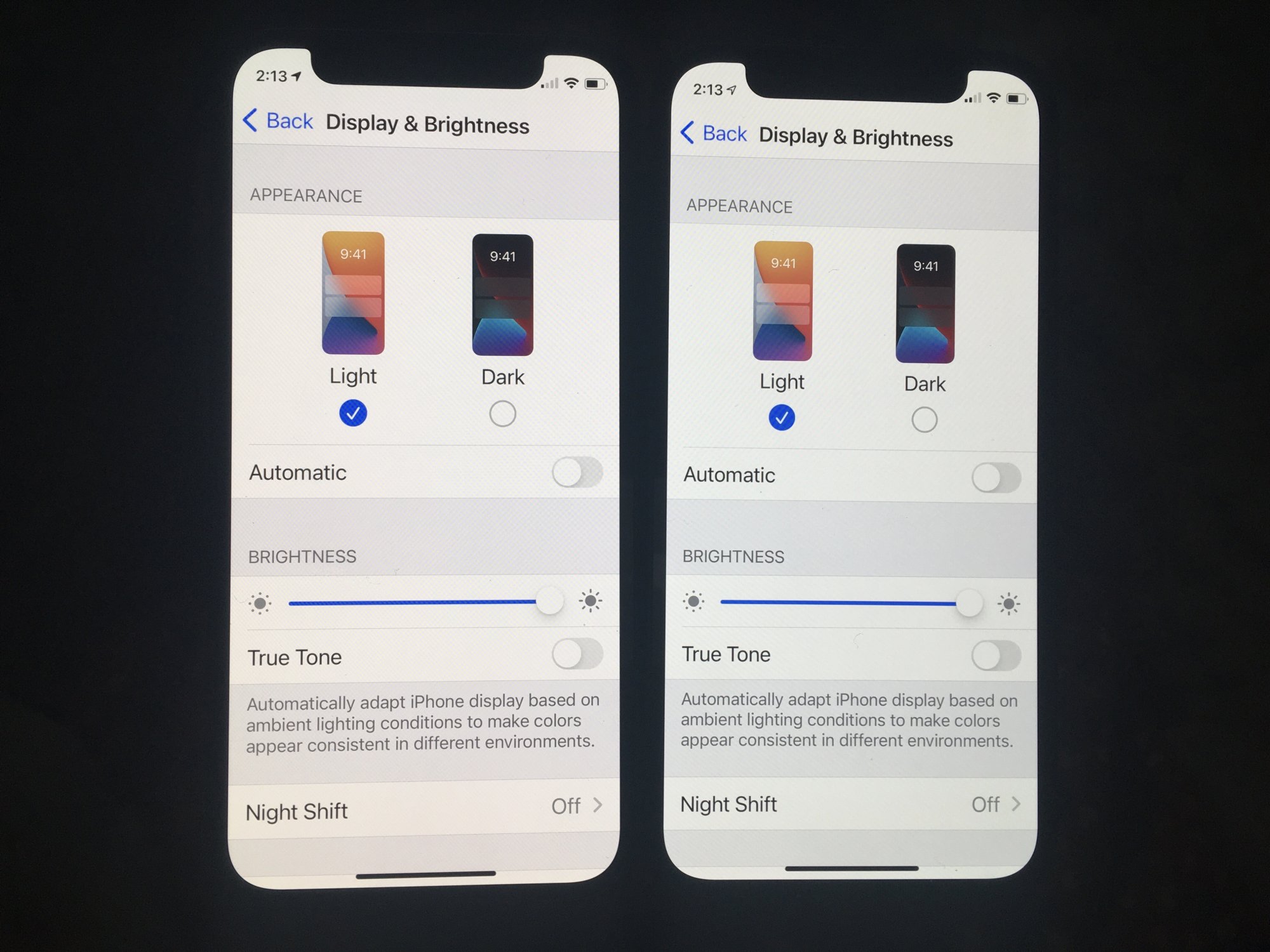

could please share a picture of both with same settings?

I don't have the old one. Traded it for the new one at an Apple store.
