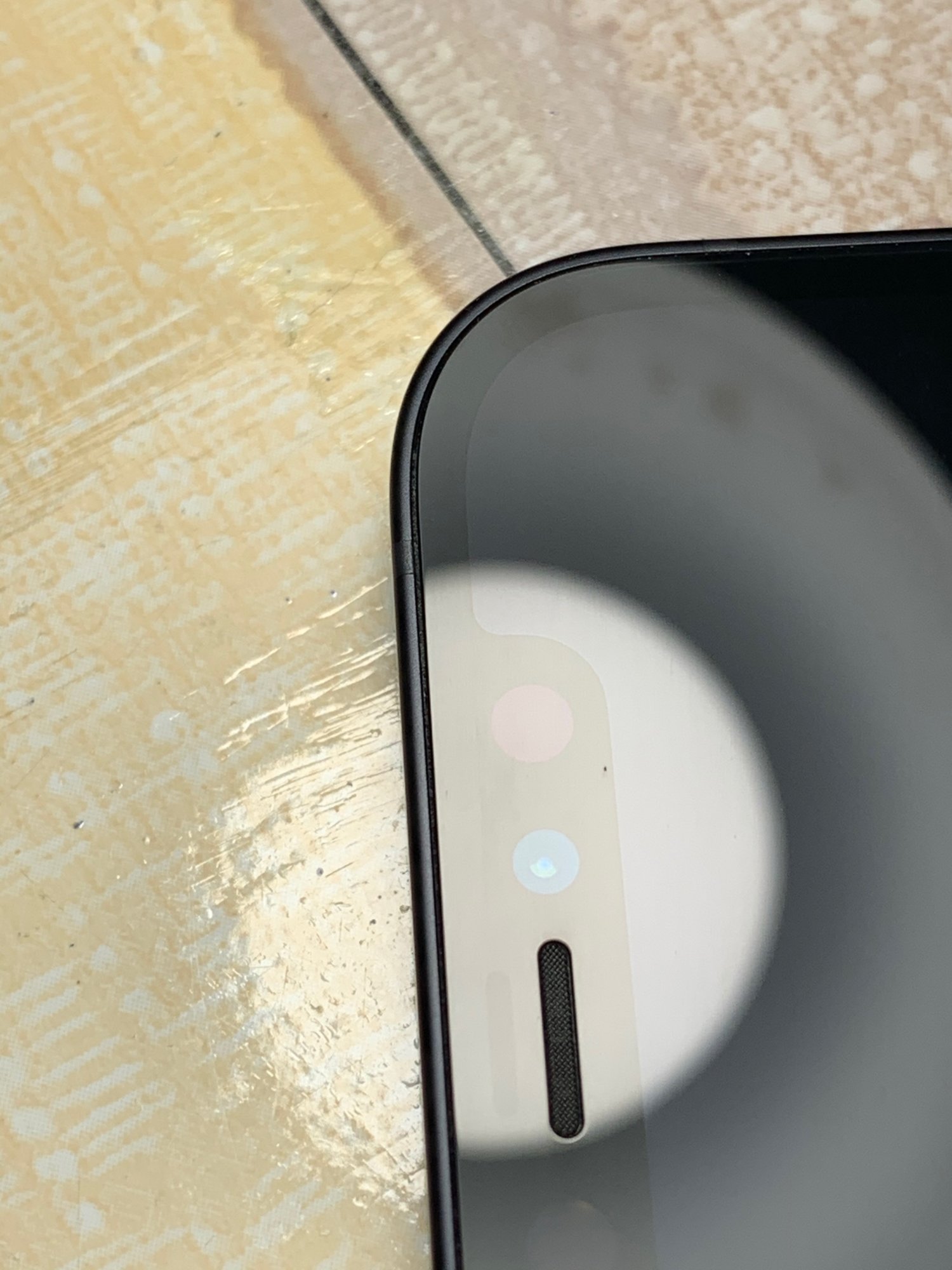

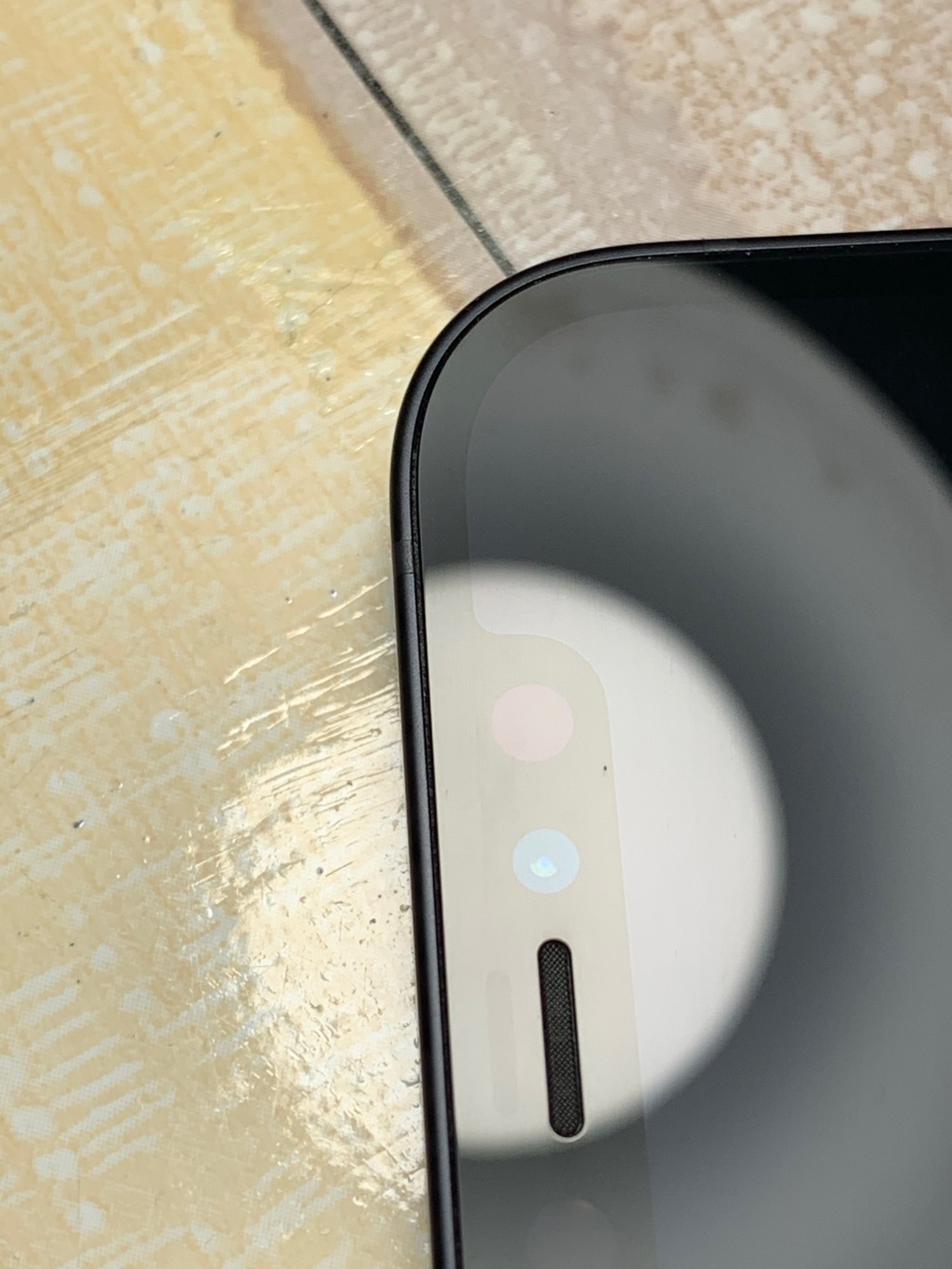

Now we have a gap between display and frame? GG.
The top on mine has a gap and the bottom doesn't..
Yes u are right. But lets speak about "up to 6 meters for 30 mins" water resistant. If u see motherboard or frame inside your 1200 dollar phone, how u will stop water go inside? And then, Apple will refuse problem, bcs, water damage is not covered. They paid huge amout in Italy few days ago because they not recognize water damage: https://www.gsmarena.com/apple_gets...or_its_water_resistance_claims-news-46512.php
Enough?

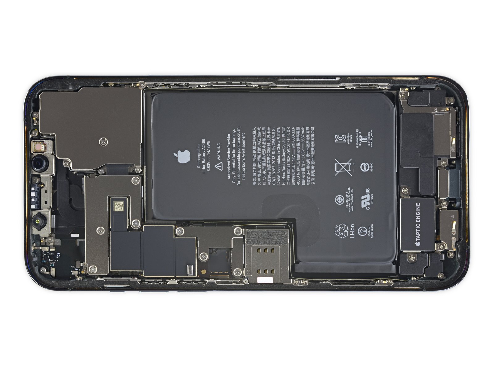

You're not seeing the motherboard. You're seeing simply the frame that surrouds the display.
The display gets surrounded by the frame and is glued on top of a lip that goes around the whole phone, and that's the waterproof barrier that prevents water from getting in the inside of the iPhone.
It's perfectly normal to get a piece of paper sliped between the frame and the display, that space has to be there so there's room to place the display during production, or to get it out and back again for a repair.
Check this photo below, you'll clearly see a wide black strip all around the interior of the iPhone. That's the seal where the display sits on top of.
It's pretty easy to see it's impossible to be seeing the motherboard or the inner part of the phone.
If you watch the picture closely, you can even see that on the right side of the phone that black lip is not event straight, so some portions are even a bit far away from the frame. In these portions, and under bright sunlight you'll probably see the metal shining. It does not mean there's some seal missing, it just means that for some technical reason, the lipa had to be moved in certain portions of the phone.
This image is pretty revealing and at the same time reassuring for those who fear to have received a defective iPhone.
That's what to expect.
I understand people who have high expectations on a product that is not cheap, but what you are seeing, is perfectly fine.
Just look at the picture closely. It's all there ;)

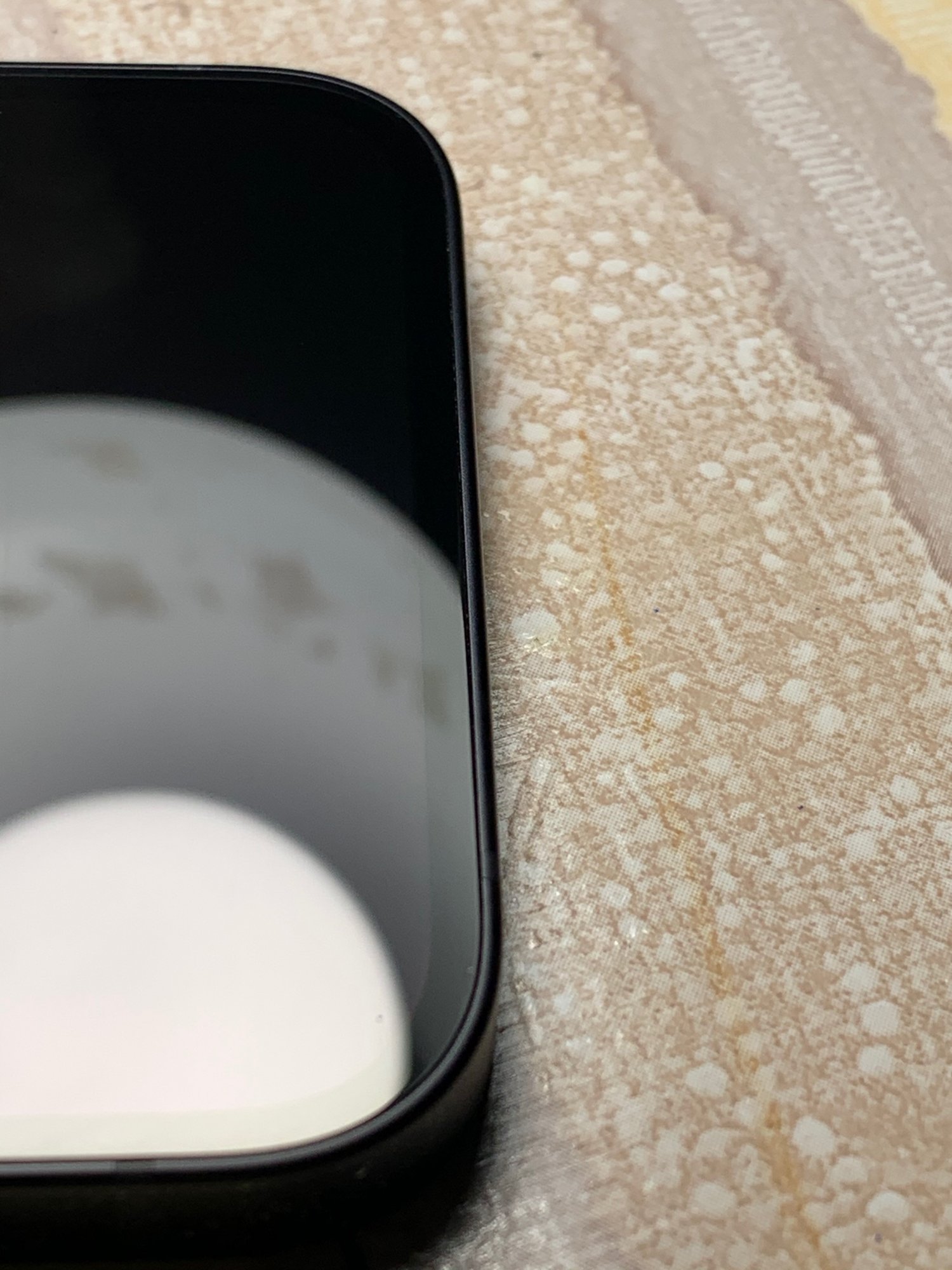

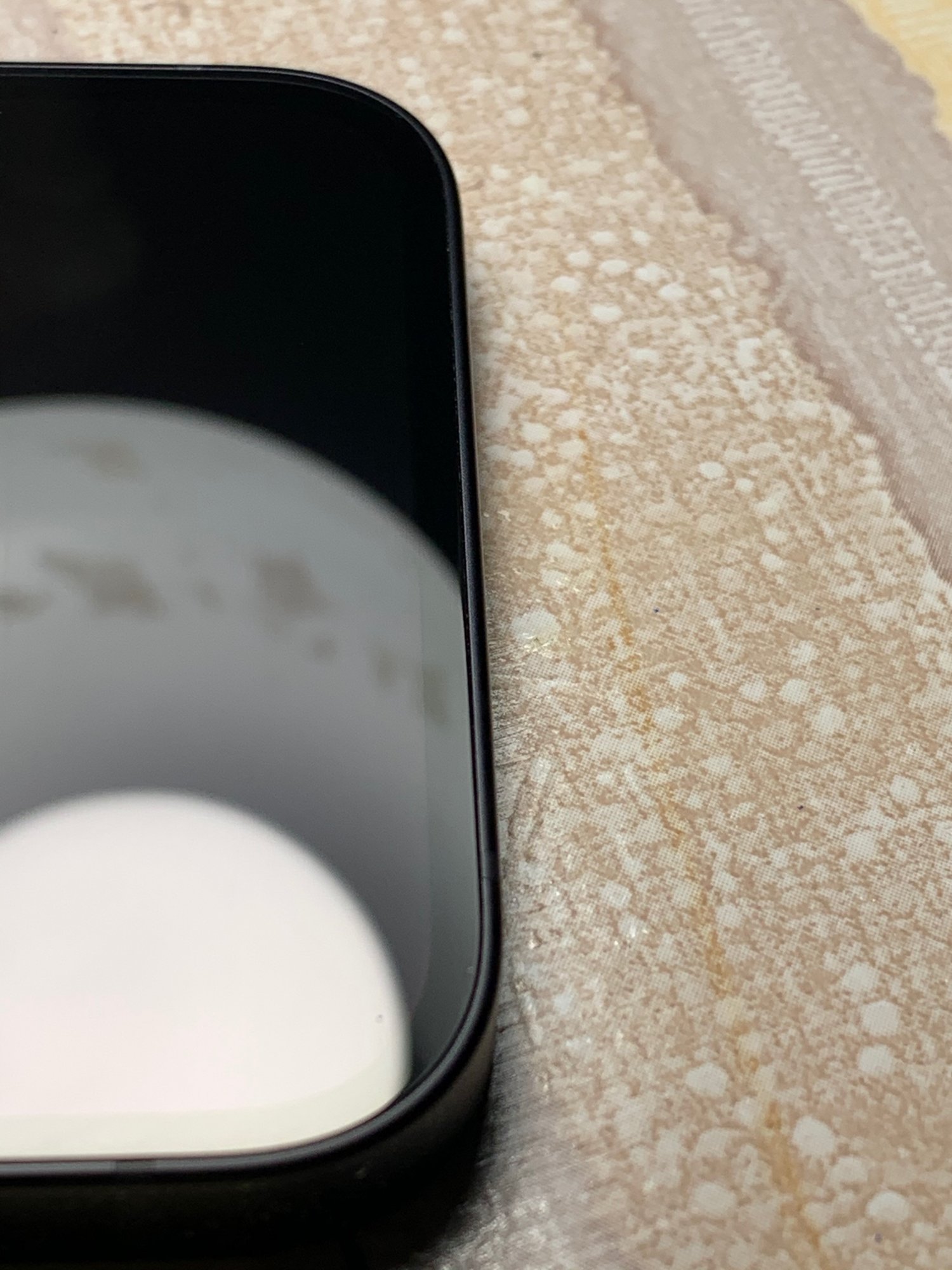

View attachment 1684251View attachment 1684252
Every side has a gap. It has to.
What happens is that it is virtually impossile to guarantee the gap space gets perfectly distributed between all sides of the display.
Some will have a bigger gap on the top, some on the bottom, and others on left or right side.
It's normal....
It's normal....

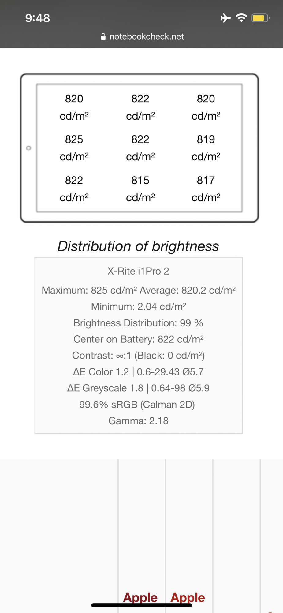

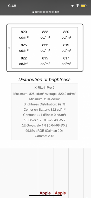

I noticed that since the xs generation the panel have become more and more uniform.
This model year show minor to none variation from each panel as you can clearly read in this thread.
yes there some clearly defective units but the most are identical. They may be yellowish the 11, have a kind of glow or whatever but that’s it.
Mone of the most annoying issue of the X generation, for example, was the evenness of the display: starting from 11 all and I say all the panel I saw was perfectly even.
Unfortunately the trend started with the oled make the panel of every new gen more yellow.
I recall the “old times” with (from 5 to xs) the variation was huge... and so, at that times, you really play the lottery game.
now it does not worth it. If you do not accept the warmth of the tint and you can’t live with the color accommodation bandaid you’re done. Look elsewhere.
perhaps the next batches will be better, who knows. At the present the evidence is pretty clear to everybody.
Indeed, they are very uniform now at 99%!

Please don't tell me about calibration, I'm sitting in front of a $1,500 freshly calibrated IPS/LCD Monitor and yes, to D65. iPhone whites are yellower/greener when comparing directly.
Also if you had read this thread you would know that some people and sites already measured the RGB balance and it was far from perfect, especially with low brightness.
Too much green color deviation with brightness change. It still may be 6500k.
xlK6MS4MLqVFaskl.huge
That’s fair enough. The way you explain it makes sense. One thing I am confused about though is that my wife’s iPad Pro does not have any gap at all around any side of the screen. Is there a reason why the iPhone has random gaps and the iPad Pro doesn’t?
