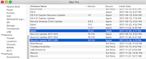

I ran that security update without issue; it doesn’t appear to have altered those files.

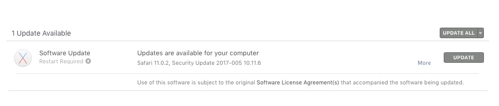

I'm on 10.11.6 on a Mac Pro 1.1. How do I make sure that I am not installing a combo update but only the 2017-005 10.11.6 security patch? I don't have a flashed GPU and so re-installing the modified Efi is a real pain in the neck as I have not boot screen!
Does this from the app store (software update) look safe?
Many thanks

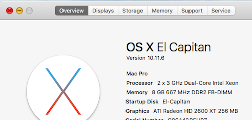

Check in "About this Mac" and it will show the current version you are running. 10.11.6 is the latest version and security updates to this seem to be OK. If it reports an earlier version you need to take care and run something such as Boot64 that will protect the boot.efi files that could become overwritten in an update. There is a huge amount of info on how to do this in this thread.
