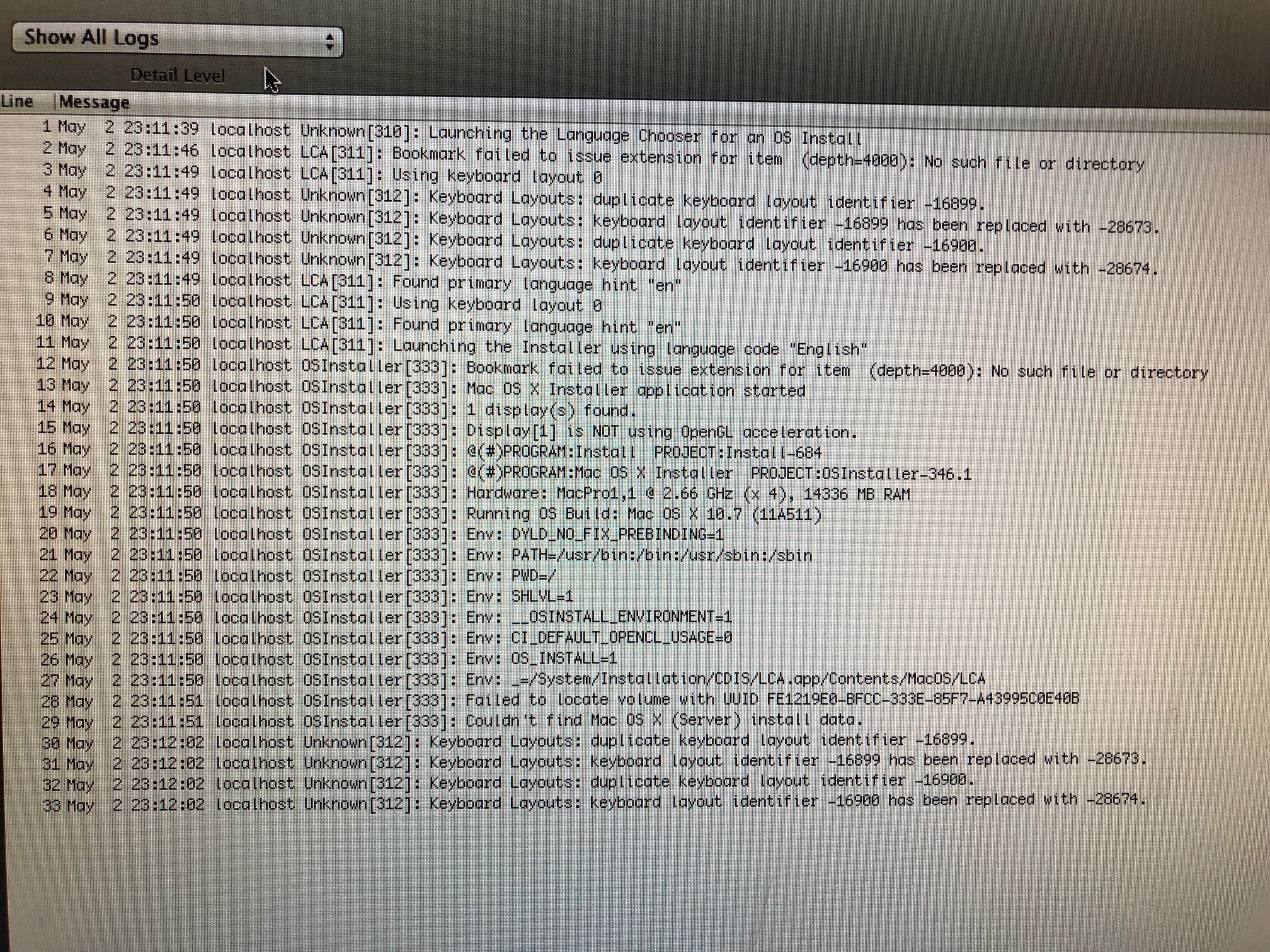

Did I brick it?
I started with OS X Lion. Was able to 'pikify' up to El Capitan 10.11. Connected it to the Internet, wasn't thinking it through, and allowed it to update to 10.11.16. Wouldn't reboot properly after that. Thought I was doing the right thing by erasing the HDD and trying to do a fresh install of OS X Lion, but now it won't let me. Even tried doing a fresh install of El Cap.
Log message:
Thank in advance for help/assistance.

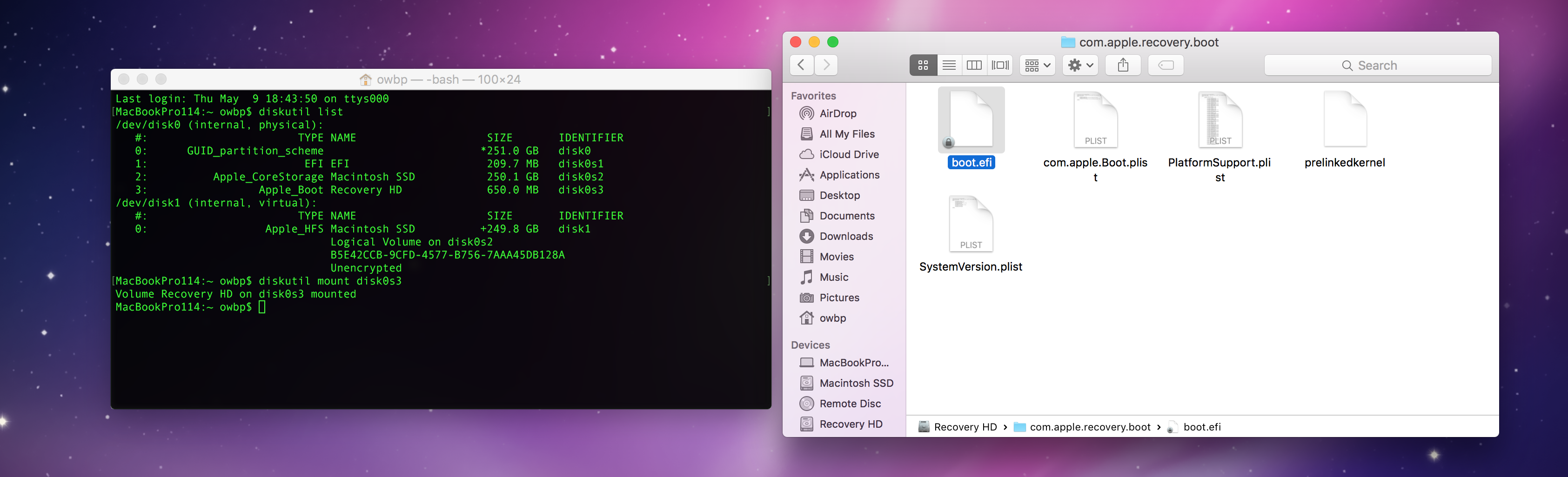

Can I put a hard drive into my Mac Pro 3.1 and install El Capitan, and after the installation put the hard drive back to the Mac Pro 1.1?
You can, but before putting it to 1,1 you have to replace boot.efi files or it won't work.
Only the two efi files on the drive or do I need also replace the efi file on the recovery partition?
Where is the efi file on the recovery located and how can I make this partition visible?
Replace boot.efi in Recovery only if you're gonna boot into it. Otherwise there is no need for that (but since it is a one minute job i don't see why you shouldn't).
Here is the location and how to get to it.
