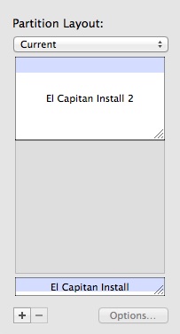

So, here's where I am so far:
a) I've used Chronosync to create a clone disk (install 2), but it won't boot. It starts up, loads little progress bar, then shuts down.
b) I've booted into my old Mavericks install, gone to disk utility and weirdly, it will let me decrease the size of the install partition, but will not let me expand it, despite there being 200G of empty space on the disk. (see picture, attached). I've reduced the size of Install 2 (which won't boot) and it creates empty space, but Install 1 will not expand beyond its original size. I can reduce it slightly, but not expand it. Usually, in the partition diagram, there is a little dot on the divider that allows you to slide the divider up or down to allocate more or less to each partition. This divider between the partitions 1 and 2 is solid and without a dot to grab.

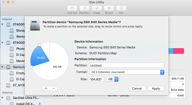

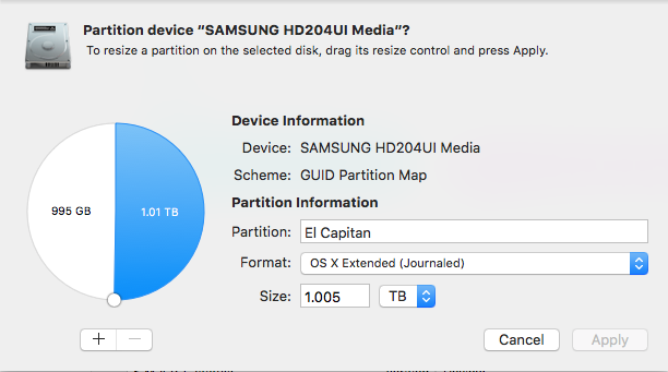

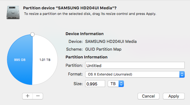

In pictures:
Here's one of my drives. I have partitioned it into two roughly equal volumes (Untitled on the left, El Capitan on the right)

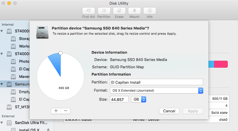

From here I can move the slider to make the El Capitan volume smaller but I can't make it bigger

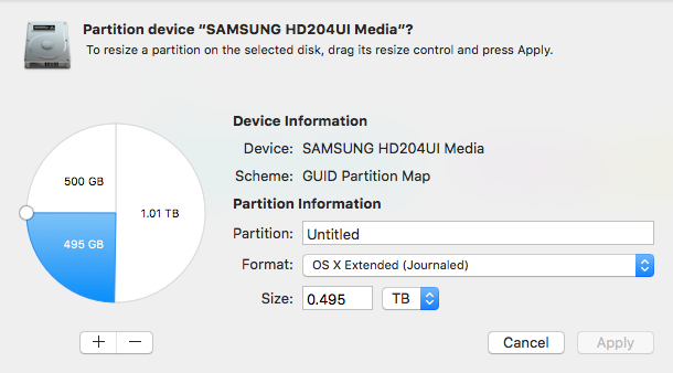

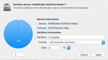

In order to make the El Capitan partition bigger, I have to make space for it by deleting the Untitled partition
Click the left-hand half segment, then click the minus button.
Deleting the partition will delete any data stored there, make sure the volume is empty or that you can afford to lose that data

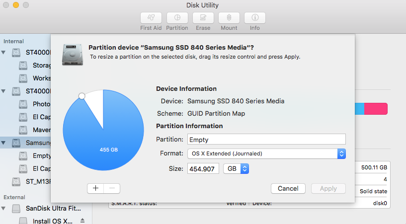

The El Capitan volume will increase to occupy the remaining space

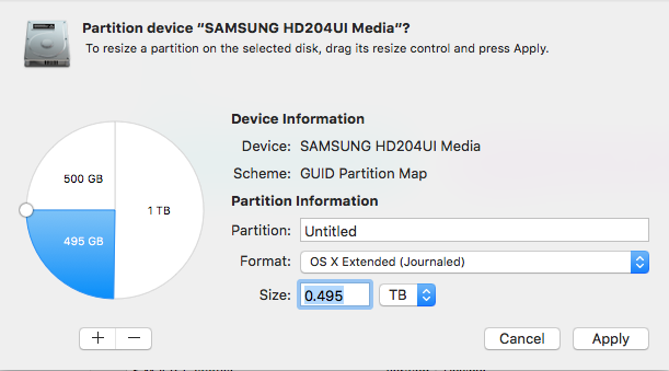

If you want to retain some portion of the disk for a second smaller partition (let us say a quarter, or 500GB in my example)
Click the left-hand half segment, drag its slider
Apply it - I now have El Capitan, Untitled, and Untitled1

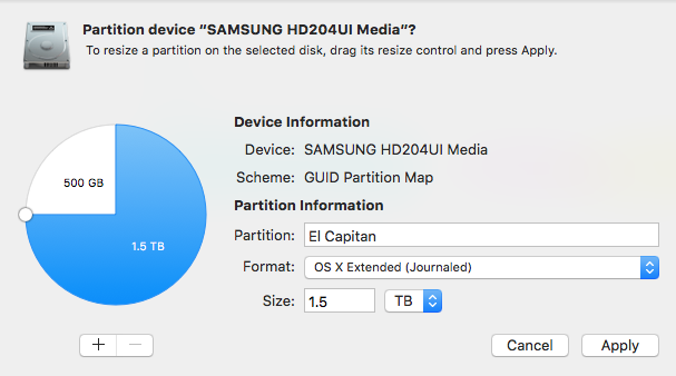

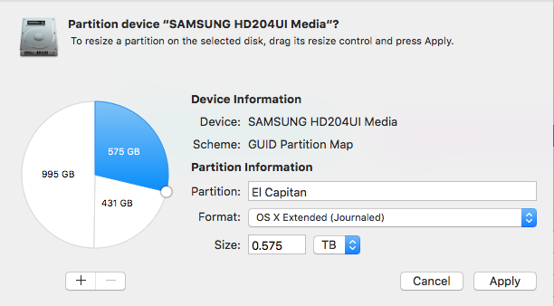

Thanks for the detailed response. So I opened the partition dialogue in El Capitan and I am getting the same results: Interestingly, the partition dialog will not let me delete the other partition. The minus sign is dimmed out. I erased the data on that 2nd partition, so now I have two partitions: El Cap Install (can't expand, though I can contract it) and Empty which is an actual partition (not just empty space)
Untitled 5 .png .
The working El Cap install is the small sliver. Note that when smaller sliver is selected, the dot is on the right side, but not the left. This only allows it to contract the partition but it won't expand (into the other side).
I can contract the larger partition fine, but that results in creating a third partition (Untitled) automatically, not empty space. Note that the dots are on both slides of the sliver, meaning it can be expand in either direction (though it won't expand INTO the El Cap sliver).
This is maddening and I can't understand why it is doing this. To further complicate matters, I can no longer boot off the Install USB. I select it on the Boot screen, it shows the progress bar, but then boots into my El Capitan drive.
In addition, I've tried to boot off the recovery drive 11.2 and the same thing happens. Booting of the Lion recovery drive takes me to the Recovery screen, but then it seems to freeze up. Right now, I can boot into Mavericks install, El Cap Install. I cannot boot into the El Cap clone I created using Chronosync.
View attachment 606591 .

OK. Looks like Carbon Copy Cloner was the way to go. Have cloned the drive to the other partition and it is functional (am working on if as we speak). I have plenty of space to work with now. Once I am satisfied, I will delete the original partition. Seems like we're back in business.

Your problem with the partition map is due to the El Capitan Install partition being "second" in terms of the partition table (your first screenshot shows the "Empty" volume as the first partition). Your problem is occurring because of the ordering. The start of a partition is typically fixed and can't be "moved". You can shrink a partition boundary and create a "new partition boundary". Once you commit the change the start of the partition is effectively fixed. The only way to change the start of a partition is to delete the partition.
Think of the starts as fixed, and the ends as variable.
You will probably need to start again! I would recommend a partition layout with the new or active El Capitan as the first volume...
In general you can fix the Recovery partition by mounting it and replacing the /Volumes/Recovery\ HD/com.apple.recovery.boot/boot.efi file with a copy of Pike's (there is more to do for a full fix but it is too much to type here)

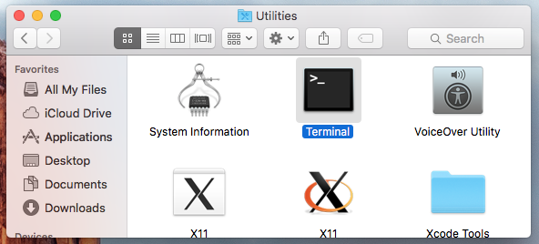

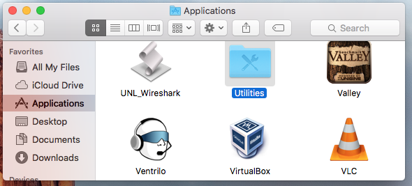

Open a Terminal. You will find it in Applications > Utilities
Screen Shot 2015-12-22 at 22.14.15.png Screen Shot 2015-12-22 at 22.14.33.png

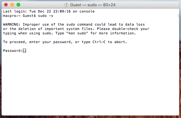

When you have the terminal open, you need to elevate your privileges by typing
Code:
sudo -s
[your normal password]
This will make you the 'root user'.

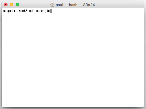

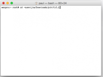

Now you need to change directory to the pikify3.1 folder. You can type this in if you know where about you put it. In the Terminal there are some special meanings
Code:
cd ~[your normal login name]
e.g.
cd ~fred
will take you to your Home folder
Code:
cd ~fred/Downloads
will take you to your Downloads folder in your home directory

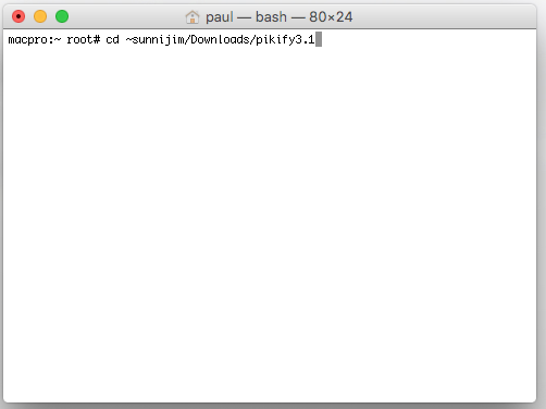

Code:
cd ~fred/Downloads/pikify3.1
will take you to the pikify3.1 folder if you unzipped into the Downloads folder in your home folder.
