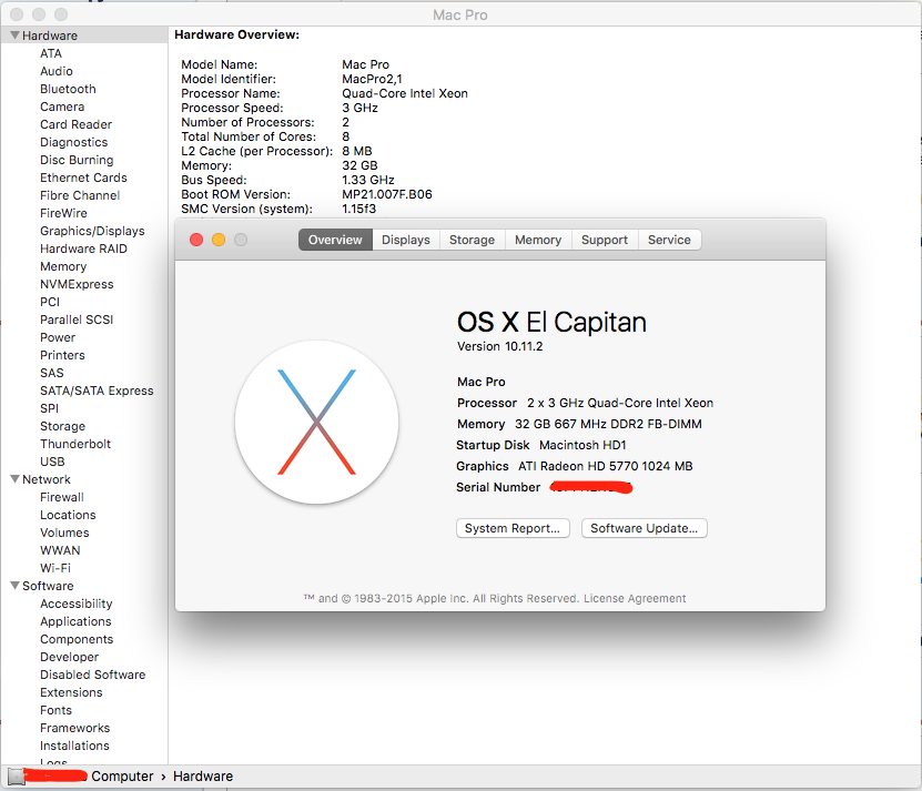

No Questions, Just a genuine Thank You to all of you who originally and continually work on this. You have saved me thousands of dollars and extended the life of my 2.1 Mac beyond anything I could have imagined. I also wanted to share my experience.
I just updated my Yosemite installation to El Capitan 10.11.2 using the instructions at post #1390, #1391. I used pikify3.1 v7. My Mac now runs El Cap with no issues. I could not get the installer to upgrade my current in place Yosemite Installation so here is what I did.
1. RTFD then, RTFD again (Read the F'n directions)
2. On another computer (iMac) i created the installer on a 16GB USB Flash Drive.
3. On the MacPro I removed all the drives except a blank HPS partitioned HD.
4. Inserted the USB Installer and rebooted.
5. Followed the El Capitan OS installation instructions on the screen and a short time later the machine rebooted into a working copy of 10.11.2!!!!!
6. I then put my former Yosemite drive back into the MacPro and booted into the new ElCap OS. I then ran Apples Migration Assistent and moved my data from the Yosemite drive over to the El Cap drive and now my machine is running flawlessly on ElCap with all my former settings and data.
You Guys/Gals rock! Merry Christmas.
***UPDATE*** So all is still well with an odd exception. My prior Yosemite installation, apps, and data fit on a 500GB HD. I just noticed that my El Capitan installation and migration from that Yosemite HD consumed 900GB!
I'm not exactly sure why. I'll update this post once I figure it out.
