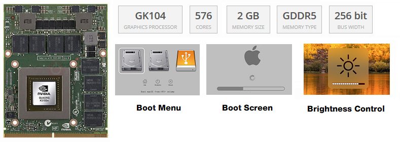

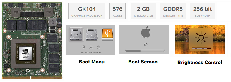

** NVIDIA Quadro K4100M Mac Edition ROM **
Genuine Native Boot Screen & Brightness Control
In the words of Steve Jobs, “this is insanely great!
After much testing and research, I've put together a ROM for the NVIDIA Quadro K4100M which will allow:
  • Genuine native brightness control
  • Genuine ‘gray’ early-boot screen
  • Genuine macOS bootloader compliance
Features (testing in progress):
  • Target Display Mode: testing
  • Target Disk Mode: functional via both TB ports
  • External Monitor: 1 DP/Thunderbolt port functional only
  • iGPU: H.264 with usual highvoltage12v HD3000/Framework Kexts mods
  • dGPU temp sensor: testing
  • Internet Recovery: present
  • Apple Hardware Test: n/a
This ROM does not require a 3rd party bootloader like OpenCore.
This is an alternative ROM and mainly for the audience that just want a “drop-in” answer to upgrading their video card on the iMac 2011.
I appreciate the ongoing ROM testing done by @Ausdauersportler, @highvoltage12v. With their efforts we can expand its utility across multiple macOS versions and peripherals. The brightness range may need to be adjusted with a modified ApplebacklightFixup.kext.
This rom does not require the use of an external EDID parser or a separate graphics core-console stack module, but I’ve left them in there for now. It uses a built in EDID_override_Protocol and GOP_protocol. The rom is based on a TianoCore EDK2 build which houses its own generic video driver. During bootup, the efiROM is responsible for video rendering before the control is seamlessly transferred off to a different handle, the macOS video drivers.
warning: as stated previously these cards are based on a WSON flash package and therefore are much more difficult to recover from a bad flash. Please take precautions and verify flashing.
