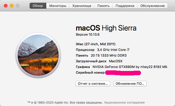

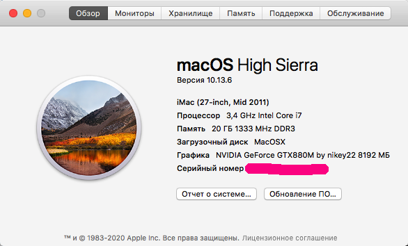

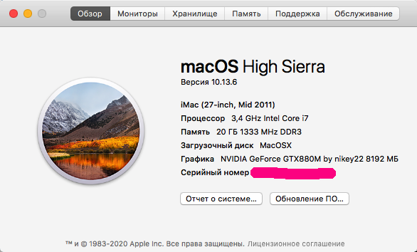

Today I bought an 880M video card
I flashed the bios from NIKEY
Works perfectly in iMac 2011 27"
Thanks!

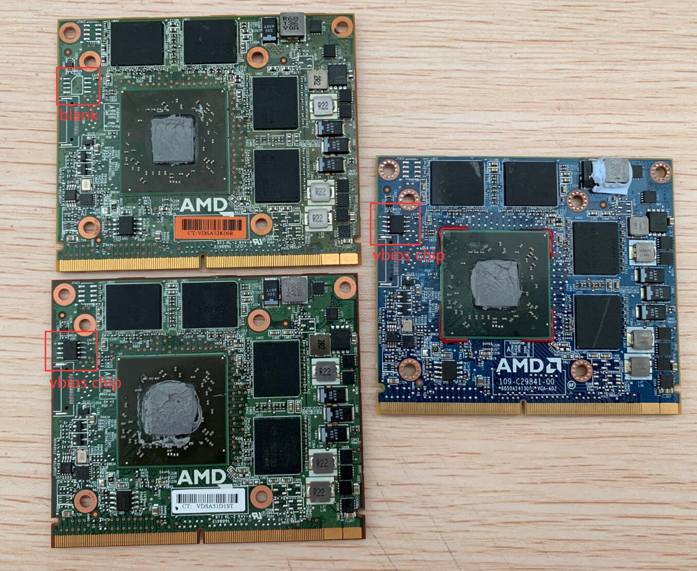

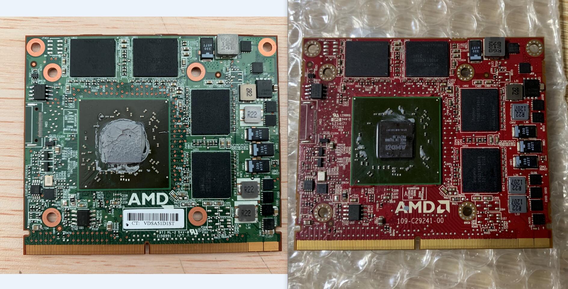

My understanding is: If I buy the Dell version of this M5950 card which already has the EFI chip, I just need to flash your vBIOS without worrying about the EFi chip or resistor. Is that correct?
It can't be!
Firmware? I don't think.
Show me a photo of the video card.
There are numerous reports on some NVIDIA cards not POSTing on the 12,2 iMac, even reference to those on the initial post here. What happens on mine is that the fans spin up for a second and then the system shuts off.
I didn't even dismount the card from the heat sink when I tried it in the 11,3 iMac and it does POST (to 2 LEDs) but I need to flash it.
It's still connected to the heat sink and I don't feel like taking it apart so the photo is probably less than useful.
Thank you very much, Nick.
I’m pretty sure you need at minimum a 128k chip, I do believe these cards have a 64k chip.
Using the chip from you dead card should work.

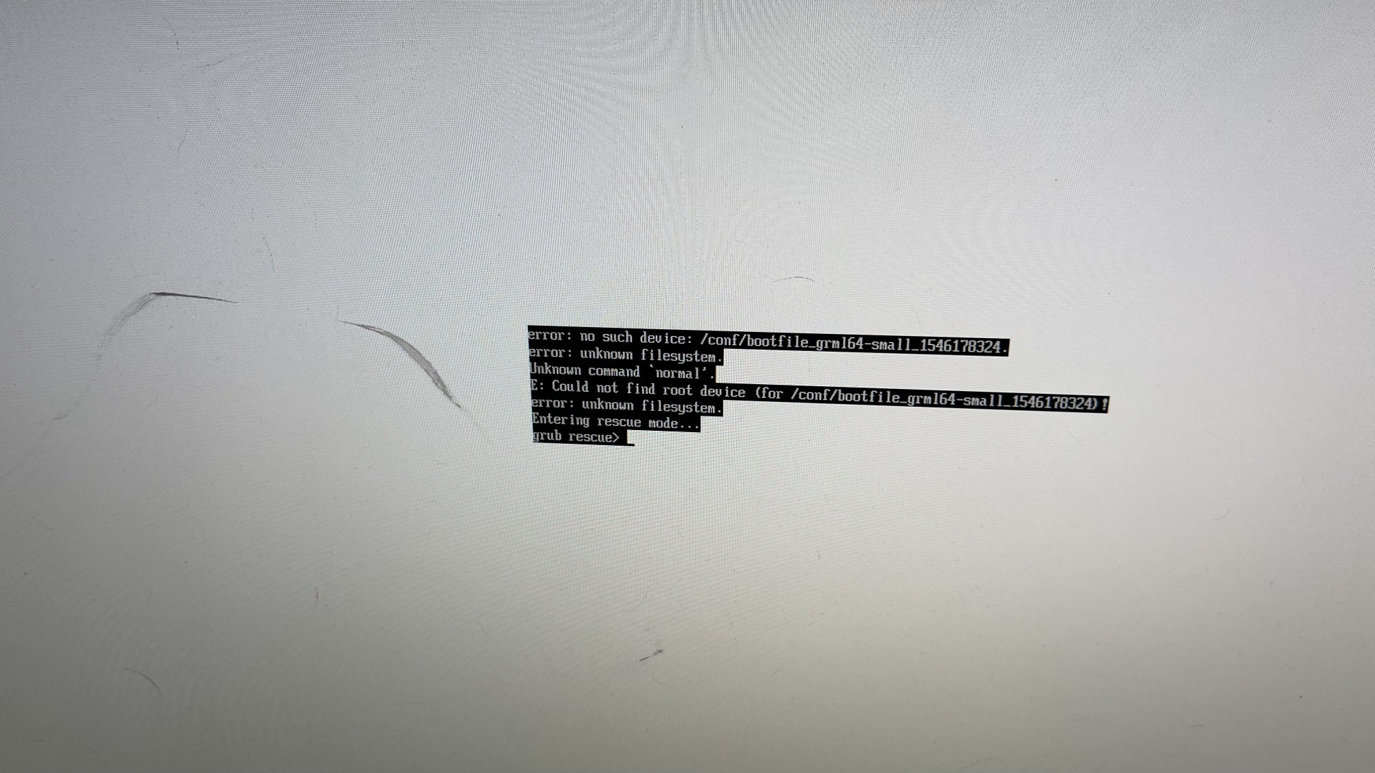

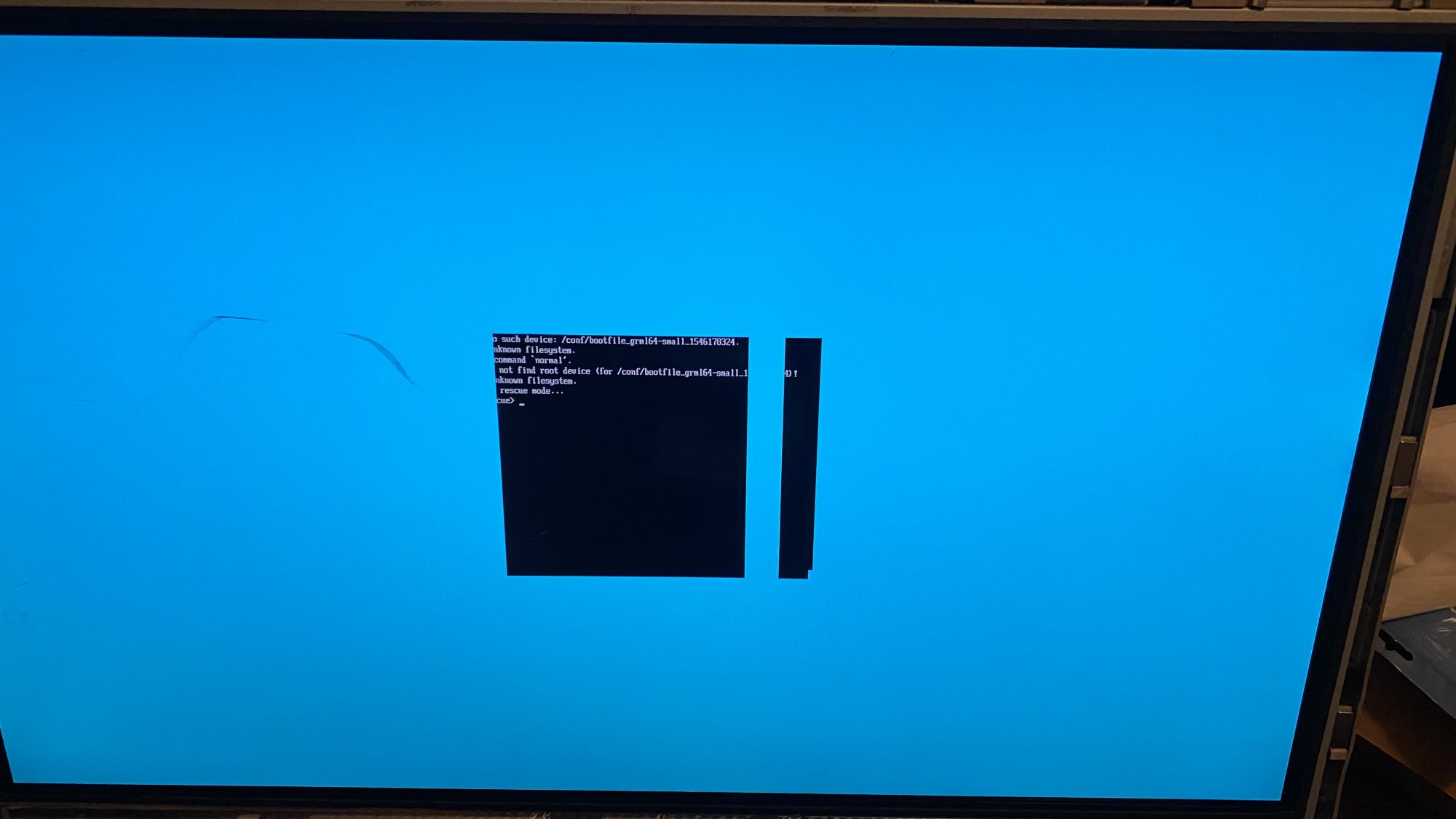

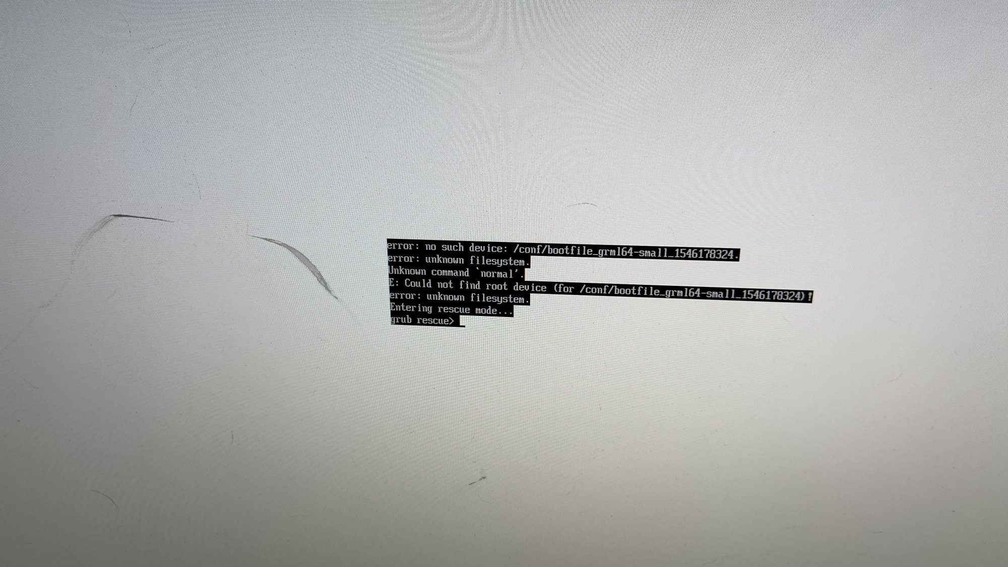

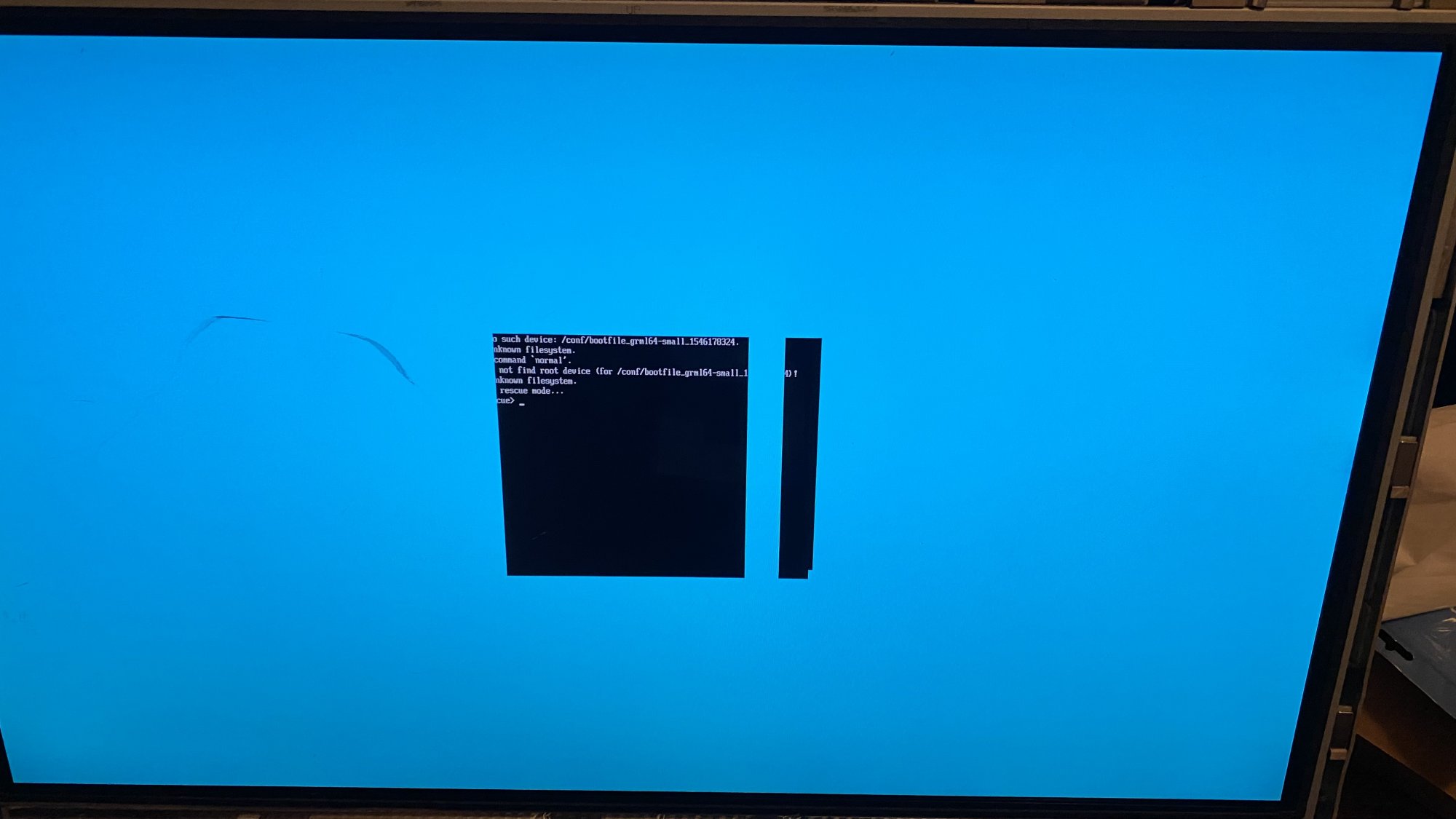

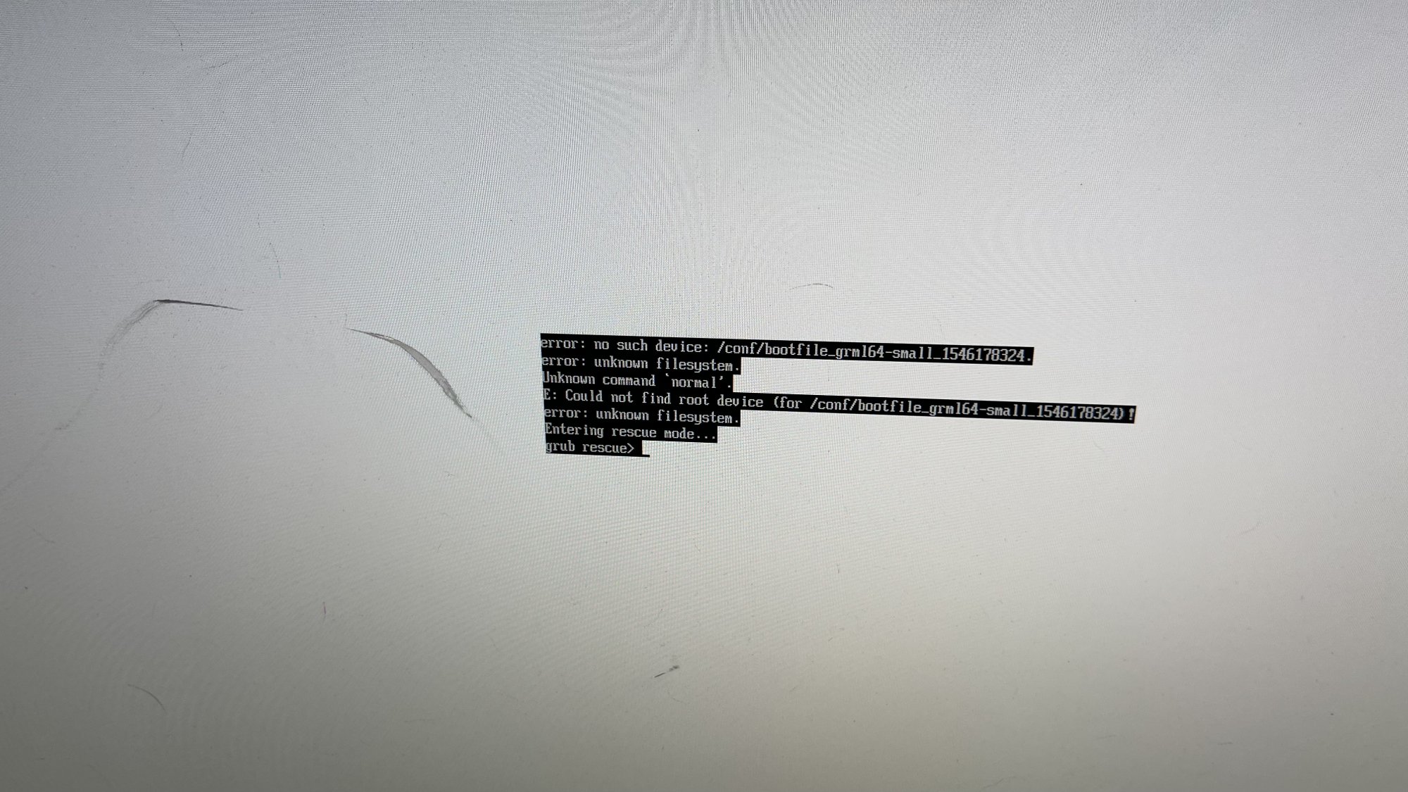

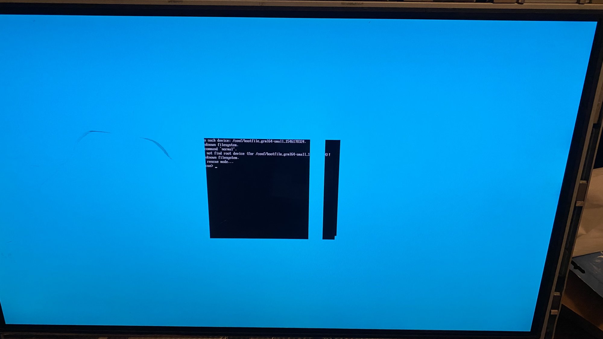

I have downloaded the file from the link and when I follow the directions this is what I get and it doesn't matter what usb stick I use or what computer. I have already flashed a handful of computers using this method, but the stick worked before and now nothing. Can someone please help me out.
I had a similar issue when my stick was formatted to NTFS... Make sure it is fat32 and try again.

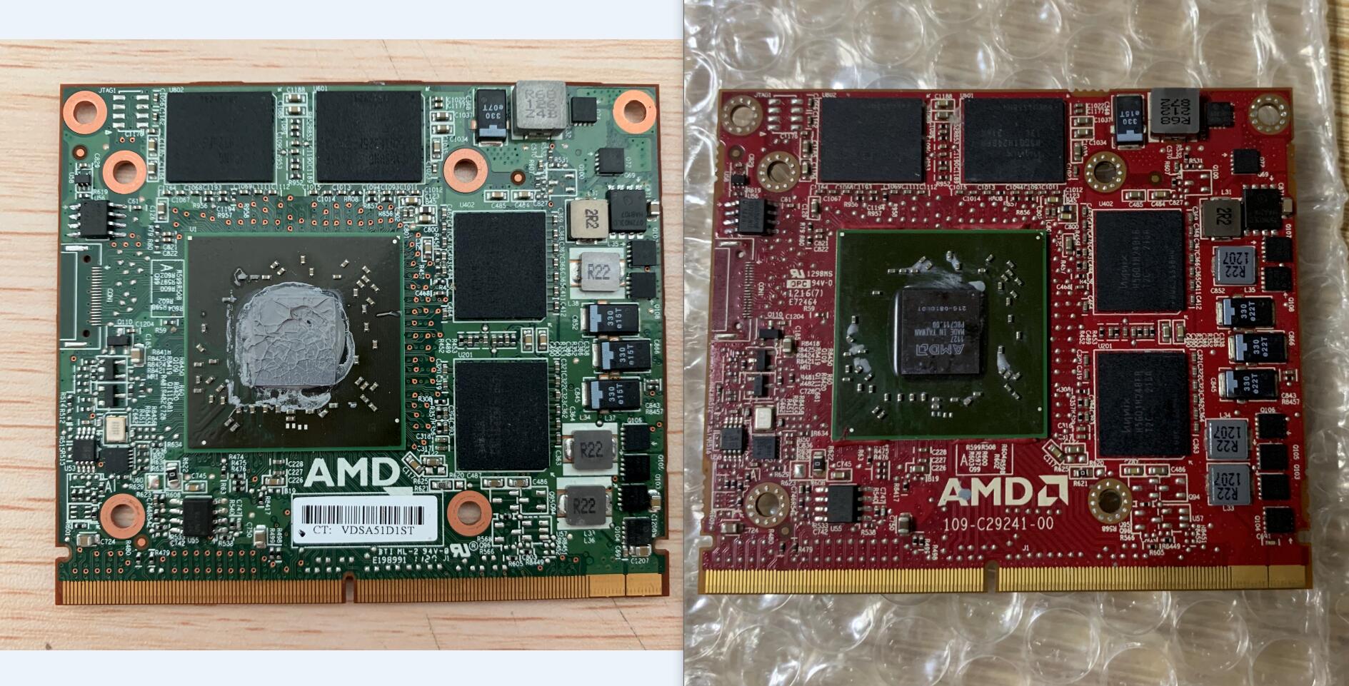

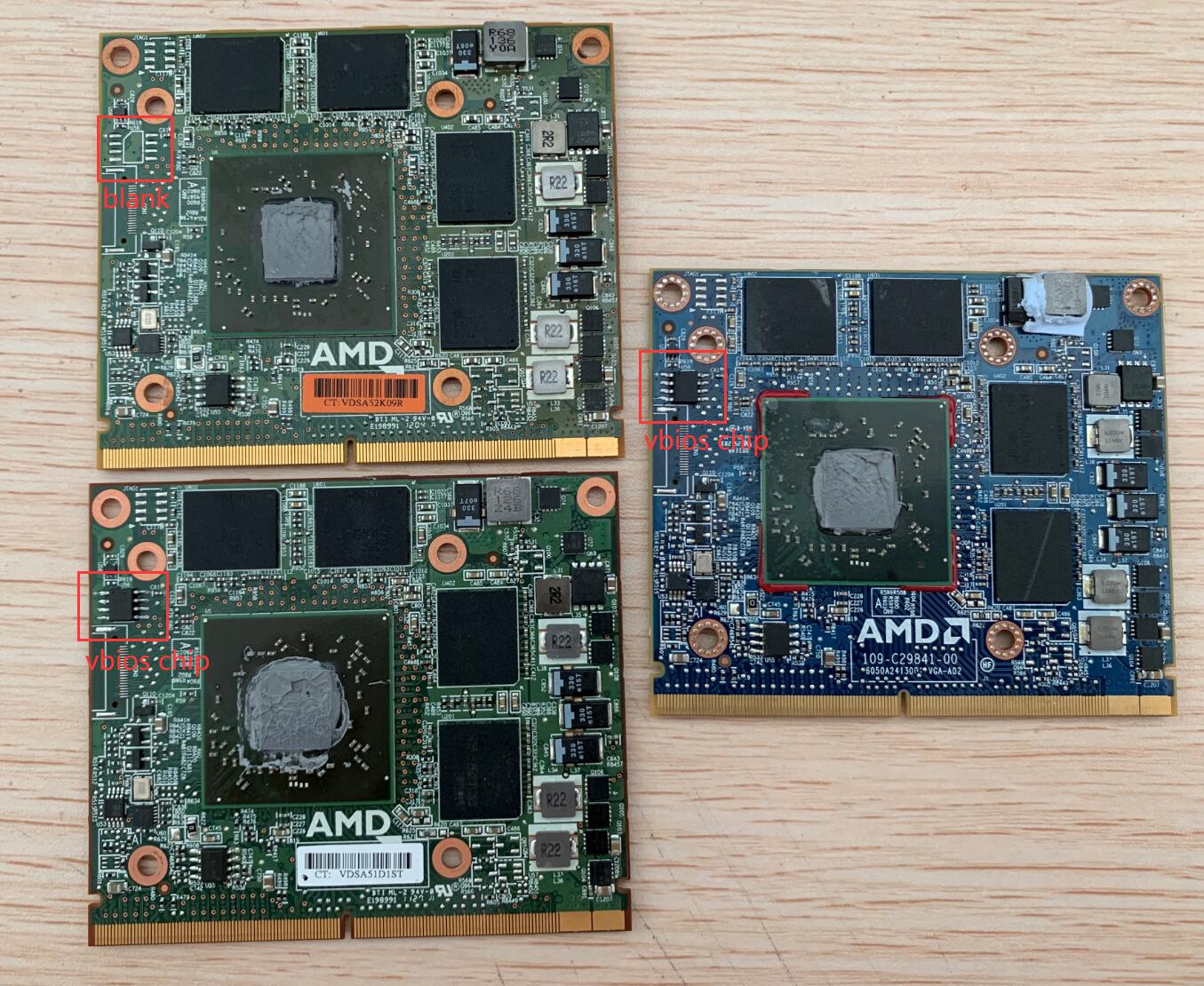

Dell red pcb vbios storage chip capacity is 64kb, need to replace 128kb or replace with a larger capacity. I am replacing the k610m like storage chip 256kb capacity. There is no problem using it.

My 880M video card works fine!!!
Sleep works without OPENKORE.
Brightness adjustment works without OPENKORE.
The temperature at high load is a maximum of 56 degrees!!!

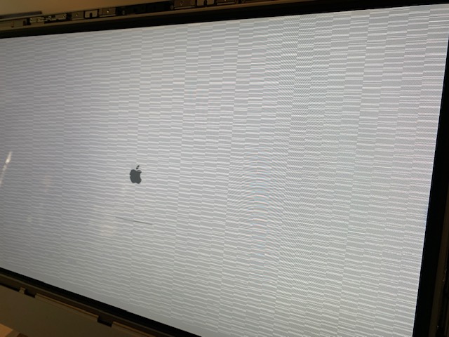

Well, after all that I suspect that the card is defective.
I was able to get the WiFi working. For those interested in the sequence of commands I'll put them at the end of this post.
I then installed the GTX880 into the iMac and booted the GRML stick. I was able to successfully log in via ssh, see the GTX880 card, save the original BIOS, load the 880M bios from this thread and then I put the display into the system.

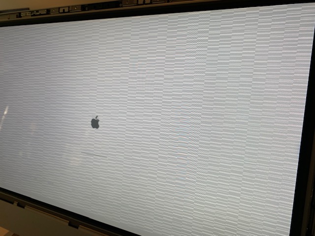

I can see the boot picker but the screen is scrambled. The system tries to boot but when it switches to turn the GPU on it crashes and reboots. Again putting the old Radeon 5750 back into the system and all is fine. (see photo)
so like I said all for naught. So close but no cigar....
