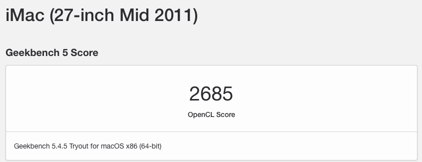

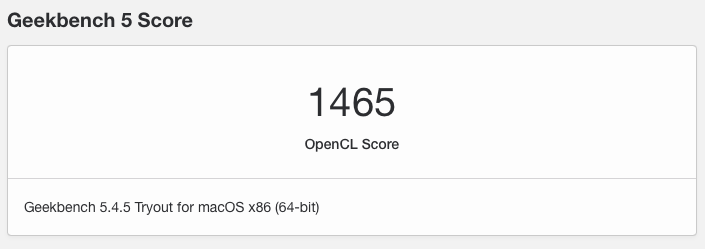

27" with a 6770m (2 heat pipe)

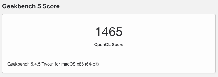

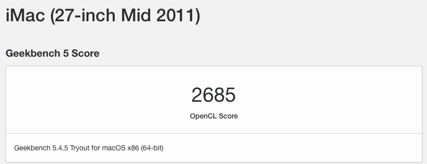

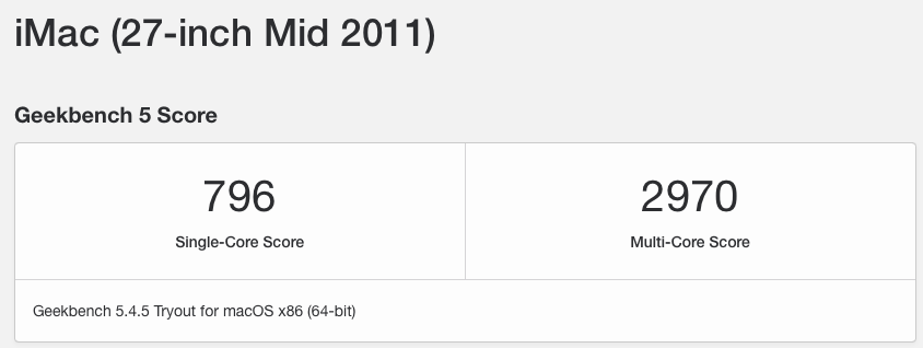

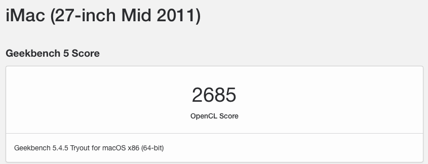

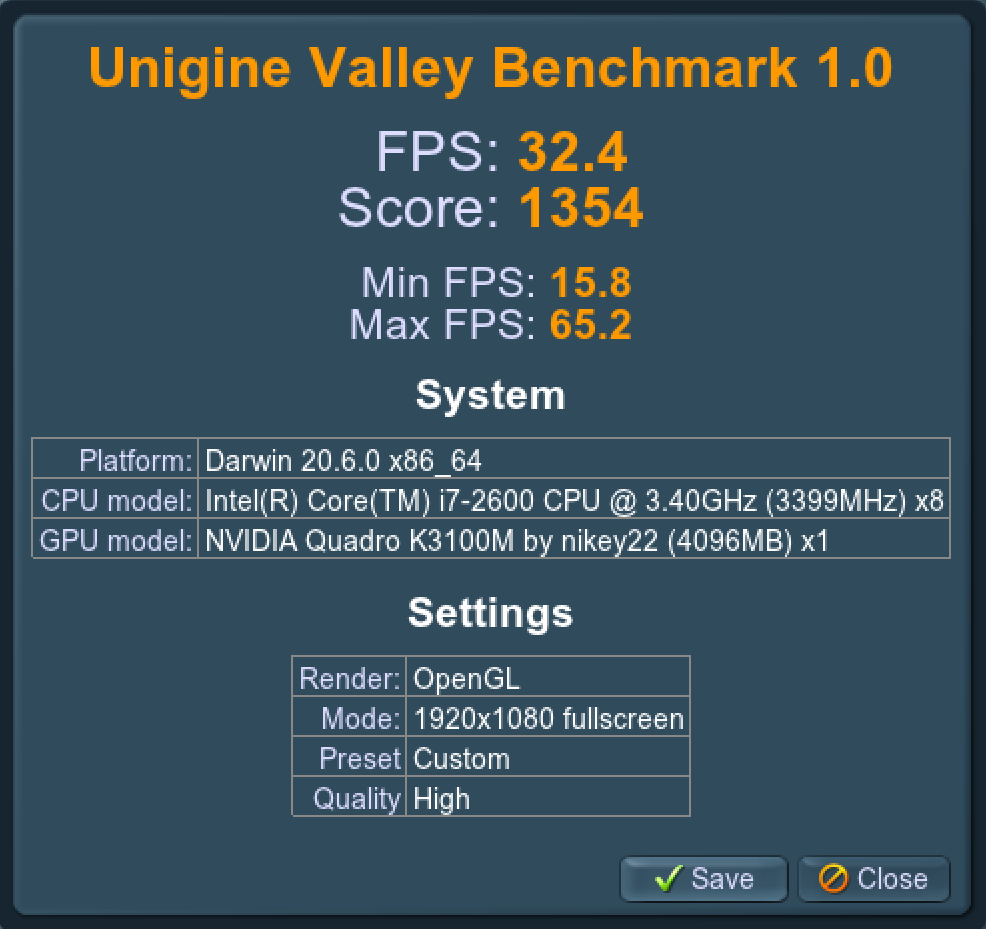

Have you run geekbench 5, perhaps your CPU is throttling?
yes GB5 was the first thing I ran actually, but I wasn't sure about it...

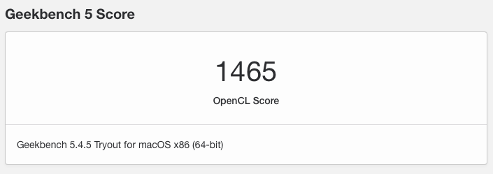

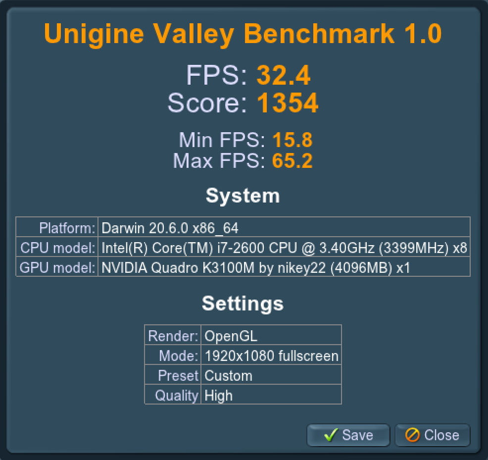

Full GPU Benchmark here (no result on depth of field!?)

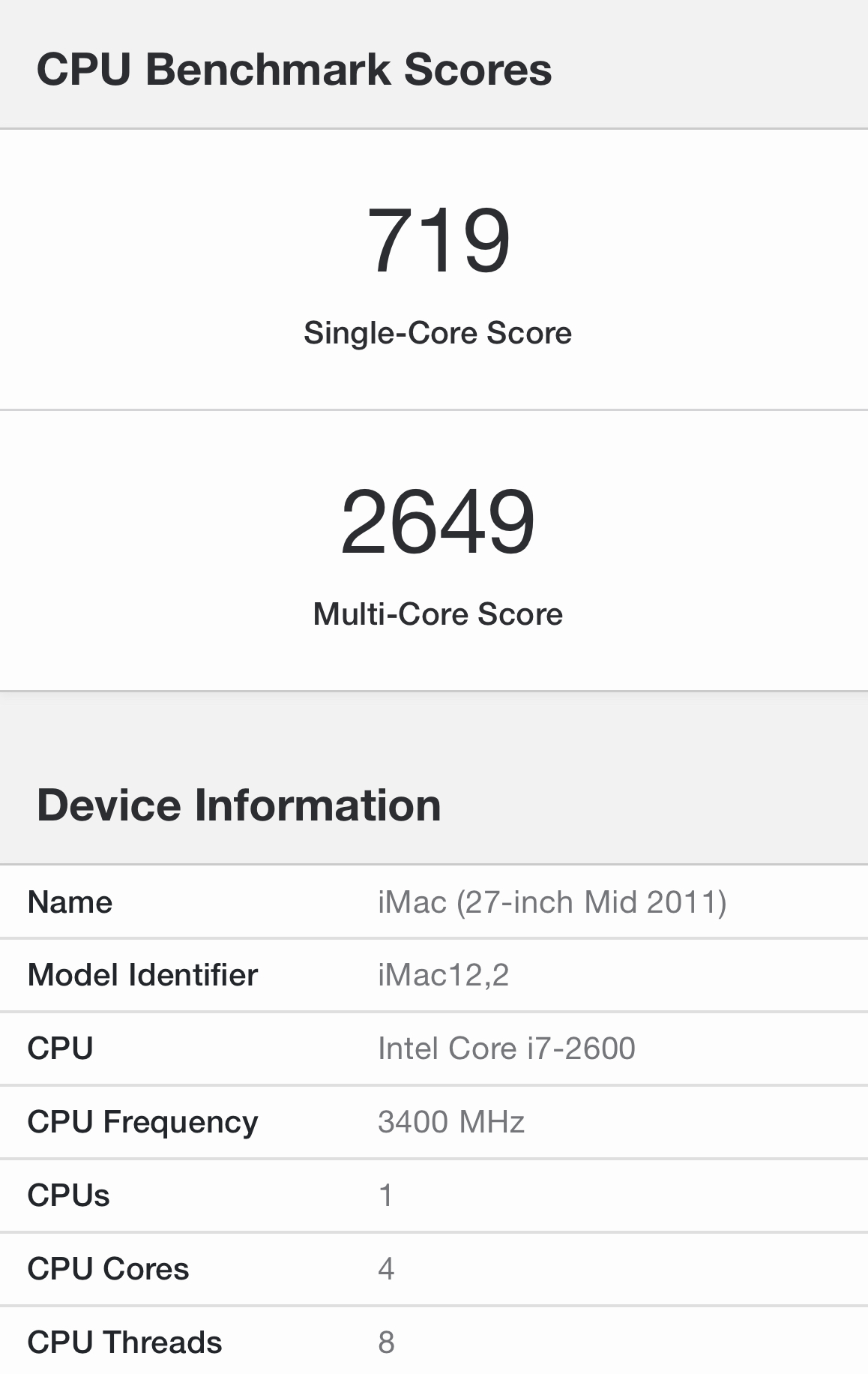

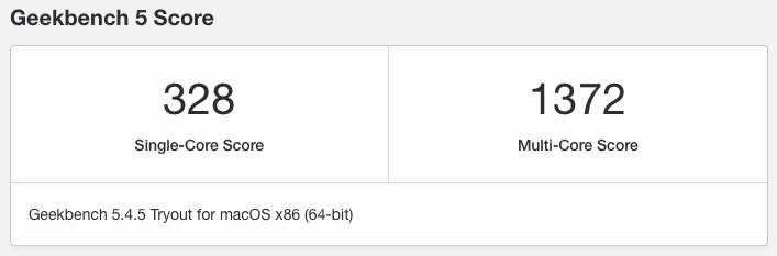

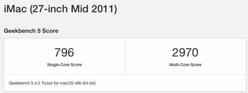

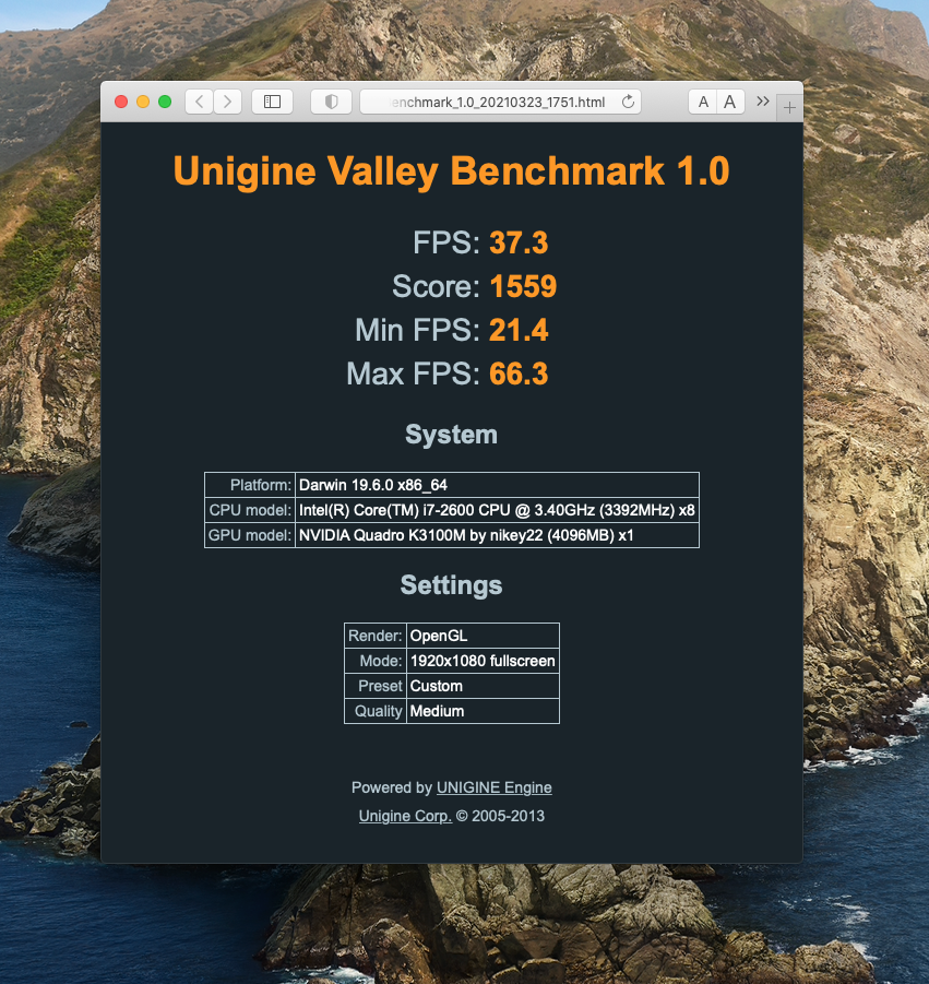

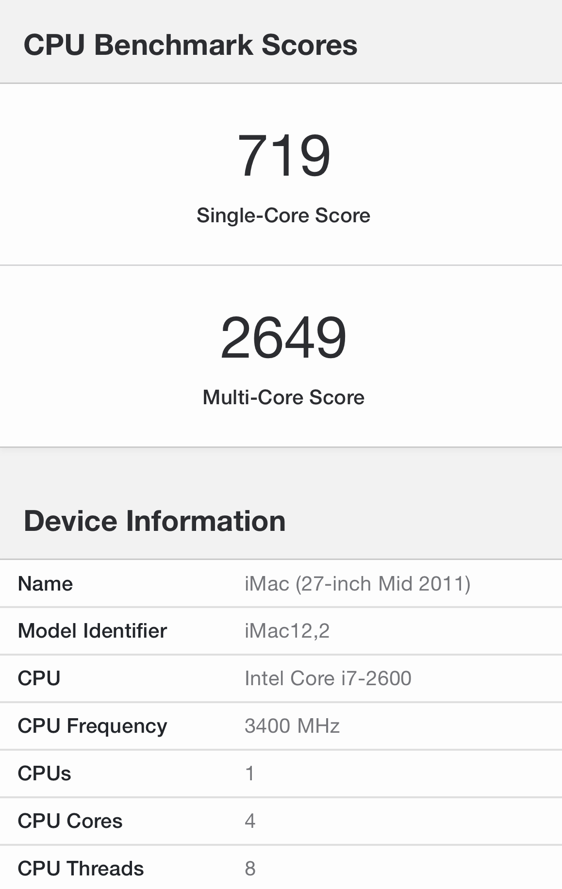

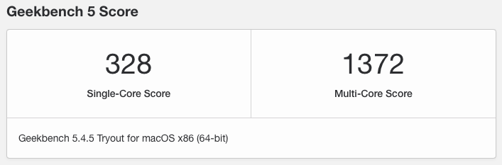

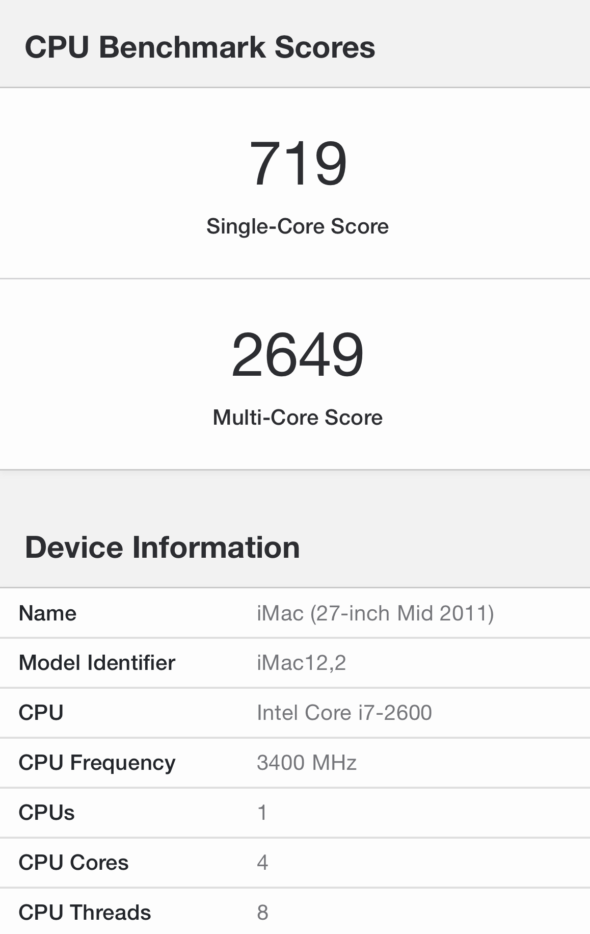

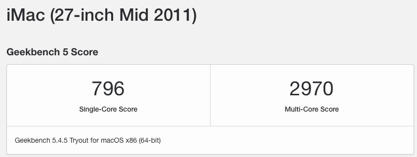

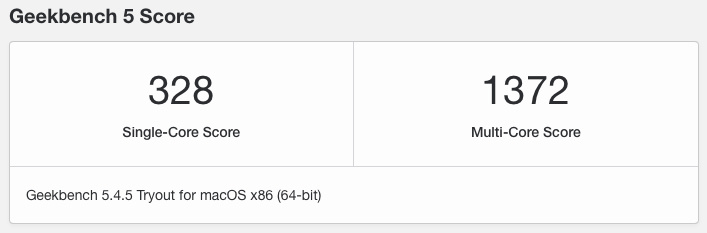

As I suspected your CPU is being throttled hence your low valley score, for your 2011 i7 you score should look more like this:
wow that's also double of my performance. 😵
any ideas what that might cause? could it be related to the gpu upgrade?
unfortunately I don't have a reference or benchmarks from before the upgrade
Here is the full CPU Benchmark.

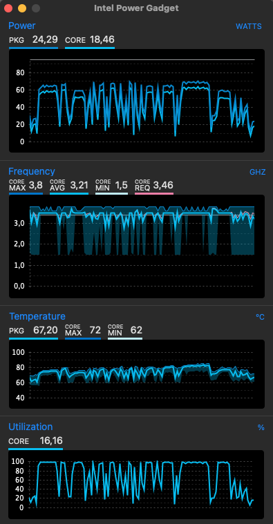

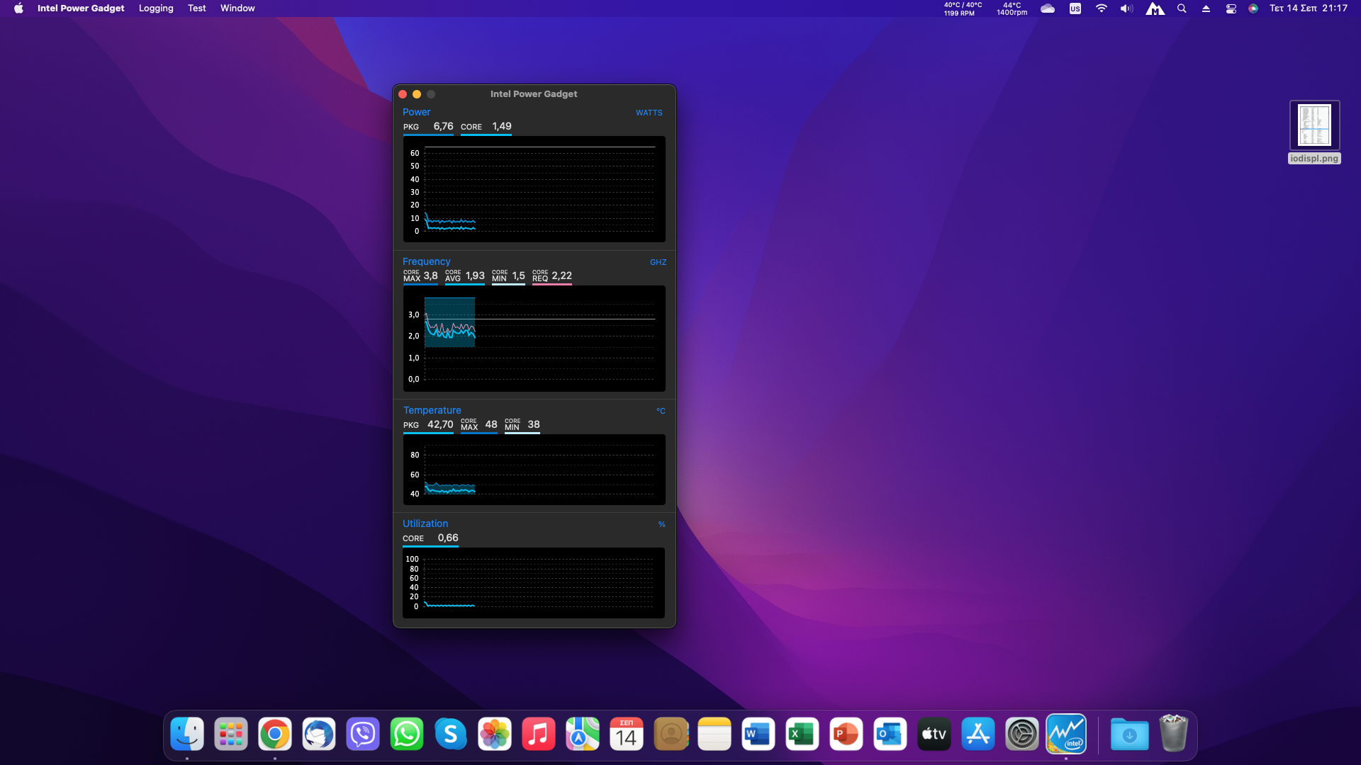

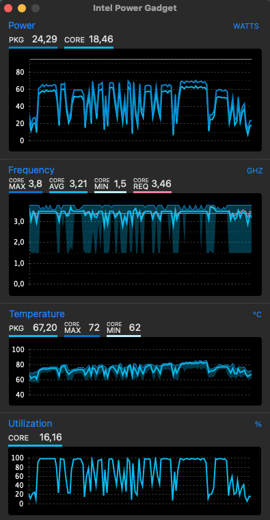

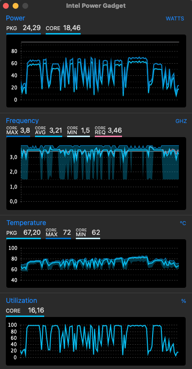

I tried to install the Intel Power Gadget to get some data, but the app crashes before on start...

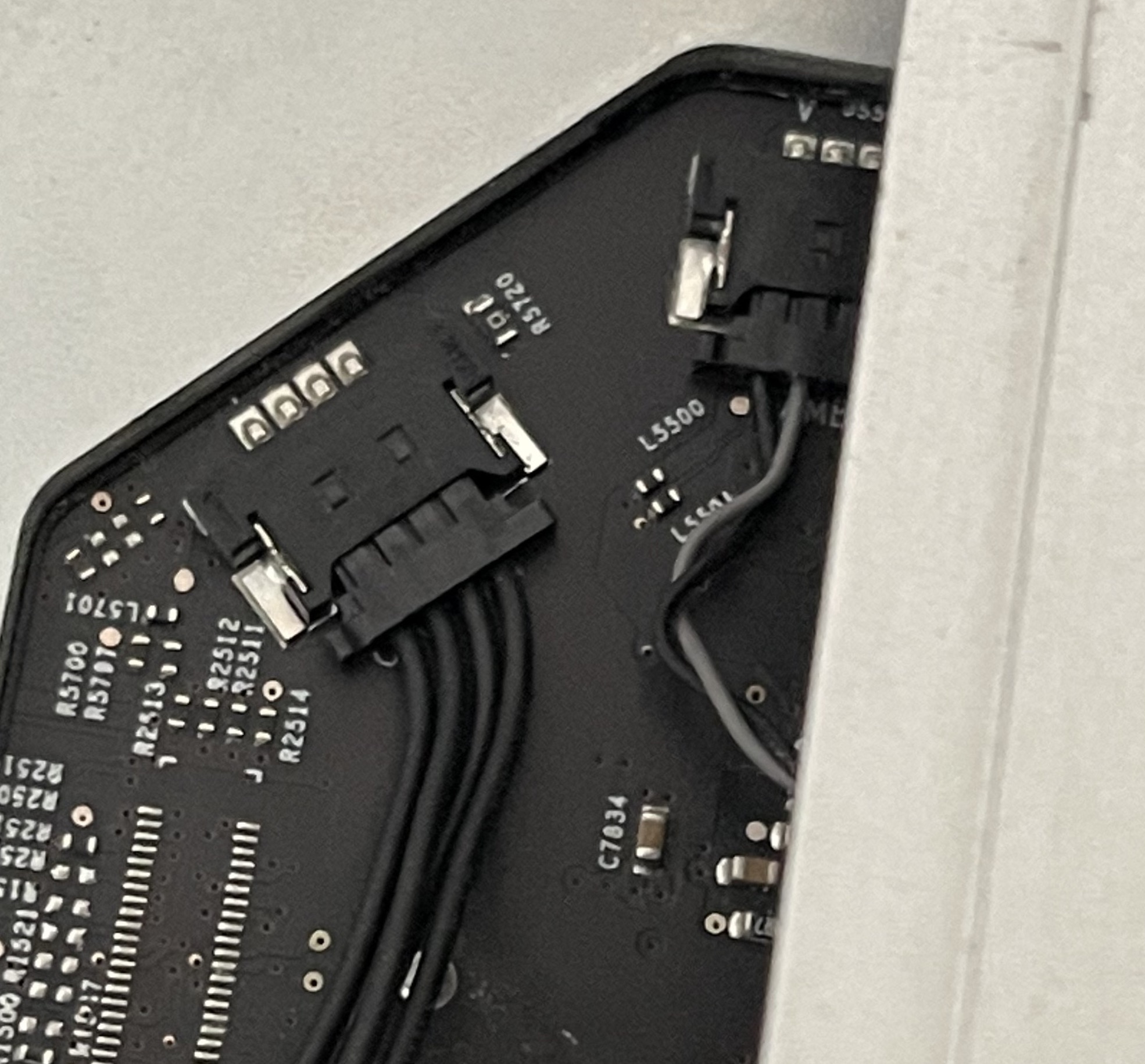

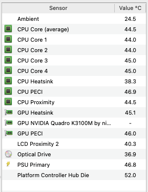

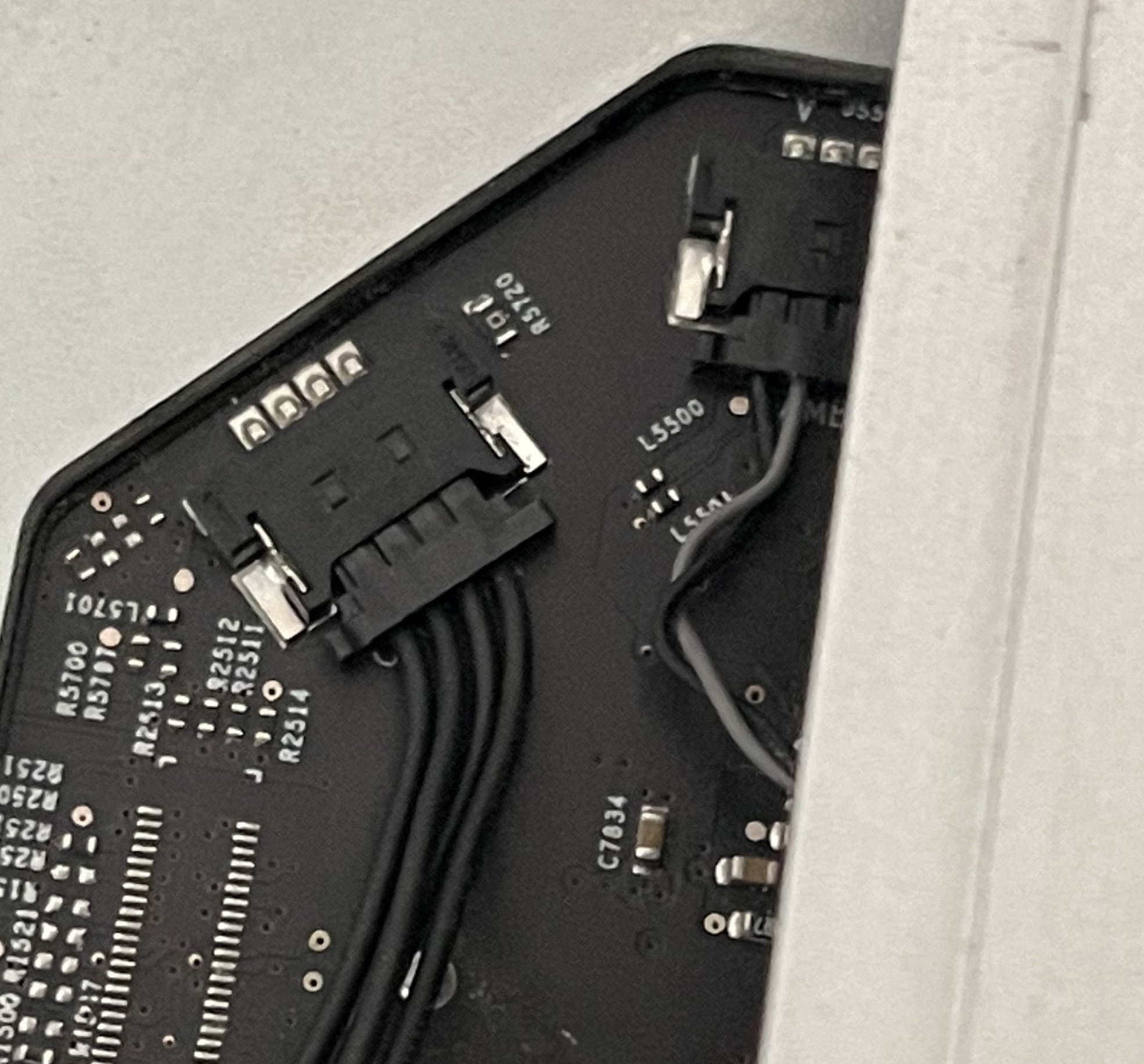

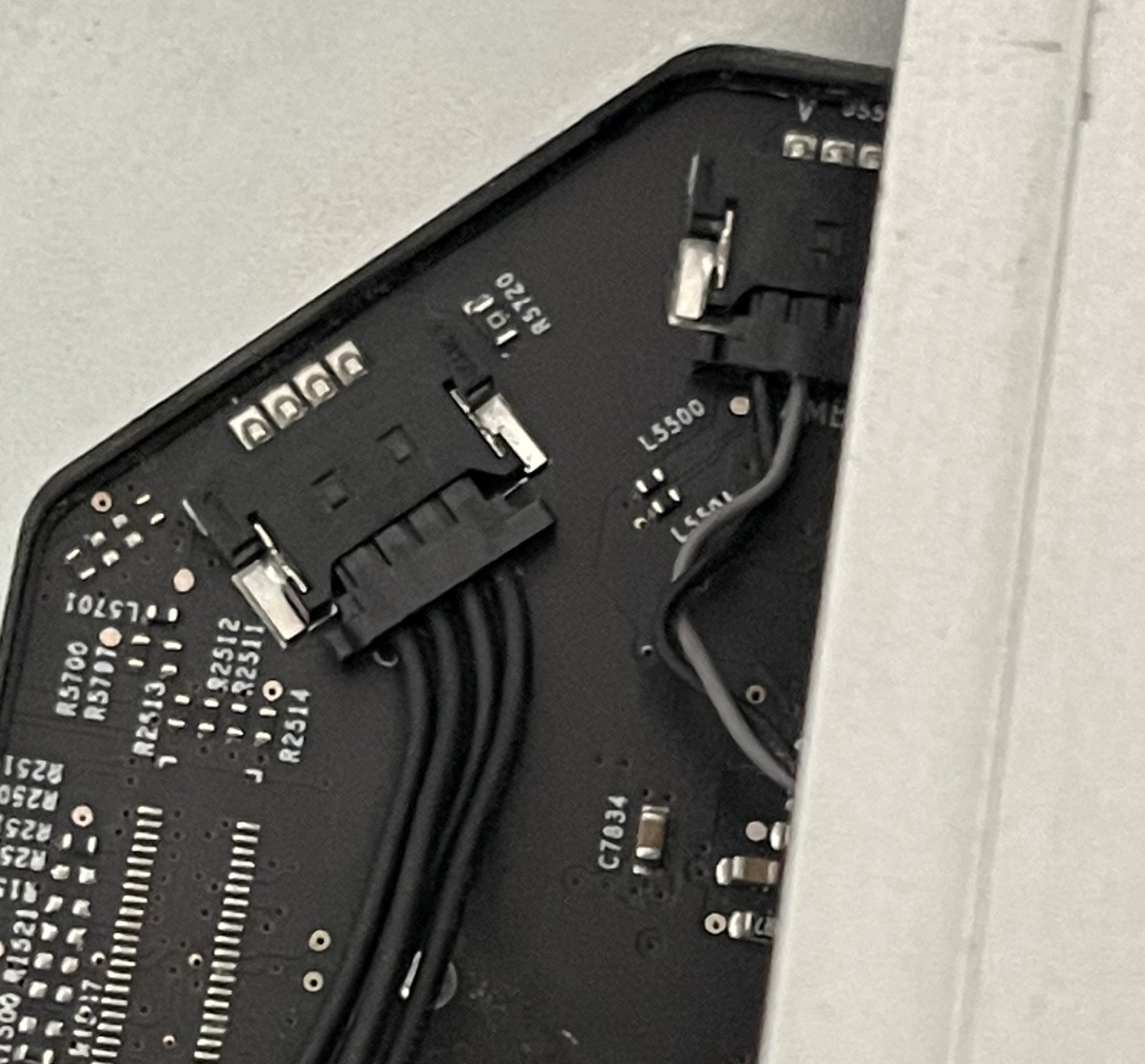

Check you didn’t knock off L5500 ferrite near the cpu fan convector. very easy to do. Search the forum for L5500 for more info.
But yes it’s CPU related.

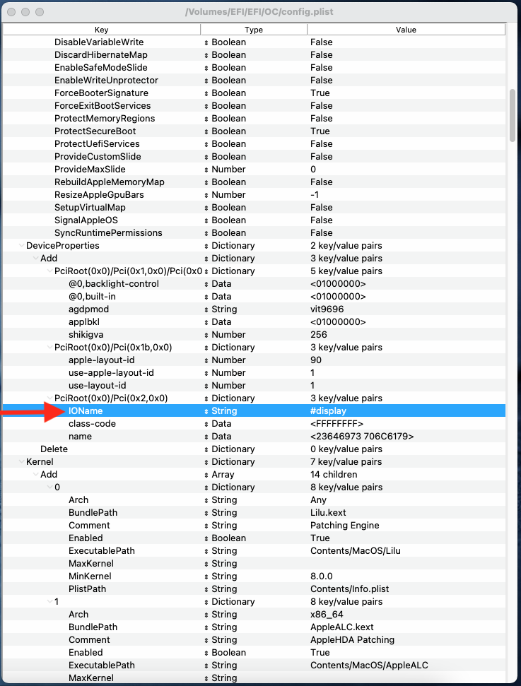

Have you recently checked the famous unknown documentation on hidden on the first post of this thread?
The S7100X can run in iMacs and can use the internal display, but there are a lot of problems with all GCN 1-3 dGPU models when used in iMac12,2 models. Now I am starting to repeat what we have tried to put into the docs.
BTW:
The iGPU within iMacs can not run the internal display!
I have checked the L5500 and it looks like its still there..?

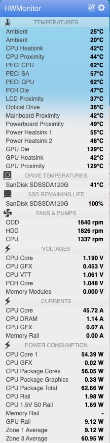

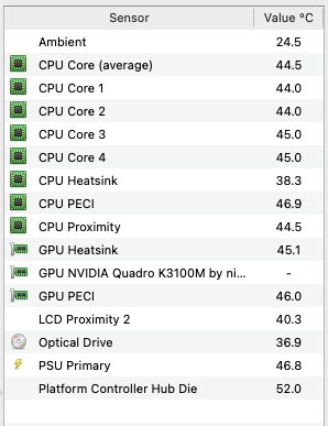

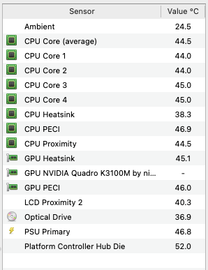

going through some post I found this
Yes, it is gone. You could have seen this using HW Monitor and checking the ambient temp sensor. It will only show 129C - with is equivalent to no data.
its mentioned that 129°C indicates no data... so when Unigine was showing "GPU Temp 129°C" is that related to the iMac not recognizing the GPU temperature sensor or not receiving data? can that be fixed for the GPU to be recognized?
temps-png.2062033
all my temps look fine, no issues here - I am also still trying to get the power gadget to work on the machine but it always crashes and gives me this error

anyone got an idea on why it crashes? is it because of the OCLP patches etc?
how else can I check what's causing the CPU to throttle?
of course physically check the CPU for damage and/or test it on another machine, but are there any other components that might cause issues?
thanks so far for the support
temps-png.2062033
- PowerGadget crashes because of OpenCore and the way it is disabling the iGPU and I will not help since you already know the CPU is crippled in some way
- Macs Fan Control does not show all temp sensors in exactly the same way as HW Monitor and other tools.
- The first post has a hardware problems section. You could have checked this days ago...this is possibly the most important hint.
Reactions: FlorisVN
Huh. Guess that's what happened with my first project and never realized. No wonder the fans spun up immediately... I was never able to locate the sensor info on HW monitor though (as in, I couldn't locate the sensor showing 129°). Oh well, I no longer have that system.
My "fix" for that system was only a partial one, since it only worked on Windows: use ThrottleStop and disable BD PROCHOT.
EDIT: I never realized there was a HWMonitor app for mac 🙃, I kept thinking it was the Windows app. At least I'm learning more, haha.
I see, I wanted to have a graph to see when it throttles but whatever - the CPU should not be broken or anything its just not able to boost for some reason. AHT didn't show any errors, I went through most of the things here already.
I have read a good amount of posts (including yours) on multiple threads here and also ifixit but they always go back to the same issue of L5500 - which doesn't seem dead to me - temperatures have been check on multiple tools.
like I said, its only the GPU that shows 129°C - the only thing I didn't do is to move the ODD sensor on the GPU and see if it still throttles. or does this "missing" sensor not affect the SMC to allow CPU boost? since it is not mentioned in your post #9,047 , that relocating the ODD sensor to the GPU will solve this.
also in regards to testing, your link to a specific ASD version for 2011 iMacs ASD has only the docs but not the actual software?

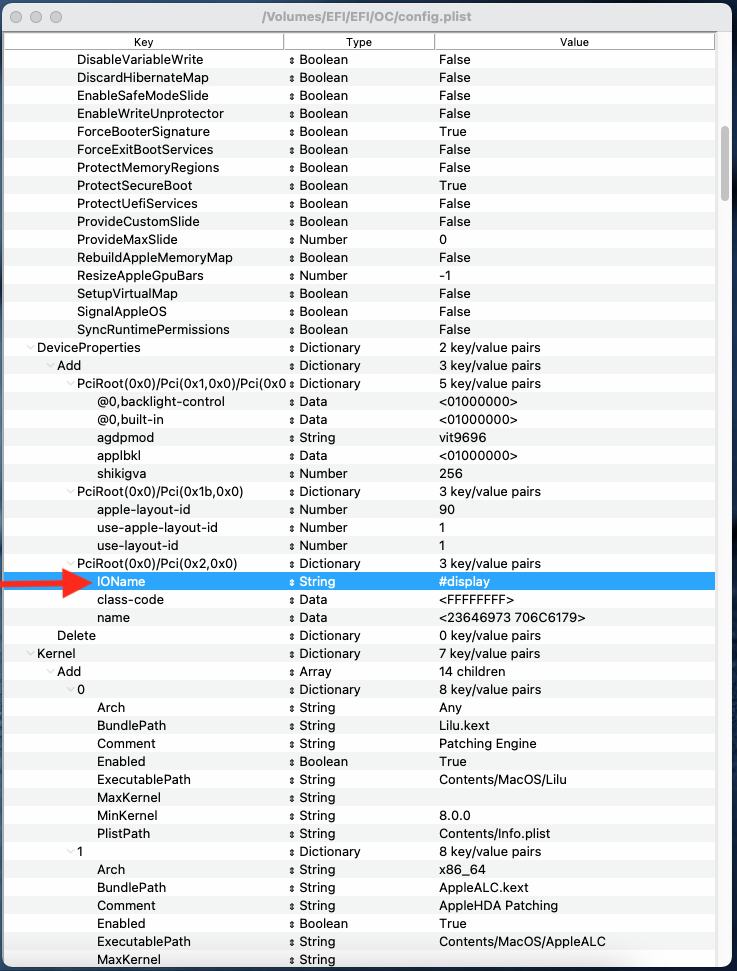

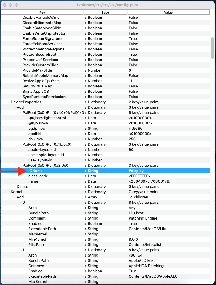

To get intel power gadget working:
1. Use any tool or terminal commands you are comfortable with to mount the EFI partition. I use opencore configurator.
2. Use "proper tree" app (or any other tool you prefer) to open the config.plist file (located inside /EFI/EFI/OC folder).
3. Delete the line that says "IONAME... String....#display" under device properties.
4. Save changes in config.plist. (File --> Save)
5. Reboot.
After the reboot your intel power gadget should be working.
5. Reboot.
thanks for the explanation! it worked! 😀
also the CPU seems to work fine now, GPU is also scoring as it should
I guess the performance is now ok, the only thing that is bothering me is a a high pitched sound that appears to become more frequent & intense, but I can't locate it exactly... 🥲
update: it actually stopped before the iMac went to sleep (dimmed lcd) so I tried to play around with the brightness and it is absolutely causing the noise! so if I turn down the brightness no sound....
