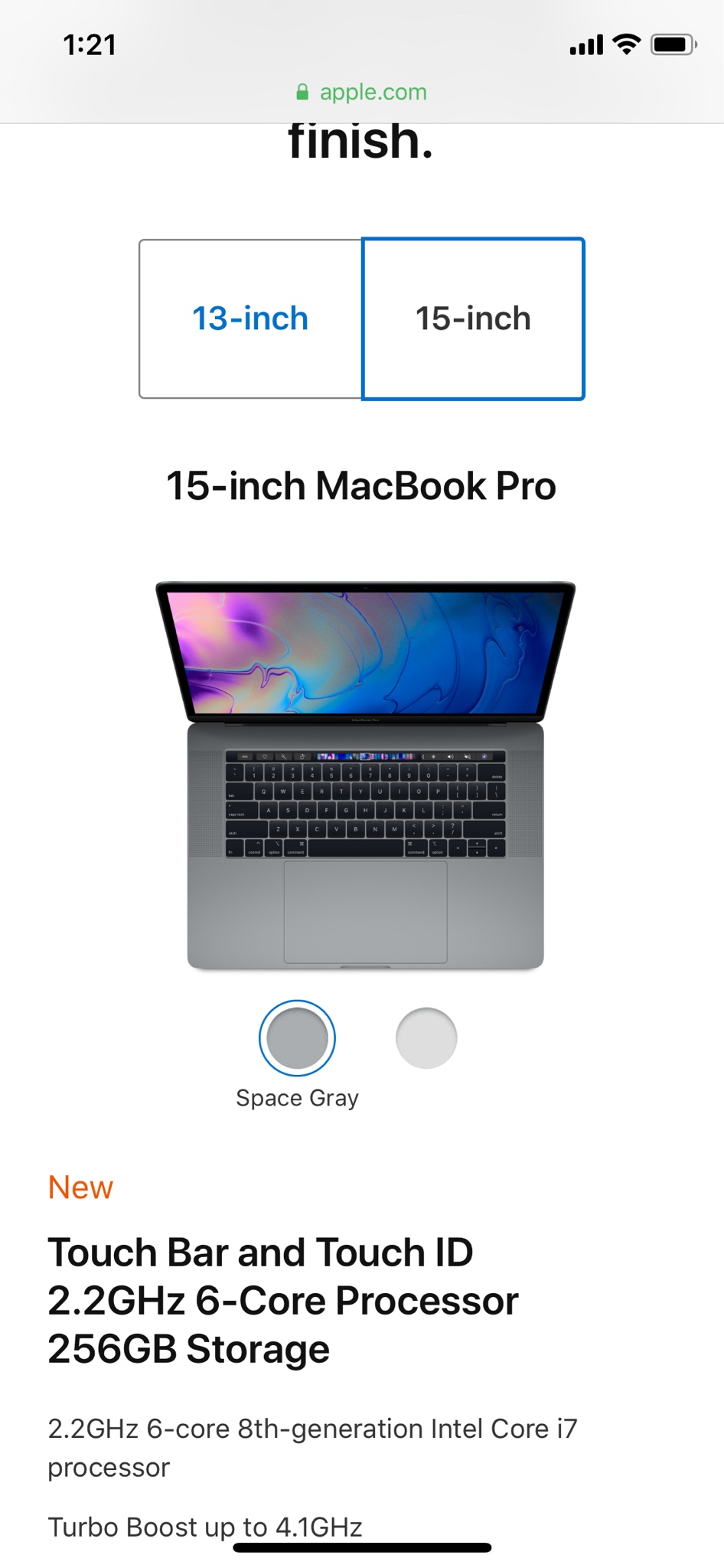

He ment i7 2.6.
Since base is i7 2,2 and upgrade is i9 2,9.
And yes, all three are six cores.
There is no option for i7 2.2 GHz on the 15" rMBP which Jon is talking about. The 15" rMBP starts with i7 2.6 GHz. That is the base version.
Dude what are you talking about ? Don't confuse others and everyone else here !!
Reactions: OC40 and Ploki
Oh Ok !! My Bad....:mad:
But he hasn't mentioned anything specifically, He just says Mid-Tier 6 Core model, He does not say 2.2GHz i7 or anything higher ? So What does Mid-Tier 6 Core Model mean ?
Yes, there is an option for an i7 2.2 GHz (low tier). The 2.6 GHz is the mid tier version!
Edit: I am a bit to late with this post. I see you already noticed. Consider this as not posted.
