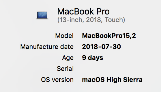

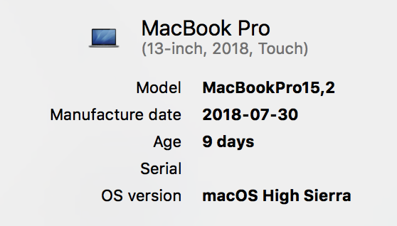

I am not sure that is correct. Coconut battery shows mine as manufactured July 30 2018, and that was the day I received it FedEx!
9 days old? Seems very unlikely to me.
That’s actually the same manufacture date as mine and it arrived 8/1. It would seem you need to take Coconut Batteries info with a grain of salt
The manufacture date is indicated by the fourth and fifth digits of the serial number, and is only the week in which it was made rather than an exact date.
For whatever reason, coconutBattery takes the last day of that week as the manufacture date; in reality it could have been up to a week prior to that date.
Though it is perfectly possible to possess a MacBook Pro manufactured nine days ago, especially if bought from an Apple store. Their shipments come much faster than our online orders arrive, because they are part of a large batch that goes to a single address and uses a quicker delivery service. I once had a 2016 MacBook Pro that coconutBattery indicated was three days old (so in reality potentially 10 days old, but still...).
That would make some sense. As much as I would like to believe they overnighted mine from Shanghai, I am sure they didn’t.
I placed the order 7/25 or 26, I forget which. So that’s probably closer to the correct date of manufacture from what you are saying

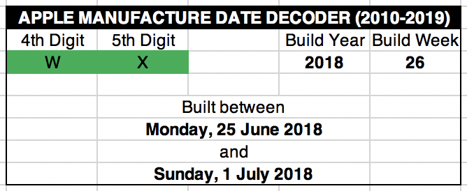

The fourth character of the serial is a six month period. E.g. V is second half of 2017, W is the first half of 2018, and so on.
The fifth character of the serial is the calendar week within that six month period. E.g. 1 = first week, and so on until 9, and then C is 10, D is 11, and so on until X which is 26 (some letters like I, O, are missed out because they can look like 1, and 0, and vowels are also removed).
For example, my MacBook Pro's serial is C02WX*******
  • Fourth character: W, which means the first half of 2018
  • Fifth character: X, which means the 26th week of that half
  • Which means built between 25 June and 1 July

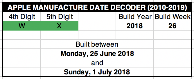

I actually made a spreadsheet a while ago to work it out for me because I'm sad like that... :D

Let's pick another example made in the second half of a year. For example C02SV*******
  • Fourth character: S, which means the second half of 2016
  • Fifth character: V, which means the 24th week of that half
  • Which means 26 weeks (first half) + 24 weeks = 50th week of 2016, so 12-18 December
More info: https://beetstech.com/blog/decode-meaning-behind-apple-serial-number

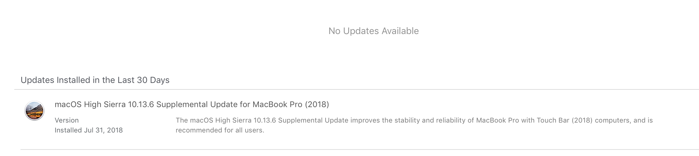

As a data point for those trying to put together patterns, my MBP is one that has not experienced any Bridge OS kernel panics, T2 firmware 15P6703. I had issues getting a migration from old mbp to work, I ended up doing a MacOS recovery the week of July 30 (I got the laptop on July 30), and I am pretty sure what it downloaded was an OS with the supplemental update already included. If I check now, it shows the supplemental update as an update performed when I look at Updates in the Apple store, but it does NOT report that update, like another mbp does, when I look at the MacOS version in About this Mac. (where the supplemental update will show). I can confirm with the utilities that the supplemental update is there and working properly when I loid test the laptop. See images below ...

As a data point for those trying to put together patterns, my MBP is one that has not experienced any Bridge OS kernel panics, T2 firmware 15P6703. I had issues getting a migration from old mbp to work, I ended up doing a MacOS recovery the week of July 30 (I got the laptop on July 30), and I am pretty sure what it downloaded was an OS with the supplemental update already included. If I check now, it shows the supplemental update as an update performed when I look at Updates in the Apple store, but it does NOT report that update, like another mbp does, when I look at the MacOS version in About this Mac. (where the supplemental update will show). I can confirm with the utilities that the supplemental update is there and working properly when I loid test the laptop. See images below ...View attachment 775095View attachment 775096

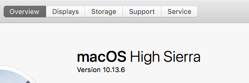

I don’t think “About This Mac” will ever show the supplemental update (mine definitely doesn’t!), however you can click and it’ll show you the build number, which should be different to pre-supplemental update.
