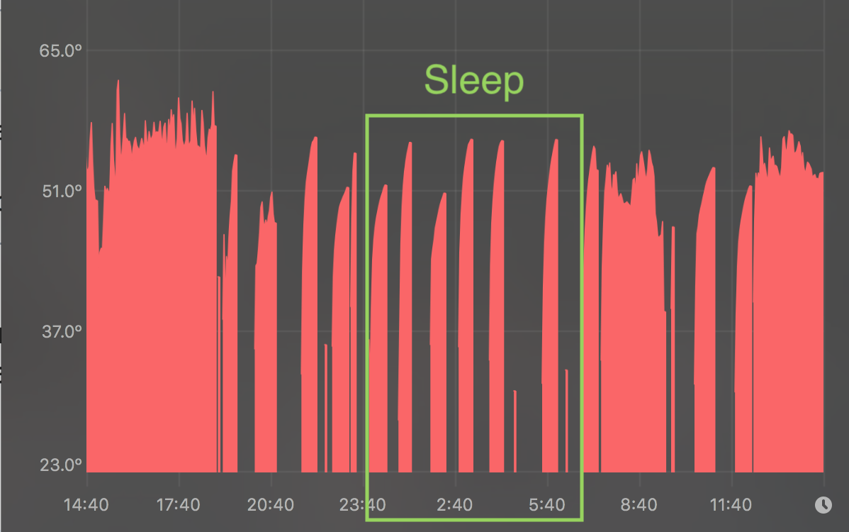

Adding a new data point with 2018 15" i9/32GB (High Sierra 10.13.6 with supplemental update, BridgeOS firmware 15P6703):
four days ago, first KP on day 16 while in sleep with TB3->TB2 connected to Apple Thunderbolt Display. Checked the log, viola bridgeOS.
I haven't experienced the same KP for the last three days.

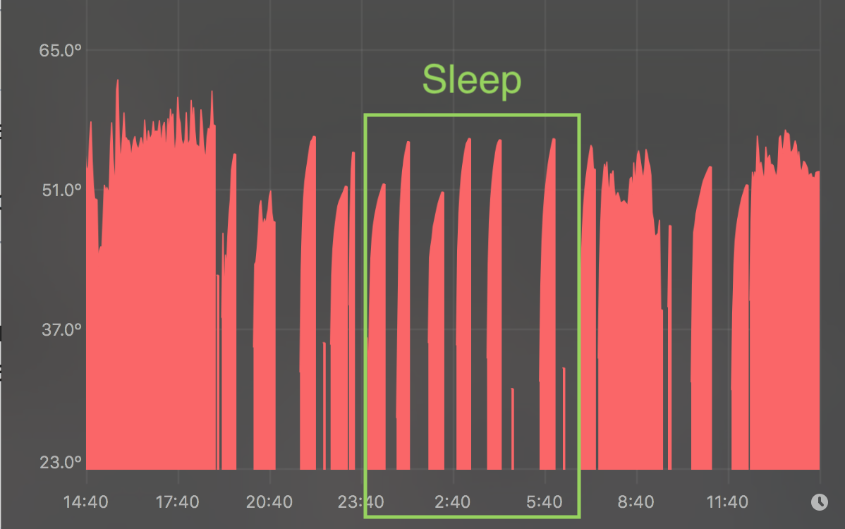

One strange thing I noticed though:
it's known that MBP can wake up by itself during sleep, usually it's only for short period and it shouldn't heat up much (DarkWake, I assume this is Power Nap). But with this MBP I often observe extended wake period (30 to 60 minutes) with the machine heating up to typical operational temperature. I went through all the logs, no clue so far.
mac_sleep_issue-png.775456
I had monitor tool running when it's awake (see attach pic). it happens rather inconsistently (0/1 per night to 4-5 times per night) .
Btw, I usually have the machine attached to power and DELL U2718q monitor (via USB C to DisplayPort cable) during sleep. My machine does have FileVault turned on from day 0.
I spoke to Apple Support yesterday. Their reaction "What do you want us to do?" and offered for an appointment with local Genius Bar.
If replacement is really a fix I might go down that route if it happens again.
