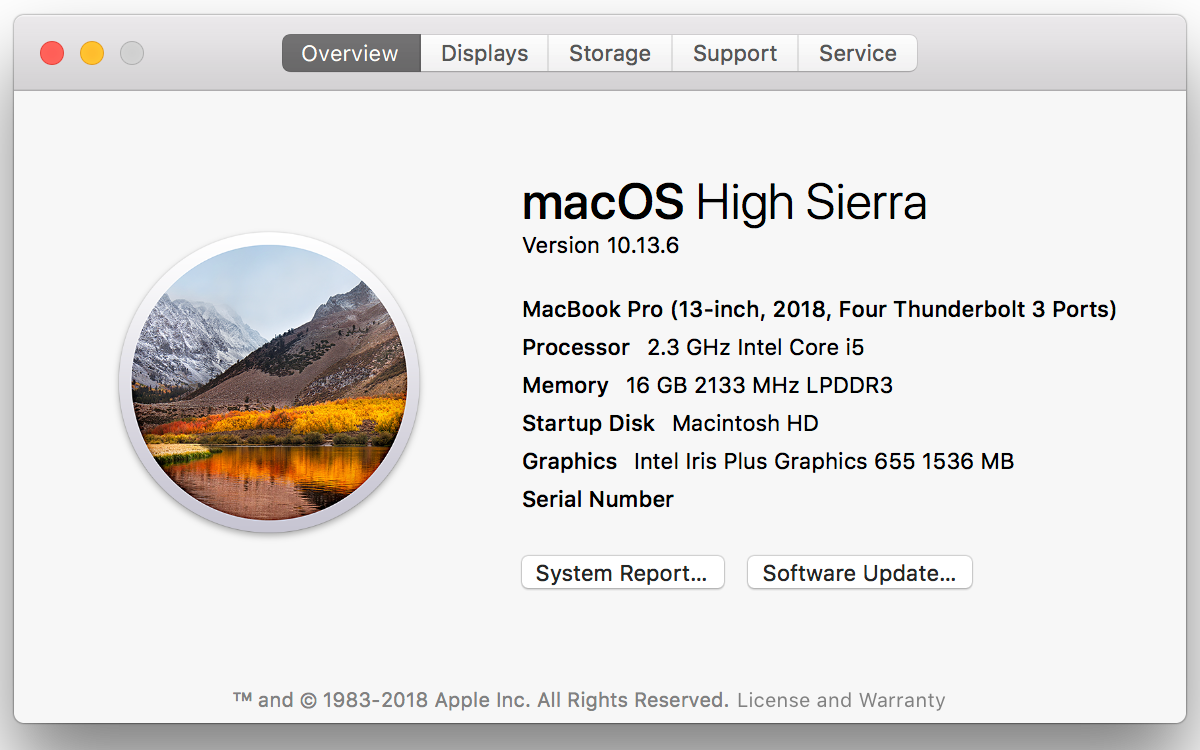

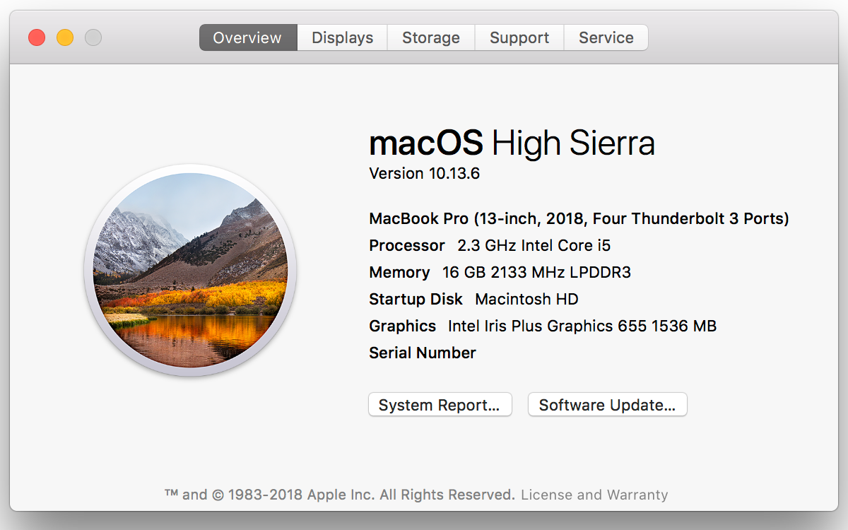

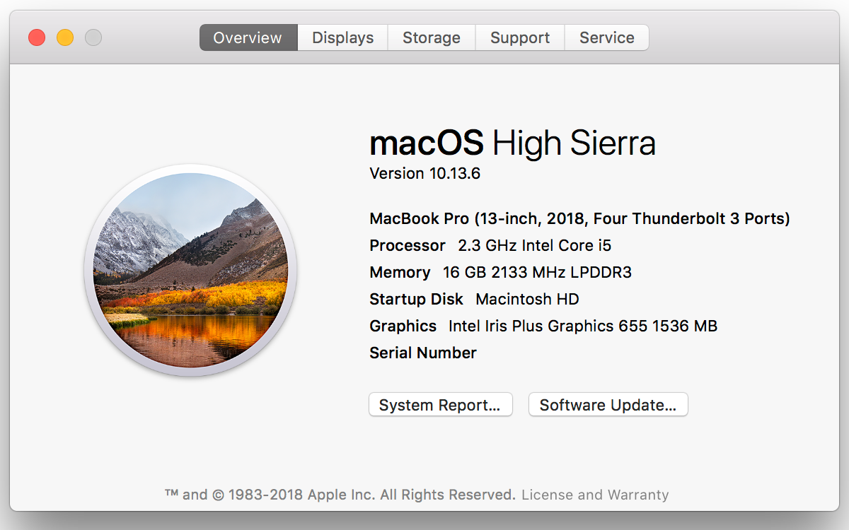

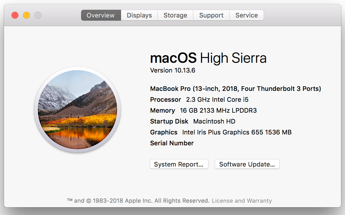

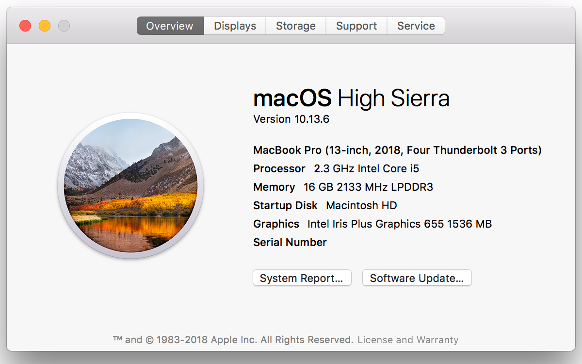

Is this your model ? “2018 MacBook Pro 13" with Touch Bar - 2.3GHz i5 - 16GB RAM - 512GB SSD"
