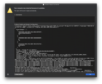

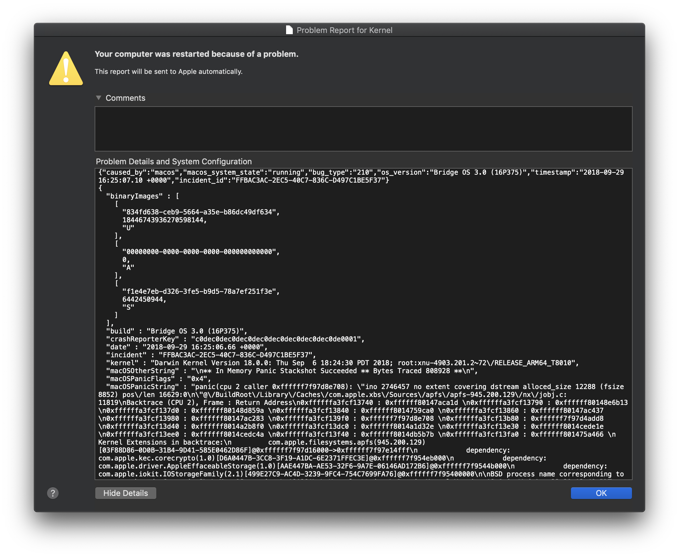

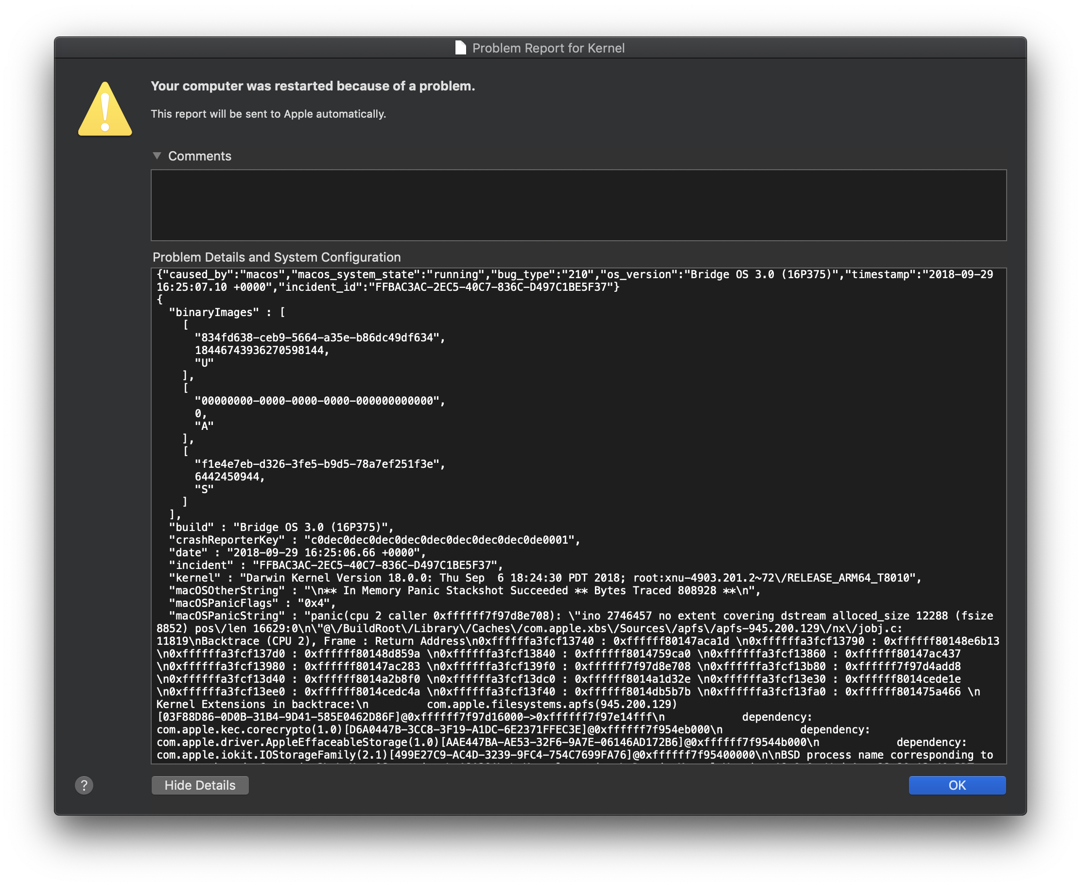

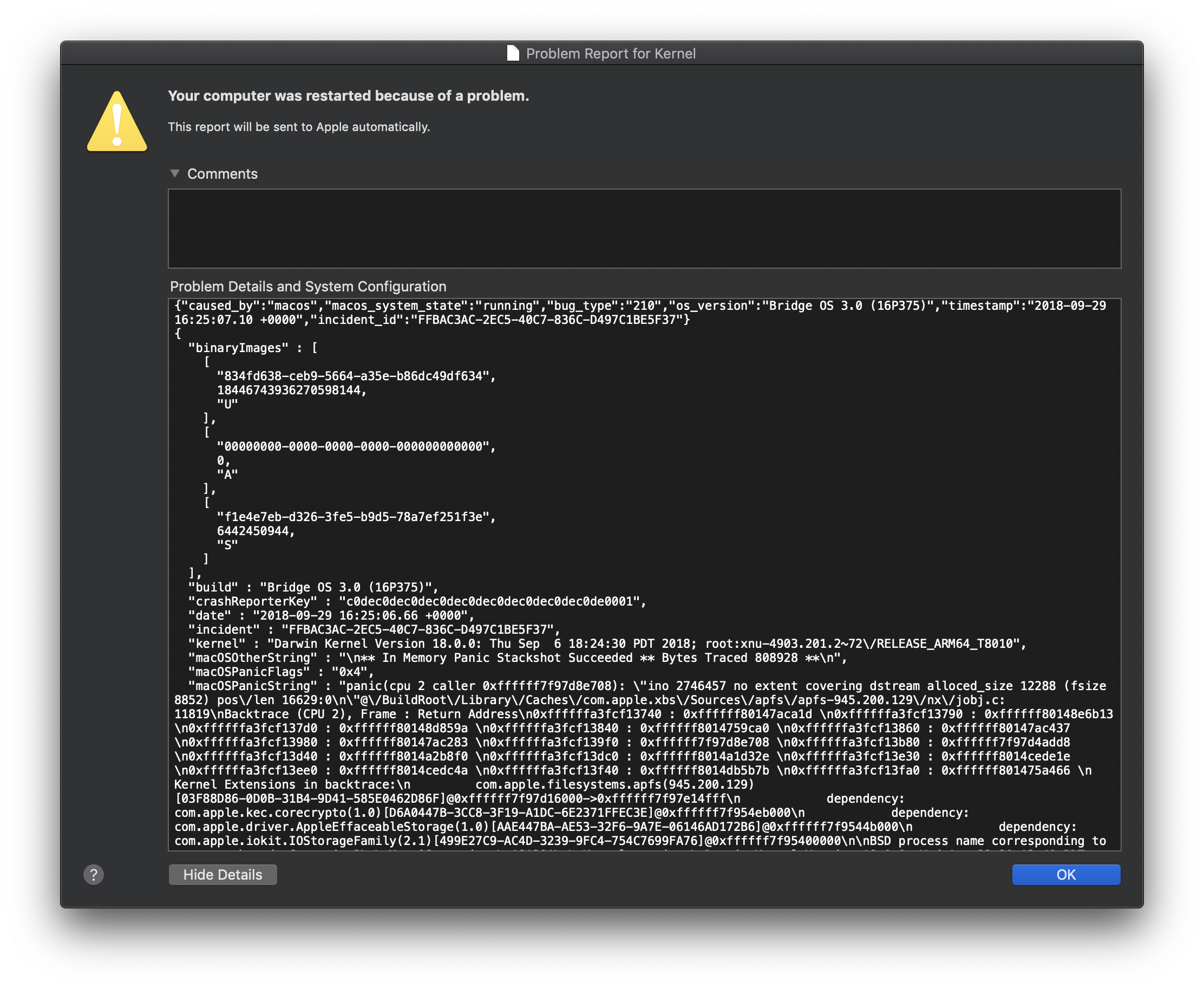

Thanks for this insight. I got my MBP 2018 for three days. Today was the first day I connected it via TB3 -> TB2 adapter to Thunderbolt Display. Everything was fine, but in the evening after waking up, the system warning appeared that I have just 1,9 GB of free memory. This is nonsense because I wasn't able to fill 1 TB so quickly, actually 700 GB is free. Suddenly the laptop turned off. Once turned on, it showed to free storage correctly and there was a message about Bridge OS 3.0. Now I'm just wondering if this is software issue and I should wait for fix or hardware issue and I should return it while I still can...

And yes, I'm running Mojave.

Id return it. If you have one KPing in the return window Id get rid of it the easy way.

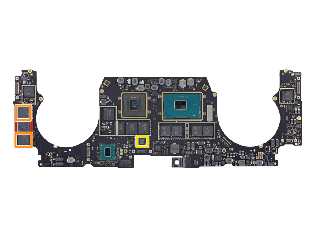

It isn’t as simple as the phone. The flash memory and controller are soldered to the logic board and would require the logic board to be replaced. So if they replaced the SSD, they would have also replaced CPU, GPU, Thunderbolt controllers, T2 chip, etc. Not sure how that guy determined that swapping the SSD was the only fix when so much else would have also been swapped with it.
* Orange - Flash Storage
* Red - Apple Custom Controller
I'm under impression that the guy is talking about 2015 MPBR which was running unstable and that he was fault finding the machine for quite some time until he replaced the SSD... And that scenario is technically possible.

Not sure. I know appleino mentioned that he had a 2015, but didn't see where there was any mention of what year/model the guy who had the hard drive replaced had. Unfortunately, it is not really an option to replace the hard drive only with the new models.
I can’t find the blog post anymore where the author claims swapping the hard drive fixed the problem for him, sorry. Had looked into this a few weeks ago but just accepted that my 2015 MBPr reboots every night (my main machine is the new 2018 model wherefore I don’t care as much anymore). The author of the blog might as well have taken his laptop to Apple and they stated that the HD was changed. The theory doesn’t hold anyhow, since apparently there are 1TB machines that crash while others don’t. I think it’s safe to assume that Apple uses the same 1TB drives in all 2018 machines, so they are very likely not the source of the problem.
That is a good question, that I don't know the answer to for certain, but likely correct since they appear to use a proprietary controller. Other brands will source from 2 or 3 vendors when using standard m.2 nvme drives, but I would not be surprised if it was not an option for Apple. It likely has to be consistent.
