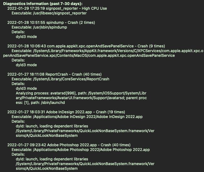

Hello martin,
last week i updated your OC from 0.7.6 to 0.7.7 (also BigSur from 11.6.2 to 11.6.3, ota) on single core MP 5,1 (32 GB RAM, sata 2 SSD in standard drive bay with system + sata 3 SSD as scratch disk in PCI, also have HDD with clean Mojave, RX 470 4GB, two displays over HDMI and DP).
Problems started with Photoshop - i could work for about hour or so, next it was no longer possible to save work. Save/export dialogs did not appear and cmd-s also did not work. Next, all running apps (Mail, Chrome, InDesign, Photoshop) terminated and i get clean desktop - with no top menu bar nor any items on desktop, just Dock on bottom. I could use power button to invoke dialog with Shut off/restart buttons, and i can successfully restart (with no warning screens), and work for another hour or so.
I tested over the weekend using just chrome and mail, and there were no problems.
I was not sure it was caused by macOS or OC update, so downgraded back to 0.7.6 (simply by overwriting folders in EFI partition as when upgrading, just now with older version 0.7.6). Now, today, i several hours use Photoshop without any issue again. Finally stability.
I'm attaching a few error messages from ethrecheck: looks like some problems with open/save panel service and many Photoshop and InDesign crashes over QuickLook?? (i did not notice any problem with InDesign, just Photoshop, both current and legal versions).
BigSur (11.6.1, next 11.6.2 and 11.6.3, ota) i installed over dosdude’s Catalina (Catalina over existing Mojave), using your OC 0.7.5, next 0.7.6 - both fine. Just now version 0.7.7 is kind of problematic. OK, my path to BigSur is not ideal, but i am lazy to do clean install (if not necessary). And now back with 0.7.6 have fine working system again.
Probably my wild system upgrades caused it, but if anyone else has similar problems with Adobe apps and OC 0.7.7, try downgrade to 0.7.6. (srry used google translate for this EN text).
Update: it happened again, problably for just not so intensive work today (and frequently saving), it last stable longer, look like i can not avoid clean reinstall... so ignore this.

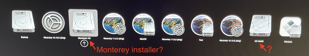

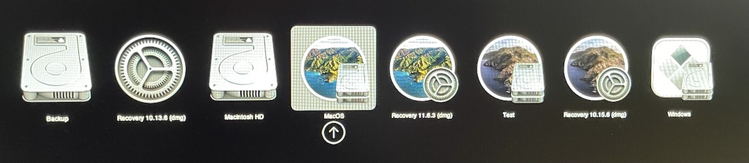

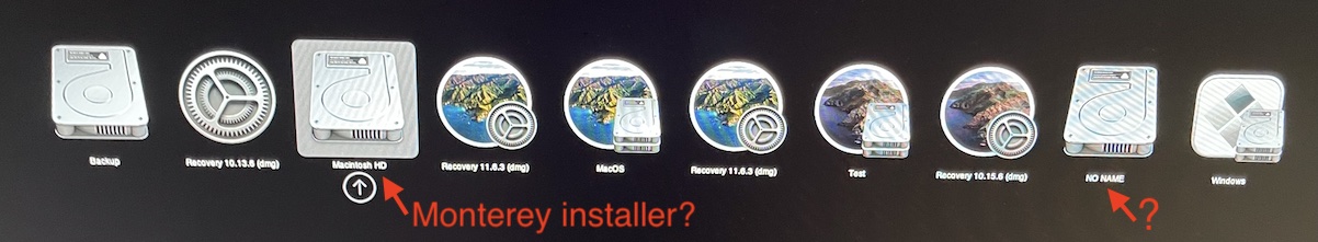

For some reason it seems I couldn't change the OC location even if I mounted the EFI partition I wanted to use (the one on my Windows 10 drive), copied the ”OC” and ”BOOT" folder from the 0.7.7 package and then ran the ”Bless OpenCore.app”, so I decided to delete OC from the EFI partition I first had it installed on and then run the ”Bless OpenCore.app” to not get any confusion. Bad idea…
I now only get a dark screen when attempting to boot – the OC boot picker won't come up comes up. 🙁
Any ideas?
Maybe drag out the drive I originally had OC on and put it back there via my work laptop. Sigh…

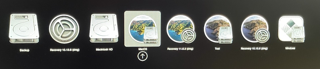

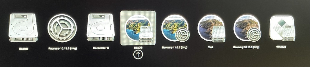

Anyway, I managed to get OC working again by copying the 0.7.7 OC package back onto the EFI partition of the drive I originally had it on. Not sure why my computer doesn't seem to like using the OC 0.7.7 I have installed on the EFI of my Windows 10 drive. Any ideas?

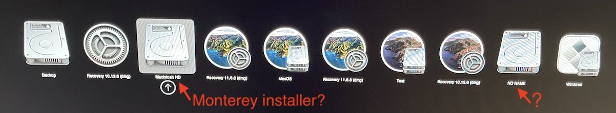

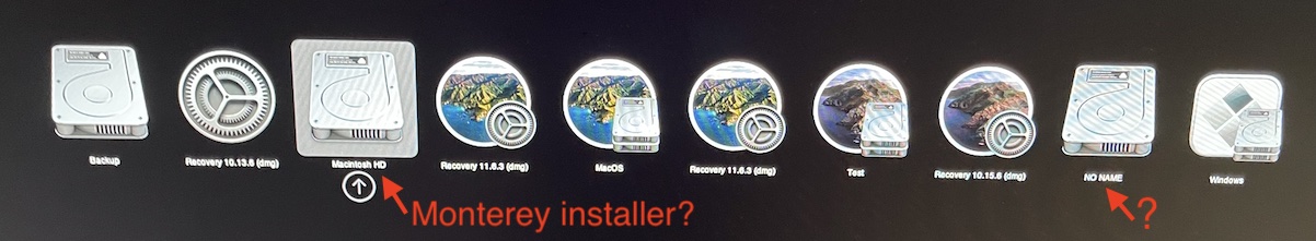

I was also a bit surprised to again see that ”NO NAME” drive in the OC boot picker upon the first restart after getting OC working again. I accidentally started from ”Macintosh HD” instead of ”MacOS” which is my main install with Big Sur. I think the Macintosh HD partition was created by the Monterey installer and now when I accidentally tried to start from it it didn't work, presumably because CpuID” is incorrectly set in in the ”config.plist”.
After trying to boot from the ”Macintosh HD” it restarted after a minute and then the OC boot picker looked like this:
So for some reason the ”NO NAME” volume, one of the two ”Recovery 11.6.3 (dmg)” went away?
Does this makes sense to anyone? 😀
How can I find out what that ”NO NAME” partition is about? 🤔
