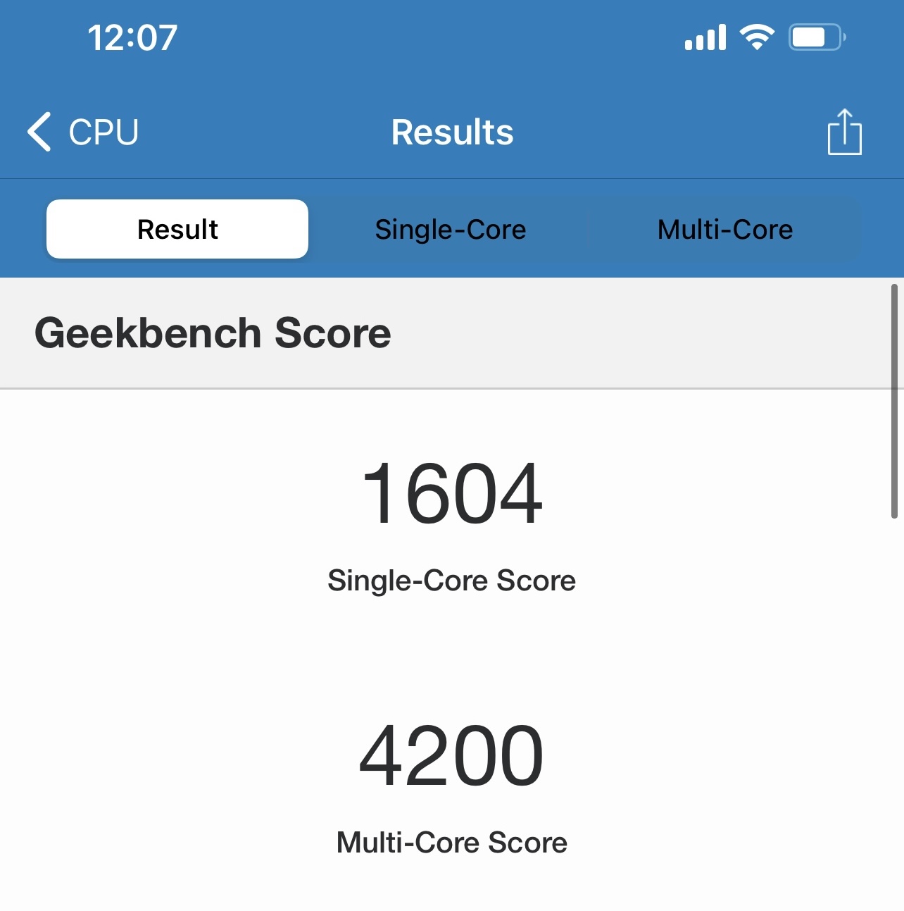

Battery charge has nothing to do with it in my case, I’m at 35% and now performing at above the 12PM average benchmarks. This has been consistent for all the tests I’ve done since I managed to somehow restore my performance regardless of battery life.
I don’t know for certain how I managed to restore performance, but my guess is probably something to do with me hitting the processor with a full load the second it booted from a cold boot maybe triggering the processor to go up to its max clock speed and work as normal afterwards. People have said the issue seems to be the processor unable to ramp its clocks up to full speed so I wonder if forcing it to stay at full speed for longer just after boot bypassed the usual down clock for power saving and then afterwards everything has settled back to normal. I may be looking too much into this but after multiple restarts not fixing it and then turning the phone off for a few mins then hitting it with a Geekbench the moment it boots seems to be the only thing that has done the trick.

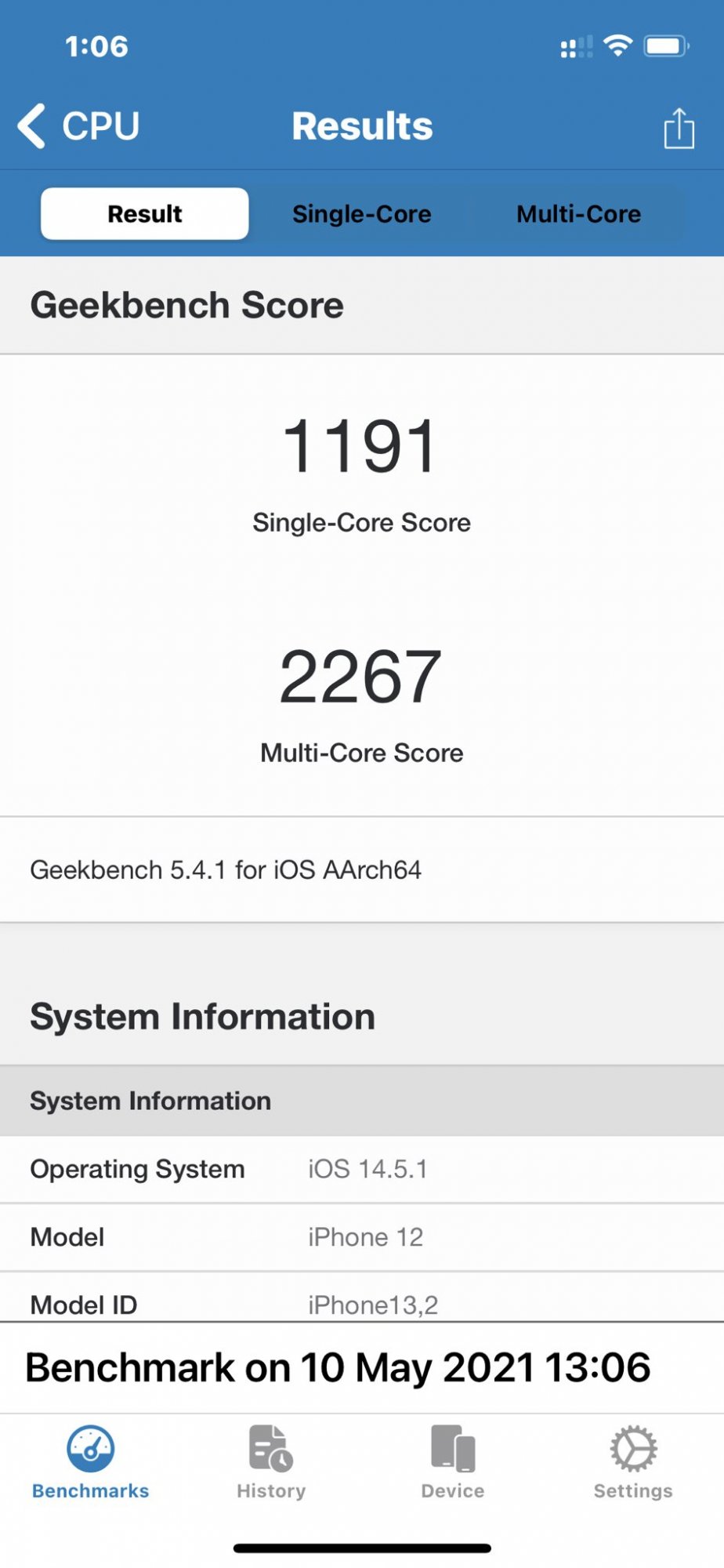

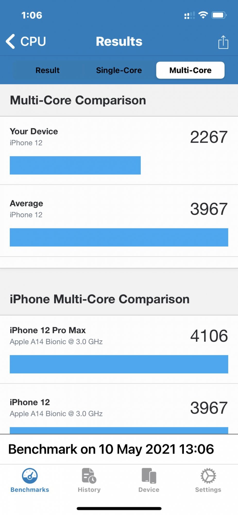

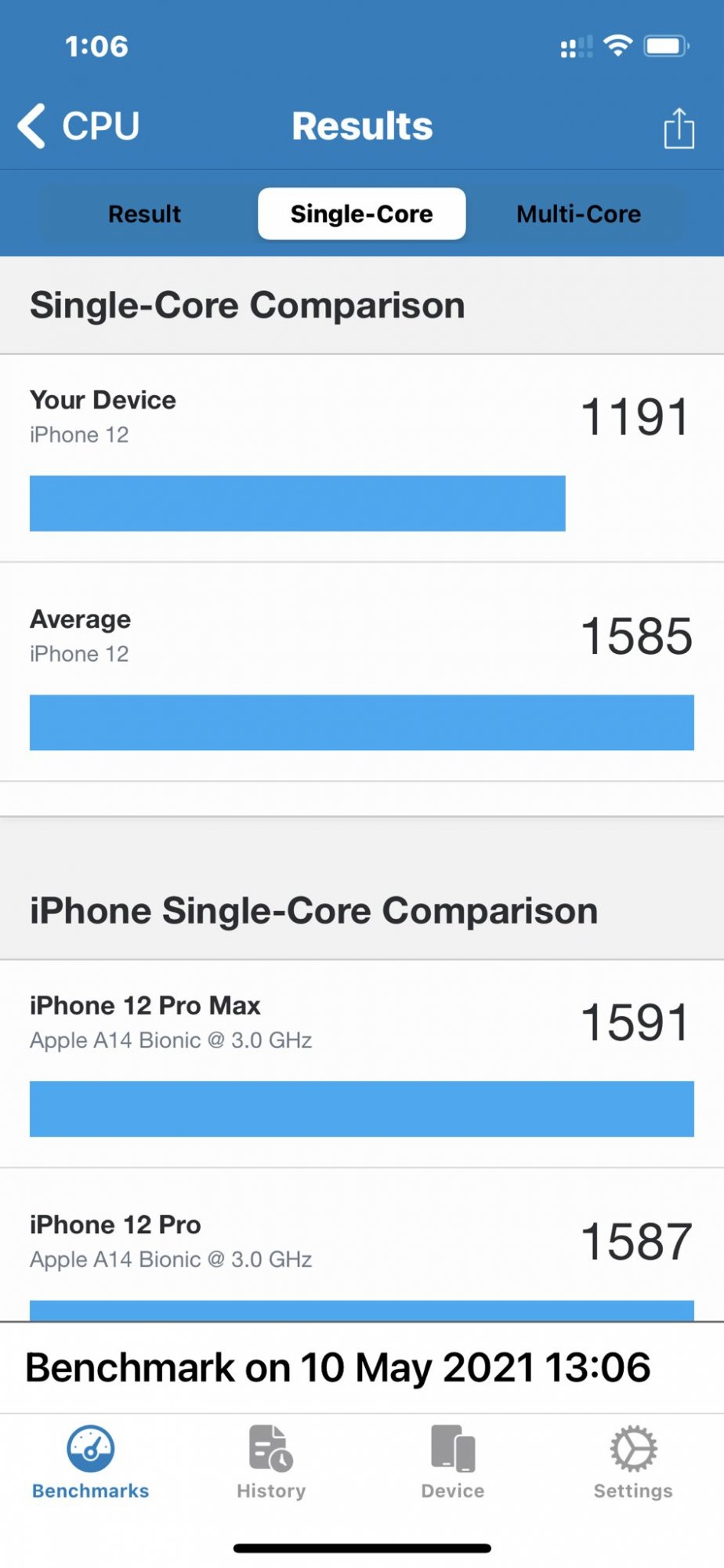

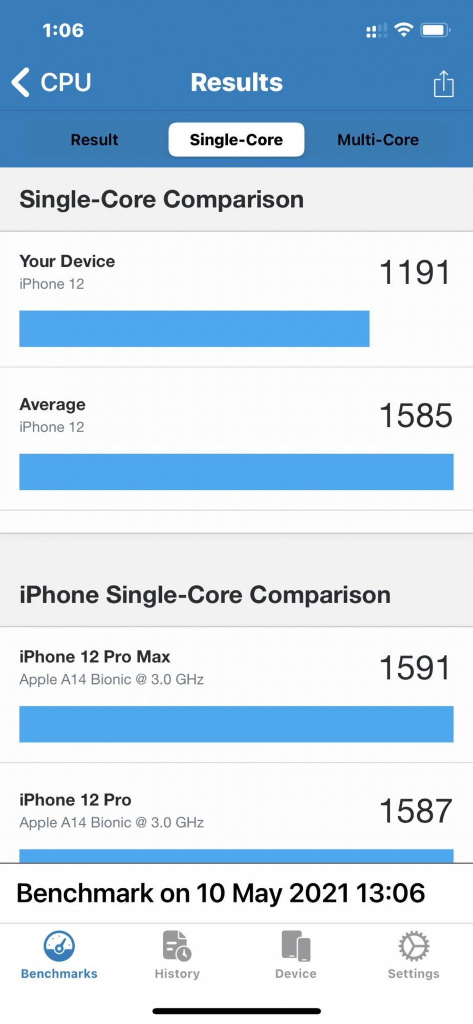

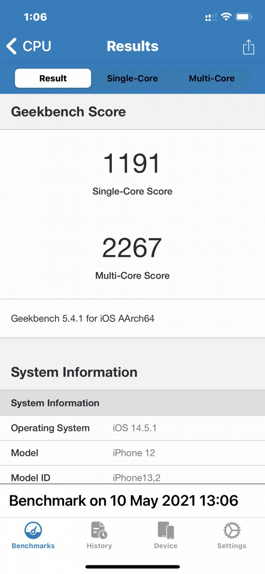

same here I am having terrible scores on my iPhone 12
View attachment 1772678View attachment 1772677View attachment 1772680

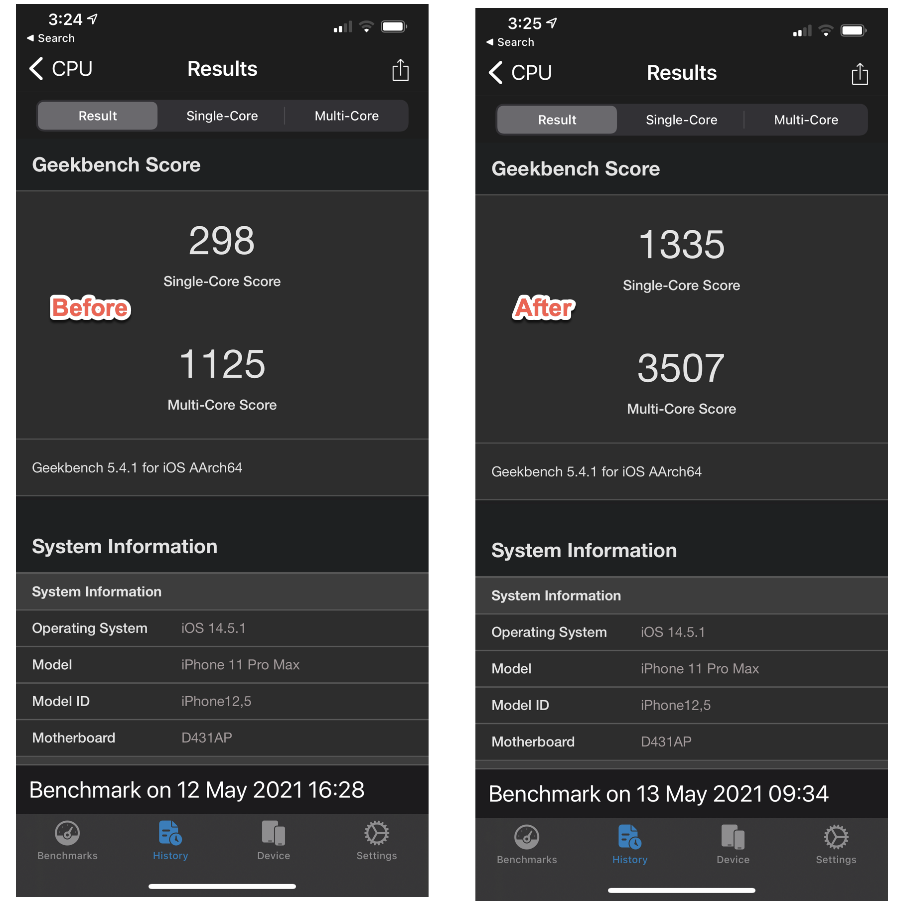

Updated from iOS 14.5 yesterday to iOS 14.5.1 on my iPhone 11. After the update finished, I was playing CODM and noticed the frame rates were horrible. I checked my settings to make that it was set to the max frame rate, which it was. I then ran a geekbench test, and the scores I got were horrible for the multi-core. I then rebooted my phone to no avail; it was still super slow in games and in opening apps. I then proceeded to do a clean install which seems to have fixed the issue. Now my geekbench score is normal, and performance is what it used to be. What is going on, Apple? Anyone else having this issue? Upload a screenshot of your geekbench score on iOS 14.5.1 and tell us what device you have.
I have an 11 Pro Max 512GB and was amazed at how slow and glitchy it became after the update.
I finally did a fresh install which seems to have fixed the problem. I don't think it's any kind of throttling just a bad update. See my before and after Geekbench results below.
