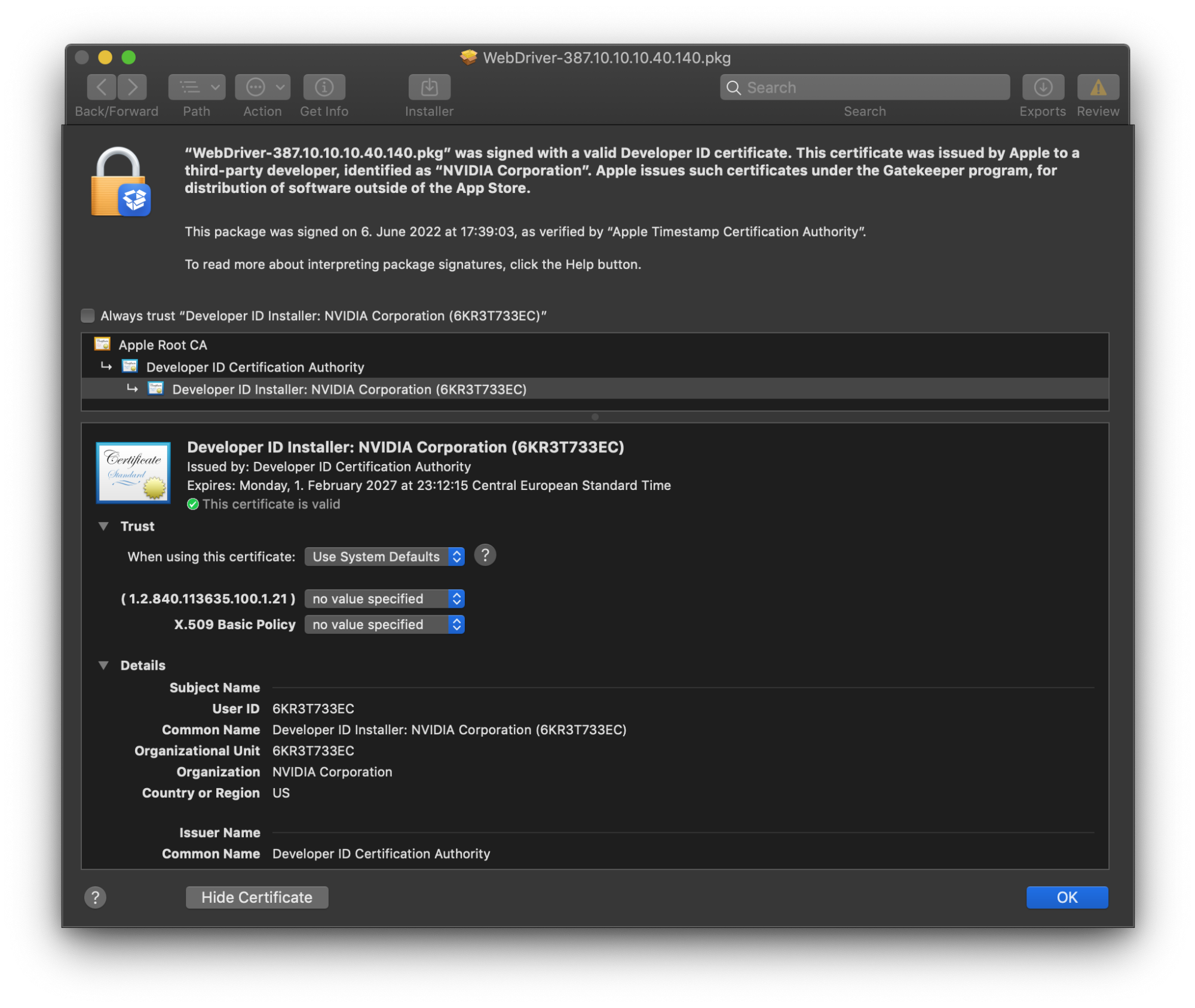

looks good, from certificate site:
(System refused to let the Suspicious Package tool open the old installer package)

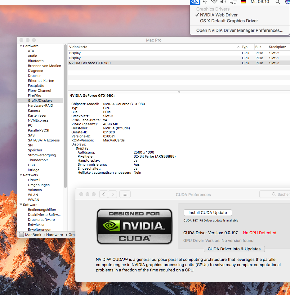

After reading all 25 Pages I am frightening to boot my 5,1 again ...
I downloaded scripts :
1.NvidiaWebdriverRevocationWorkaround_v13
2.com_apple_trustd_delete_and_lock
3.com_apple_trustd_just_for_listing_the_commands
etc.
I also tried to patch Webdriver with https://github.com/corpnewt/Web-Driver-Toolkit
with WebDriver-378.05.05.25f19.pkg
1st Question: Is there a workaround for Sierra 10.12.6 (16G2136) ?
after booting CUDA prefpane opens (no GPU found), menu is set to Nv-driver but prefpane from Nvidia is still
broken.Next time CUDA pref also can't launch anymore ...
2.nd Question: I have also RAID Sierra 12.4 running , CUDA is old now I fear to update.what's next?
3rd Question: I am also using HighSierra 13.2 because of multiGPU 378.10.10.10.25.106 driver
and I want to recover this old image but last time I was not able to run Davis Dubois's github webdriver script
( does not exist anymore :https://vulgo.github.io/nvidia-drivers/) to install special version on 13.2 HighSierra is
there also a way to sign specific webdriver version ?
4th Question? and last question could we make a final Tutorial page with how-tos and scripts
from this topic in one place ?
Thank you all for keeping our old good Macs alive with CUDA software !!!

So, I had a different 10.13.6 system that was not essential to me at the moment, so I unblocked trustd & ocspd in little snitch on that system and let it connect. (I did not run the latest script that was developed by Dayo on this system..used earlier method)
I restarted.
Of course, the frigging old drivers are still working.... I'll report back tomorrow if they ever fail....so I can then test the new driver they sent, and see if it actually works.
I can confirm the new driver does indeed fix the revoking of being launched to be installed at least.
Will report back if I can get my system to lock me out again...
Please post, if anyone has any success with these new drivers on a system that is currently revoked....
Confirm! This works for me! Extended the life of this 12 year-old Mac for a little longer.

HUGE thank you to @DTRX and @Dayo! Really appreciate you guys working so hard to get a fix. Can't thank you enough, so many were left to dangle when the certificate was revoked.
Thank you to @Fullerfun for contacting NVIDIA and sharing the driver package.

Sorry I used to just use Benjamin Dobells Github script to install NVidia.
To 1: We tried to find a solution for "Low" Sierra by locking a different set of folders. Dayo should have implemented it in his script. Give it a try and report to eventually help others.
To 2: Do not update. Try Dayo's script. It is not bound to a particular version of CUDA. Although there might be small differences in trustd's implementation for different subversions of Sierra. The info about which folders to lock to break trustd was taken from the latest version of Sierra (10.12.6). I'd still give the script a try and test if it works for you.
