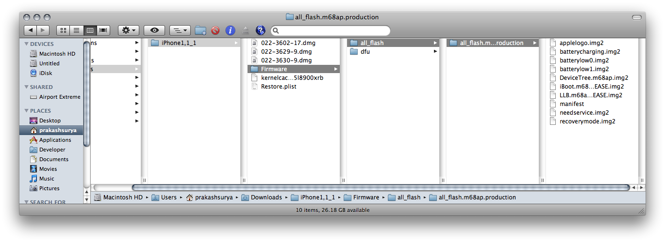

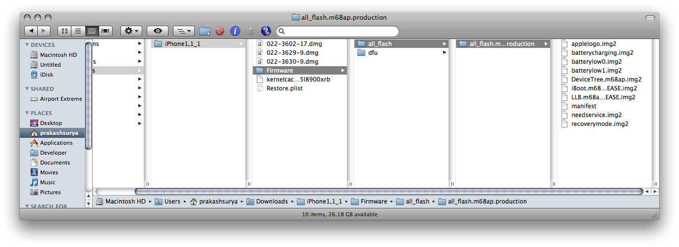

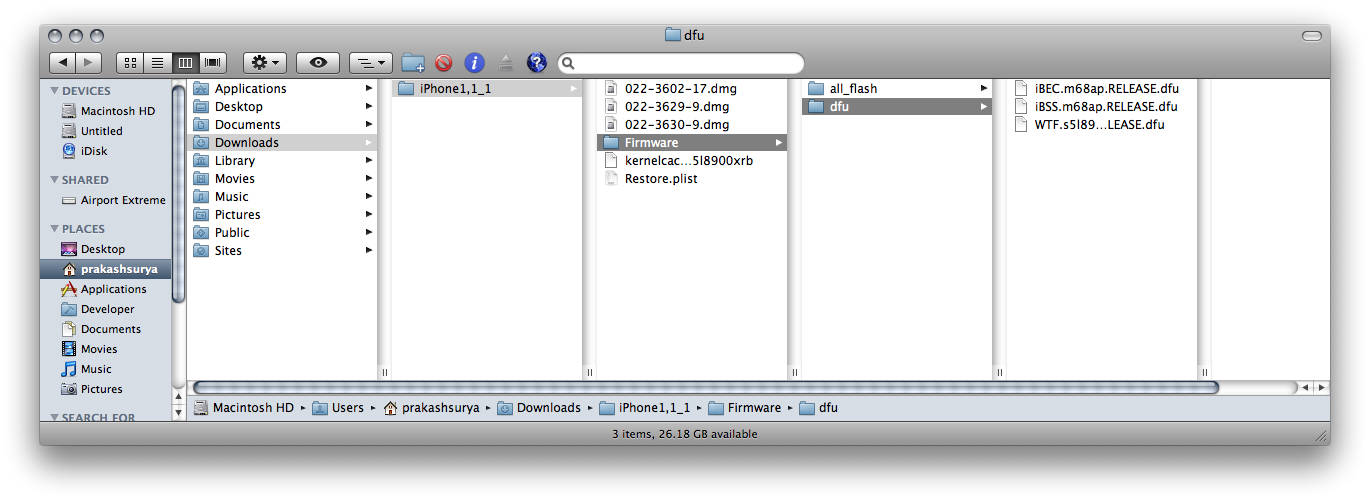

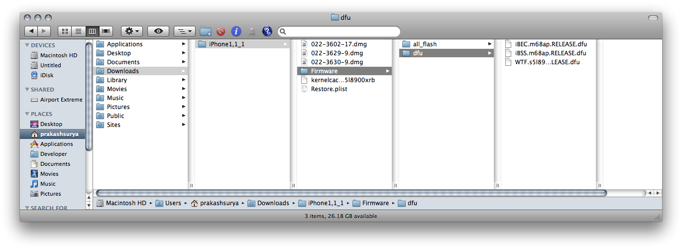

i cant seem to find this .ipsw file for step 5. i did download the file in the previous step but it did not give me any .ispw file. heres whit i downloaded, wheres the file i need?
I think that this happened to me, too. I think the first thing you should do is check your trashcan. A lot of the things I downloaded went straight to the trash. If you still can't find it, just download it again.
if that is the correct firmware you downloaded, you have to rename the folder (that you have named iPhone 1,1_1) to "iPhone1,1_1.1.1_3A109a_Restore.ipsw". a pop-up will ask if you want to change to .ipsw, say yes. the file should have that exact name, when it does it should look like a Lego block. use this to restore from.
