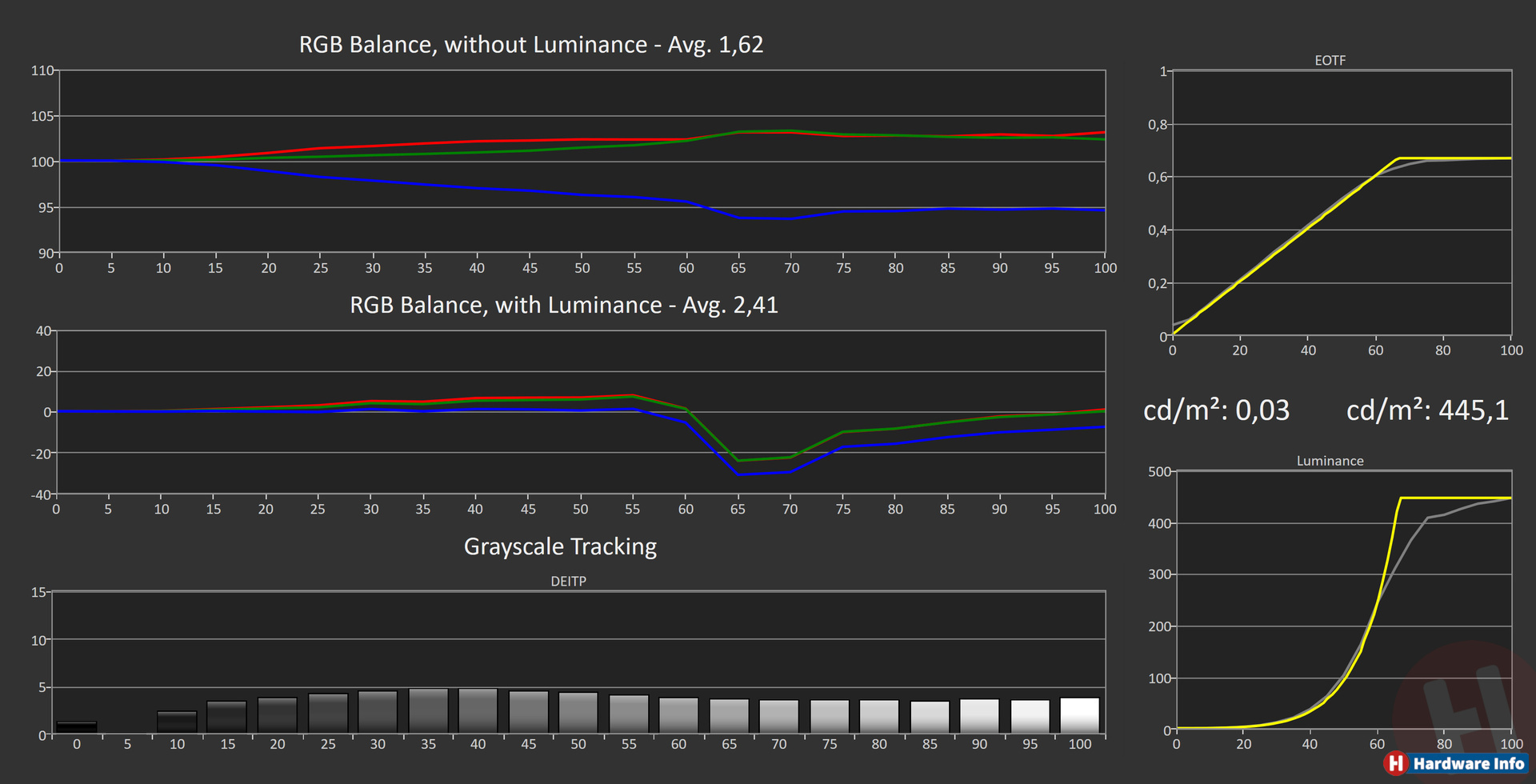

My point is, no one knows if it’s a issue or if they just redesigned something as it’s a shortage of components
One of the changes which is certainly related to the revision is the change in HDR white point. The roll-off for the PQ curve is not so strong anymore as it was with Rev A00. Dell confirmed the change in white point in a private message to me: "The HDR white point is a change by our product engineering team as per the market needs. Unfortunately, we can't do anything about that."
And I saw that you also asked which brightness setting I've used for the contrast measurements (I'm not very active anymore on this forum). I've used different settings but here are the results of the default value measured with the SpyderX at five different places on the screen: respect. in the centre, top right corner, bottom right, bottom left and top left corner:
Standard mode - brightness 75%, average contrast 1970:1.
Custom mode - all RGB sliders at 100%, brightness 75%, average contrast 2100:1.
It looks like that Rev A00's of the U2723QE do have a lower contrast ratio than the A01's. I've measured also lower contrast on two A00, also Tweakers.net measured lower contrast with their A00. And besides that, several other users with A00 are reporting lower contrast ratios.
Yes, it do seem like that.
I’ll call dell support tomorrow and ask them to send a new one.
1500 in contrast is 1/4 of what they promised.
I call that false marketing.
I can buy if it was 1900 as it always can diff.
