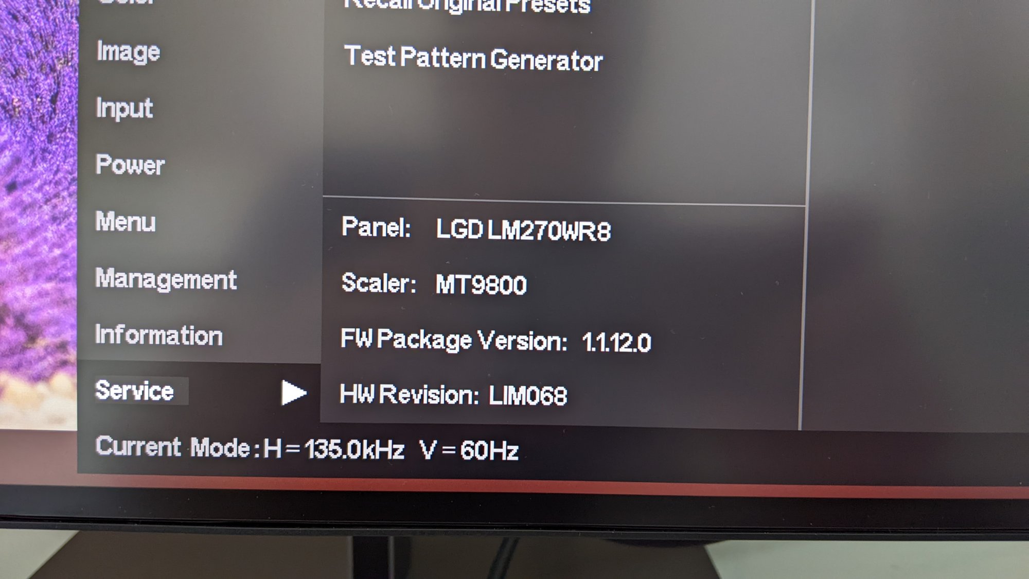

There is no way to disable the uniformity compensation, even not in the hidden service menu (I've discovered you can access this menu when pressing and holding the 4 cursor button and while turning on the screen). So 266 nits is the max in SDR unfortunately.
In the service menu I saw that the monitor uses a LG Display panel, the LM270WR8, the postfix is not visible, but this could be the LM270WR8-SSC1.
In the service menu I saw that the monitor uses a LG Display panel, the LM270WR8, the postfix is not visible, but this could be the LM270WR8-SSC1.View attachment 2021446

That hidden service menu on the picture is from the HP Z27xs, not the U2723QE. I did not discover yet how to enter that menu for the Dell monitor unfortunately.
