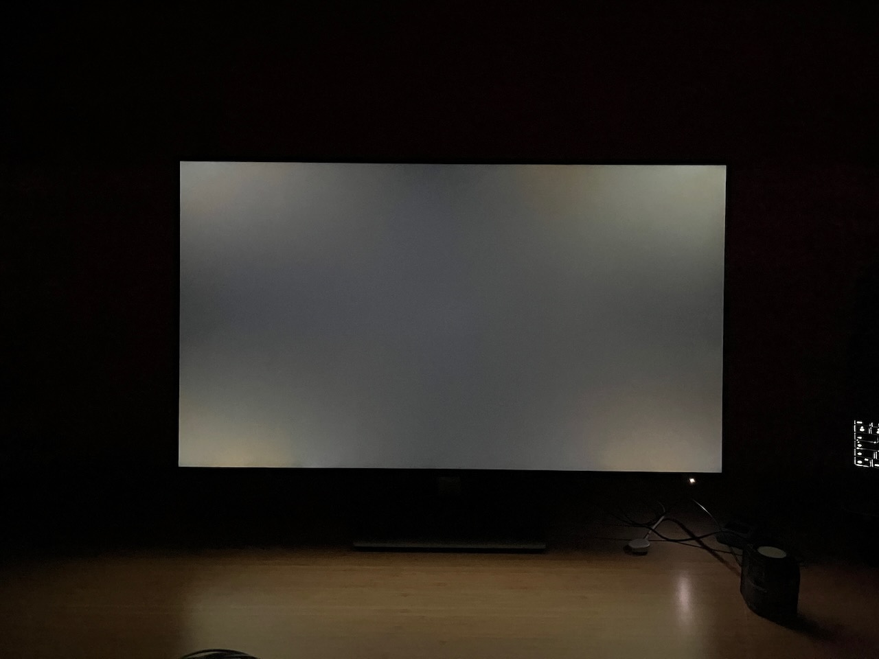

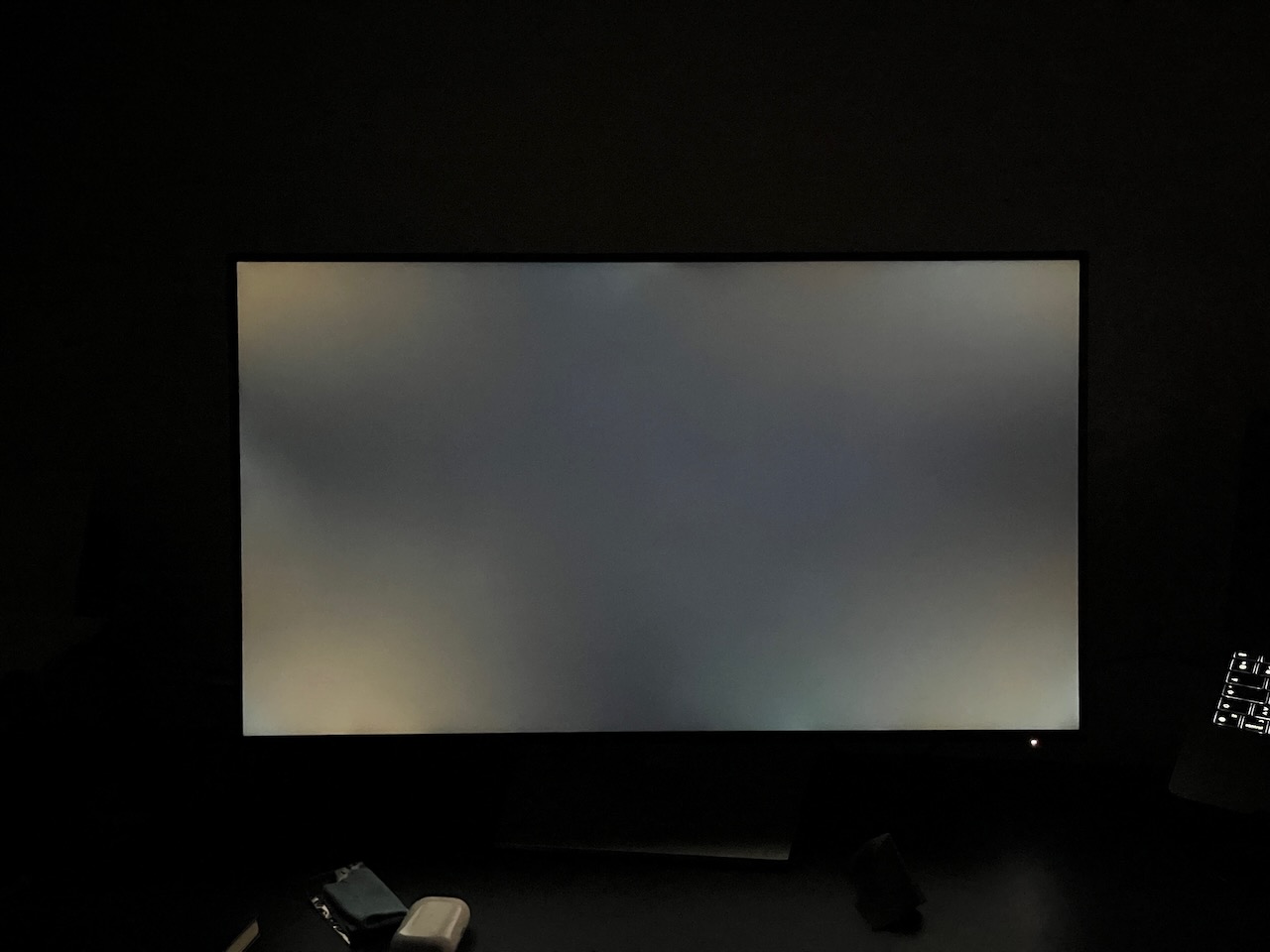

However, some are better than others. Here are my 2 U3223QE, with the same settings (brightness at 38 for 120cd).
The first one is full of backlight bleed, as the second almost have any (slight bleed in the upper right corner but nothing compared to the first one).
IPS glow is still there of course, but not really annoying excepted on a black screen in a really dark room.

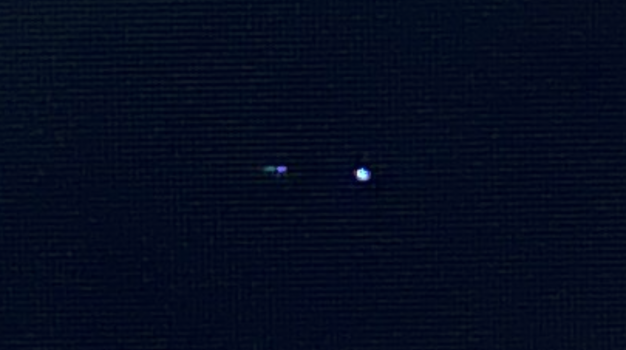

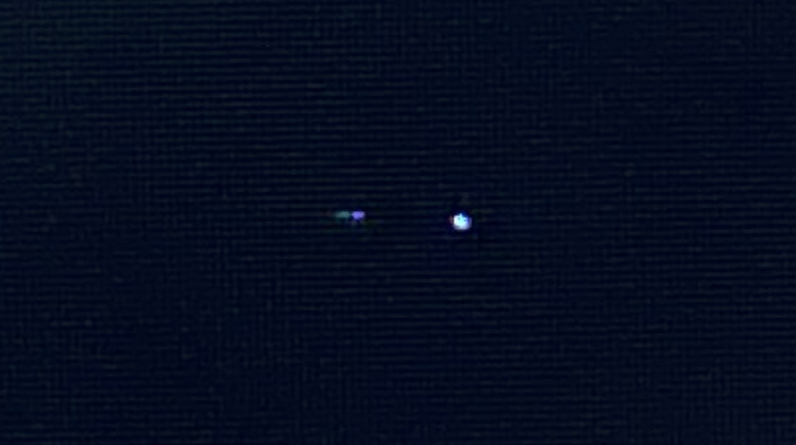

Last thing: my first unit has a green stuck pixel, which is visible. My second one has a...I don't really know. It looks like a blue stuck pixel, but it's not bright at all. I can't see it during the day, even with my head on the screen, nor in the dark at my normal viewing position. So I don't really know what it is. I tried to take a photo of it. On the right, it's a blue pixel in Affinity photo (1x1), and on the left, it's my "issue". But as it's not visible, that's not a deal breaker to me.

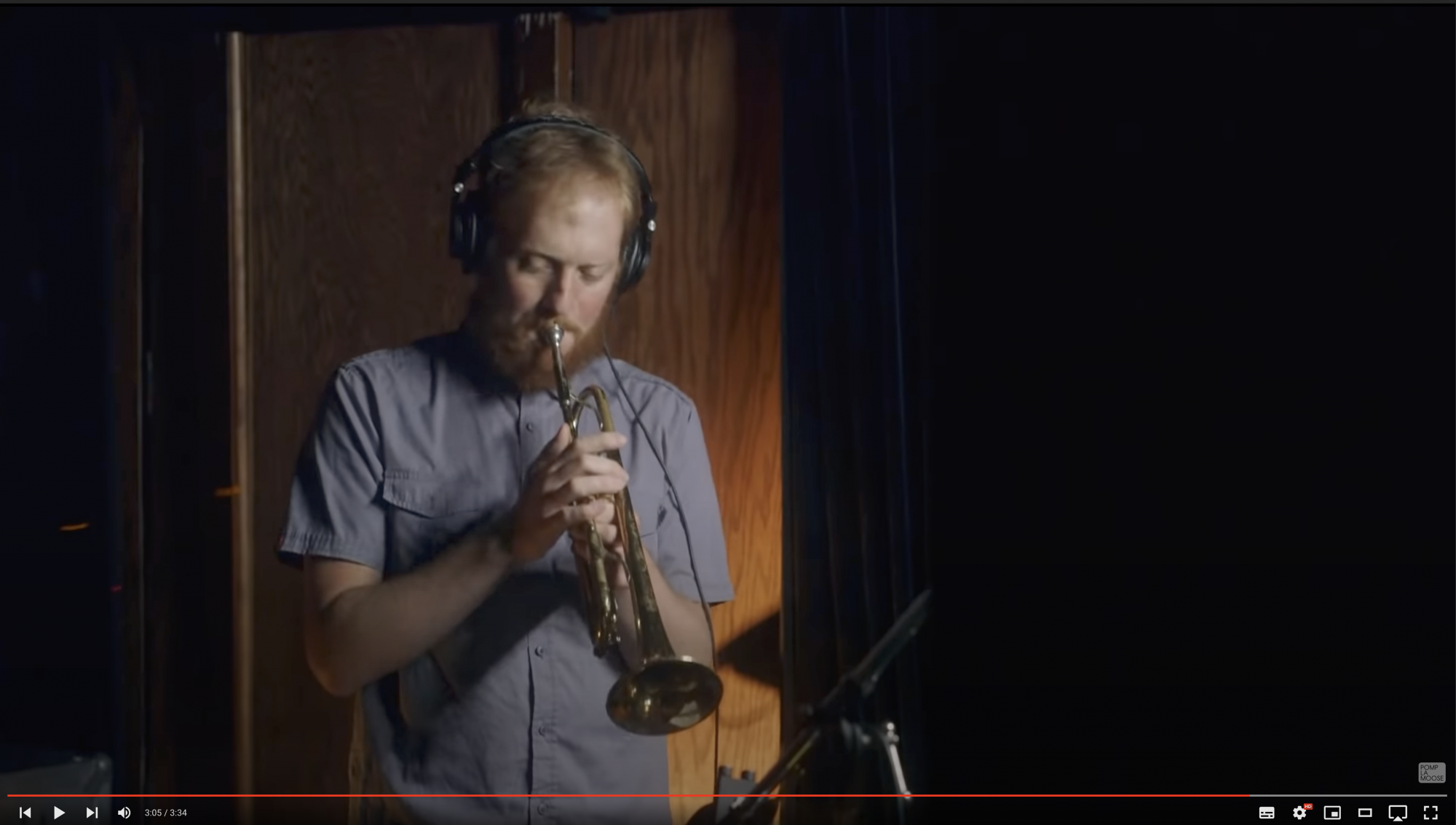

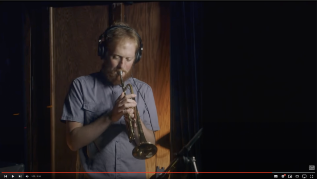

Another weird thing: could someone confirm that this print screen, opened in at 100%, makes the display flickers?
I'm currently in 3008*1692.
Thanks!
edit: actually it doesn't happens once uploaded on the forum. The size isn't the same so something should have been changed!
