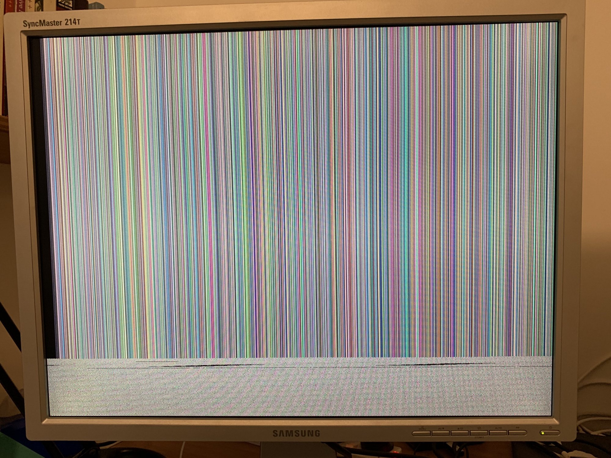

I'm having trouble with just one of my monitors.
My old 2016 Mac mini works fine with both my old Samsung SyncMaster 214T (1600x1200 @ 60Hz) and my newer NEC MultiSync EA244WMi (1920 x 1200 @ 60Hz), using the Apple HDMI-to-DVI adaptor that came with it and a DVI cable.
My new M1 Mac mini works fine with the newer NEC monitor, using the same Apple HDMI-to-DVI adaptor and DVI cable, but when I connect it to the older Samsung the result is this:
Has anyone else seen anything like that ???
To re-iterate, the monitor (with same cable etc.) works fine with the older Mac.

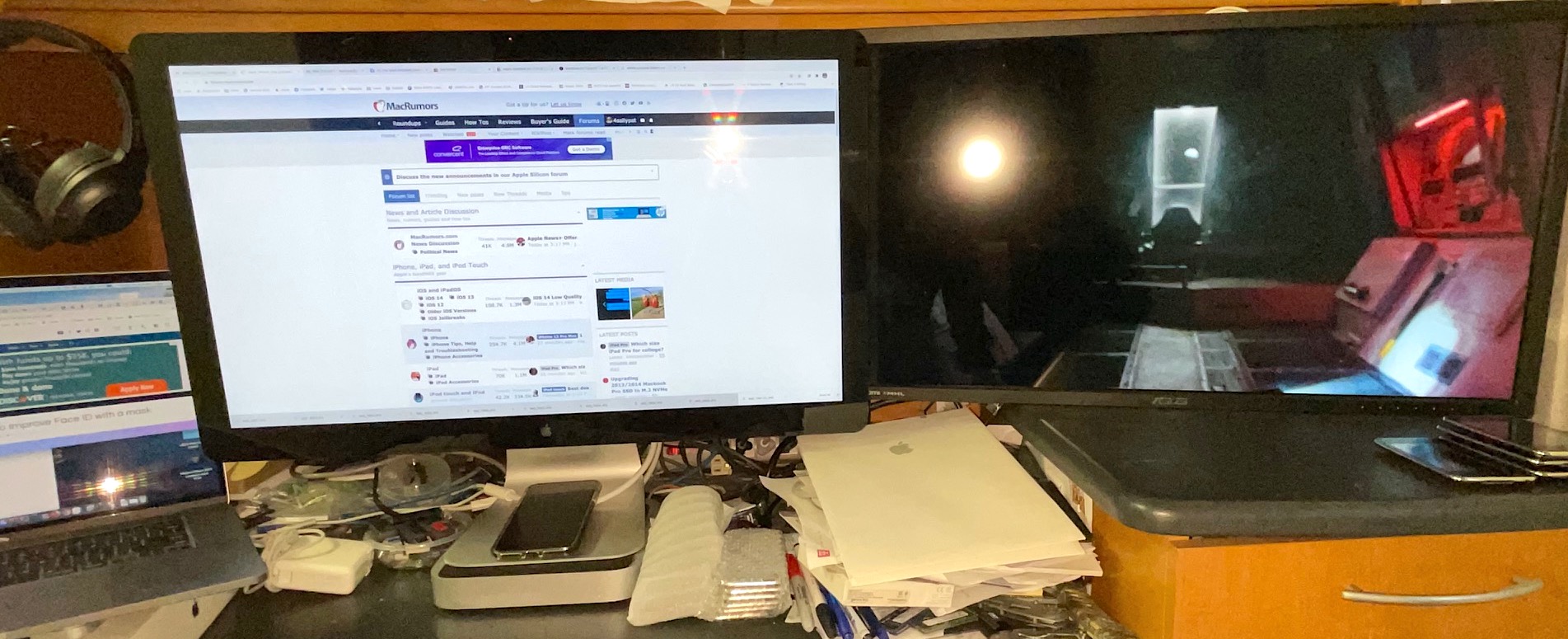

Okay so I’m getting this exact same issue. Oddly only seems to be the monitor connected with HDMI. I’ve tried a different cable and a different monitor and the issue is still present. Monitors are old, no 4K or anything running at 60hz. Managed to get a picture.
I'm sorry you have to deal with this issue as well. Thank you for capturing an image of it!
As an update on this: the monitor works fine when I use a USB-C-to-HDMI active adaptor.
So the issue is only with the Mac's HDMI output.
