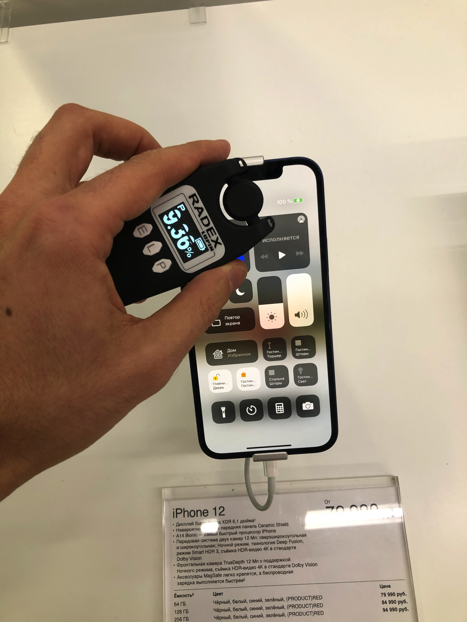

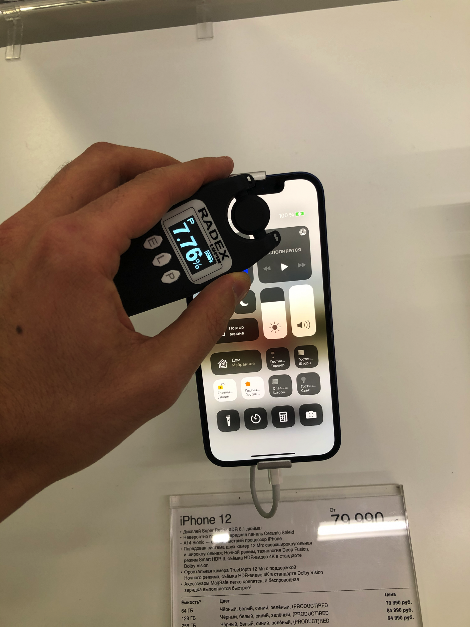

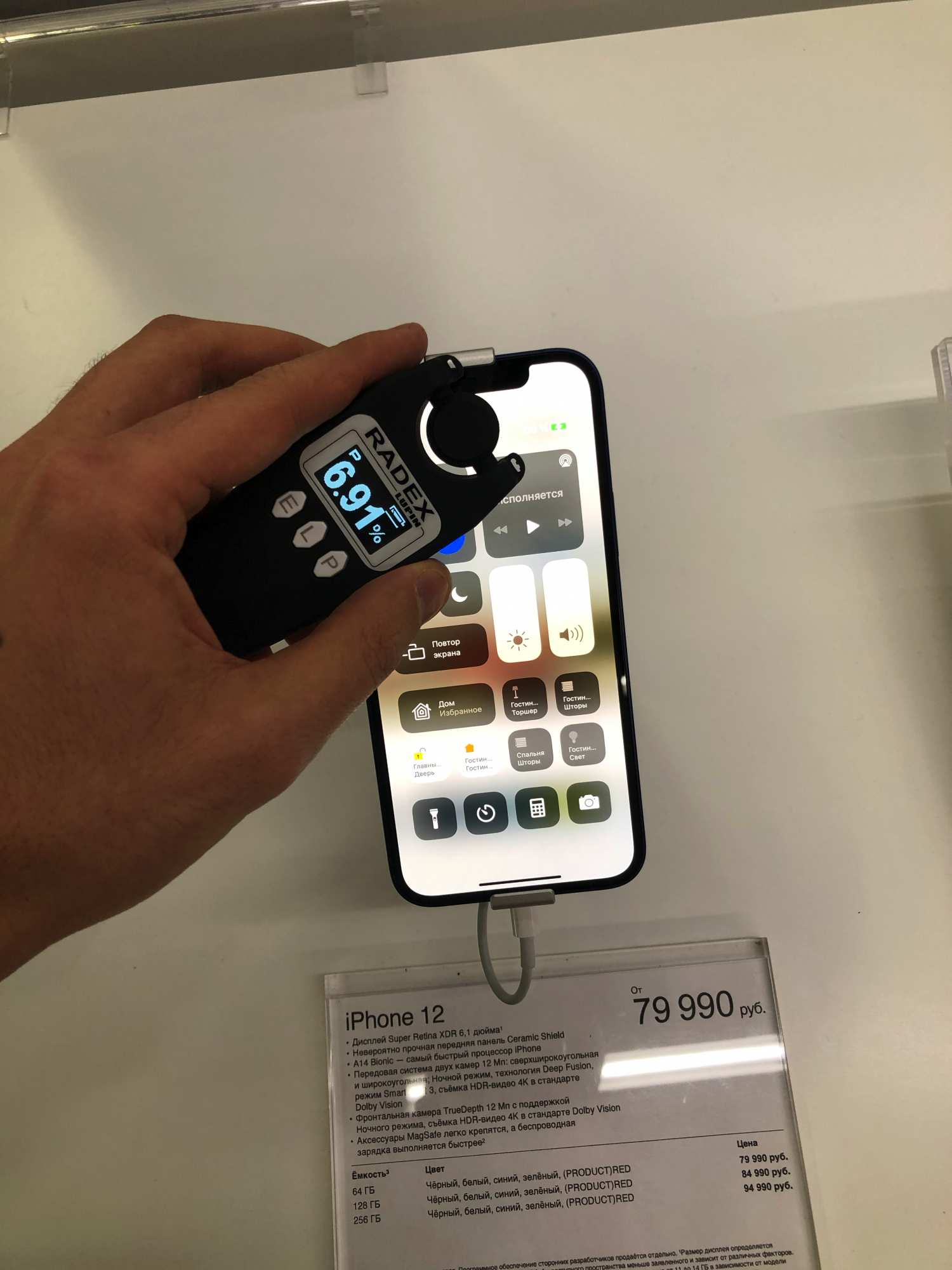

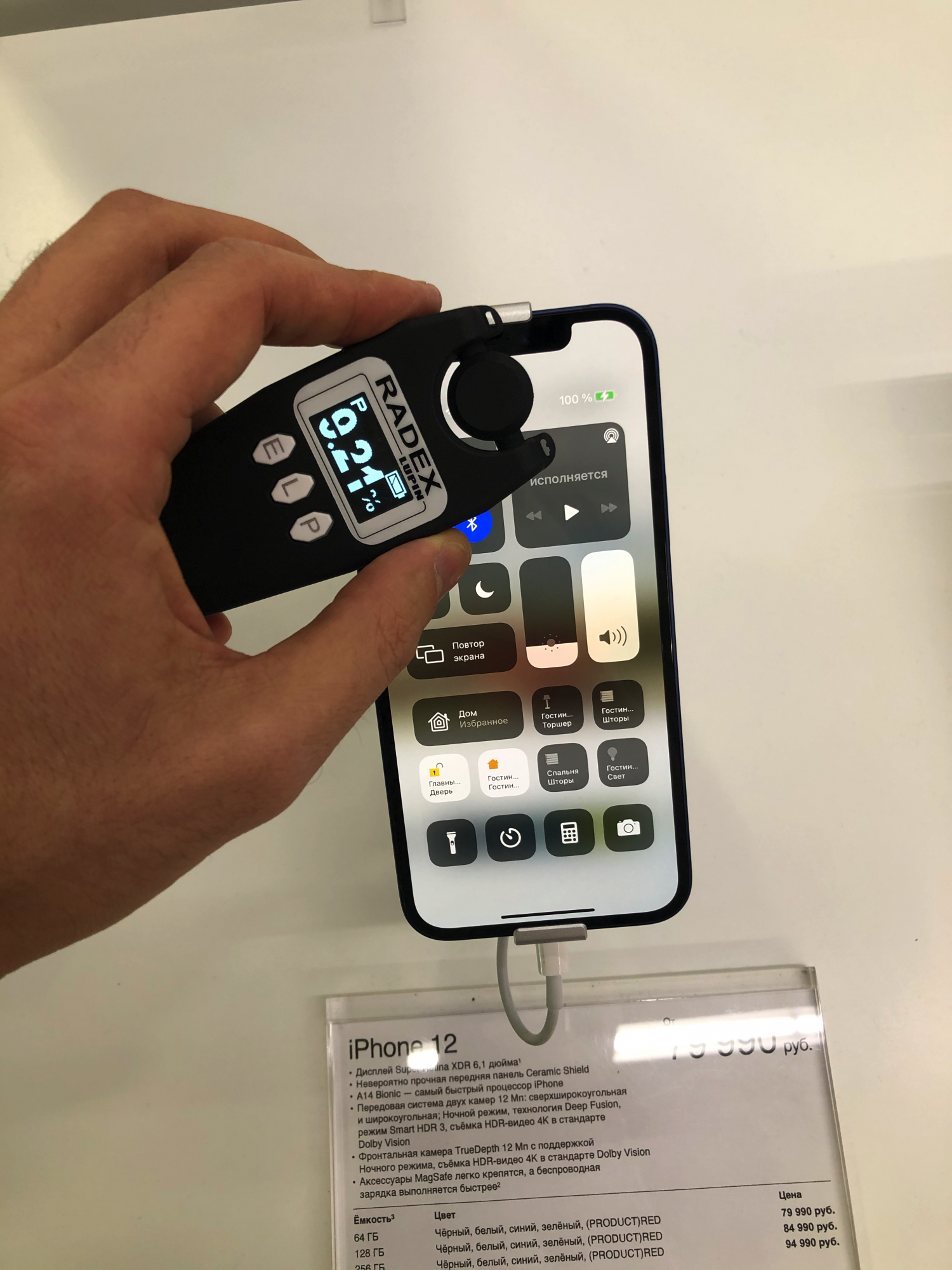

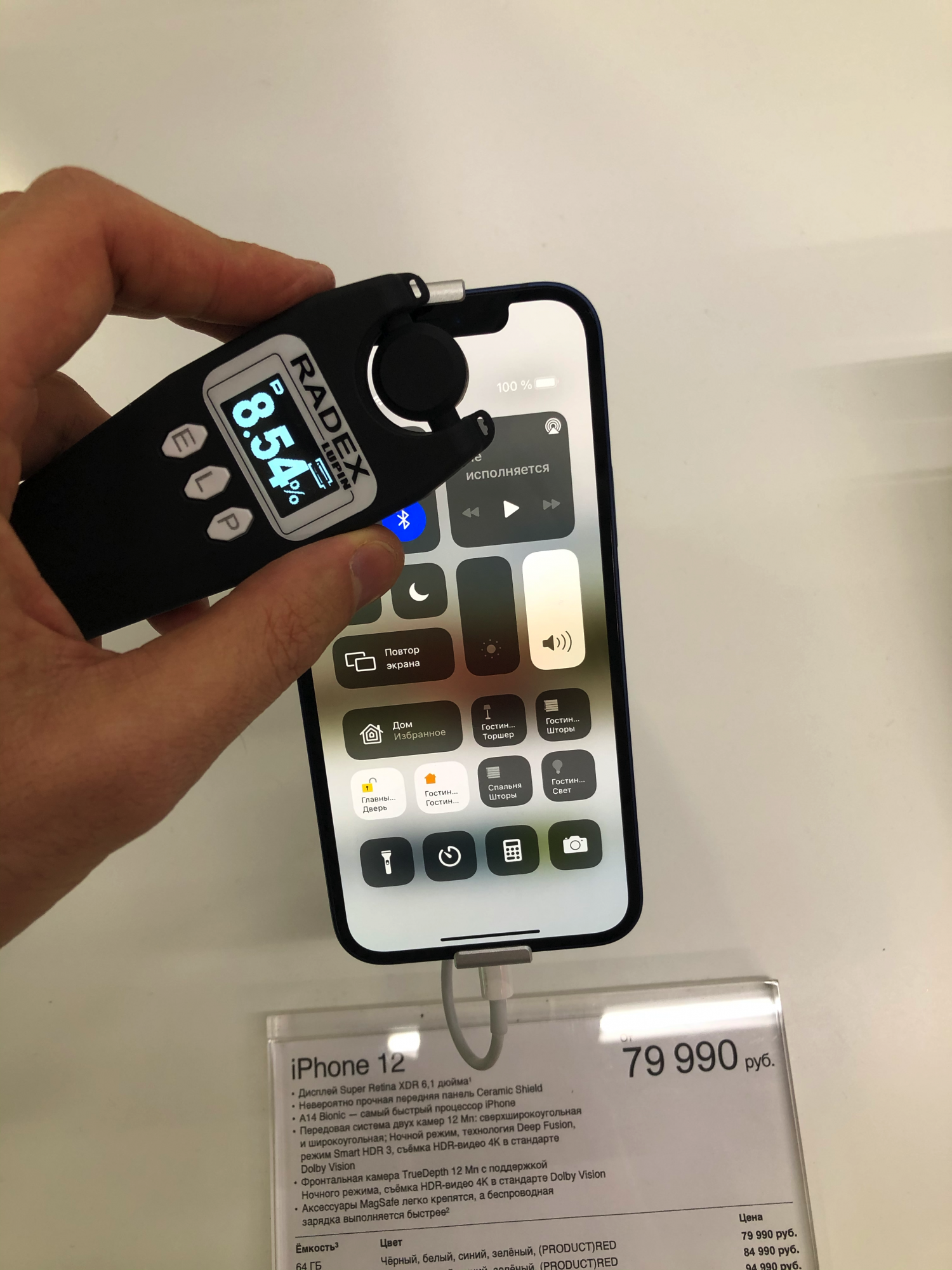

I have seen a few posts with different flicker measurements on the 12 Pro, which is quite confusing. Yesterday I received my 12 Pro, of course I measured it right away, the results were very unpleasantly surprised.
Brightness level - pulsation coefficient (flicker index)
1. 100 % -7.3 %
2. 75 % - 7.9 %
3. 50 % - 8.9 %
4. 25 % - 11.4 %
5. 20 % - 41.4 %
6. 10 % - 99.6 %
7. 0 % - 74.5 %
The pulsation coefficient starts to increase dramatically below 25% brightness and this is very different from what I measured in the store on the first day of sales.
https://forums.macrumors.com/threads/iphone-12-is-flicker-free-dc-dimming.2262673/
I even started to think that what was discussed in this topic may be true - that in stores, phones have different software settings and have a very high brightness, or dc-dimming is used.
I went to the store again and again measured the 12 and 12 Pro screens. The 12 Pro showed similar results as my phone, while the regular 12 still ranged from 6.9% to 9.36%.
What is the reason, I don't know, different screen providers, different software settings in stores or something else. For me, this year the story is over, because 12 Pro, even at brightness levels above 25%, causes all the same symptoms as previous OLED iPhones - literally in 30-40 minutes doing the settings, I got eye strain and a headache. For myself, I made a decision that while the device flickers more than 1%, I will not buy it. I'll take regular 11 and return 12 Pro.
Good luck guys, I hope that the advancement of technology will still allow us to use modern phones and not get stuck with our SE, 7, 8, 11. Maybe next year.
Below are some photos with regular 12 measurements in the store.
1. 100 % -7.3 %
2. 75 % - 7.9 %
3. 50 % - 8.9 %
4. 25 % - 11.4 %
5. 20 % - 41.4 %
6. 10 % - 99.6 %
7. 0 % - 74.5 %
