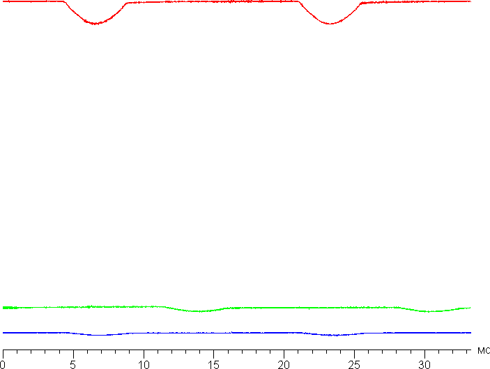

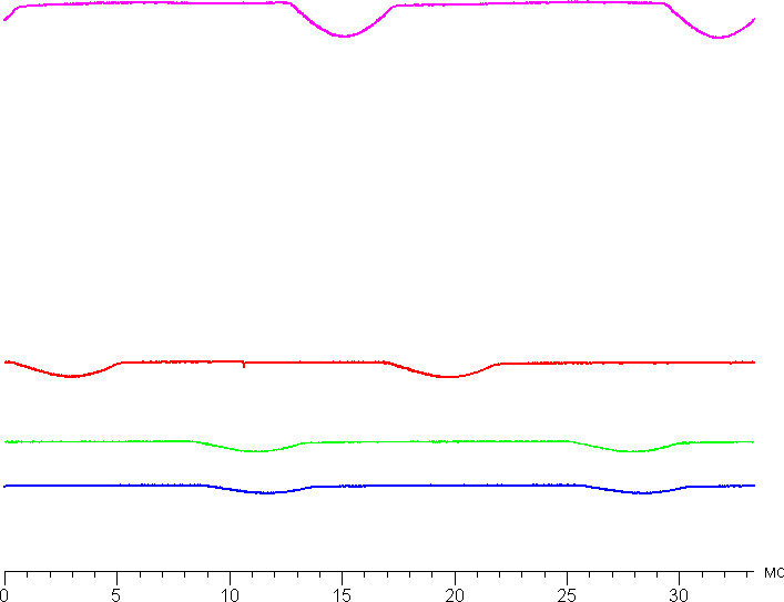

Apparently iPhone 13 is “definitely” getting a LTPO display according to new reports.
Apple Watch Series 6 uses a LTPO OLED, and has practically no flicker at 60Hz with an incredibly low amplitude:
Although it should be noted that the PWM on previous Apple Watch generations has had a similarly low amplitude, which explains why we don’t have any issues with the Apple Watch. I think this proves Apple could be doing more to address this on the iPhone.
For comparison this is the amplitude curve on iPhone 12:
For further reference this was iPhone X:
It does seem to be improved at between ~ 25-75%, though not as drastically as I’d like.

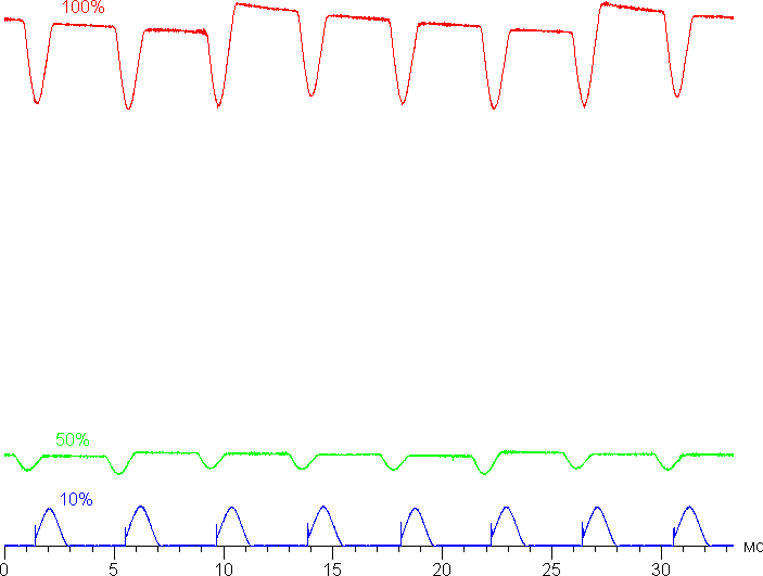

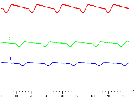

This was Apple Watch Series 4 pre-LTPO:
Great graphs here, but I just want to point out that the Apple Watch series 4 did have an LTPO backplane.
LTPO OLED Retina display with Force Touch”
There seems to be a lot of confusion going around about this, probably because Apple marketed the always on display so hard in conjunction with LTPO.
Anyways, we can see that the Apple Watch does a lot better at any given brightness than the OLED iPhones do. I don’t know what requirements Apple has for color accuracy on the watch, but I’d bet it’s not as high as for the iPhones, which makes it possible to run at lower brightness without PWM.
