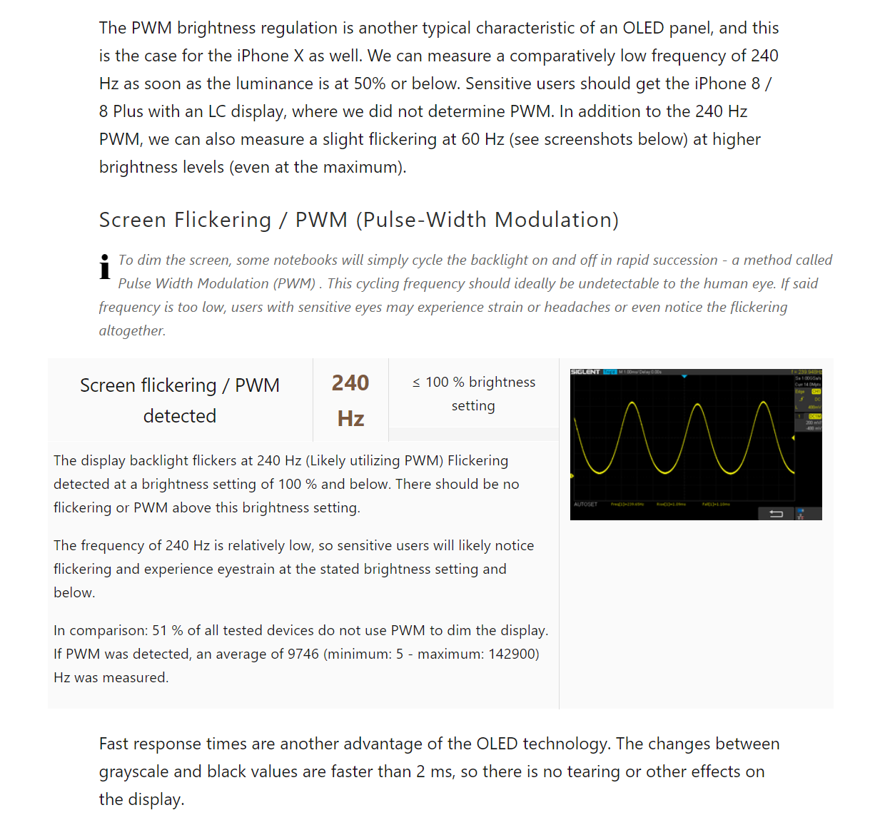

Actually there's still at least some amount of flicker with DC Dimming too, but it's reduced quite a bit compared to PWM.

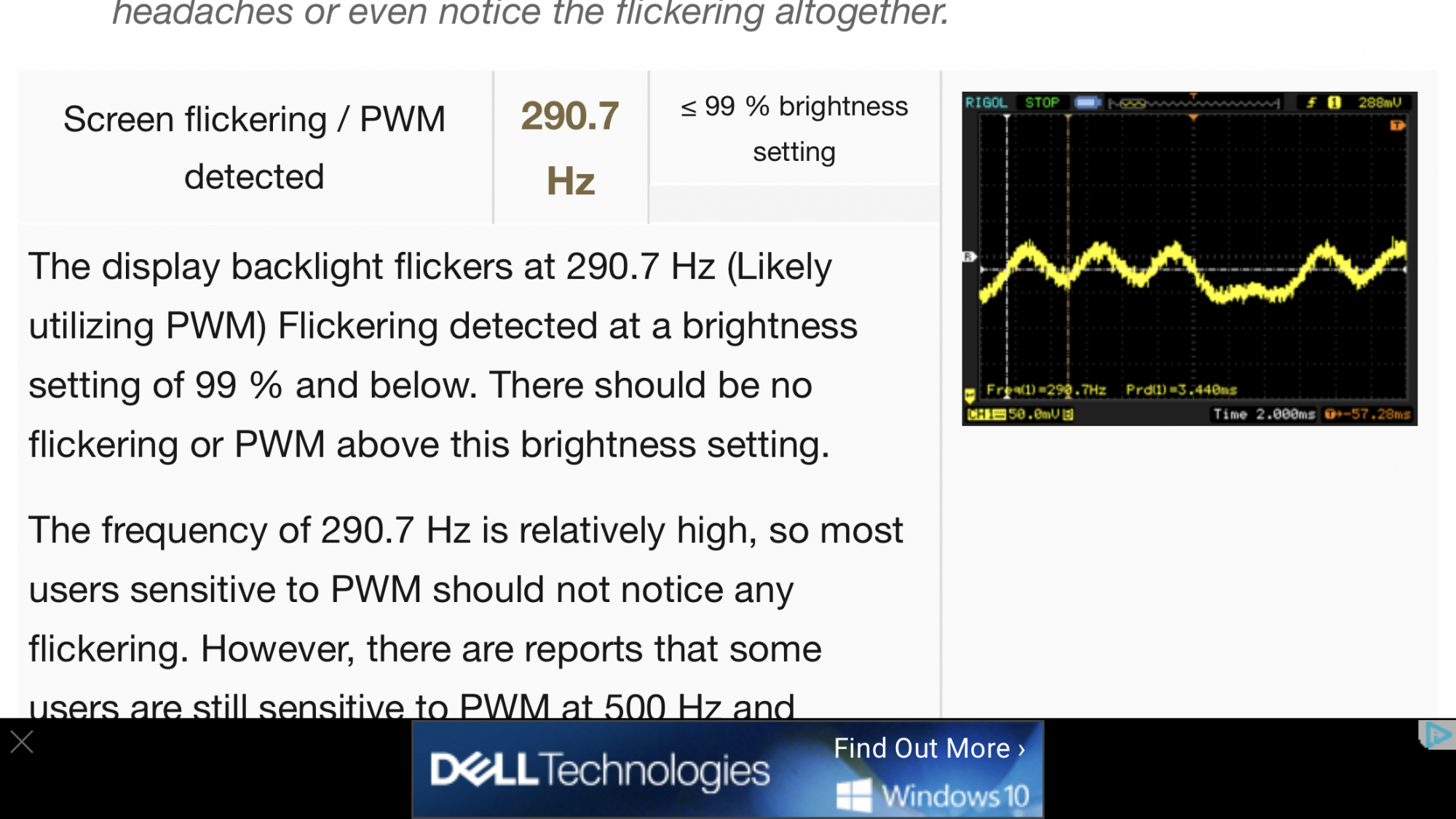

You're showing the results for the 11 Pro, the video i showed was for the X ..
Well I was originally talking about the 11 Pro (and how notebookcheck misrecorded rate) so I have no clue why you replied with video for the X?
iPhone X - 240 Hz
iPhone 11 Pro - 290.7 Hz
iPhone 11 Pro Max - 245.1 Hz
iPhone 12 - 226.2 Hz
iPhone 12 Pro - 277.8 Hz
iPhone 12 Pro Max - 238 Hz
All are considered low
I don't think this outfit is very good at recording accurate readings as they been caught out misreading the rate for the 11 Pro but this info has been shared so many times its never been corrected.
But 100% agree these rates are very low and the reason it's a huge issue for those sensitive (and I'm starting to think more people are affected but don't know it's there phone/tablet/monitor which is the cause).
Notebookcheck ? Where were they called out, you have a link ? They do excellent work.

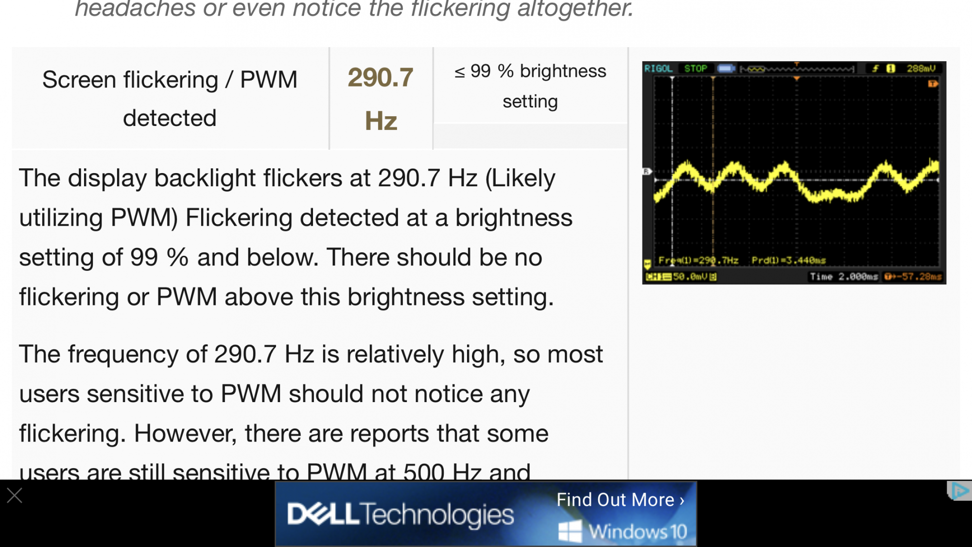

Its already been mentioned a few times on the forum that the 290.7 reading was a writing error that hasn't been amended.
Link example - post 2838:
Eye-strain while using iPhone X
Yes I mentioned earlier in this thread that the original review was bogus as they misread their own graph. It clearly shows slower than 290hz if you measure it yourself, but they wrote the 290 anyway. Sloppy. Also this goes to show how much this issue is placebo induced that merely the...
The report also mentioned:
11 Pro Max:
"The display backlight flickers at 245.1 Hz (Likely utilizing PWM) Flickering detected at a brightness setting of 99 % and below. There should be no flickering or PWM above this brightness setting.
The frequency of 245.1 Hz is relatively low, so sensitive users will likely notice flickering and experience eyestrain at the stated brightness setting and below."
11 Pro:
"The panel in our review unit flickers at between 60 and 290.7 Hz, which is rather unusual. By contrast, most OLED panels flicker at one frequency."
