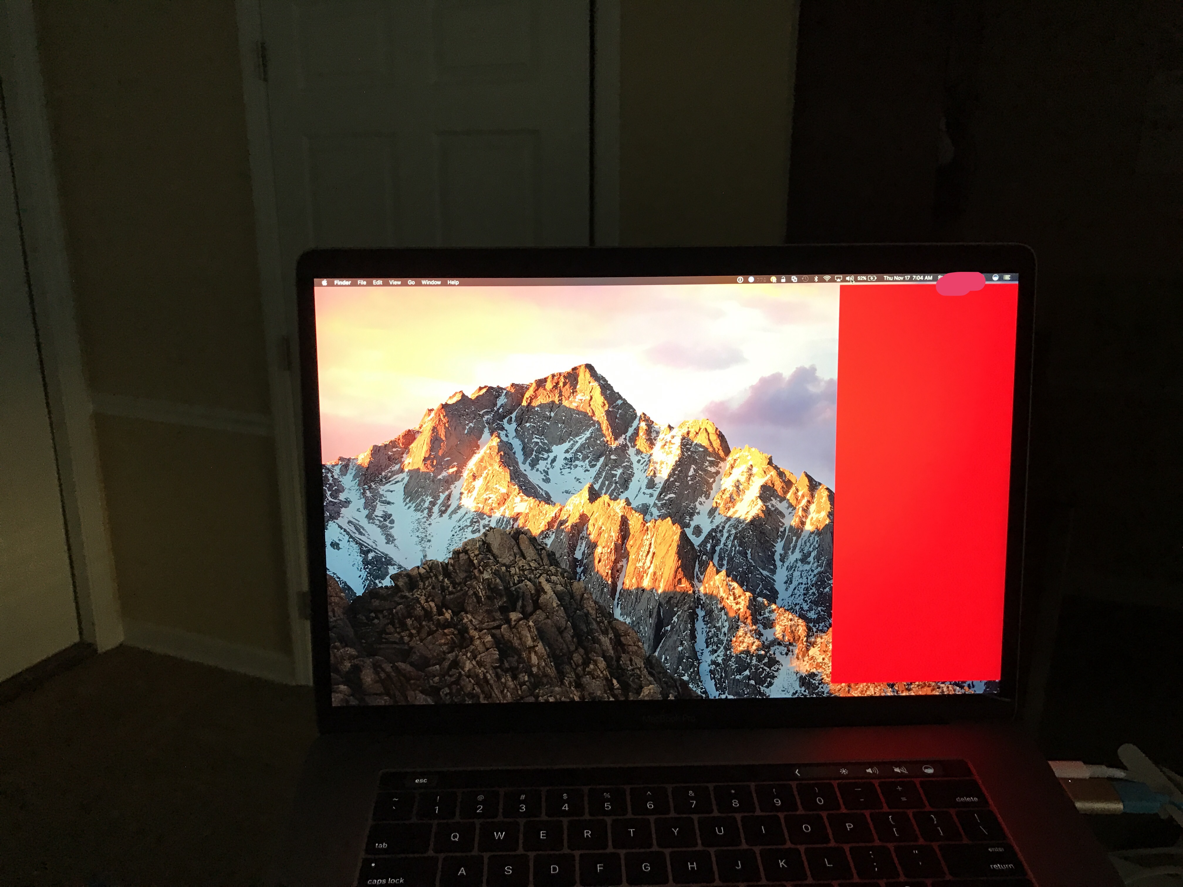

Wonder if the driver flipping between igpu and dgpu is buggy. Are you on battery when this happens.
I was both on Battery and on Power and the issue still happened. I also forced the dedicated GPU and found the issue would happen as well.
[doublepost=1479396542][/doublepost]I will let you all know what happens, I have an appointment with Apple today. My hope is they let me keep this computer and order me a new one and let me use this one until it arrives. I rather them not try to "FIX" a brand new computer and for my freelance business I can not be without a computer for over a month.

It hits me too.. is there a way to enforce it using Intel GPU for the time being before Apple fix it?
I'm not sure if mine is related to OP's problem, but on bootup after logging in I get a flicker at the bottom of the screen. Just got this yesterday 15" tb 2.7/16/512/455. Did hardware diagnostics at an Apple Genius Bar and restored the OS and it still happens only on log in. Anyone else have this?
I have the 15 MBP, 1tb, 2.9, 460 and this was happening on logging in. Disabling file vault stops it from happening, but I believe it is because the logging in window changes. In any event, I have been on the phone with apple support and they want me to bring it in for a replacement. They are currently calling local stores to see if there is an exact model that I could replace with. However, you are the first with a 455 that I have seen encounter this issue, so I am starting to wonder if it is more software related than anything else. Maybe firmware for the video card?

I've got the same problem with a build to order 2016 MBP - 15"...was fine for a day...was watching a youtube video and dragged the safari window to the top of the screen and got the multi-desktop view...then everything went red/matrix'ish...and the video audio kept playing...then stopped...after a reboot I have some significant screen flicker...
The red matrix were light red blocks of tetris right?

My 2012 MBP had a similar issue. Initially, Apple thought it was the display itself. So they replaced it. One hour after getting home (with new display fitted), I had the problem again and took it back. I didn't even make a second appointment... At this stage I was so annoyed.
In the end they replaced the mother board AND graphics. Thankfully I had AppleCare, because afterwards, they gave me the invoice which was a total of 920EURO (about 1000USD) for the new display, MotherBoard & Graphics unit, but I didn't have to pay a penny.
Haven't had an issue since!
Can anyone confirm if the screen artifacts occurs when the computer is in integrated GPU or discreet GPU mode? You can figure this out with an addon. Not sure if this utility still works on the newest MPBs, but it is worth a try: https://gfx.io/
It looks suspiciously like the Skylake HD5XX IGPU issues I am seeing while gaming on my desktop. You get small black squares which looks like a graphics rendering problem. If so, it looks like a Intel GPU driver issue.
One thing to try is to connect to external display, which will force the MPB into discreet GPU mode. Repeat experiment to see if the rendering problem still occurs.

If your assumption is correct, is it a hardware or software issue?

I know for sure that regardless of NVIDIA or AMD, these dGPU MBP's have had way too many problems BECAUSE of these cards (People with the models with no dGPU's have had none of these aforementioned issues)
It could be a cooling issue as well. The whole motherboard has soldered components, but only a few are actively cooled. In my experience with graphics glitches, it's always been overheating. Sometimes replacing the thermal compound between the heatsink/heatpipe fixes the issue, but sometimes not. It's almost as if the package is insulating the integrated circuit so much that heat can't escape fast enough. If you could check the GPU temp, that might provide an indication of whether it's temperature related.
Yeah I have this too. I select the red region and it goes away. Will take it in once I know they have supply.
