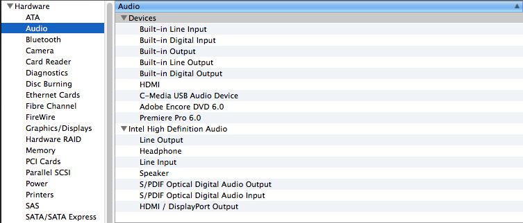

Upgrade from 10.9.2 to 10.9.3 beta, the HDMIAudio still works.
Can't confirm that. Here it does still show up in sound prefs and works. Just tested with MPlayer in 13D45a on a 2009 MP 5,1, HD7970.

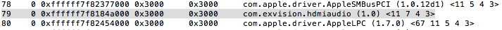

Here is what kextutil says
Thanks! Worked great on my Nvidia GTX 680 and 10.9.2. I'm running audio over DisplayPort to my LG monitor, it shows up under the audio devices as my monitor's model number, "34UM95".
@Hennesie2000: I got the same message, but it's just a warning and worked for me anyway. Make sure you reboot right after installing.

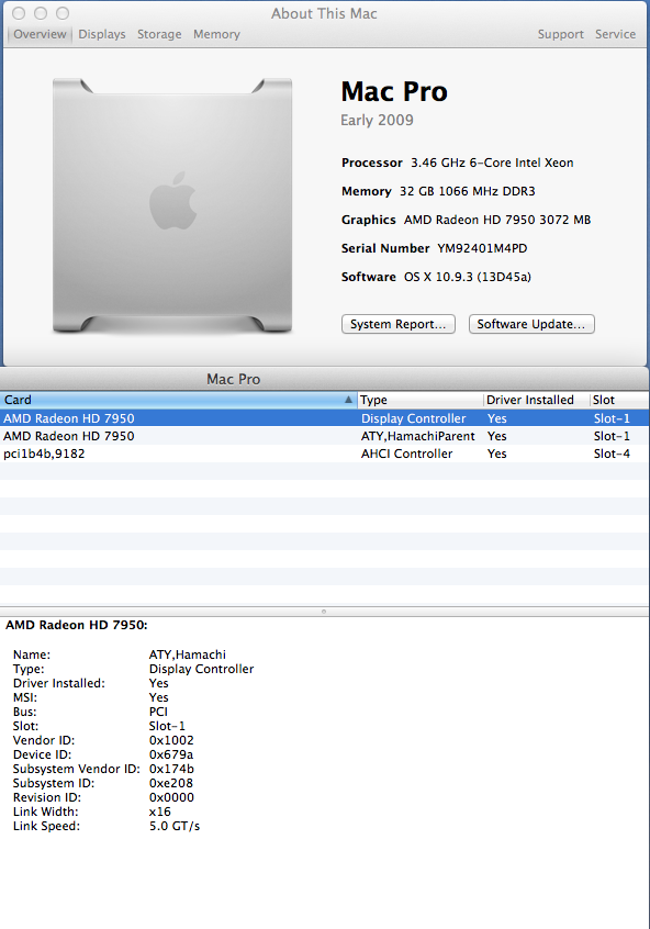

Just wanted to say that out of curiosity, I downloaded and installed the extension on my 1,1 with HD7950 Mac Edition installed. My system information now shows HDMI audio output as an option for sound. I am running OSX 10.9.2. Very sweet addition to our machines. I do not currently have a need for this on my oMP 1,1. But in case I do in the future, thank you.
And It's looks better in the system report as well, I don't want to see any hardware there with no driver installed :D

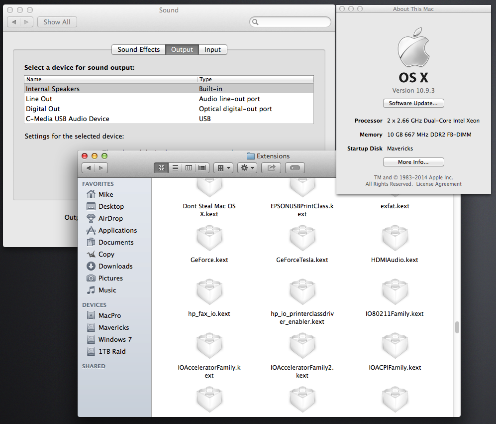

I have a Mac Pro 1,1 running Mavericks using the Tiamo boot.efi file. The GTX 570 is in slot 1 and there is a USB 3.0 card in slot 3. The monitor/TV is a Samsung UN22D5000 which is connected using a mini HDMI to HDMI cable.
HDMI did not show up in the audio preferences when I was running the 10.9.3 beta as it shows up in 10.9.2. I have not updated to the official release of 10.9.3 yet.
Edit:
I updated to the official 10.9.3 and then reinstalled the HDMIAudio kext and it does not show up as an option in sound preferences still. It also does not show up under audio in the system profiler as a device. When running 10.9.2 there is an HDMI listing under devices. I also tried modifying the 331.01 driver package from Nvidia to install on my system, which it did, but it is using the default OS X driver because the driver from Nvidia is not compatible with 10.9.3. It did not make a difference with HDMI Audio.

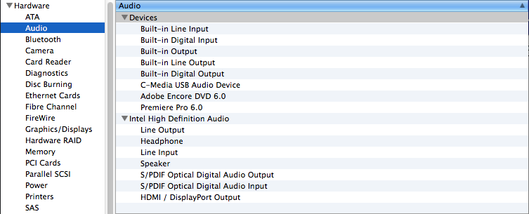

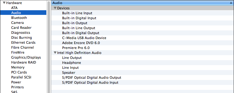

Here are two screenshots on 10.9.3 with and without HDMI Audio installed. It would seem that the device is not initializing properly. In 10.9.2 there would also be an HDMI entry in the devices list as I stated above.
With
Without
10.9.2 With
Edit:

Since you have basically the same setup as me and it is working for you. Can you type 'kextstat' in terminal and see if HDMIAudio is mentioned at all? It is not mentioned there when I am running 10.9.3 so I would assume it is not loading properly.
It's there for me. Sorry, I've really no clue why it's not loading for you.

Update:
I noticed it doesn't show up under kextstat in 10.9.2 even though it is working fine. So don't think that was a good test. I assume it is something with my card at this point.
