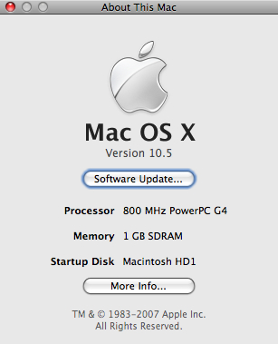

Worked flawlessly, first time through. Thanks for the write up.

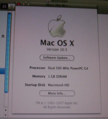

I successfully installed Leopard by following the procedure outlined here, and then restoring the modified image to a spare 20 gig drive. I'm now playing around with it for the next few days before I decide to install it on my main drive.
