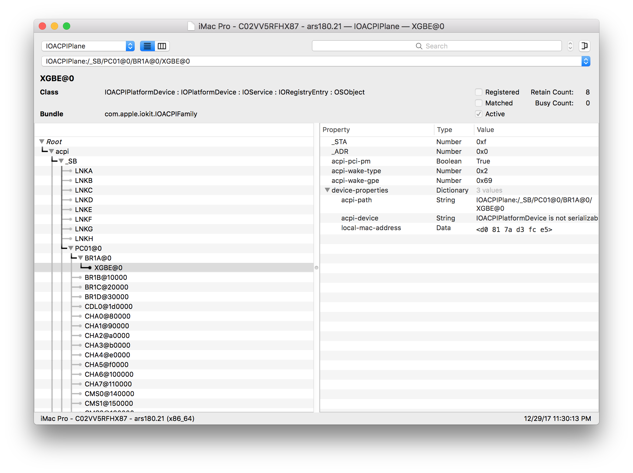

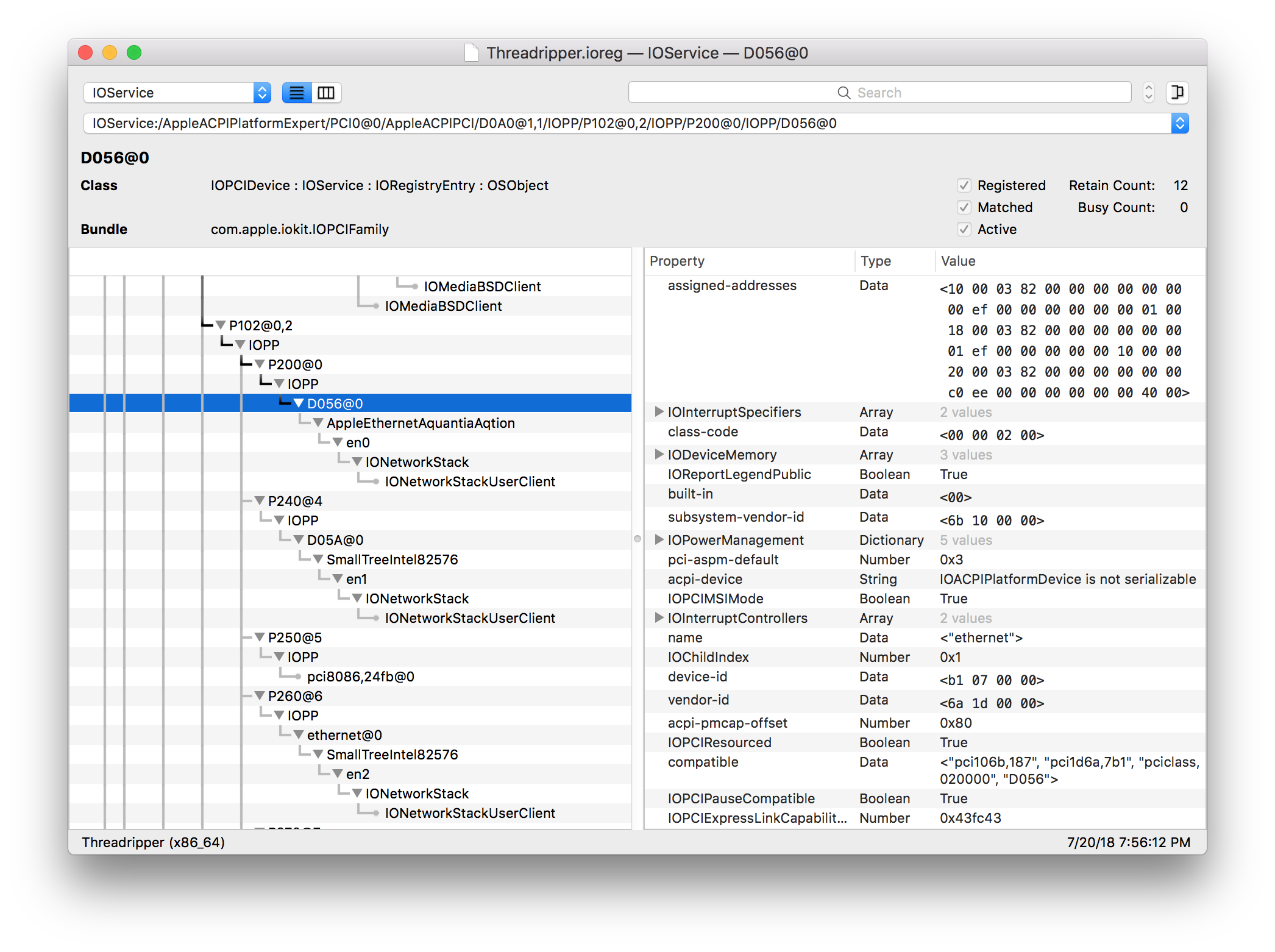

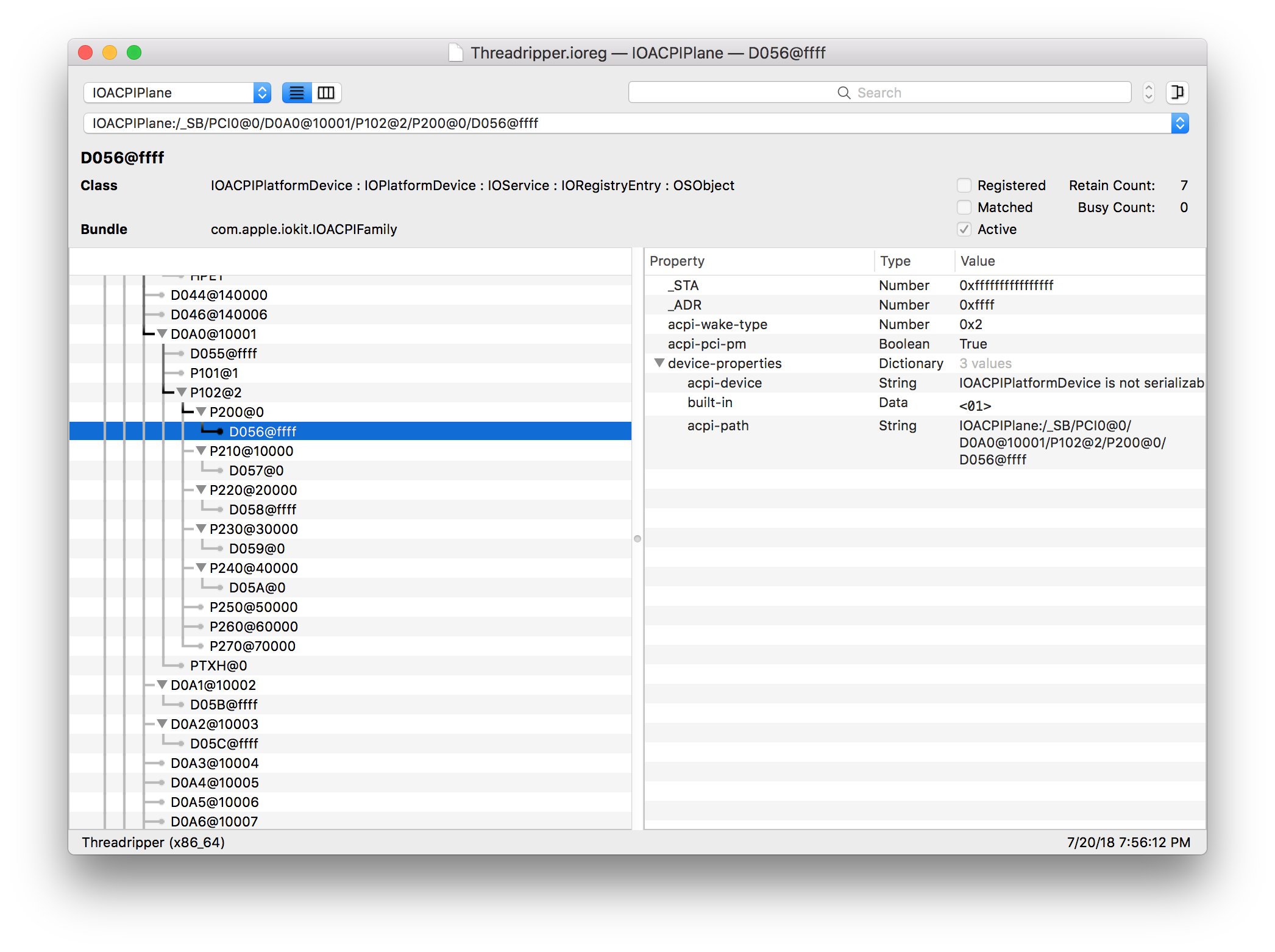

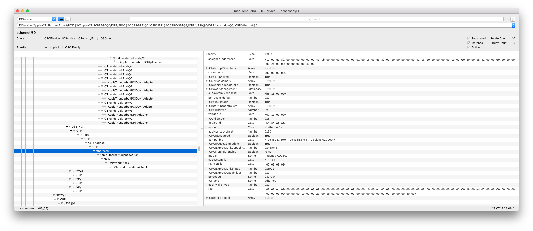

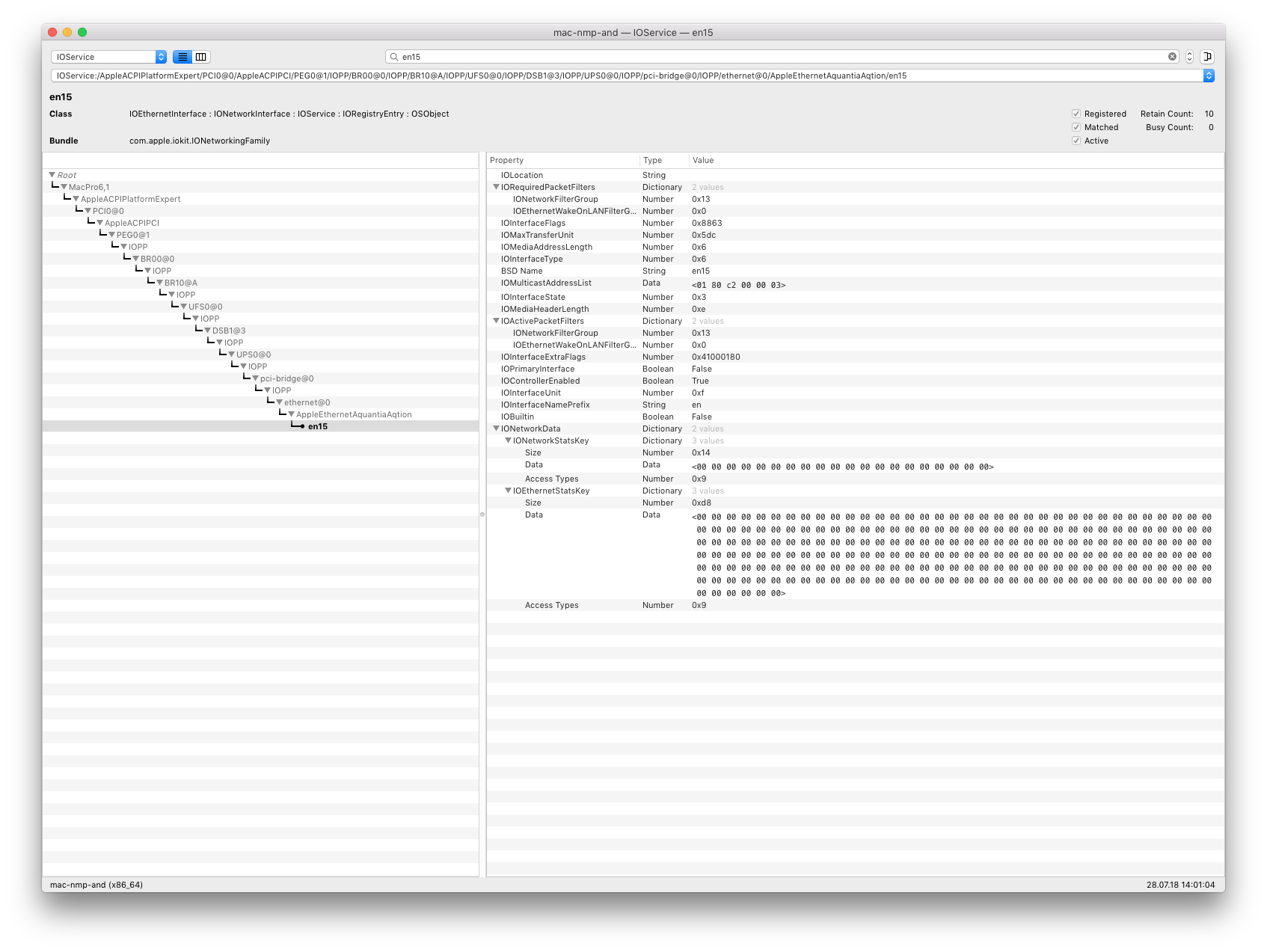

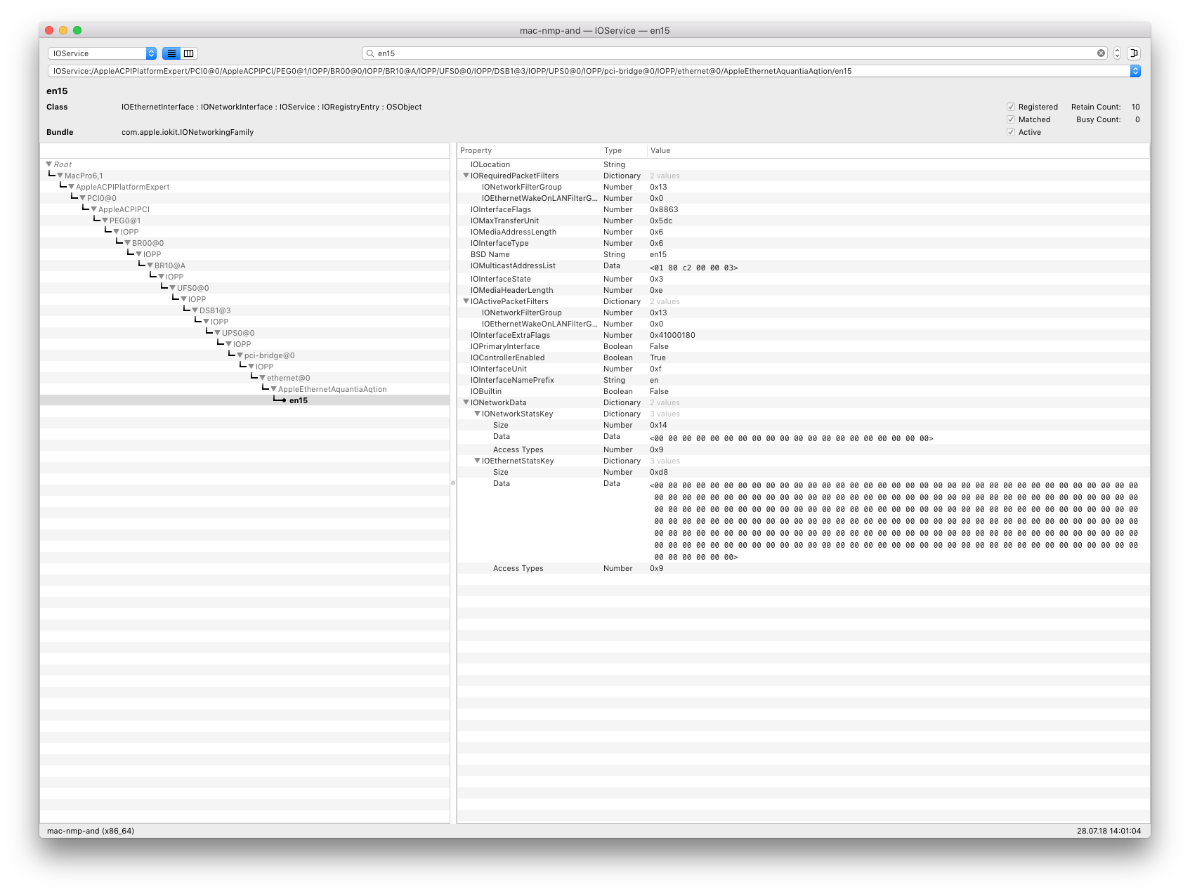

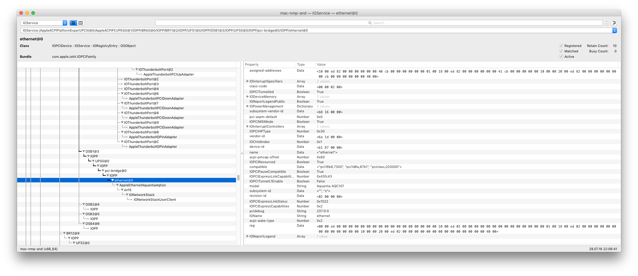

`IOBuiltin` is `False`, if that's what you mean.
How would I search for that?
Two levels up in IOService plane. DSDT/SSDT is in IOACPIPlane. The screen shots are from onboard AQC.
iMacPro does not have built-in property in DSDT:
Reactions: dabotsonline
@ydeng Can't seem to find the corresponding node in IOACPIPlane...
Thanks for trying. Then there is no DSDT/SSDT for the device.

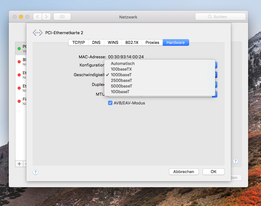

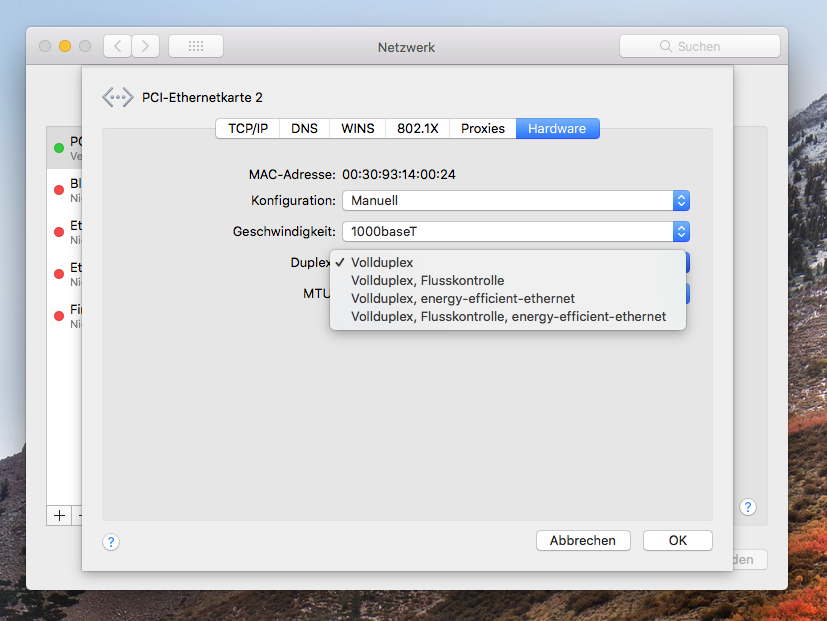

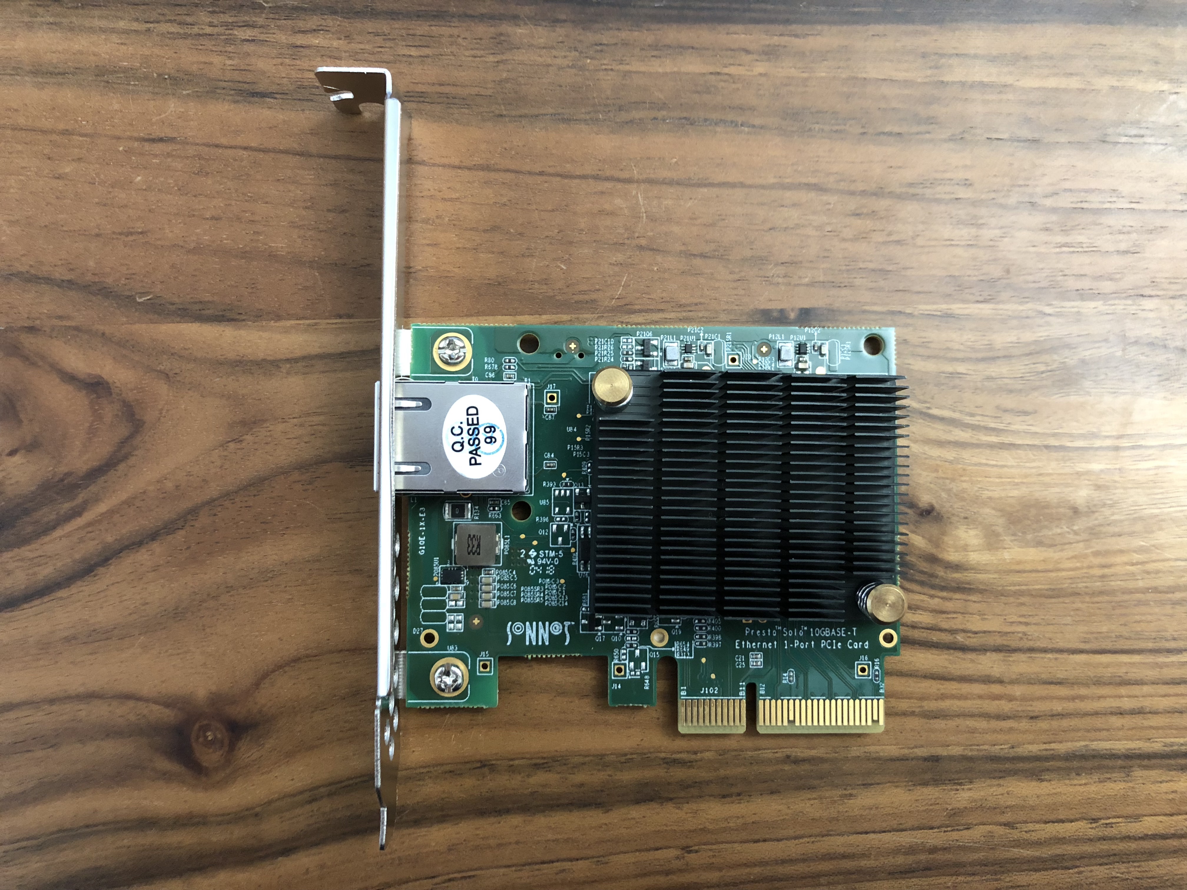

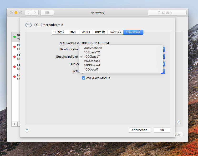

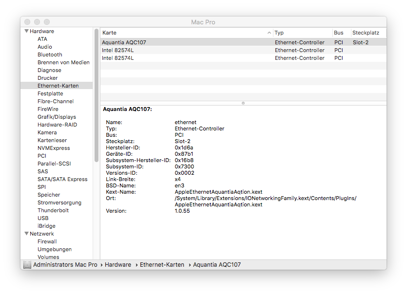

Good news! I've received my Sonnet Solo10G PCIe card and it works as advertised. Plug and play in both a MacPro5,1 and a Thunderbolt enclosure (FirmTek ThunderTek/PX) under macOS 10.13.5.
Now I need a second device to actually test 10G troughput.
View attachment 770053 View attachment 770054 View attachment 770055 View attachment 770056 View attachment 770057 View attachment 770058
PS: Sorry for the german screenshots. Didn't realize it at the time. :)

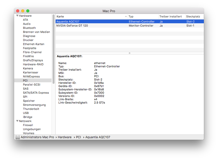

according to your screenshot, the link on the PCIe is only 4x 2.5 GT/s (should be 4x 5.0 GT/s IMHO)

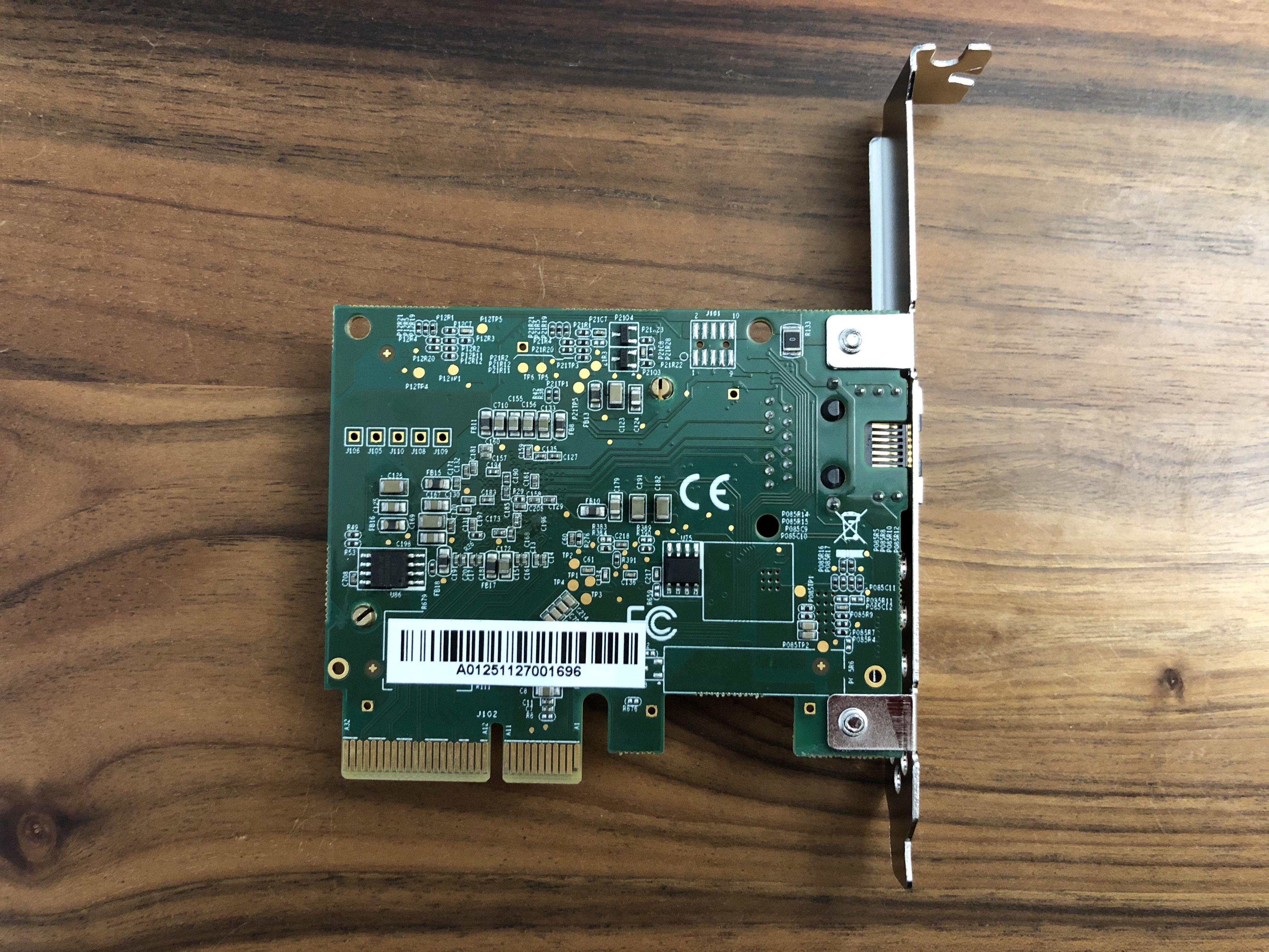

[doublepost=1547112412][/doublepost]also, AFAIK, the first batch of Sonnet 10GbE PCIe cards had some problems.
Rev. A cards: serial starts with an "A". rev. B cards: serial starts with a "B".
the serial # of your card starts with an "A"...

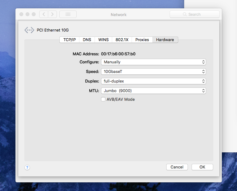

[doublepost=1560871971][/doublepost]Hi Kris - Here are the requested sys prefs -

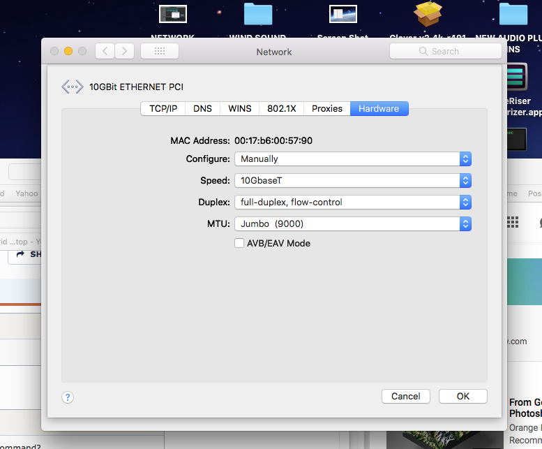

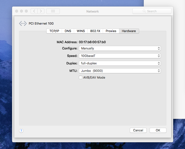

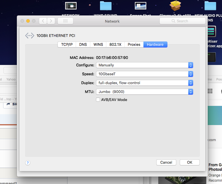

What are your cable specs? Are you using cat 6/cat 7? Long run? Short run?
Also turn off jumbo frames for now to see if you get anything different.
Iv tried 3 cables - Two Cat6a - one worked but lowered scores - the other didn't - Best results are from a CAT 8 - all less than a metre.twisted pair copper as per the specs of the card
I moved the card in the Mac Pro to a x16 slot. Remote - local is 36.56Gbits/sec but slightly lower in that slot from local to remote.
Tried turning off jumbo packets - no difference in results

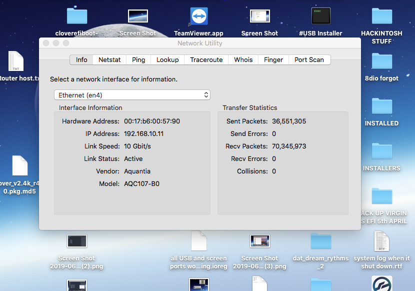

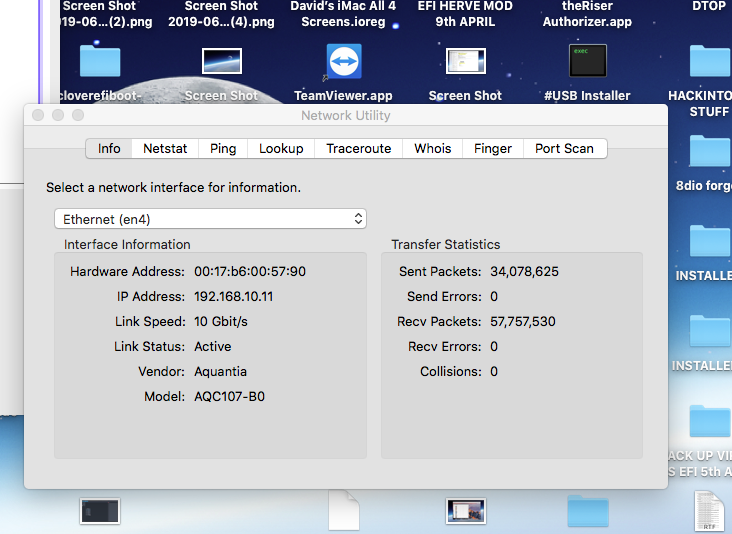

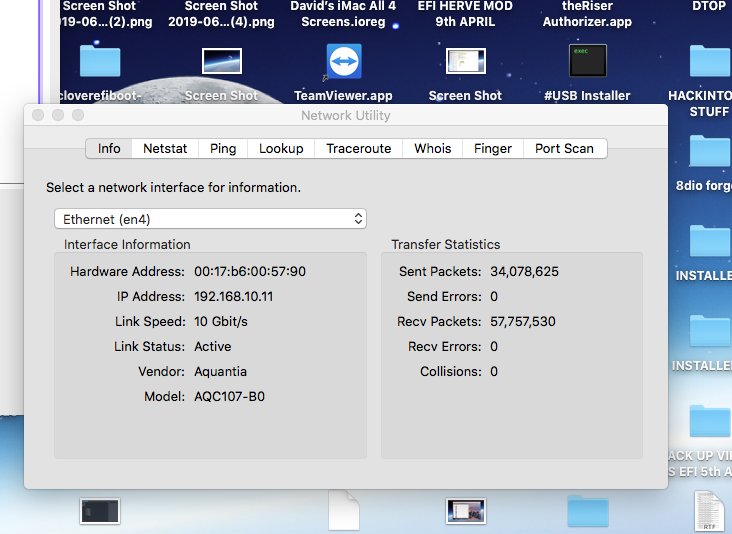

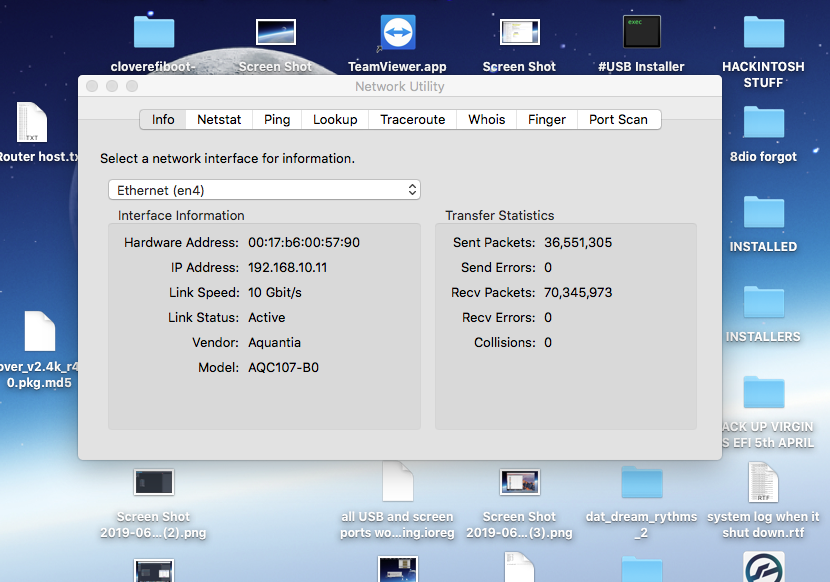

That's definitely not enough and indicates a problem with the network connection itself.

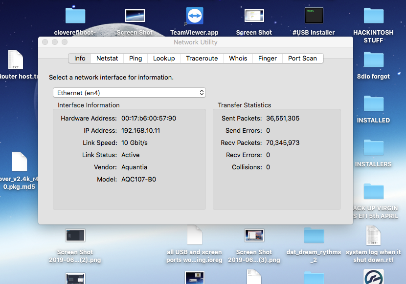

Can you check the error rates in "Network Utility.app"? Switch to the first tab ("Info"). There is a dropdown that lists the different network interfaces. Select the 10G interface, run an iperf test again and check the number of "Send Errors" and "Recv Errors". With a good ethernet connection, both these counters should be 0.
Can you check the error rates in "Network Utility.app"? Switch to the first tab ("Info"). There is a dropdown that lists the different network interfaces. Select the 10G interface, run an iperf test again and check the number of "Send Errors" and "Recv Errors". With a good ethernet connection, both these counters should be 0.[/QUOTE]

Hm, both error counters are 0, which means that the connection is good (so in my opinion the cable and shielding are fine).
Since testing the localhost with iperf yielded troughput far above 10gbit/s, the CPU shouldn't be the problem either.
Is it possible that the cards run too hot? The AQC107 chipset tends to throttle at high temperatures.
Or do you happen to have some firewall software running that might be slowing the connection down?
