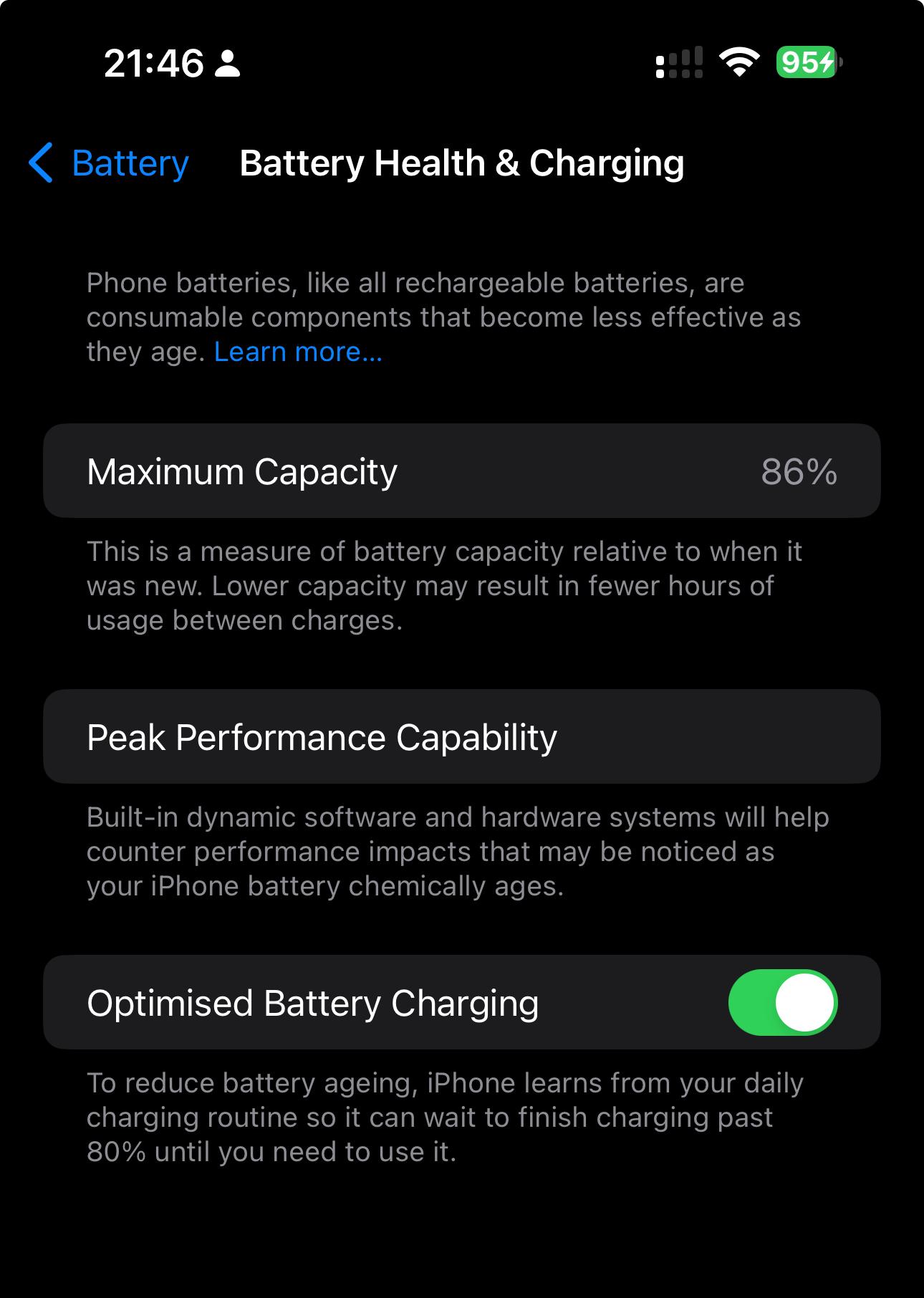

In another month I’m down to 88% (from 90%). This is getting ridiculous. My iPhone 14 Pro Max is just 1 year old and the battery health is 88%. Never happened before.
I didn’t change my habits, so definitely something is wrong with the battery
I have 214 cycles in one year

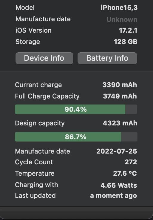

But [mention]Efficiency-King [/mention] mentioned that the battery was calibrated. How do you do that with lithium ion batteries?! What am I missing here? Nickel batteries needed calibration but we’ve moved past that decades ago.
Just for context, my coconut battery reading is this -
And coconut battery aligns with the iOS battery stats.

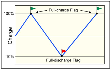

A simplistic explanation from Battery University:
To maintain accuracy, a smart battery should periodically be calibrated by running the pack down in the device until “Low Battery” appears and then apply a recharge. The full discharge sets the discharge flag and the full charge establishes the charge flag. A linear line forms between these two anchor points that allow SoC estimation. In time, this line gets blurred again and the battery requires recalibration. Figure 2 illustrates the full-discharge and full-charge flags.
For the most part, it’s the capacity that changes (i.e., full charge). So...
