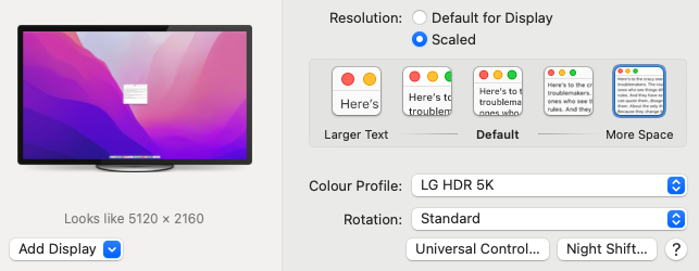

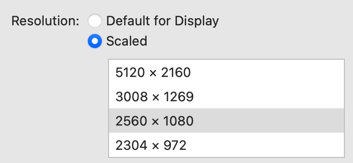

Just in case it's useful to anyone, I just got the M2 Air and I can run it in native res just fine...
(although I prefer 2x "Default" mode, and I can control the size of text inside the apps I use)
The options I see are:

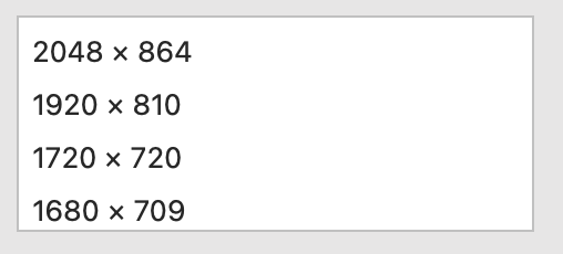

Other than the 5120x2160 native res, all of the other options are HiDPI. There is no option I can see to have e.g. 2560x1080 in non-HiDPI mode.
While SwitchResX can't create custom timings for Apple Silicon (because Apple), it can probably create custom scaled resolutions such as 2560x1080. I would try that to see if there's any non-HIDPI modes.
View attachment 2032981 View attachment 2032982 View attachment 2032983
This is actually the same issue that the regular M1 chip faced, and it's unfortunate to see that the M2 chip suffers the same problem.
Most people who buy the 5K2K ultrawide monitor prefer to run it a HiDPI mode that scales the effective resolution to somewhere close to 3440x1440 so that the text/UI stay sharp while retaining roughly about the same effective screen real estate as a conventional 34" ultrawide monitor with the 3440x1440 resolution.
To put it another way, none of the resolutions listed there are considered optimal because:
  • 5120x2160 (native resolution) makes the text/UI too small
  • 3008x1269 (highest available HiDPI resolution) results in a smaller effective screen real estate than a conventional ultrawide with 3440x1440. With this setting you're essentially trading your screen space for sharper text/UI
  • 2560x1080 or 2304 x 972 give even smaller screen real estate, so it doesn't make sense to buy such a premium monitor if this is truly all the screen real estate you need
For those who are wanting to use higher HiDPI settings, the only choices at this point are buying one of the higher tier M1 chips (e.g. Max, Pro).

more space is not native .. it's still scaled probably.. 0.6 or 0.75 can u give ?
It looks native res to me. Everything way too tiny. Not sure how I'd check if it's not really native res. Surely if it says 5120x2160 and the native res of the monitor is 5120x2160, then there is no scaling?
Yeah you're correct. Running any monitor in its native resolution will give you the most screen real estate. There's no scaling involved when running in the native resolution. I think @macmus12 got it mixed up.

No no .. nothing is mixed up... native resolution in case of 5k2k is working fine, however that is not HiDPI (x2 scaling to 10k is too much, check what are the limits I wrote above).
Right and you are not going to get HiDPI above 3008x1269 on 34WK95U using either M1 (non-Pro/Max/Ultra) or M2. That's just the limit as is.
