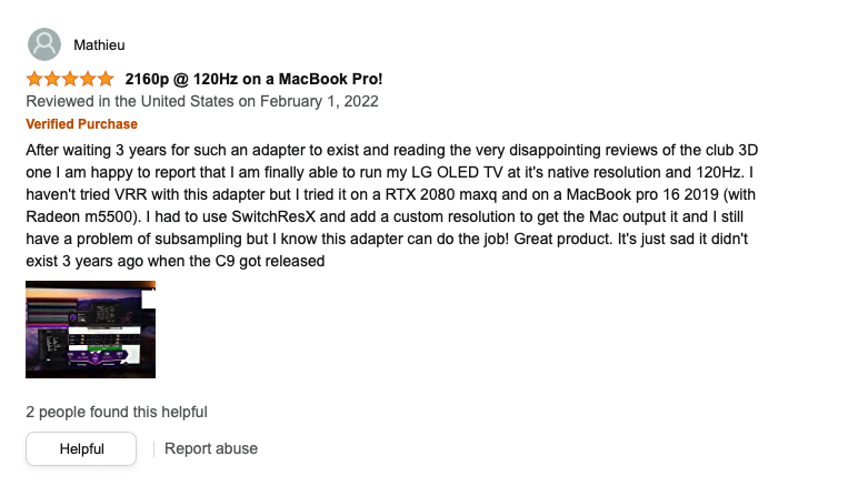

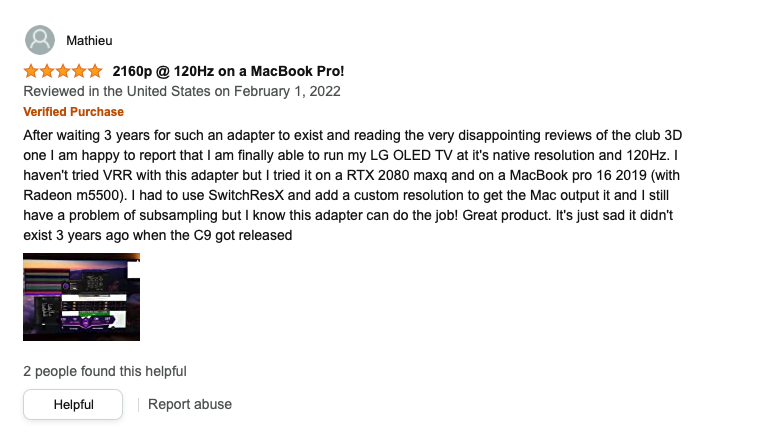

Maybe, it looks like that adapter requires extra USB power, no other adapter requires that, so maybe it does something different🤔. But i’m not getting my hopes up😖
The Club3D CAC-1085 also uses external power as it's not USB-C but DP. I expect this is just another variant of that.
This review, though 👀

I just found this active adapter on Amazon
The reviews seem promising. I think I'll give it a shot unless anyone has already?
Trying to get 4k 120hz for my C1 from my intel 16" MBP
I bought and tried this adapter a while back, unfortunately it’s a no-go on the M1 MBP. Worked fine on my older Intel Mac Mini.
