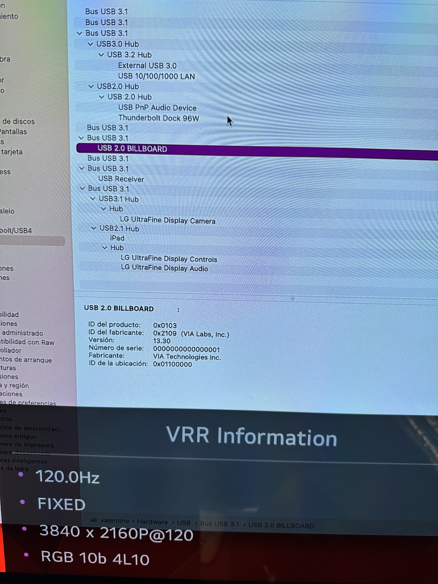

But I donw know why it says BILLBOARD
I never updated its firmware

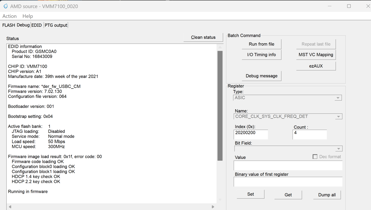

Can u start the Firmwaretool and show us Adapter Informations when clicking on Firmware version?
U need a Windows Machine with USB-C for that.
And can u plz upload ure EDID which u used to get RGB 10b 4k@120hz ?

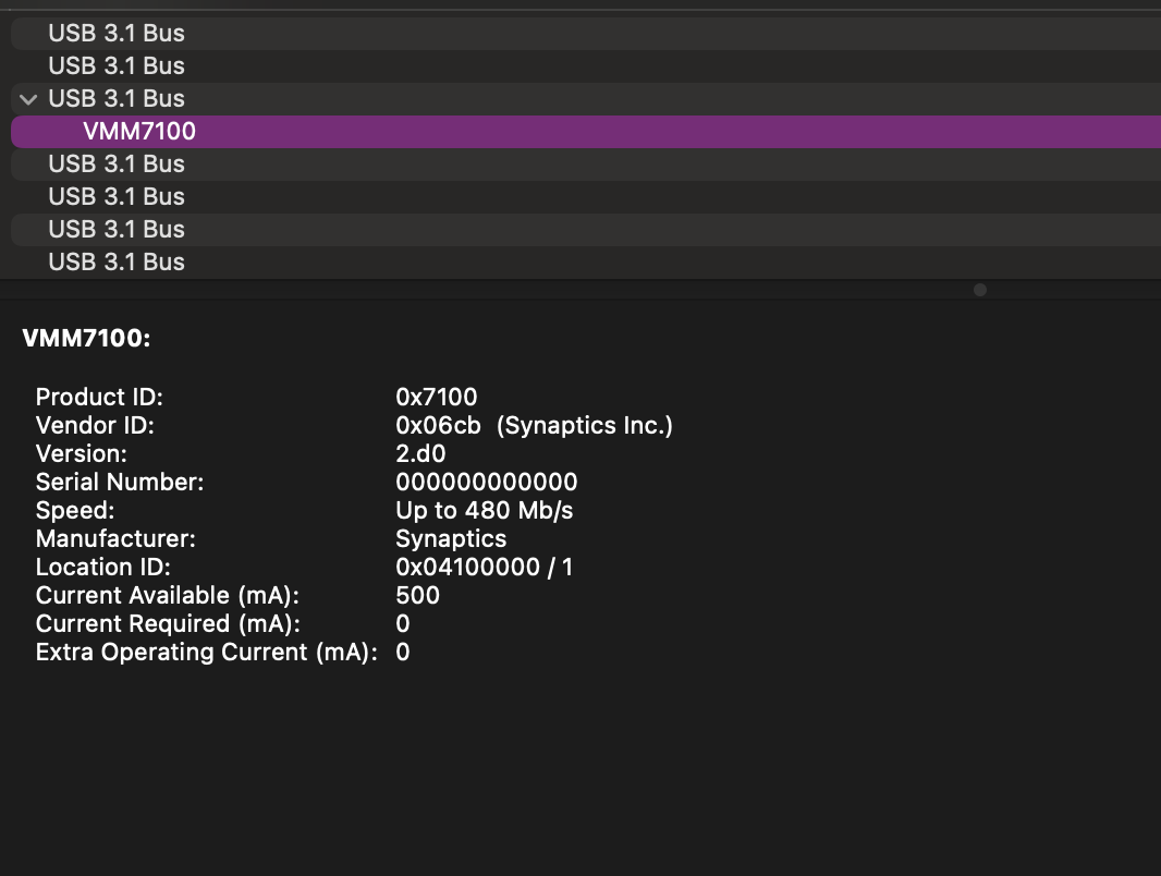

How can u test if u have an VMM7100 ?? Open the updater, it will show u the information!
U need a Windows Machine with USB C for the updater!

@AironMan do you know any other way besides using windows to update the firmware on the Cable Matters adapter? I mean its a bummer that Cable Matters doesn't have the mac version of their tool.

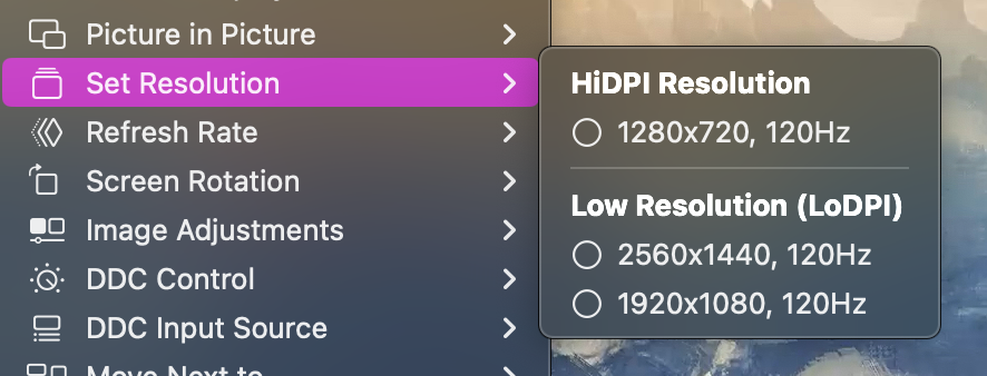

upgrading to ventura solved the issue. 120hz works with but not with rgb and it looks really bad. I'll just keep rgb 10b @ 60hz for now.
If anyone knows how to swtich to rgb, let us know. :confused:

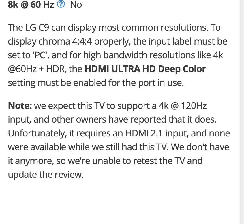

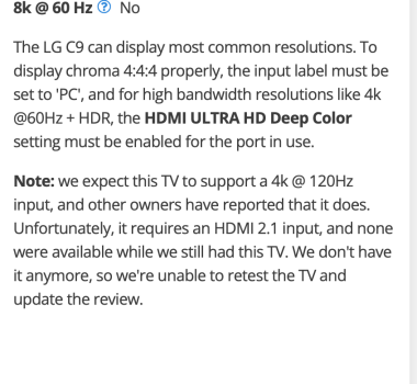

Maybe it's something with the C9 compared to newer CX-C2? I have my Sabrent one coming in today with a different HDMI cable. If that doesn't work I'll order the Anker

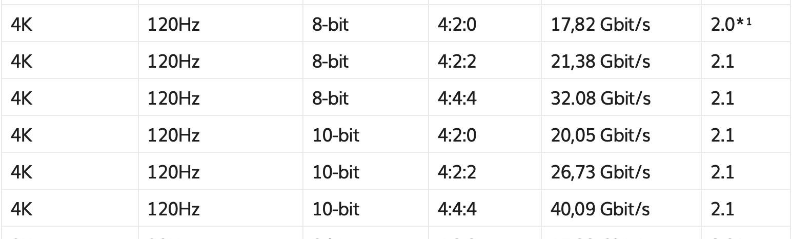

Iam not sure if the C9 can do 4:4:4 4k@120hz with 40 Gbps ! U have to check the bandwidth of your HDMI Ports. Also an good HDMI 2.1 48 Gbps Cable has to use with that.
Something like that:
Something linke that:

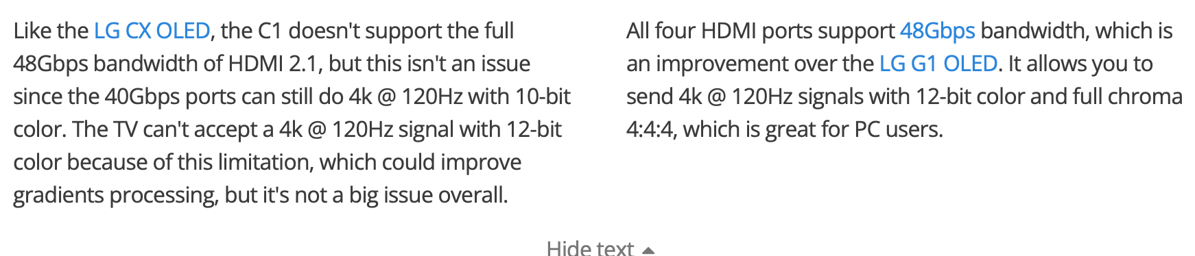

The C9 supports 4:4:4 4k@120 12bit with 48 Gbps I believe. Not sure about 4:4:4 40 Gbps
Iam not sure if 40Gbps is enough. When looking to @Alan Spiegel he has an C1 with RGB 10b 4k@120hz working. Dont know if RGB has less Bandwidth compare to uncompressed 4:4:4. Audio takes also some Gbps i think.
Yes u have to use Ventura. Iam Also on Beta Programm Ventura with latest release yesterday. 13.2.1 (22D68). U have to press many time green button to get information how the connection is to your lg tv. U have to be in PC Mode as well.
