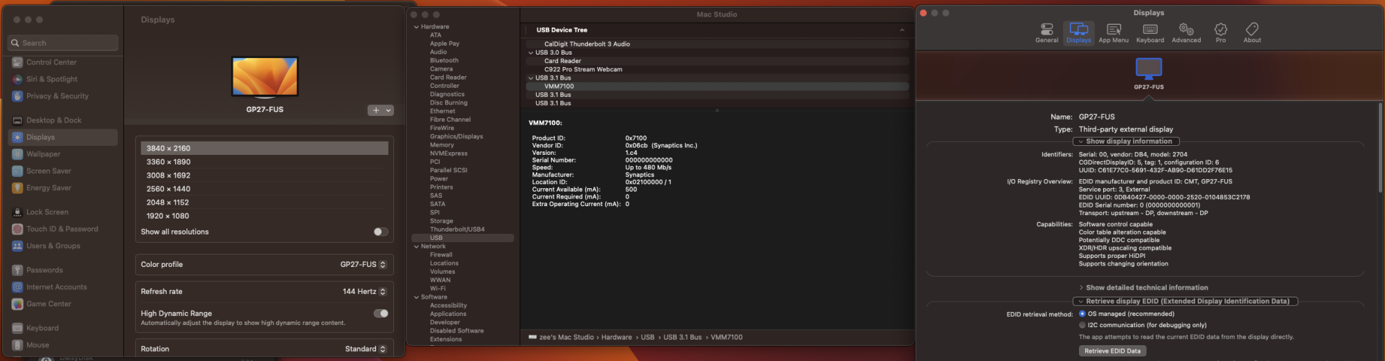

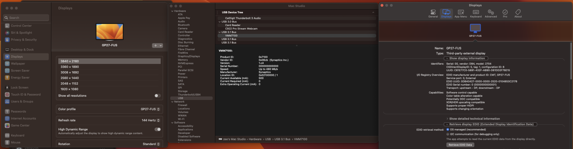

Now using a good HDMI cable by belkin now I'm able to do 4k 144hz on cooler master GP27U
Cable: https://www.belkin.com/th/AVC012bt2MBK.html
Also cable seems to be VM7100 and still works
